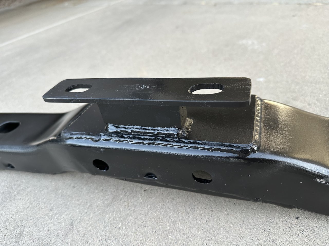

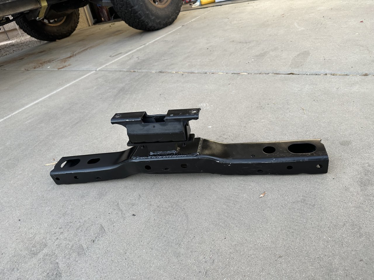

    Transmisssion crossmember is back. 10 hour turnaround. Tomorrow is final assembly of everything, then hopefully Tuesday is first start!

    I used to sell a fully fabricated boxed crossmember for the 2wd auto 2nd gen Tacoma. It was a very complicated and lengthy build process so the price-point I had to sell it at wasn't affordable to most customers unfortunately. Wish I could sell it cheaper but it takes 2 full days to make, I always ended us losing money on it actually haha.
    Ill still build it, but its costly.

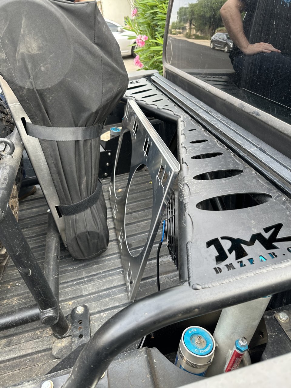

    Got in touch with AAPAK, a local AC company here to have some AC lines made for the truck. Just need to get the radiator and condenser mounted tonight. Im hoping there's enough room for it all...

    Welllll no shot the radiator fits up front. Condenser could, but then I’d need two sets of fans. F that.
    both are gonna go in the back. Don’t really have an option.

    Keeps rocks from puncturing the rad/evap. Not a horrible thing, but Im scared I won't be able to get it done before Thursday for my driveshaft appointment. Im struggling to find the correct size hose in a long enough length. Need 1.5" ID hose.

    Can't find some stainless steel tubing, or aluminum ? Got to be a local supplier close to you. Metal Supermarkets, Steel Supply, etc...

    Was going to try and do soft line. Not sure if that’s a bad idea or not.

    Most long runs that I have ever seen are hard, then with soft connectors where necessary. Probably because it is easier to attach, and won't sag where it shouldn't.
    Ultimately, your choice.

    Might not have a choice since I can’t find any soft.
