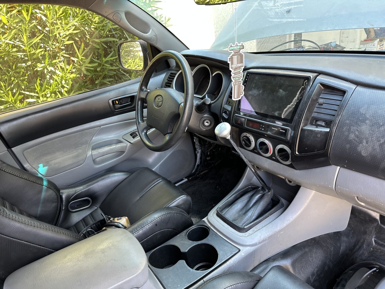

    New shifter installed, I’ll probably get a new shift boot…

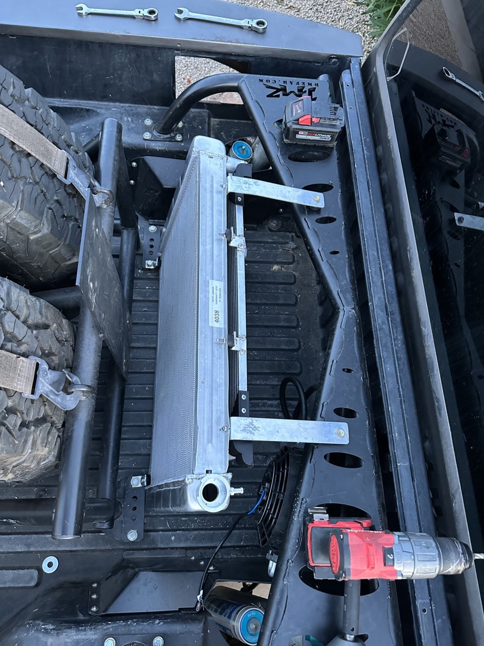

    Radiator and Condenser installed in the bed. Tire cage is still fully removable. Will put the fans on tomorrow.

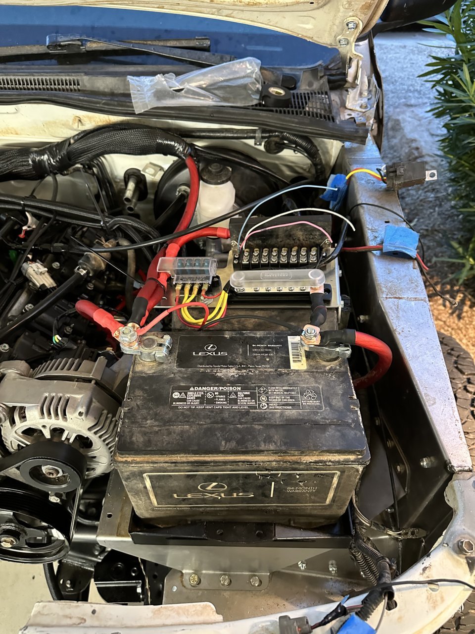

    switch pros and power tray install is done. Got a few wires to tidy up and connect, but for the most part it’s done. Just need to loom it.
    I want to find a shorter battery too.

    Is your switch pro hot line direct to the battery or also tied into the fuse block? Just an fyi switch pro recommends direct to battery (with a fuse ofc) and you “may” have some difficulty with any warranty work if you have it tied into a fuse block or anything, or so I have heard.
