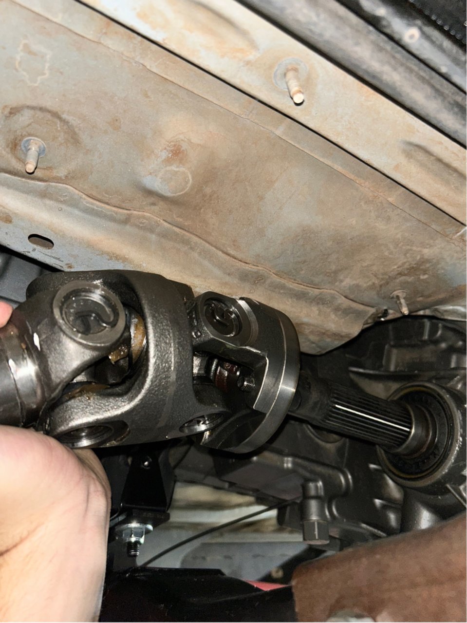

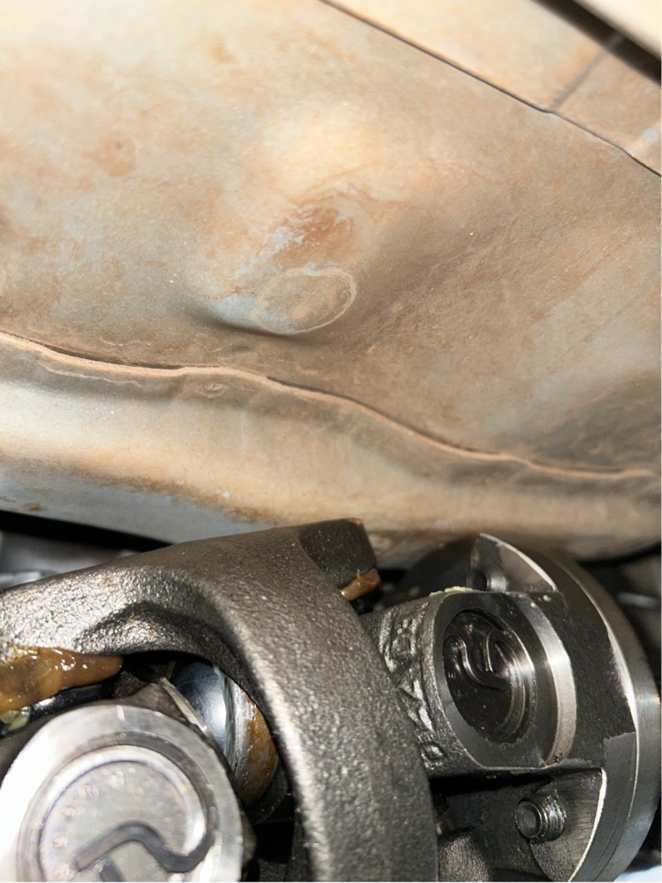

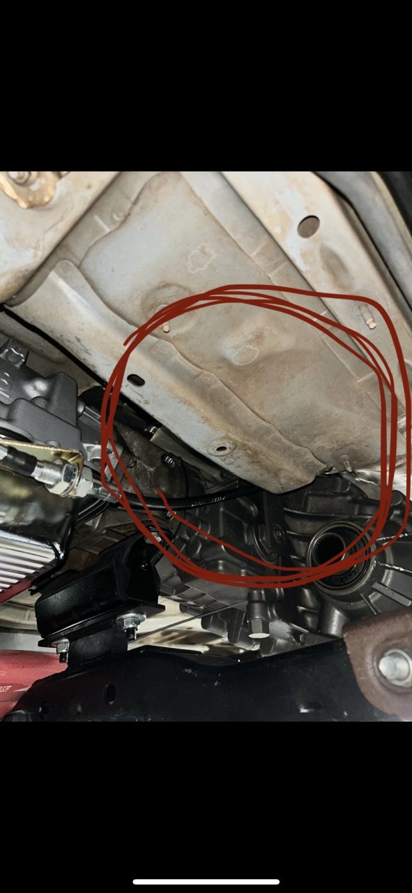

    Well got a call from AZ driveshafts. Rear driveshaft is done and fine but there was an issue with the front. Something about there not being a whole lot of room because the floor is in the way. They’re going to get me some pictures tomorrow. I told them to just do what they need to do to fix it.

    0aadbd2145384313ae02a6a871aaba45.jpg 2ada5eda05e249a0b87a6460d8c4b7a0.jpg 6b14c54f976b4be695df95f44145686e.jpg
    They're going to tunnel out the part where it's interfering. Going to be a little bit before I have the truck back I guess.

    Cut that extra reinforcement rib and run itttttt

    That’s what I was thinking but what do I know. They said they want to tunnel it so maybe I’m missing something.

    Pretty sure that'll self clearance...might make some funny noises in the process though

    Lmfao I’ll fuckin clearance it.
