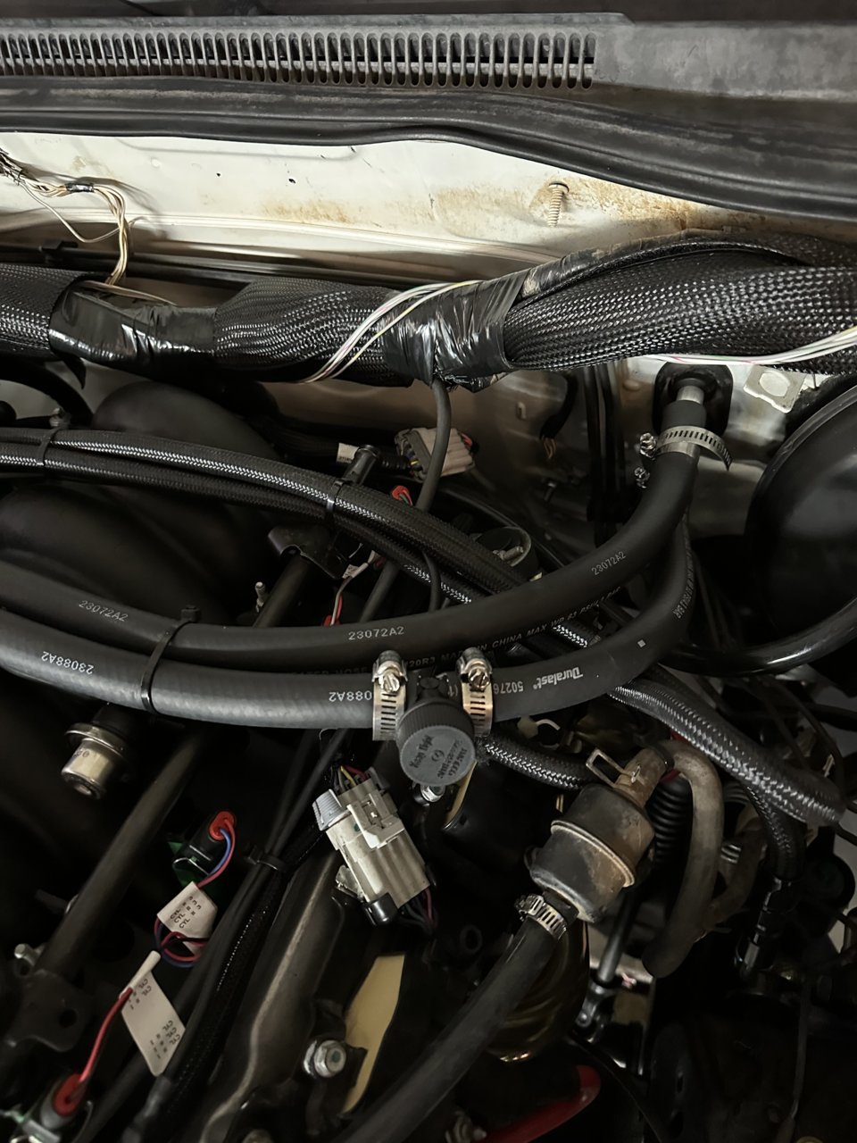

    I’m pretty sure that’s how I have it. The only thing I could guess is that there’s big enough air pockets for the pump to start cavitation and overheat. I’m gonna try sucking the air out with a vacuum pump from the steam vent. Can’t think of anything else.

    That’s a ducking brilliant idea. Has to be the heater hose? I have a place on the top of the water pump, but I imagine the pressure is just going to take the path of least resistance and not fill. What’s your suggestion on what to buy to make this work?

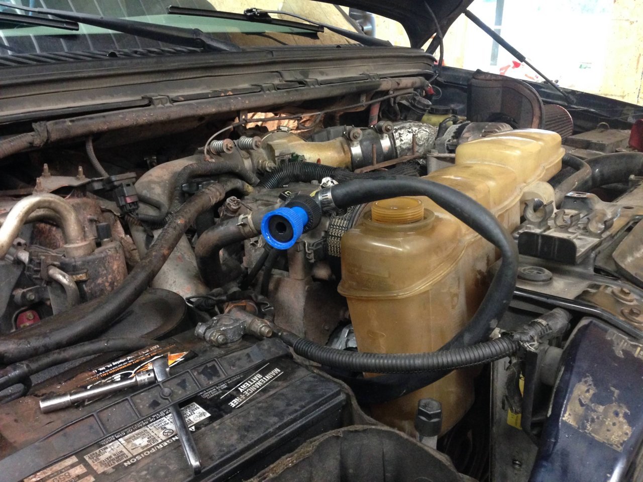

    doesn’t have to be but any of the smaller hoses. Maybe one that taps off to go to a temp sensor or the like, just not the larger main inlet/outlet hoses. The heater hose is nice because it’s at the top of the block so it forces water in most of the places it needs to go and easy to access. Not sure on the LS engines but on the taco and my old ford there are block drains you could also crack to check they flow without air as well.
    I used something like this kit
    https://www.autozone.com/cooling-heating-and-climate-control/radiator-flush-tools/p/peak-flush-and-fill-kit/525931_0_0
    on my 7.3 the heater outlet is super easy to access

    Per @6 gearT444E I got one of those flusher kits and got the T installed. No coolant came out when I cut the line :/
    Gonna flush fill it tomorrow and see how it comes out. Gonna take the overflow line off the reservoir and stick it in the 6 gallon jug of coolant I have right now, that way eventually it should circulate in there.

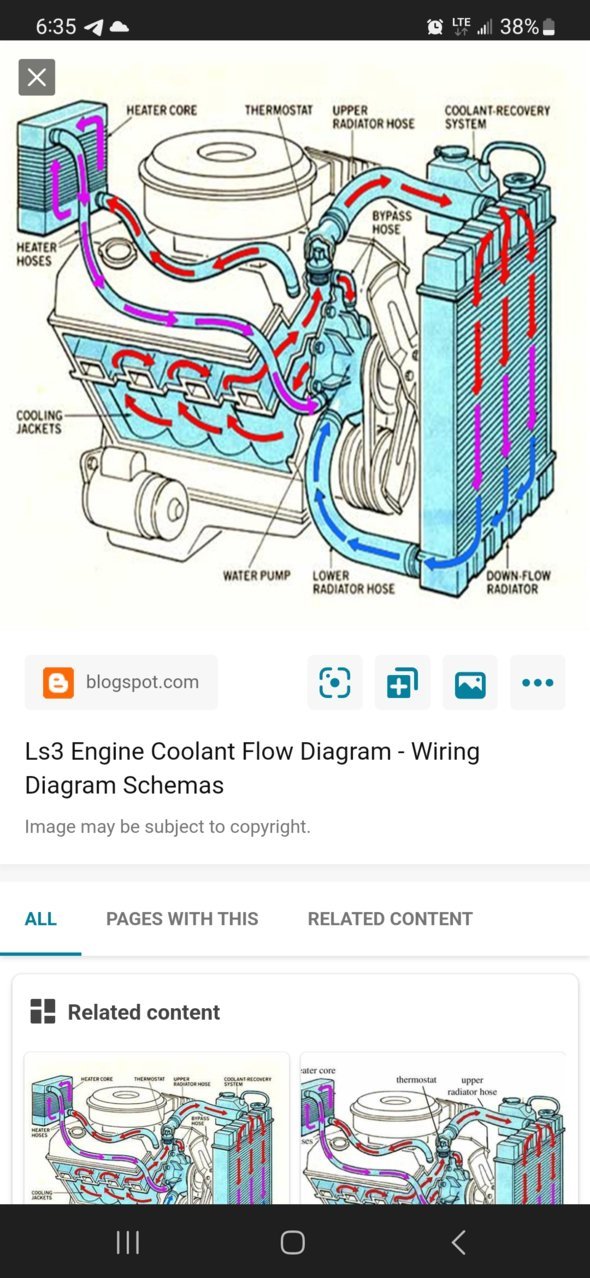

    Good thing that I said "should". I tried doing g some brief search, with no luck finding a similar illustration. Regardless, one port will go to the top of the radiator, just the same as before. That is an easy test to find out. Simply knowing which one pumps out. I am.sure you know that already. If the heater hoses are in opposition to the radiator flow, it could create a problem.
    Just a guess though, but it kind of seems like you may be experiencing vapor lock.
    I have heard of some setups similar to yours that required a pump to aid the flow across the distance. Just s thought

    I believe the illustration is of a SBC (for illustration purposes only). My 5.3 L33 cammed truck engine now has the same water pump as you (I believe). As I switched to Vette accessories that are 1.5” closer to the block making the engine more compact. I.e. more room for the custom fan shroud I had fabricated to fit & cover every fin in the radiator. The shroud sets within 1/16” of the fins and holds two 12” SPAL fans combined pull 4400 CFM. The shroud slides and bolts in just like the factory composite plastic one does. The shroud also has six 3” holes in the aluminum shroud with thin rubber flaps that will allow for more flow at highway speeds. All this behind the drop in Mishimoto radiator in the OE location to get maximum air flow to keep the baby all aluminum 5.3 cool. I want the installation to look as factory looking as possible!!

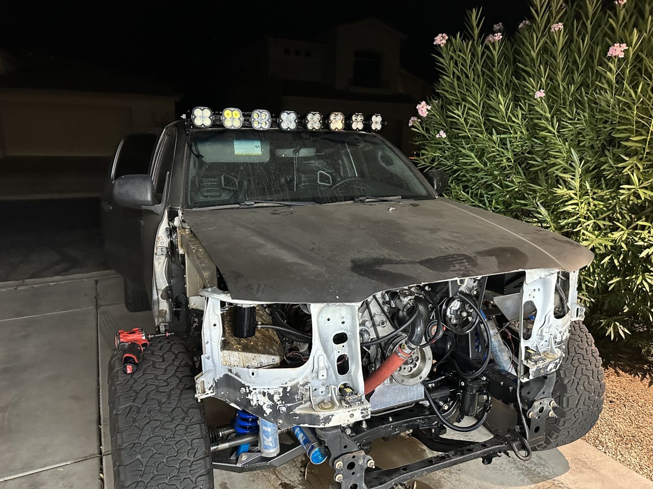

    He's going to do full aluminum skids, front bumper, fiberglass, core support, engine crossover, resi mounts, just the "small stuff" to get this thing finished and looking like a tacoma again.

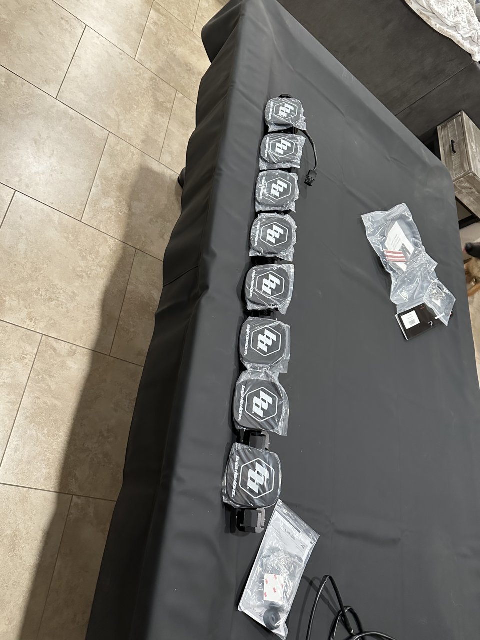

    On todays post of “shit I bought that I don’t need to get the truck working” @Baja Designs Brandon hooked it up and got me a linkable light bar for the Tacoma. Can’t wait to get it on.

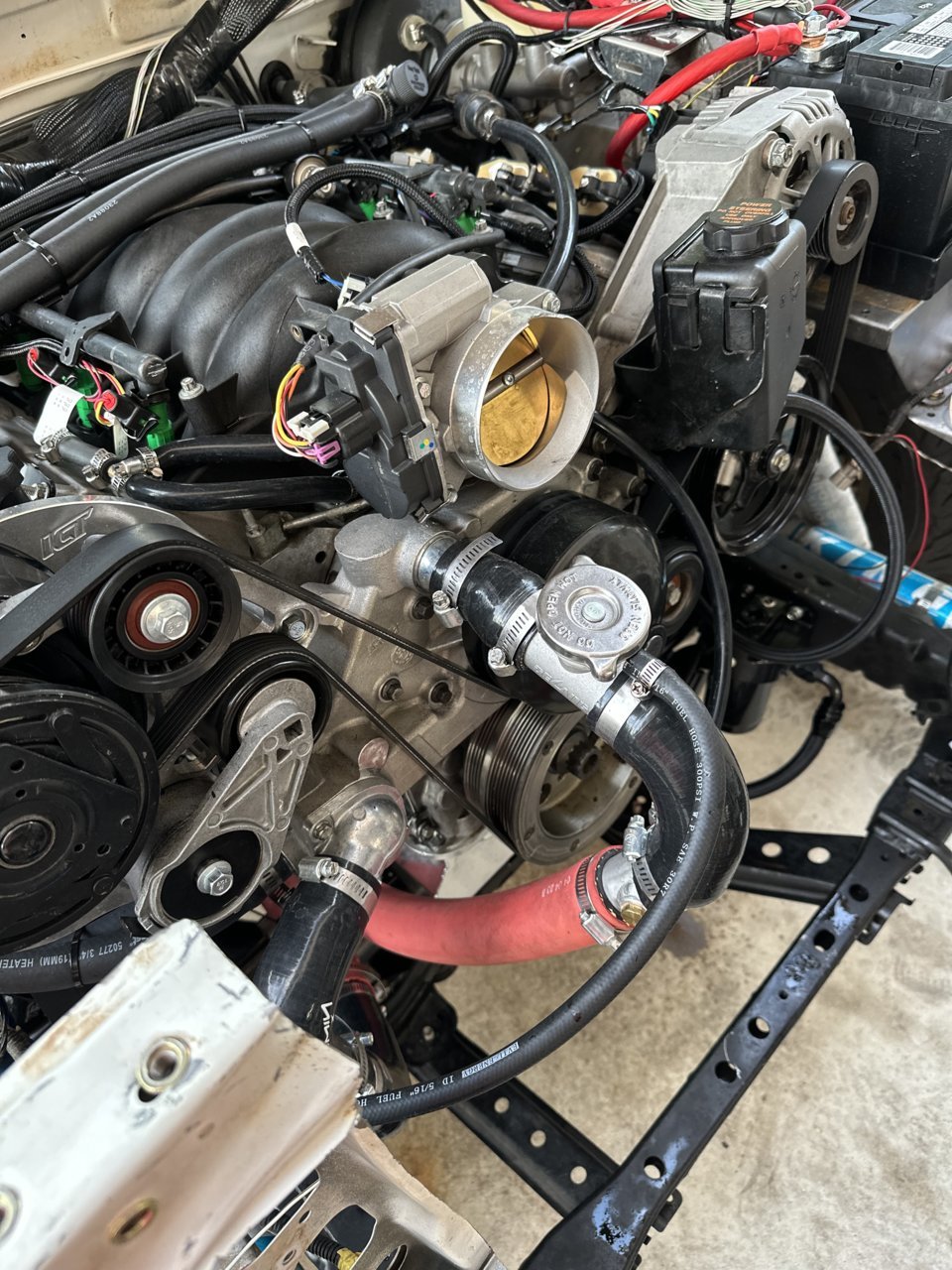

    Fill port on the top of the water pump is all it took. The system sucked down another gallon with this. After that, the cooling system stabilized at 205. Took her on her first real drive, went around the neighborhood a few times, about 10 mins. No issues! I want to have someone remake my power steering lines, the an fittings I have are leaking. Need that, an exhaust, and AC lines made, but man is this thing fun to drive! It’s freaking quick.
    got the linkable light bar from Baja designs installed tonight too. Real trophy truck shit! As if the suspension wasn’t, lol. Anyways, gonna take the truck to the gas station tomorrow and give her a fill up.
    the truck had an issue with hot starts. Whenever it got up to temp, if you shut it off, it wouldn’t want to restart. It would just crank and crank and crank. Lowered the fuel regulator pressure from 85 to 60, and now it hasn’t happened since. I think I was vapor locking the fuel system. The truck got to learn its tune a little bit so it’s not running quite so rich, but it needs an exhaust to really clean the AFR up. T- 1 week to 454 motorsports to make this thing look like a truck again!
