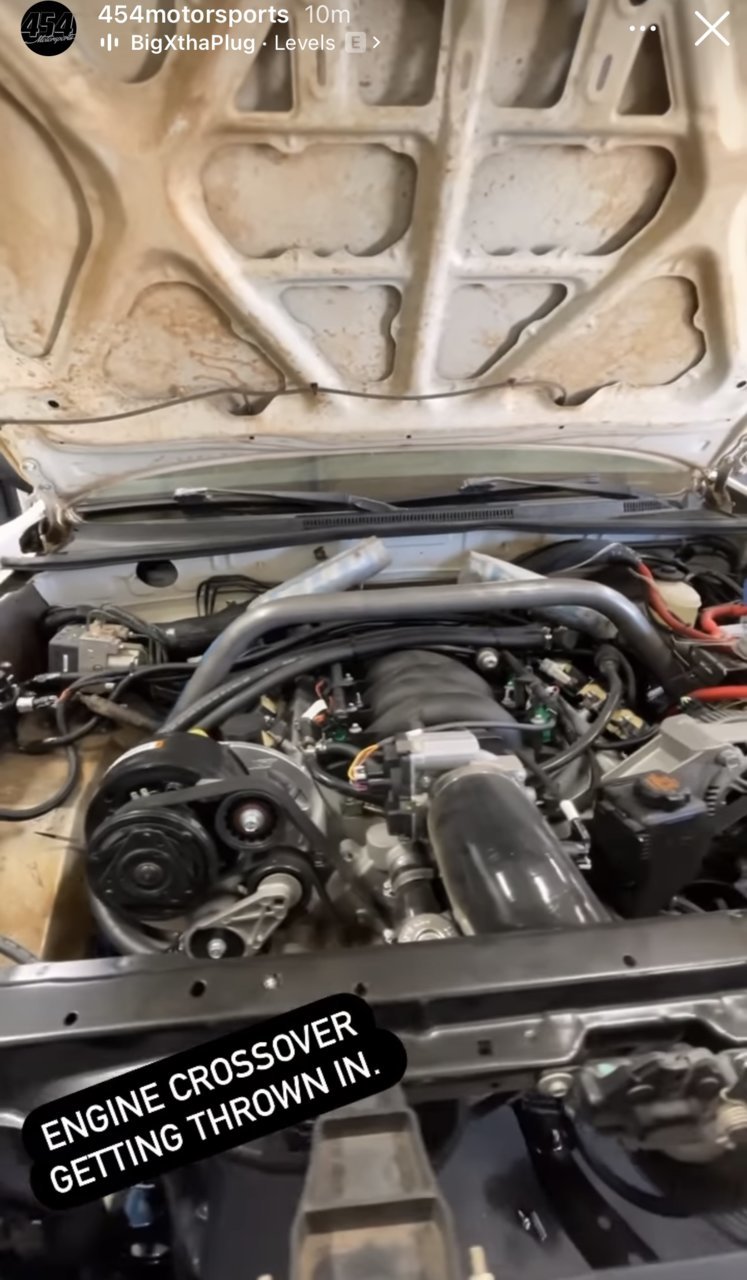

    Getting some rigidity up front!

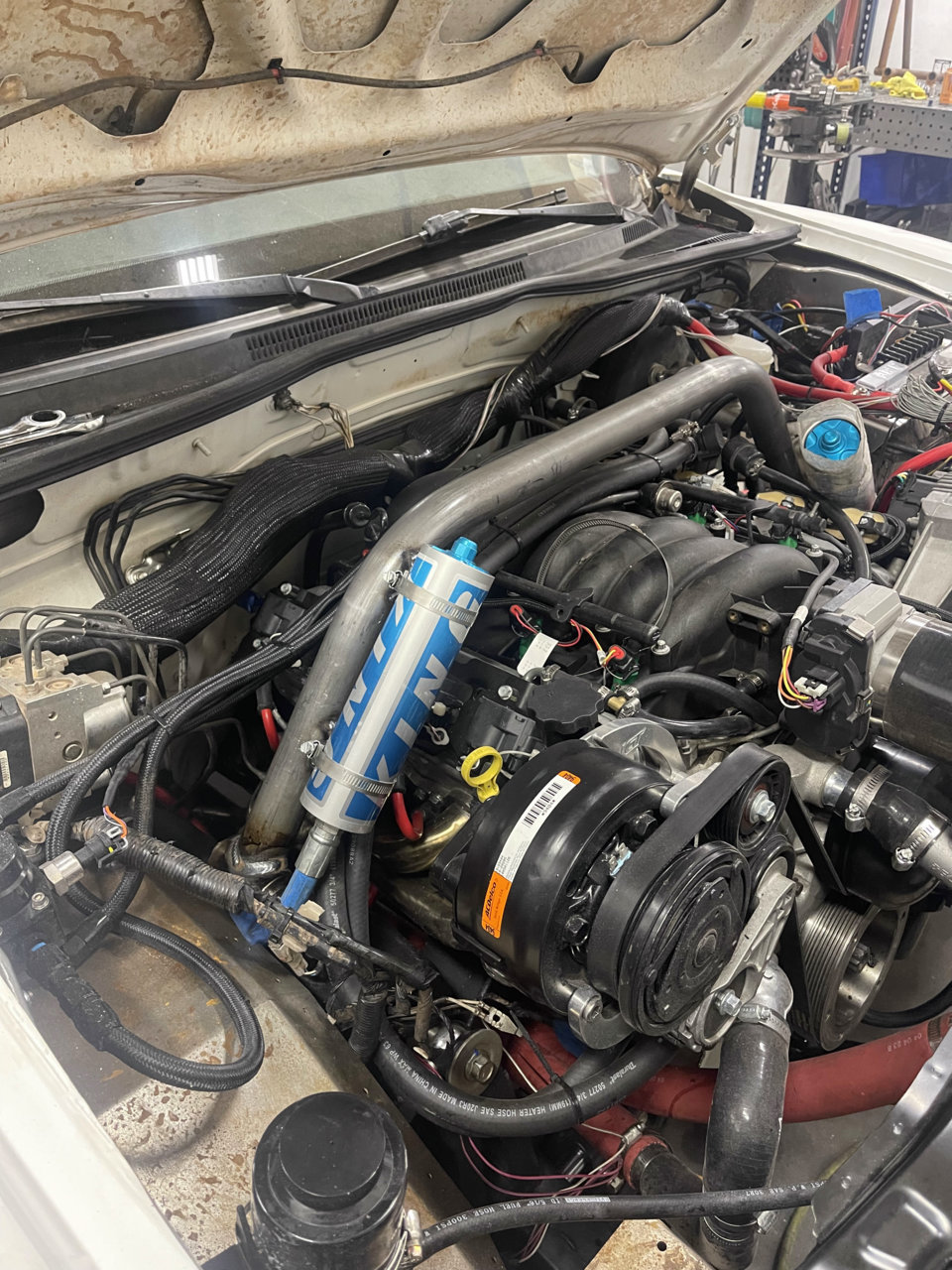

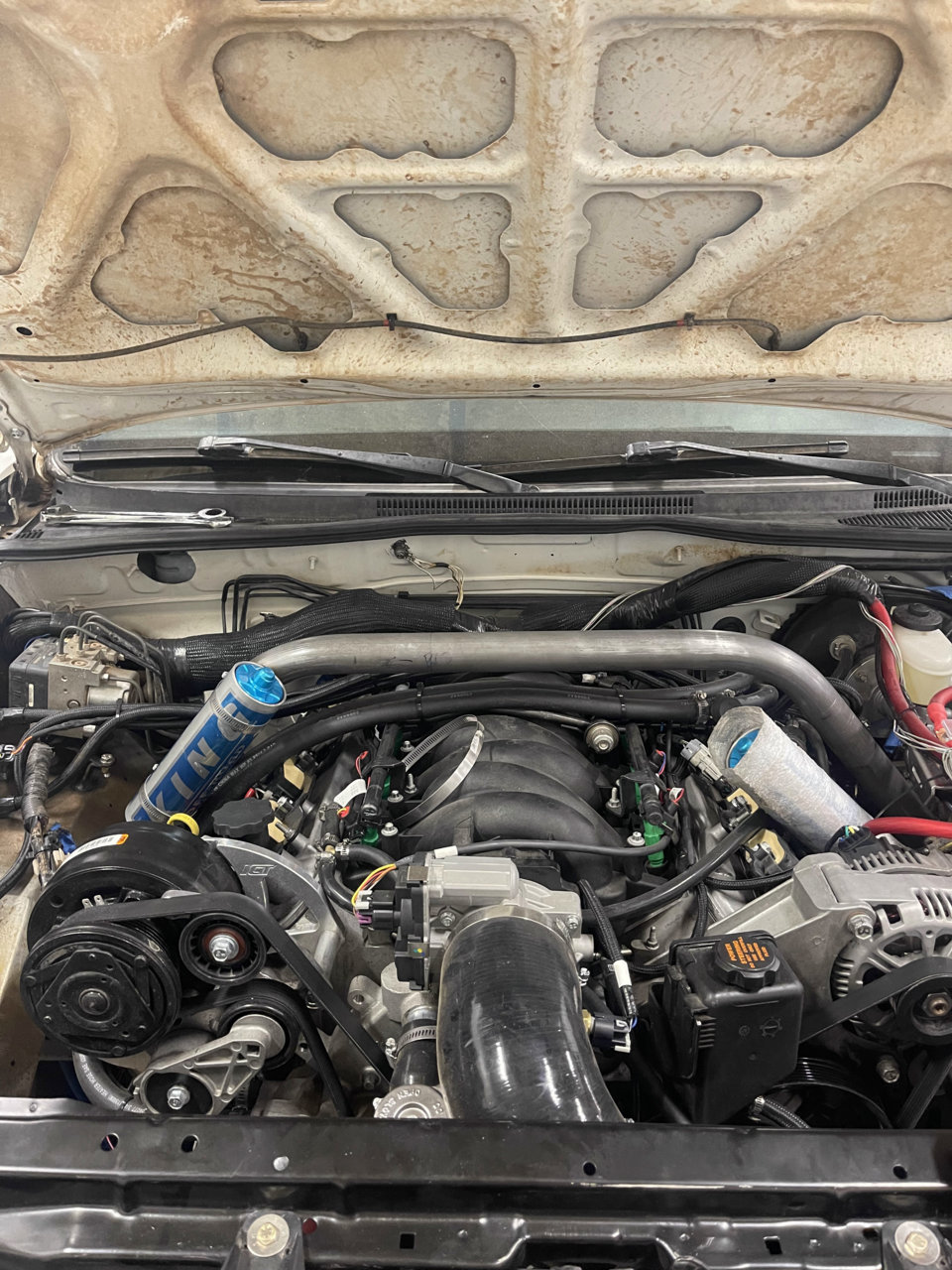

  17. Jul 27, 2023 at 4:12 PM
    #617
    Pittsy
    Pittsy [OP] Ex car guy, currently in rehab
    Jan 20, 2022
    #387923
    2,347
    Davis
    Cave Creek, AZ
    07 DCSB 4x4, 25 Tundra Limited
    BTF Fab +4.5 - DMZ SUA - TE Cage - LS6 Swap
    I forgot to mention this here, but when the motor comes back out, Im going to take the time to fully remove the factory engine harness. I Was excited to get this thing running so I just chopped the connector and got everything out of my way. Since its gotta come out, might as well make it look super clean.
