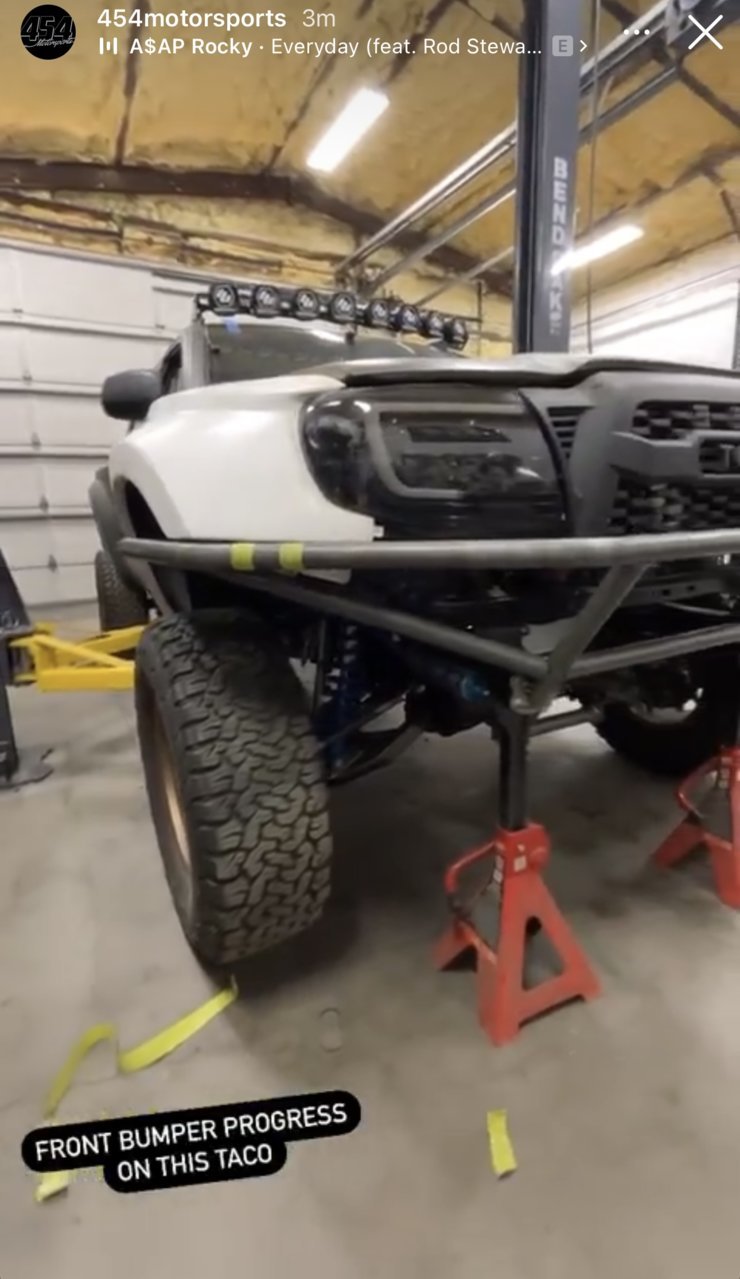

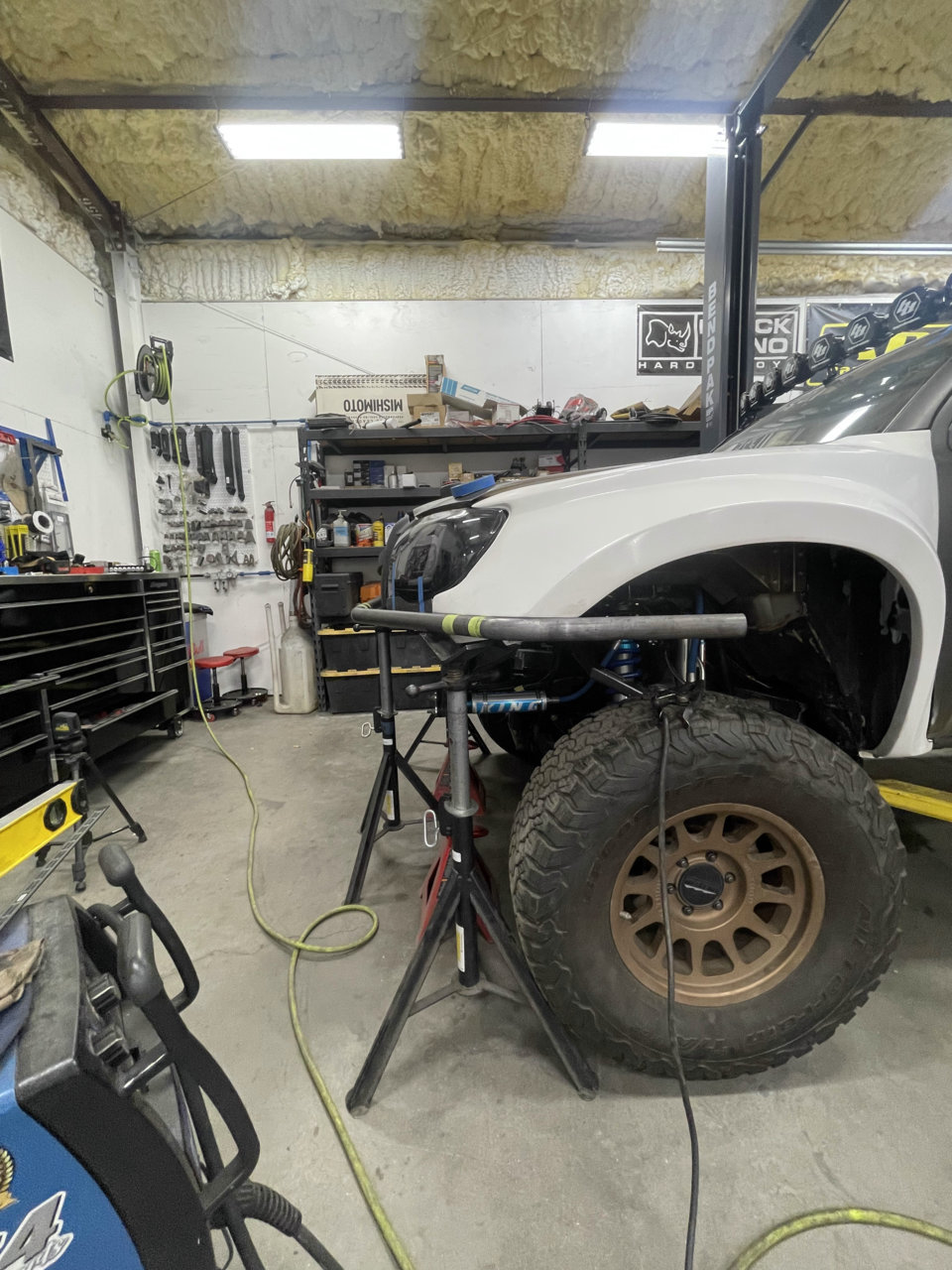

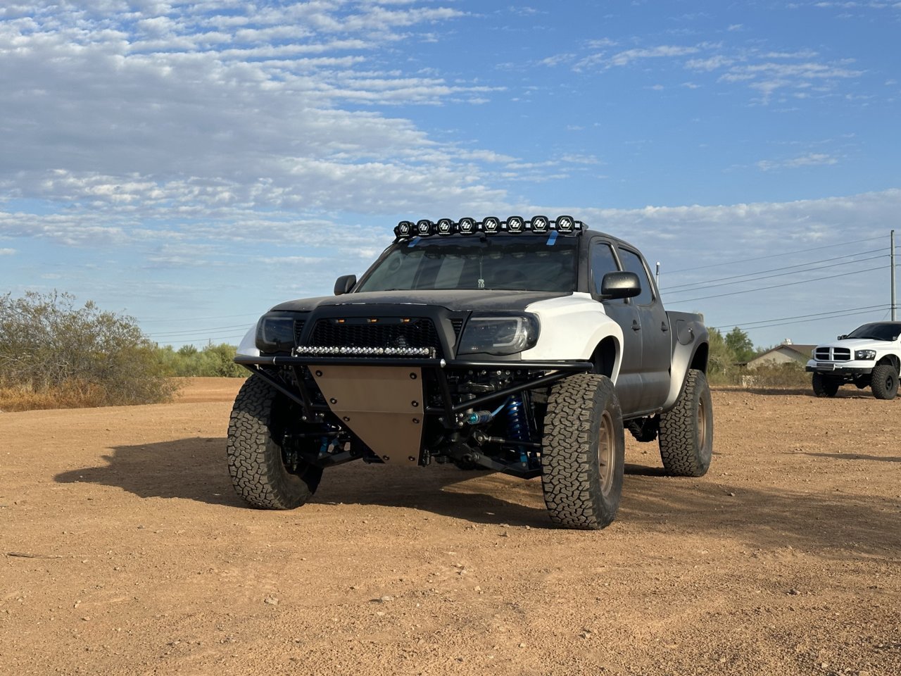

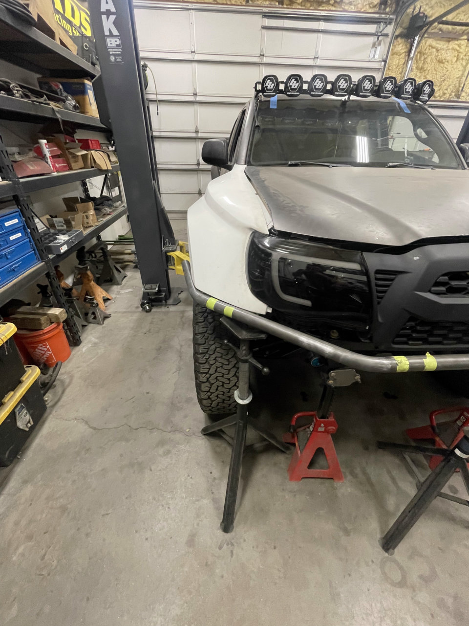

    Making headway! This bumper looks sweet so far.
    Im hoping when I have the truck back that I'm able to pull the motor straight up and out and leave the transmission in place.

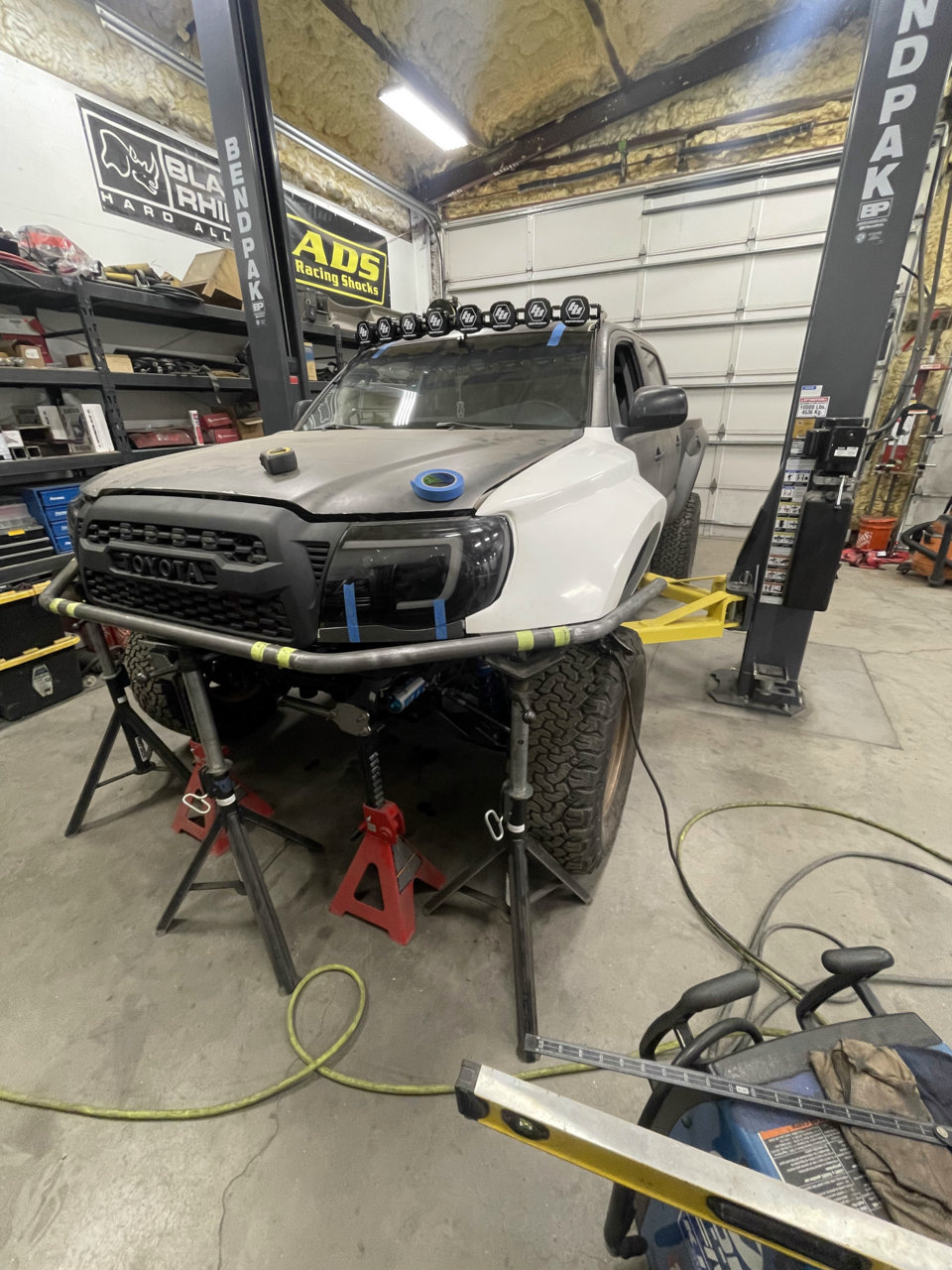

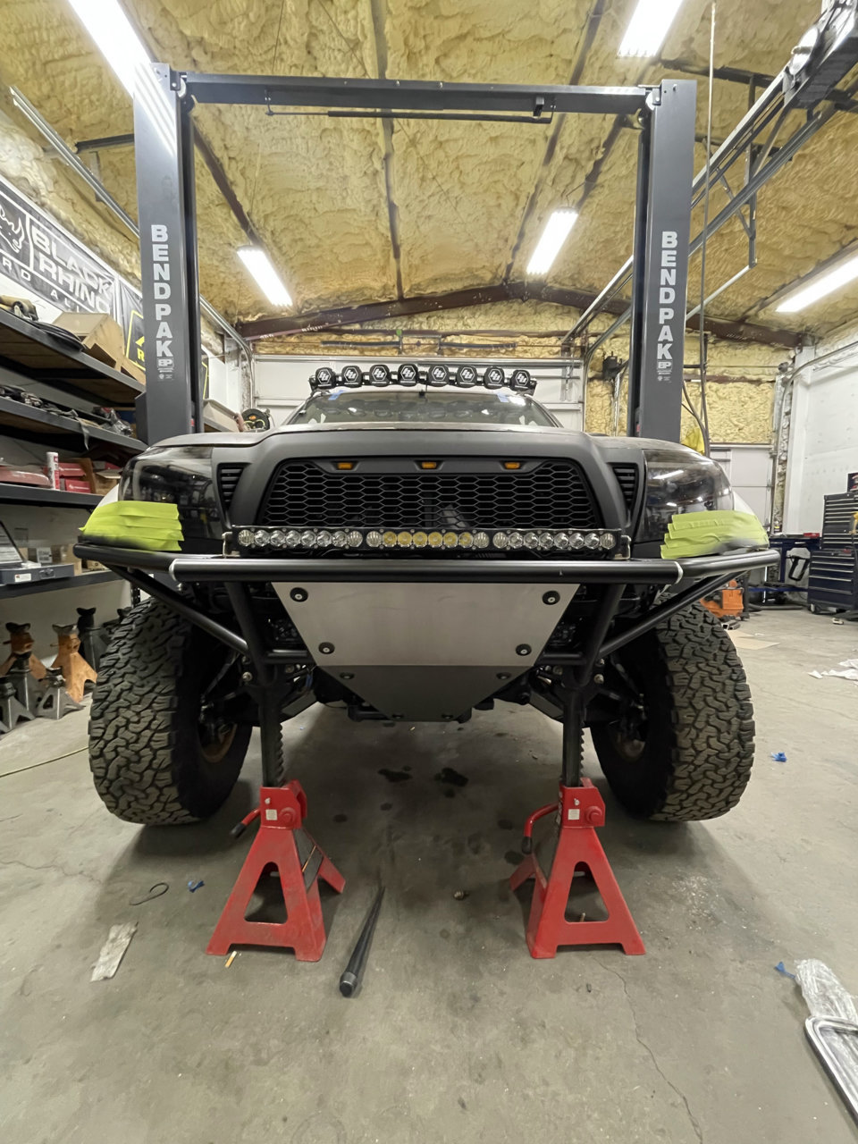

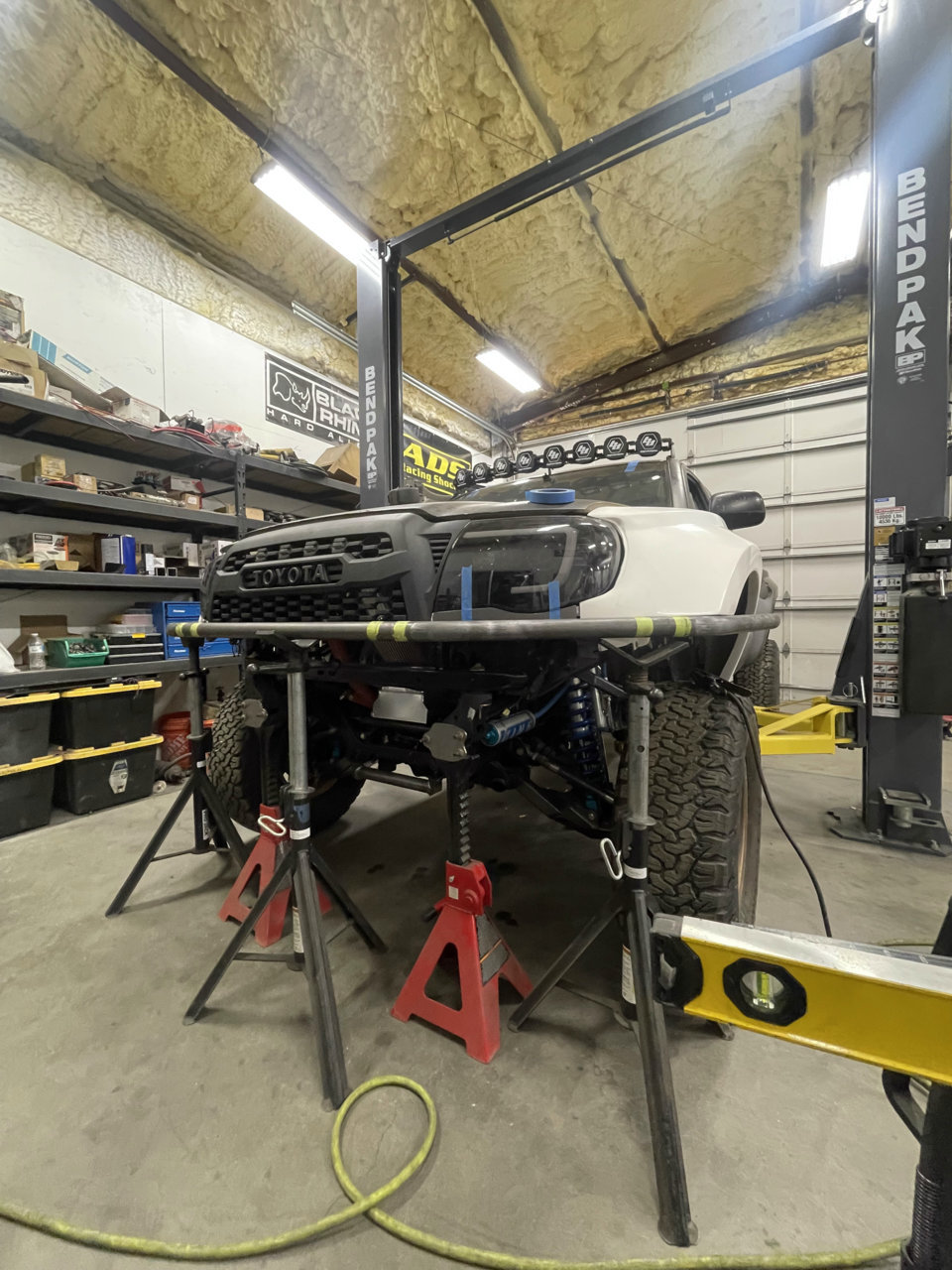

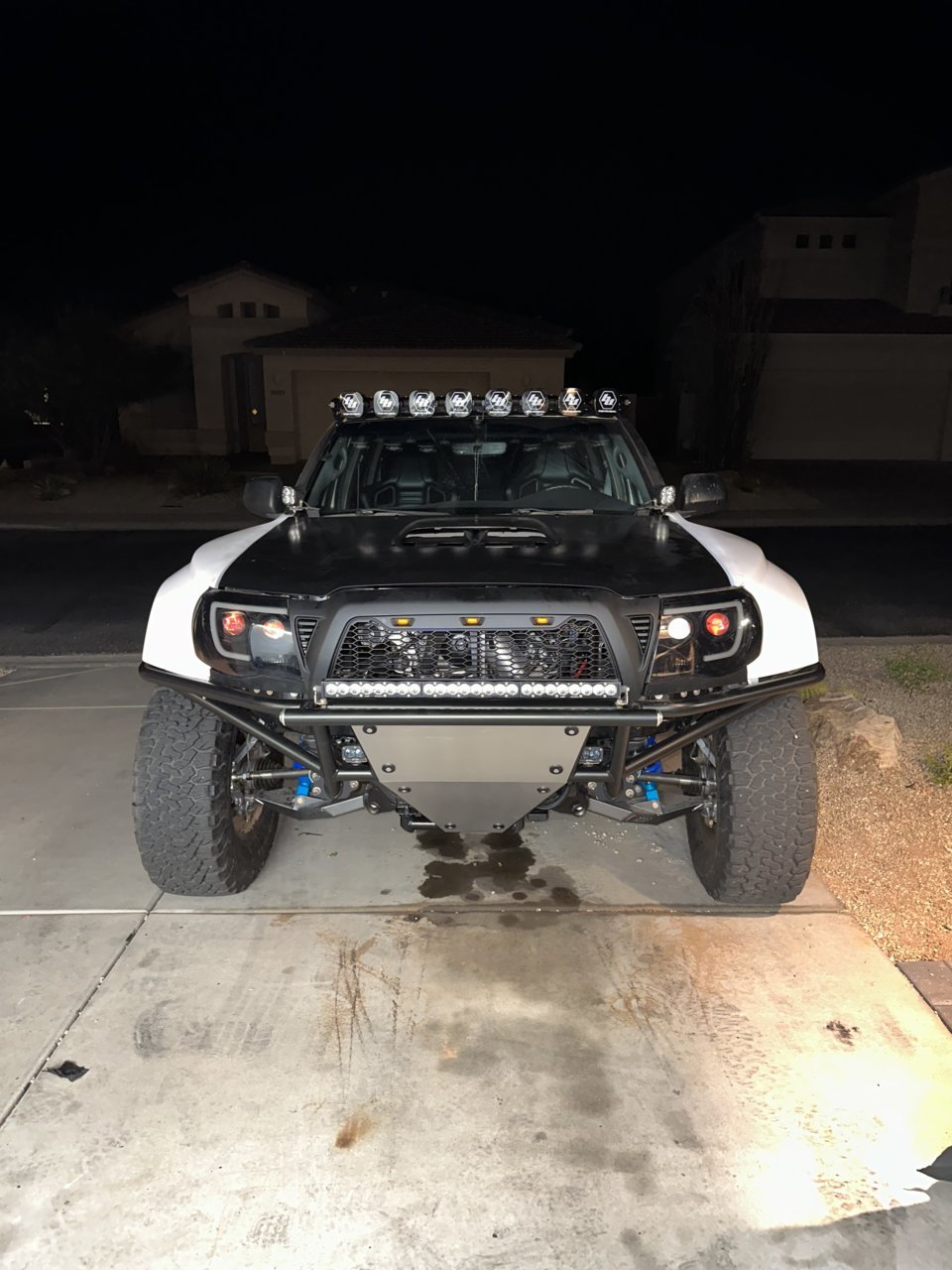

    This thing looks so freakin cool. Off to powdercoat.
    MarX, AllTacosFloat and Hayden334 like this.

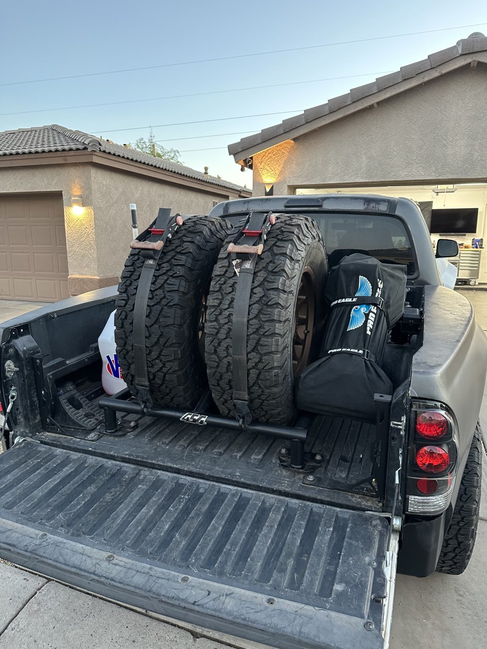

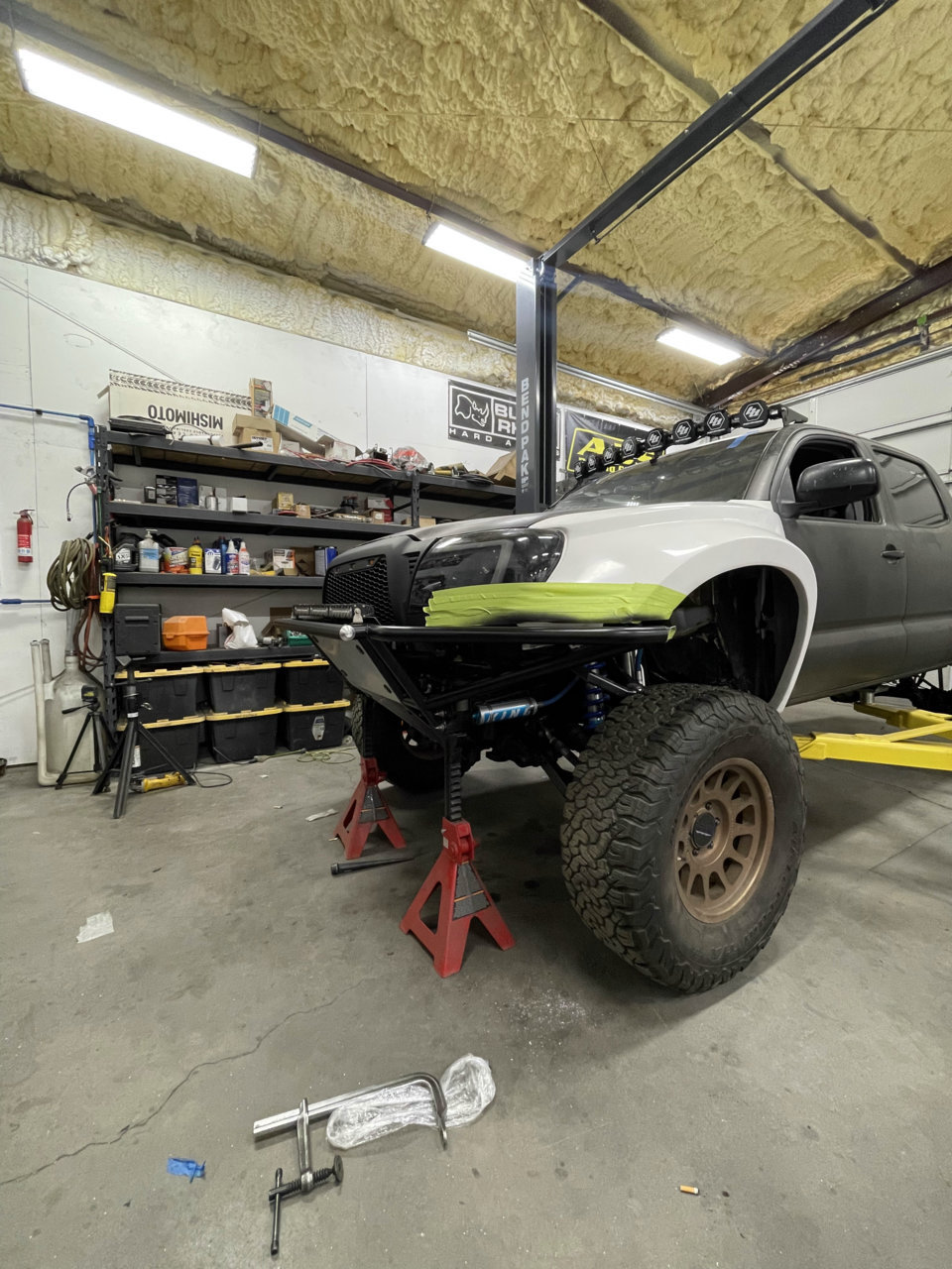

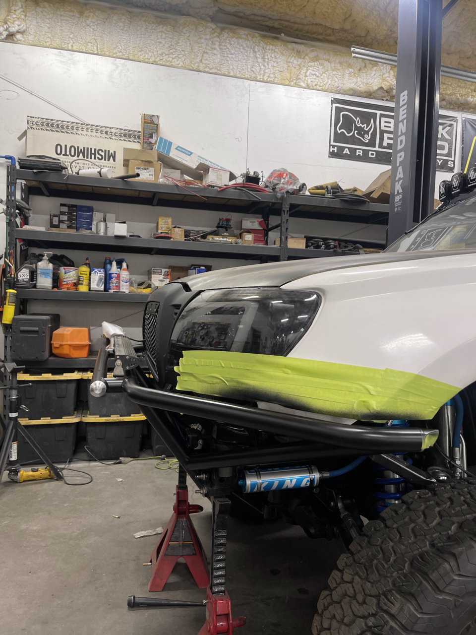

    Bumper all wrapped up. This thing is so cool. I haven't seen a single bumper for a 2nd gen that looks as cool as this one imo.
    MarX, TireFire, Hayden334 and 6 others like this.

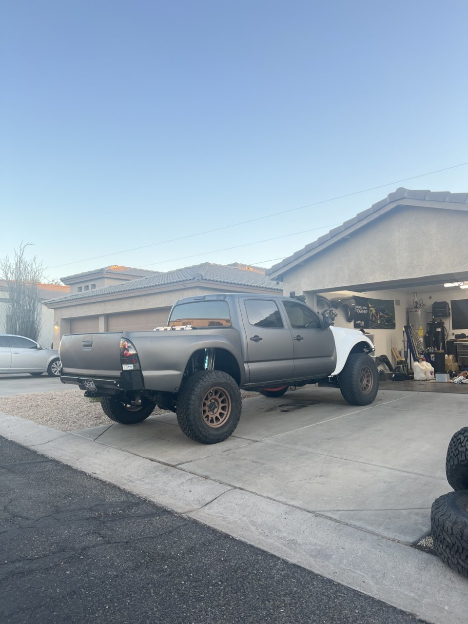

    Picked her up today!
    Going to take care of some things, like the transmission harness, rear fuse box, all the small stuff I can accomplish here at the house.
    once it’s done, I’ll tow it over to my friends shop to pull the motor and reseal it. Hoping it’s not gonna be too bad. I’m so excited to drive this thing for real!

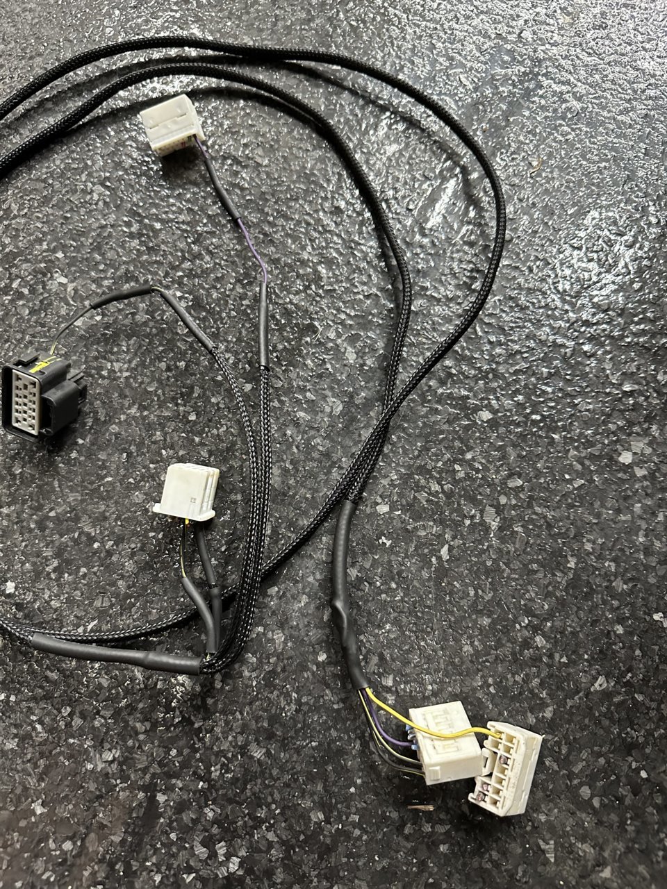

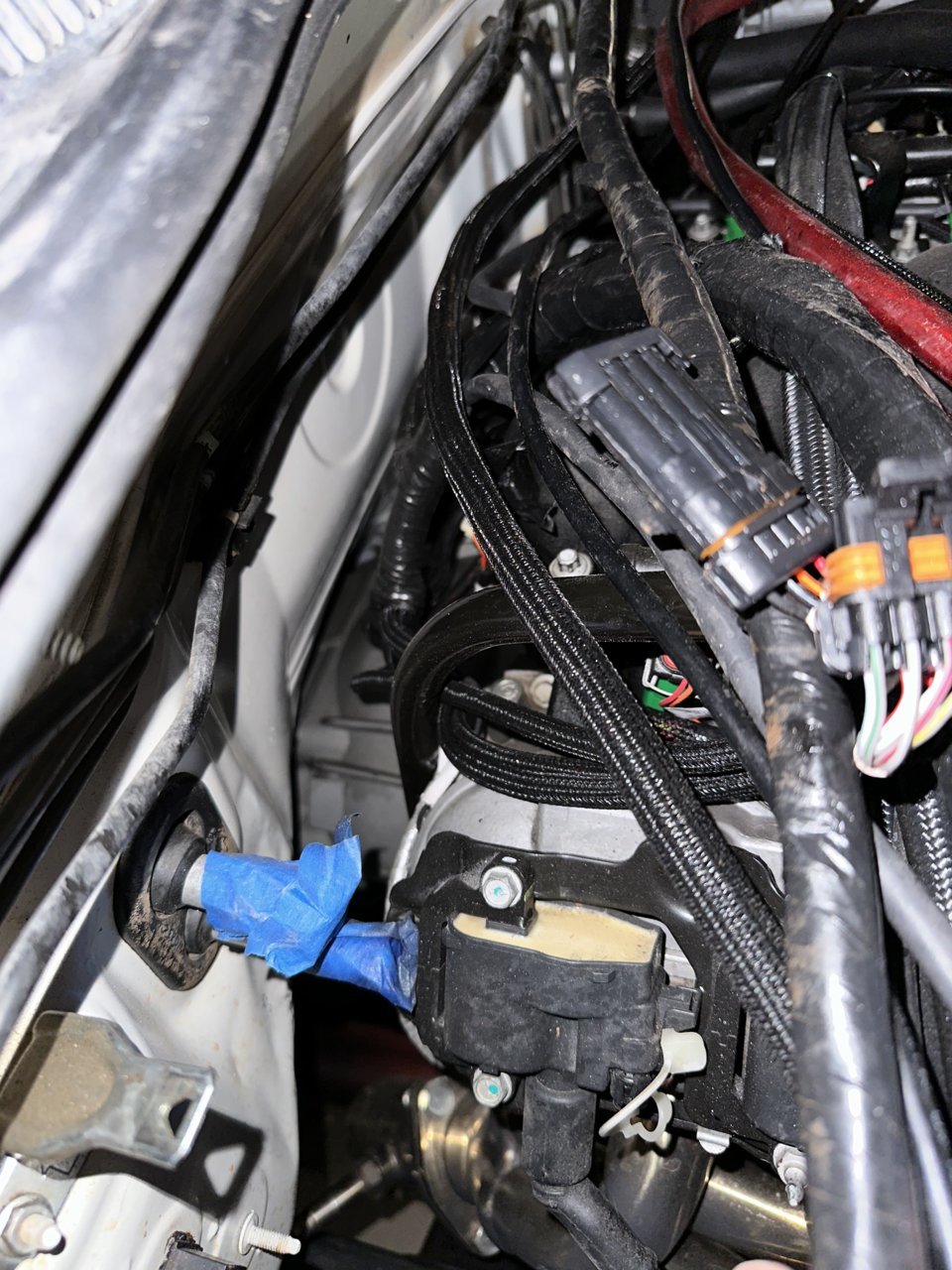

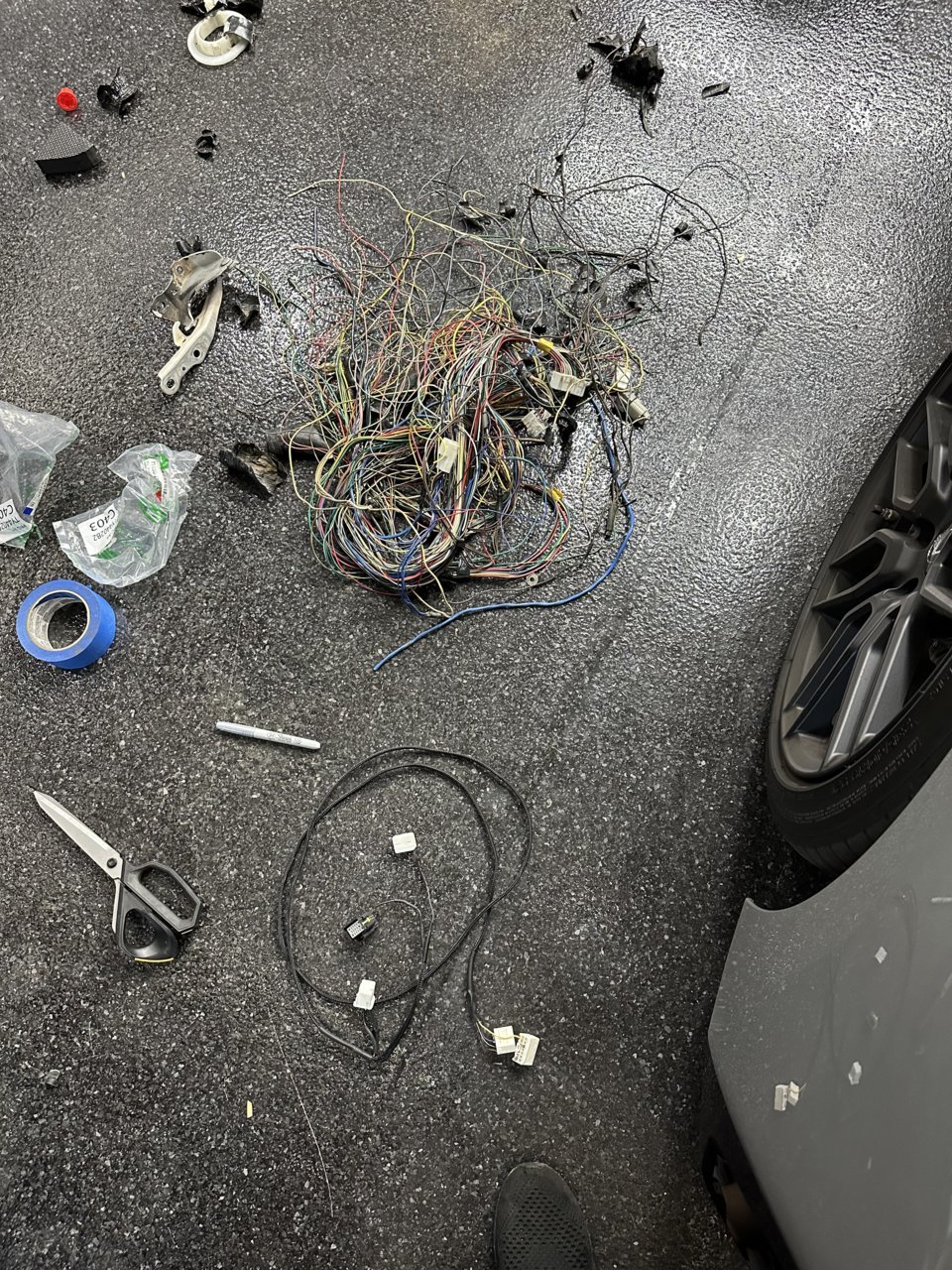

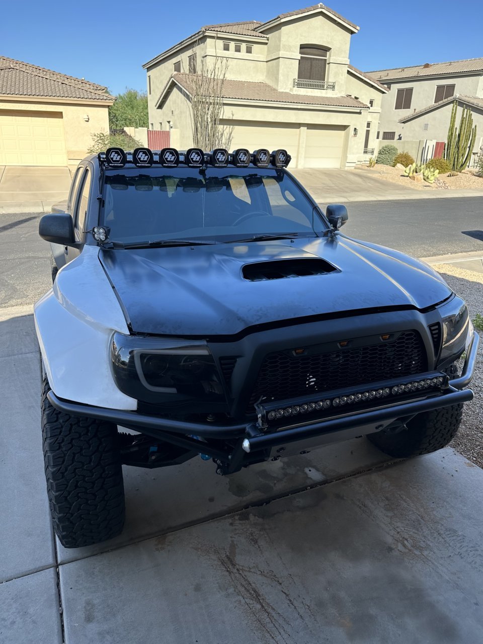

    Started the evening off with installing the new hood hinges, sport hood, and Baja designs squadron pro ditch lights. Really pulls this truck together.IMG_5654.jpg
    After that, I pulled out the pre-2009 transmission harness. While I was at it, I also removed the Holley harness, and the factory 4.0L engine harness. I turned this giant rats nest of wires:IMG_5658.jpgInto this:IMG_5659.jpgI had that giant bundle of wires all for 4 conductors. Now it’s all meshed and looks great.
    @hayrider2.0 here you go:
    And here’s where I left off:
    Still need to organize the rest of the Holley wires, probably going to use some Tesa tape, can’t think of a better time efficient solution. Meshing it isn’t a possibility, unless it’s some split look but that stuff is kinda garbage. We’ll see what I go with.
    I found the correct Holley software I need, and I’m able to add the 4L75E to the handheld from my laptop. Waiting on a USB type A to USB mini to get here. Not sure how I don’t have one of those. Really hoping that works. If it does, I might just go jump this thing, even with a leaking rear main.

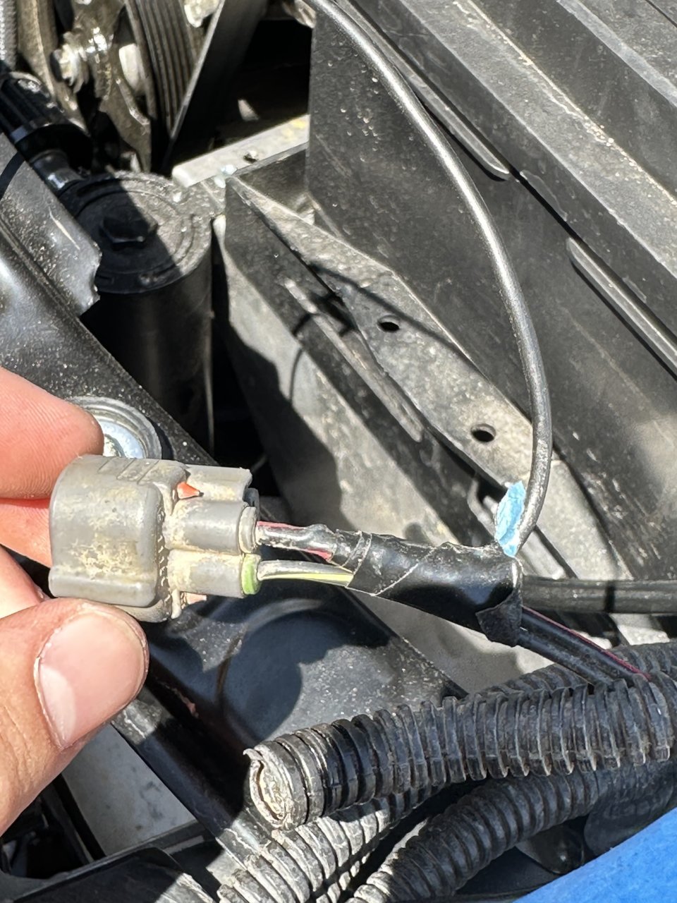

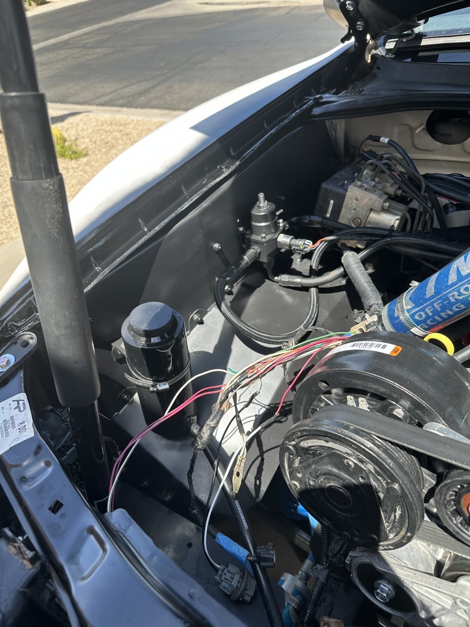

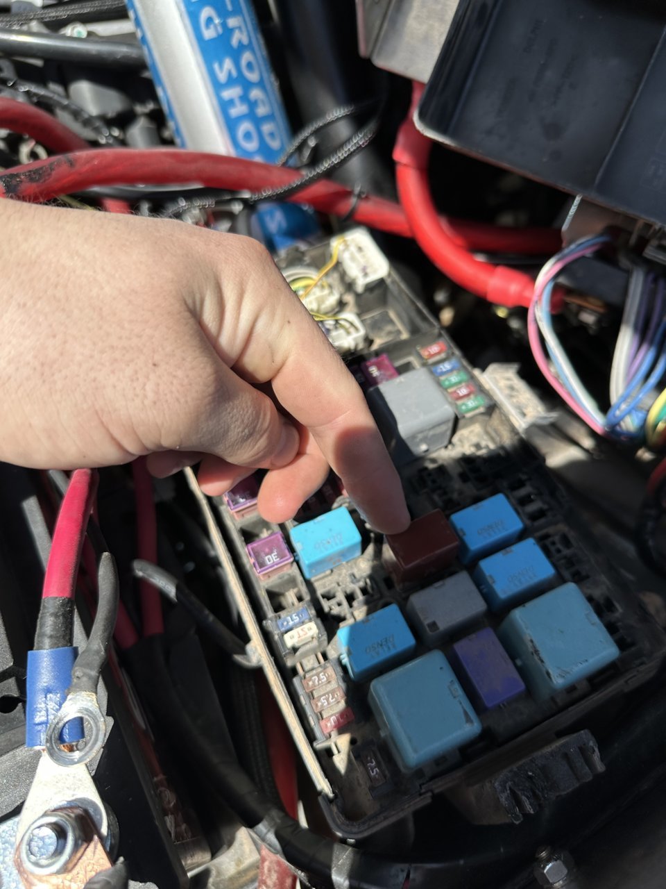

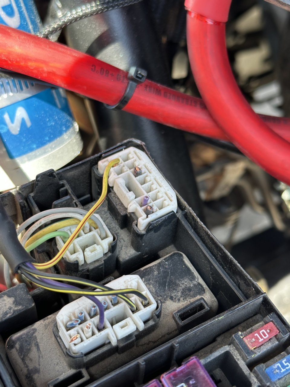

    @Dm93 helpppppp
    after depinning all the unused wires, my fuel pump won’t kick on anymore. I’m not sure why. There also a hum coming from my engine bay fuse box now, kinda sounds like a 172 stall horn. Could that be related? My only guess is I got rid of some common ground. Any ideas?
    One thing I did notice is that wire I tapped into next to the headlight for the fuel pump resistor, to give the fuel pump power all the time from the Holley, is the same color as a few of the bundles I see in the rats nest I pulled out.

    @Dm93 IMG_5672.jpgIMG_5673.jpgbetween each of those black with red stripe wires in the fuse box and the black with red stripe fuel pump resistor wire, im reading 324 ohms.

    This brown/red relay is the one buzzing, looks like it’s the fuel pump relay. Any reason why it’s buzzing now? Did it simply fail? Or could it be a grounding issue? How do I resolve it?

    Mine did the same. (efi) according to the 4cyl fuse box. I just removed the relay and tossed it

    But my fuel pump used to work, now it doesn’t. Not sure.

    Um, it just started working. Lol.
    pulled the noisy relay out.
    got the Holley updated to V6 from v4, got the correct trans selected. Need to get stuff buttoned up before I start to drive this thing, but not a whole lot left.

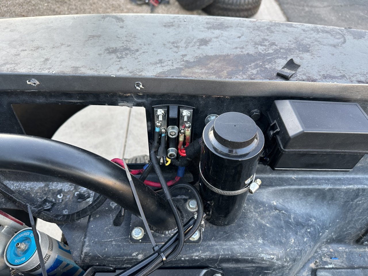

    I rewired the rear fan setup. I threw it all together with lose relays to get it working, but in my dyslexia, I used the IAC and AC kick off wires instead of fan 1 and fan 2 from the Holley, which is why they just ran constantly. Fixed all of those and meshed the wiring, made it super clean. Added a relay and fuse box, plus a bus bar for the bed electronics. I can also jumpstart the battery from the back now which is nice.
    I forgot to cut the zip ties, but I’ll do it tomorrow lol.

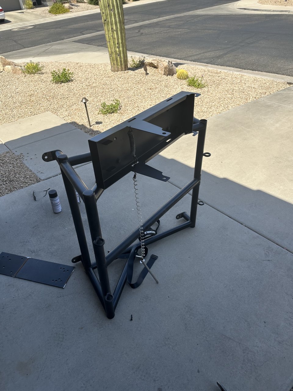

    I also took the bed cage out, cut off the old jack plate mount, and added some spacers for the new one that 454 welded onto the side since the radiator blocks the old mounting point.
    It looks so nice back there now.
