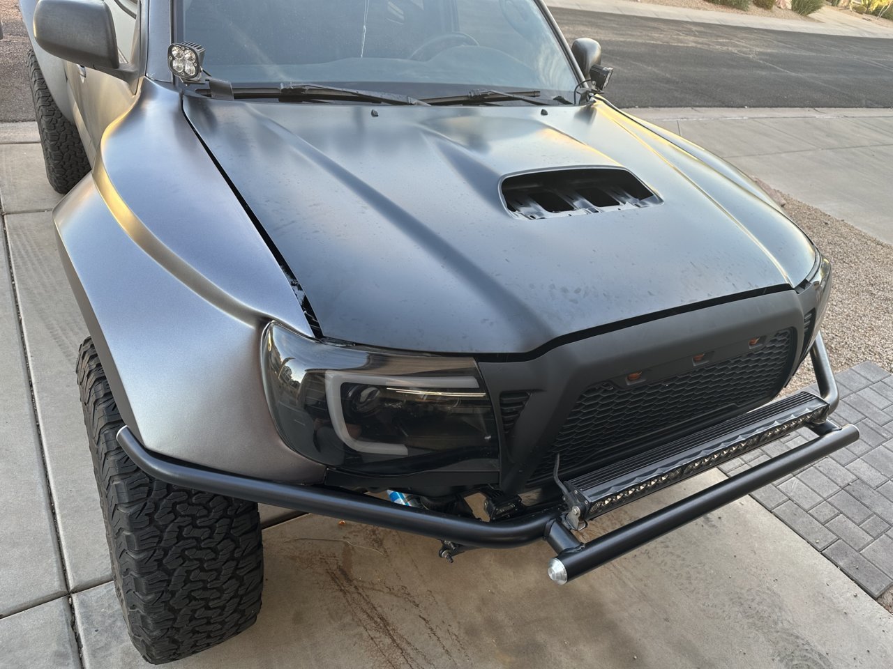

    fenders wrapped to match the rest of the truck!

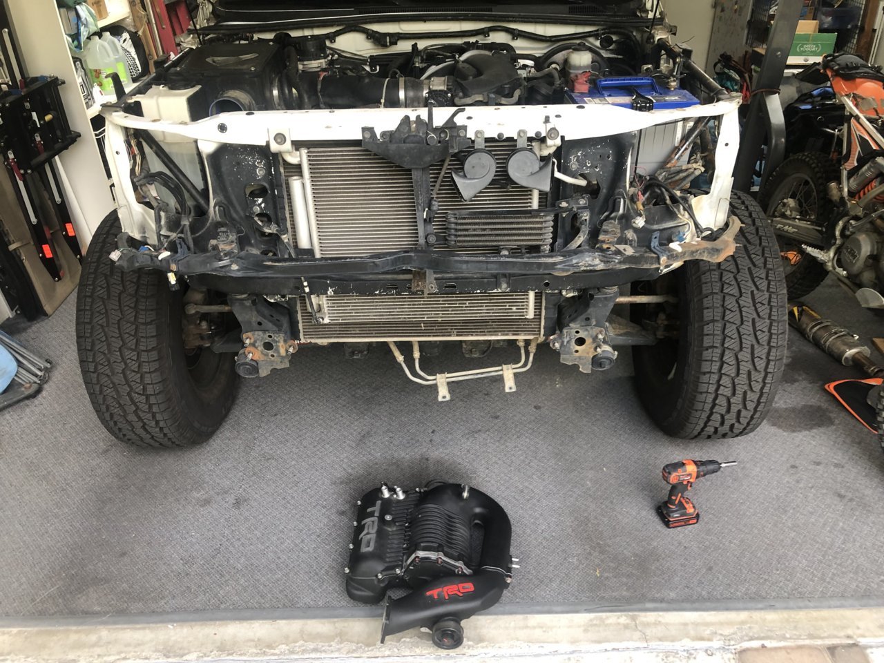

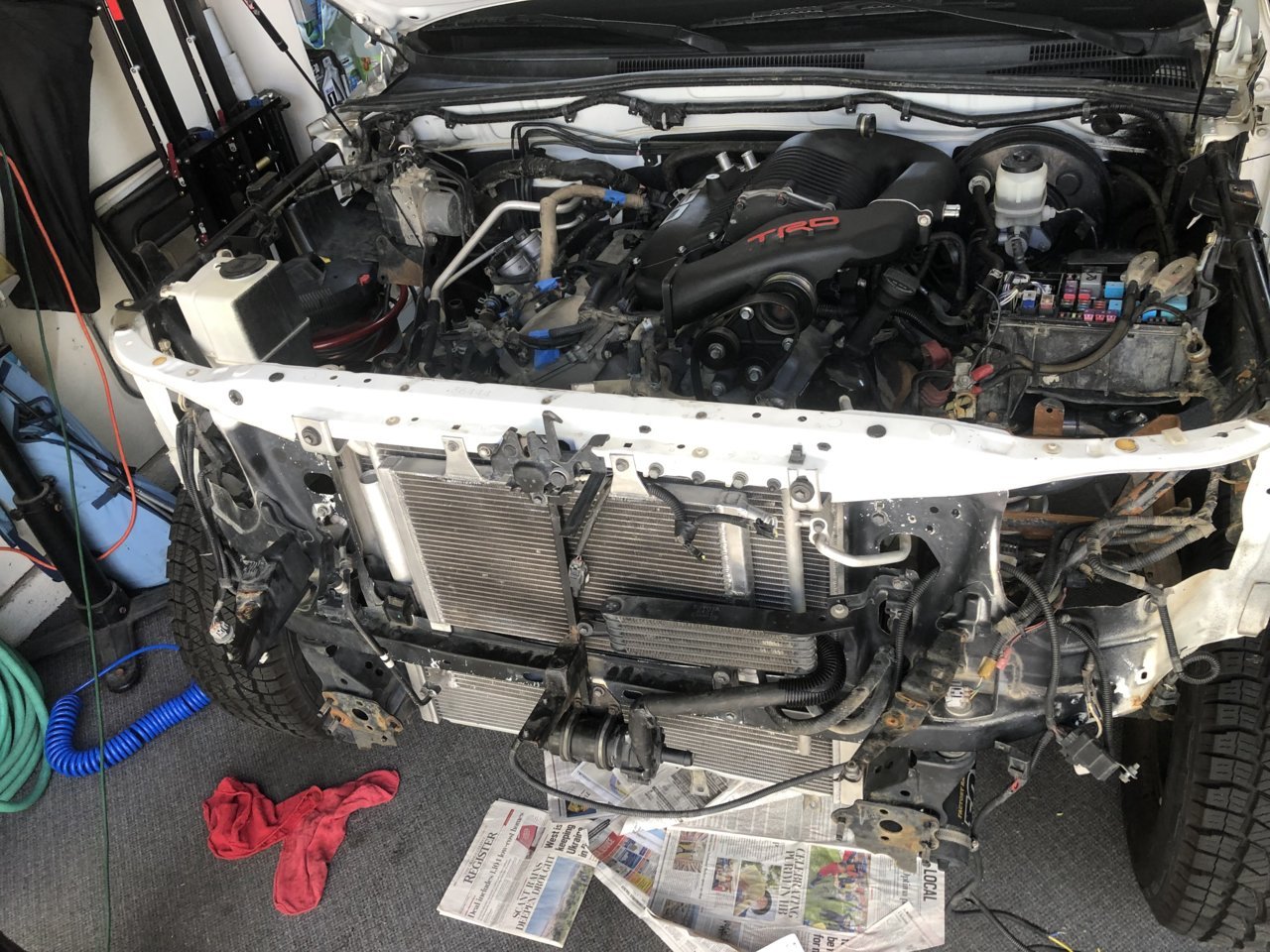

    Can someone with a stock 4.0 and a stock front end send me a picture of how their condenser is mounted?
    thinking about moving back to the grille.
  13. Aug 13, 2023 at 8:51 AM
    #653
    Sterling_vH111
    Sterling_vH111 Go do something real instead.
    Oct 4, 2015
    #165793
    2,989
    Sterling
    socal
    2012 DCLB Prerunner V6
    Secretly Long Travel & Supercharged
    Mostly stock ish. This help ?
    edit: second picture has a CSF radiator and the supercharger intercooler that sits in from of the oem ac condenser.
    Torspd likes this.

    yeah,
    I’m trying to see if I have enough room to mount it between the intake and the condenser. I think I will. Just sucks it won’t have airflow unless I’m moving.

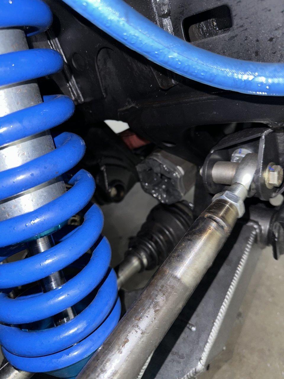

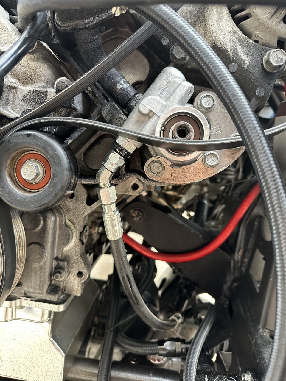

    Automotive Hoses came by and made me a new pressure line for the power steering, now no more leaks!
    Drove the truck over to Royal to have the coolant hard lines made, first trip on the interstate. Everything was fine until the end int the parking lot. Went full lock backing up and popped an axle.
    Hoping it’s as simple and putting it back in and rebooting. Not sure why it popped because everything cycled correctly.

    Eeew. Sorry to hear.
    Should be an easy enough fix for you. Including some steering stops too I guess.

    The thing is I still have the OEM steering stops, maybe because of having such different geometry with the steering system. Once I have the truck back again I’m gonna jack it up and go lock to lock and see what’s going on.
