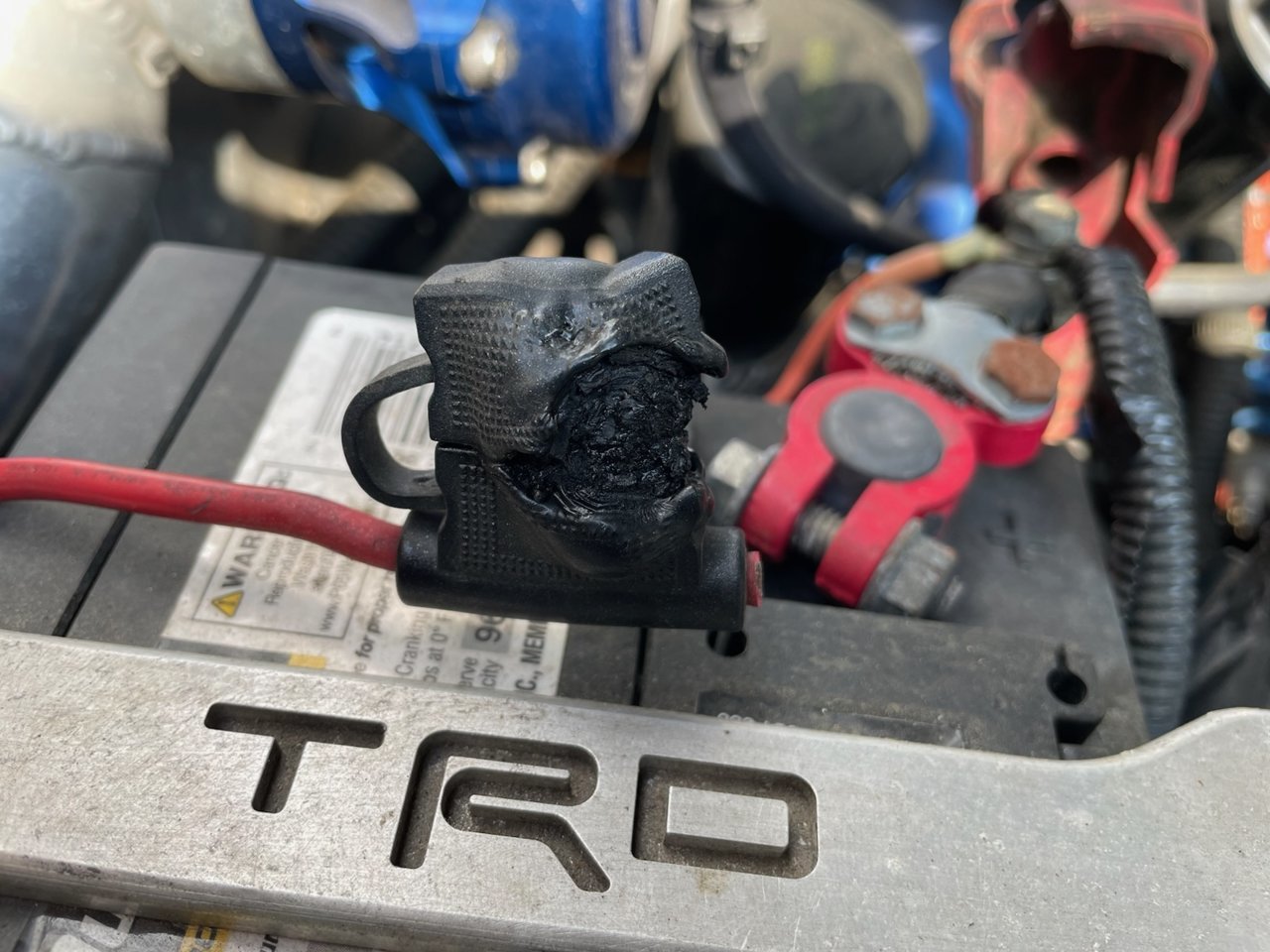

    With these fans that high starting current may melt connections, plugs, and/fuse holders. If that happens, then look into one of those PWM controllers.

    Hopefully not, They should design those fans with integrated soft start circuits. I need to put a circuit breaker going to the rear connection, I haven't done it yet, but need to. I dont like the fact that that length of wire is unprotected right now. There's fuses on the fans and relays, but if the wire dead shorts, its unprotected.

    I hope not as well. Otherwise it looks like this.

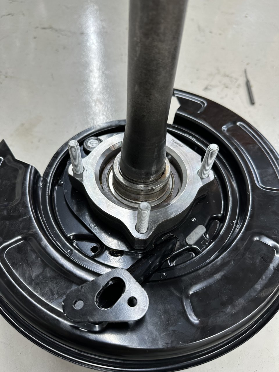

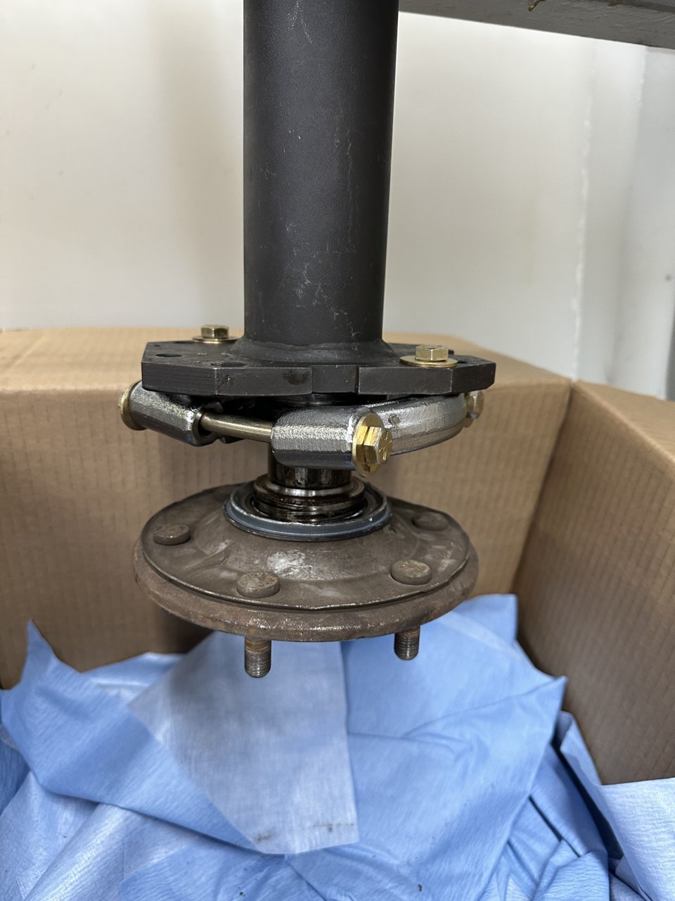

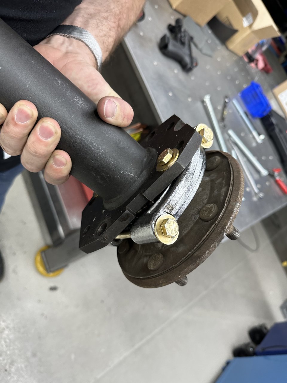

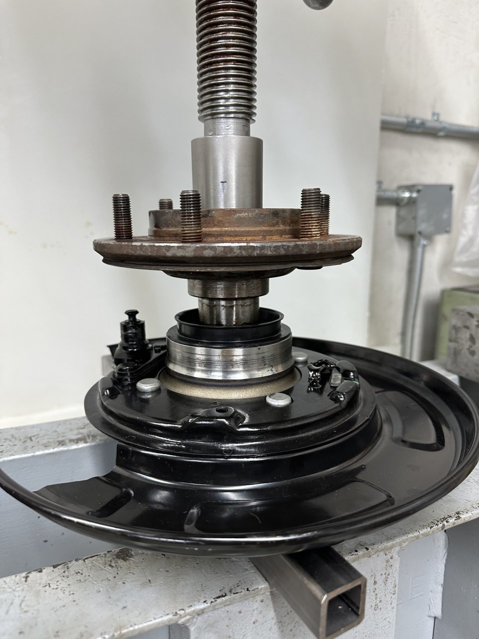

    Thought I was making excellent progress now that I have all the correct tools for the job. Got the axle out and the bearing races off and reassembled. Got back to the truck and…
    First of all, Fuck Pedders. None of their instructions are coherent. The new backing plates come with the parking brake installed. You have to remove the parking brake to press the new studs in. They don’t mention that you need to immediately reinstall the parking brake afterwords, before you press the axle in. Once the axles in, you’re unable to install the parking brake.
    so now I’m on my way to 24 hour autozone to go get new bearings since these ones will break when I press the axle back out. Cars and trucks are pain, I hate it all. I’m losing my mind over this brake kit.
    I’m going to make a detailed write up here on the correct process on installing this, because this is fucking bullshit.

    I ended up getting the passenger side done, but the driver side bearing race will not come off. I keep snapping the bolts holding the race removal tool to the press tool. Tried torching it, no luck either. Bought some better hardware to try again tonight, and if that doesn't work I have one more idea. I will never recommend this kit to anyone ever.
