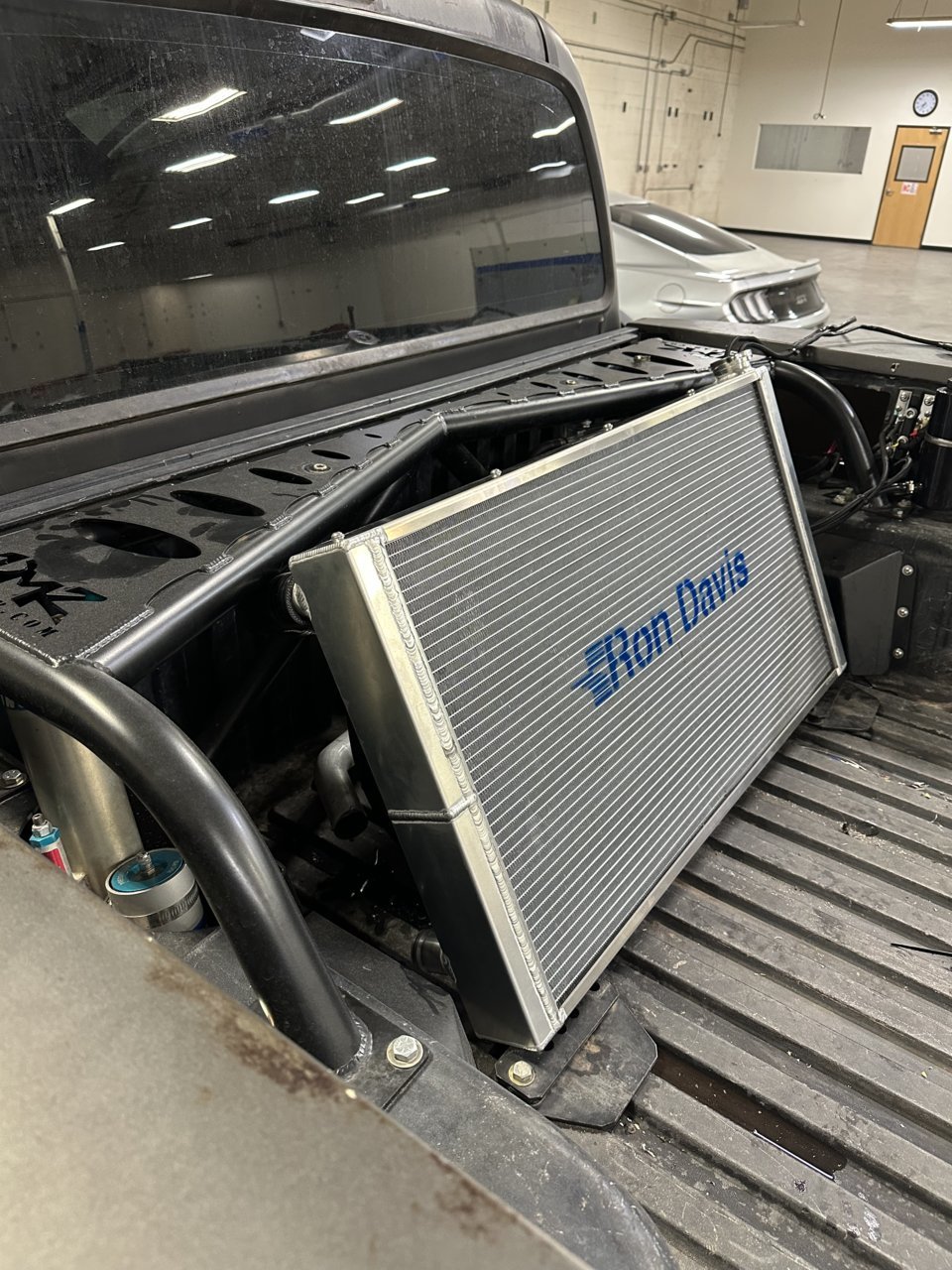

    Give them a call though. Make sure. My first front mounted Ron Davis started leaking after a few years, due to the flexing of the front end. After contacting them, I learned that my purchased radiator was meant to be mounted in a very rigid location. Not in front of the engine where the the chassis flexes a lot. They made me a new one for the front that matches the OEM mounting, and that has now been working perfectly.

    Well im sure it'll need rubber isolators no?

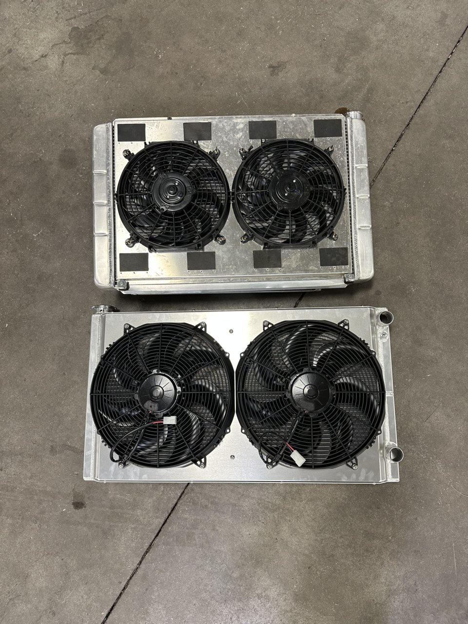

    And the last radiator, I mounted it using the fan shroud and radiator flanges. Whats the better way?

    Called them, they reccomend a u channel structure lined with 40 durometer neoprene. I wish my fab skills were better...

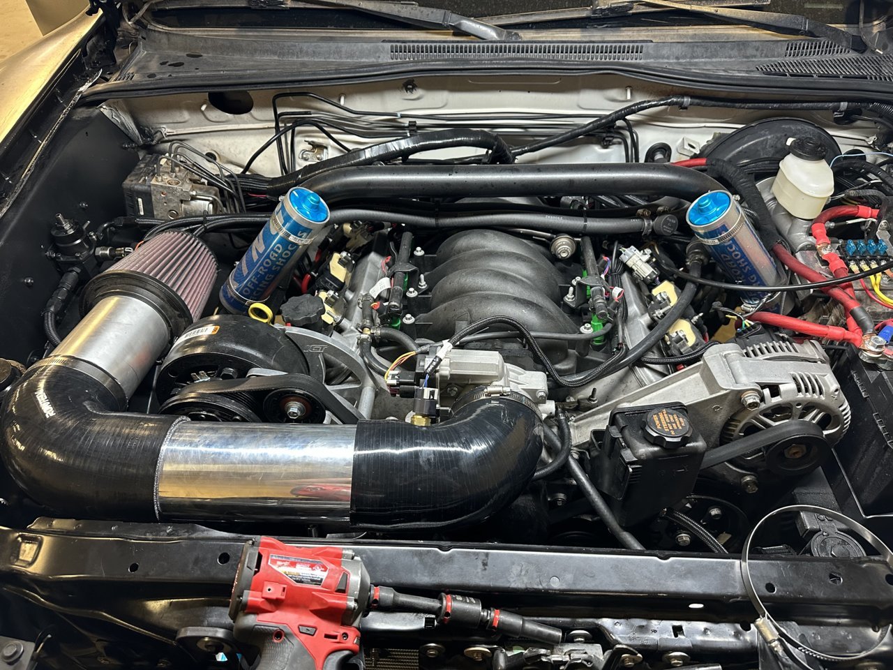

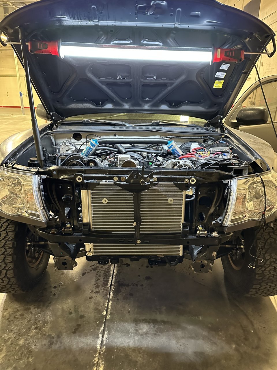

    Just enough room up front for the condenser.
    You vs. the guy she told you not to worry about.
    Working on a solution to mount this up.
    Waiting on some clamps, but the intake wraps around to the side now since the condenser is there.
    Another thing I didn’t take pictures of, I got rid of the ghetto Lokar shifter, and picked up a nice winters shifter like the real trophy trucks, lol. But now it shifts so smooth and the engagement is perfect. Just need to build a center console now, lol. Idk how to do that yet.

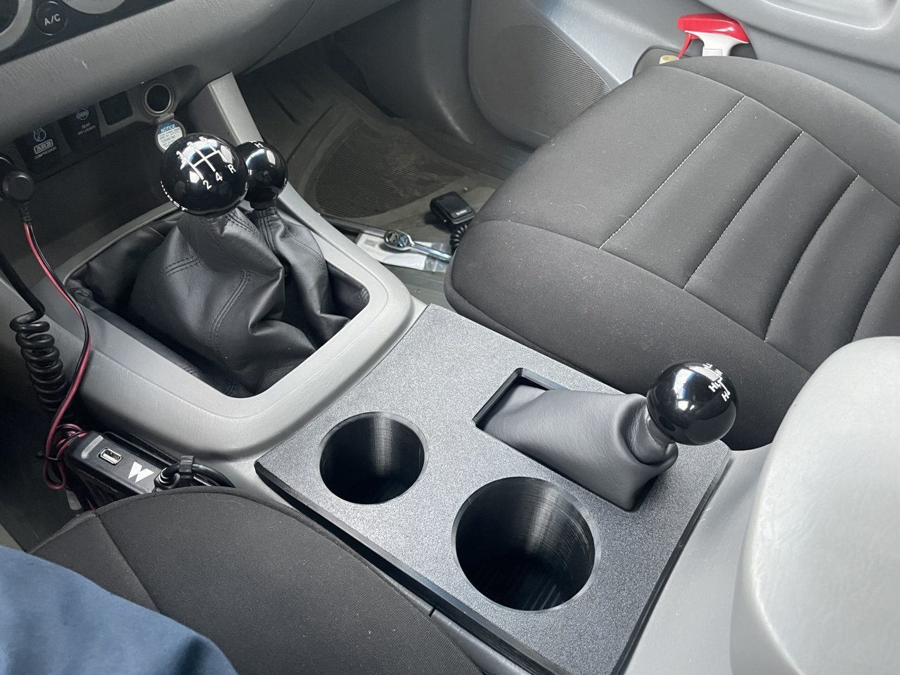

    There are some guys on this forum that do really good printing. @BassAckwards just had his cup holder/shifter slot made. He can direct you to the member that printed that. Maybe that guy can help you out?

    I used Blue Dog Designworks. Will is who I worked with, and they make nice quality stuff
    https://bluedogdesignwerks.com/
    here’s how my cupholder turned out

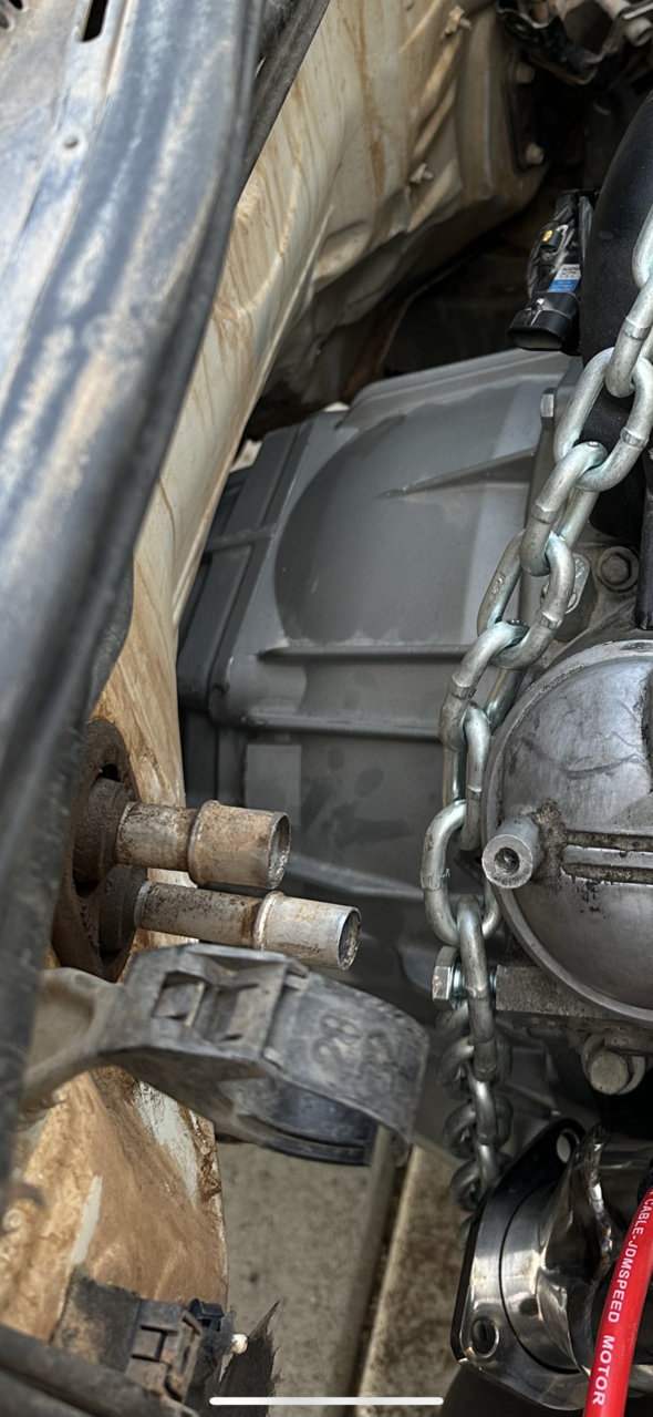

    Who's the resident AC Expert here? I need to get the connections for the evaporator core. Ideally they'd be adapters. @Dm93 Do you know anything about this?
