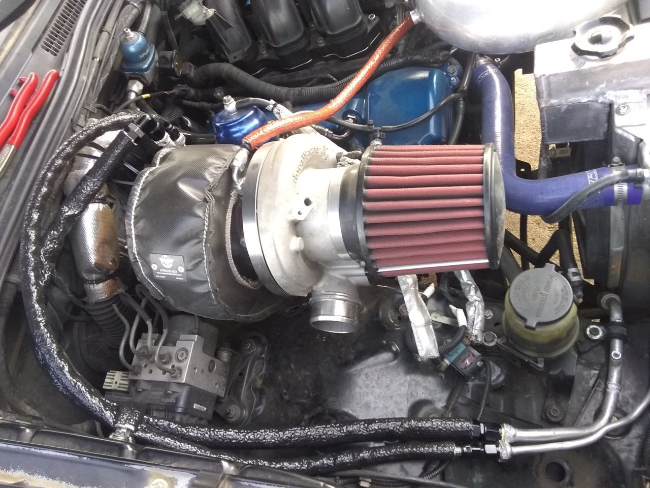

    Do you still have the OEM lines that used to go there? By your last comment, I take it as a no.
  8. Aug 26, 2023 at 10:35 AM

    Torspd Custom Turbo kit [] Borg Warner 9180EFR Turbo [] Haltech Elite 2500 [] TiAL Q BOV [] TiAL V44 Wastegate @ 15psi [] CP Pistons [] CP Carrillo Rods [] ARP Head studs [] ARP Main Studs [] ARP Header - Head Studs [] Ported Heads w/ 1mm oversized valves intake/exhaust [] Brian Crower Forged Stroker Crank [] Darton M.I.D. Sleeved Block [] Kelford Camshafts [] Torspd 160* T-stat mod [] APR Large Fuel Rail [] Walbro 460 LPH E85 Fuel Pump [] FueLab FPR [] APR T56 Conversion Kit [] KP RACING Built T56 [] McLeod Racing Custom Twin Disk Clutch [] One Piece Aluminum Driveshaft [] MGW Shifter [] Custom lowering kit [] Ohlins Front Coilovers [] QA1rear shocks [] Custom Ron Davis Radiator [] Dual SPAL Electric Fans []
    Don't know if this will help or not, but this is what I did.
    I used the section of the OEM lines w/o-rings, then cut/welded/welded on AN fittings, then soft lines.
  9. Aug 26, 2023 at 10:38 AM

    2014 DC OR 6spd 4x4
    Predator tube steps, Ranch Hand grill guard, Magnaflow CatBack exhaust, Toyota tool box & bed mat, 2LO Module by @Up2NoGood, Rearview Compass/Temp Mirror, Tune by @JustDSM.
    I was thinking they could weld some fittings to those pipes if there's no way to adapt to them.

    MMVI 4.4L 4x4 Access Cab
    Correct. I cut then welded the section on that made it easiest to create the 90° in the photo.
    Then welded the male AN fittings at the next best location for the specific need. As best that I can share in the below photo.
    Thank you @Dm93

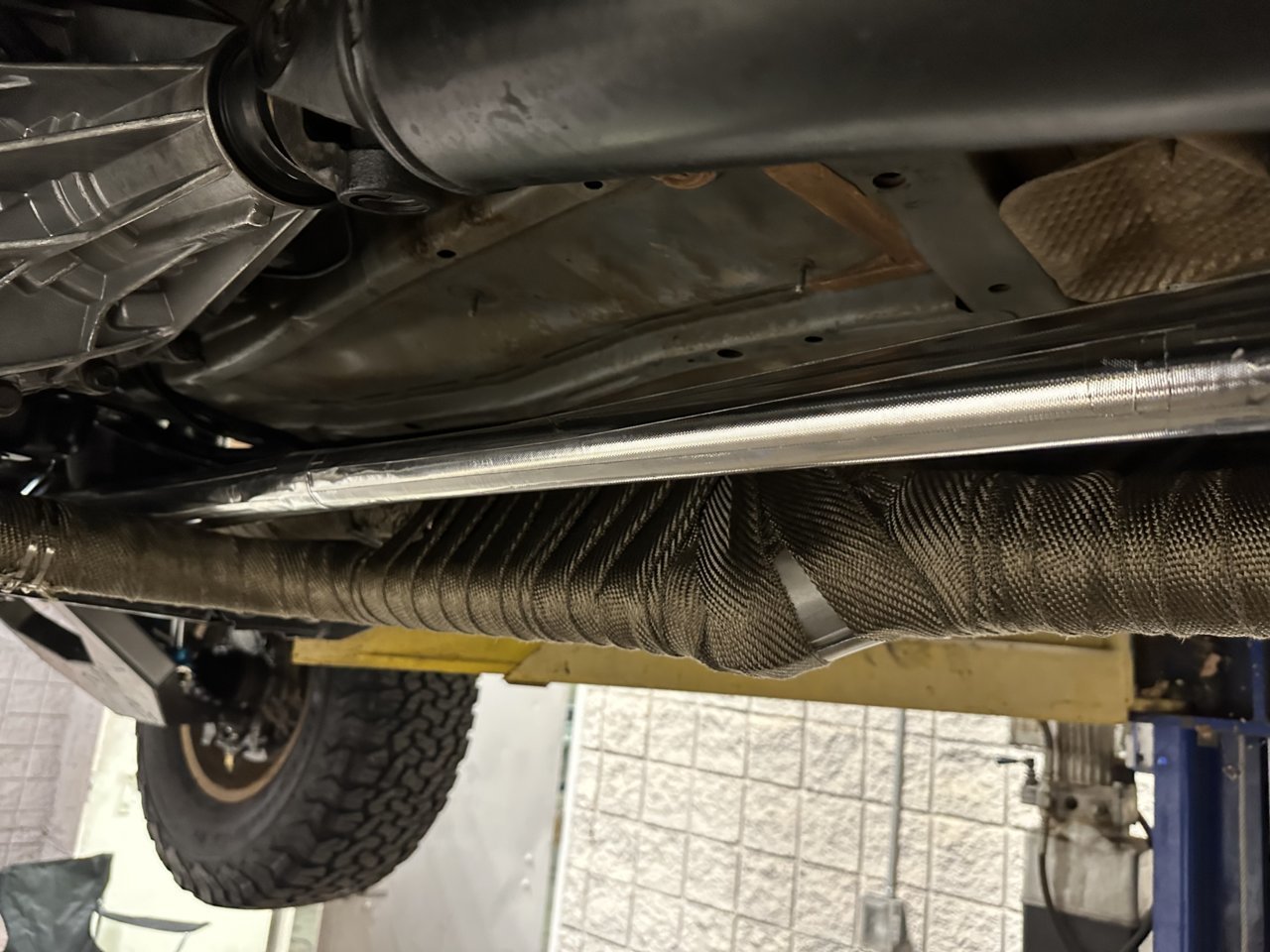

    Exhaust wrapped in titanium wrap and the coolant pipes wrapped in cool tape. Should help keep temps down.
    got a start on the radiator mount today, need to get some more material tomorrow.
