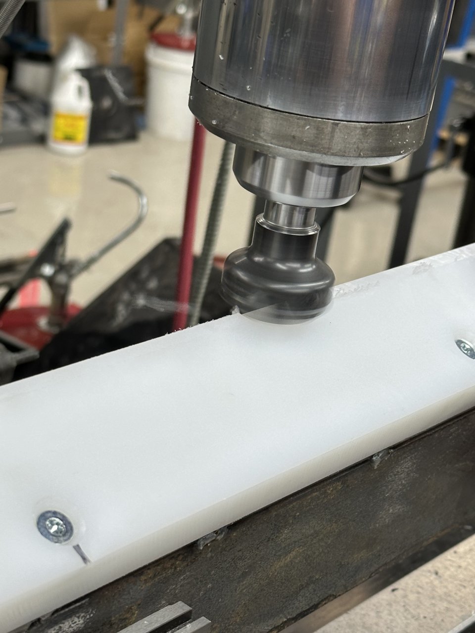

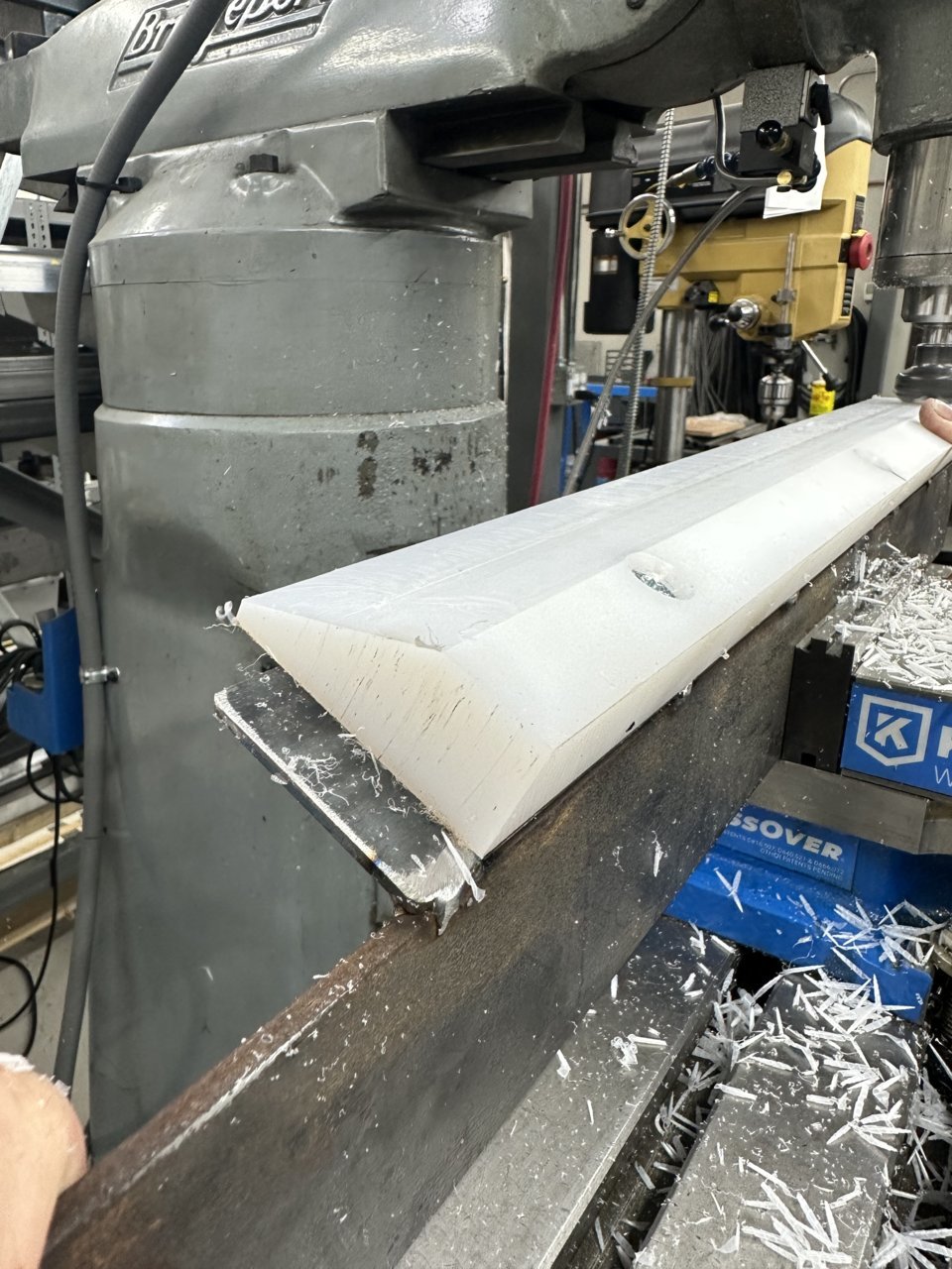

    Milled a 30* angle in some 1” UHMW plastic to serve as the bottom of the radiator mount to support the weight and dampen vibration.
