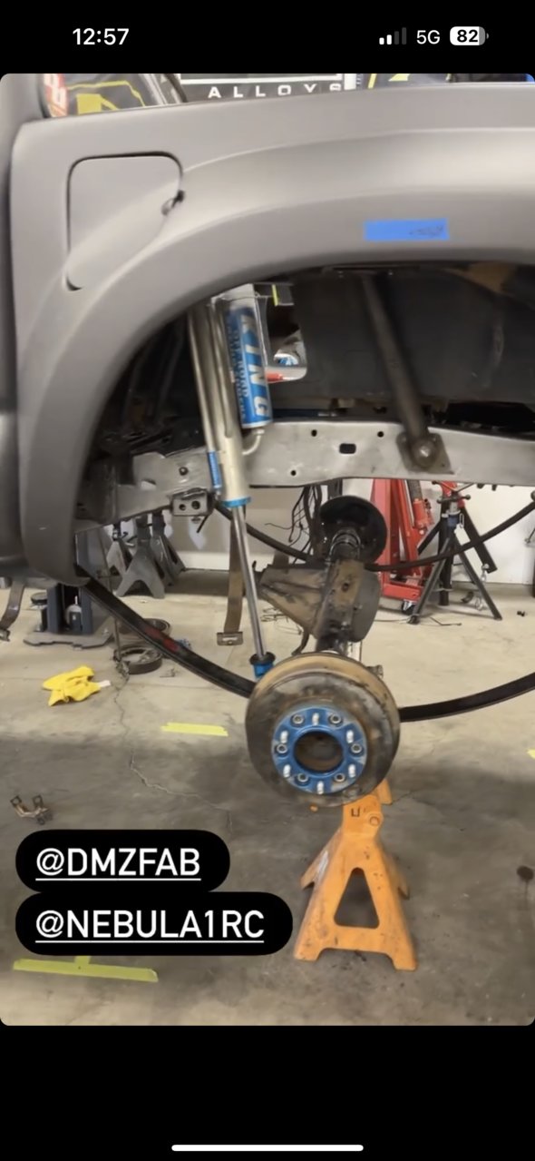

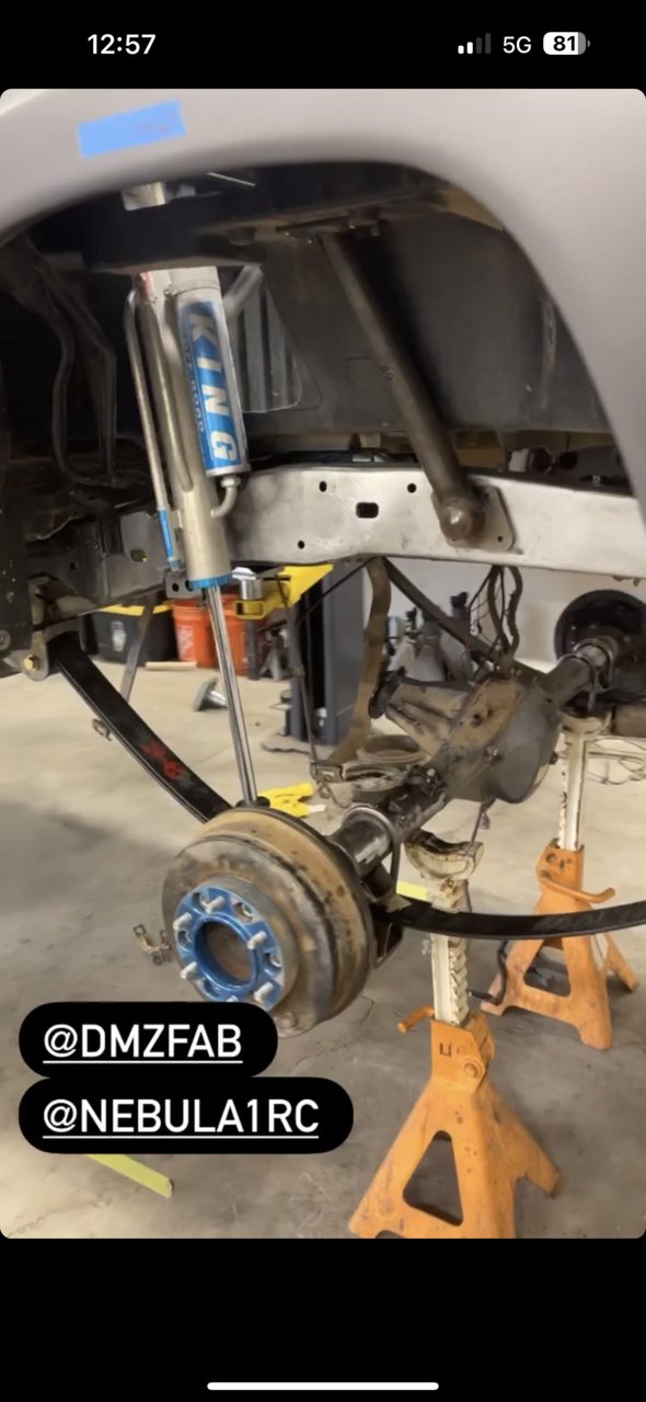

    Just a little update. 454 Motorsports is making really fast work out of this DMZ SUA kit. IMG_1920.jpg
    Springs and axel goes in today, going to start cycling stuff!
    While he has the truck apart, he's going to be doing a mazulla rear bumper, and a 454 low profile hitch receiver.
    My front BTF Long travel stuff is finally nearing its shipping date, so I was discussing install stuff with 454, and right now since there's no motor, he's going to install a double shear kit for the front upper control arms. He's also leaving the spring perches on the axle just tacked into place, since there's no driveline he cant set the pinion. I'm going to have the truck back in 2 ish weeks, then I'll get the motor in for good. Once the rest of the BTF stuff gets here, im going to bring the truck back to him to have the front LT installed, as well as have the driveline and pinion built. He's going to do a DRT fab spindle gusset and CMR at the same time. Lots of fun haha.

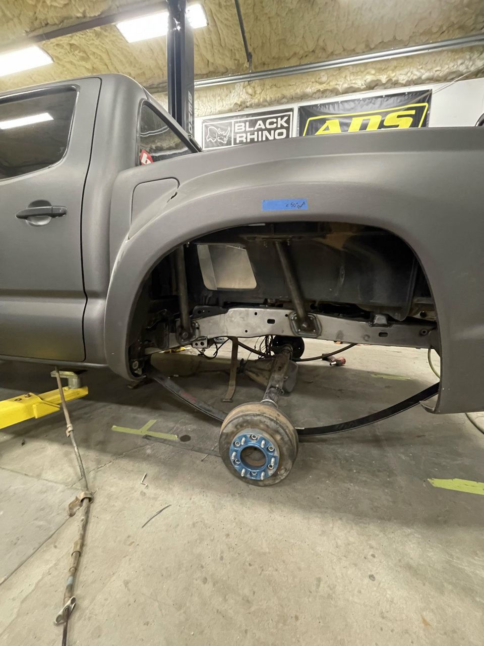

    Coming together!
    Cant say enough good things about 454 motorsports. Highly recommend. Fair pricing, quick work, great communication. Also, incredibly thorough. He noticed one of my return fuel line fittings was cracked so he went ahead and replaced it. I don't know of many shops that are this meticulous.

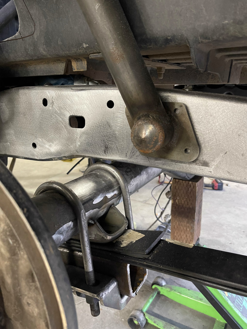

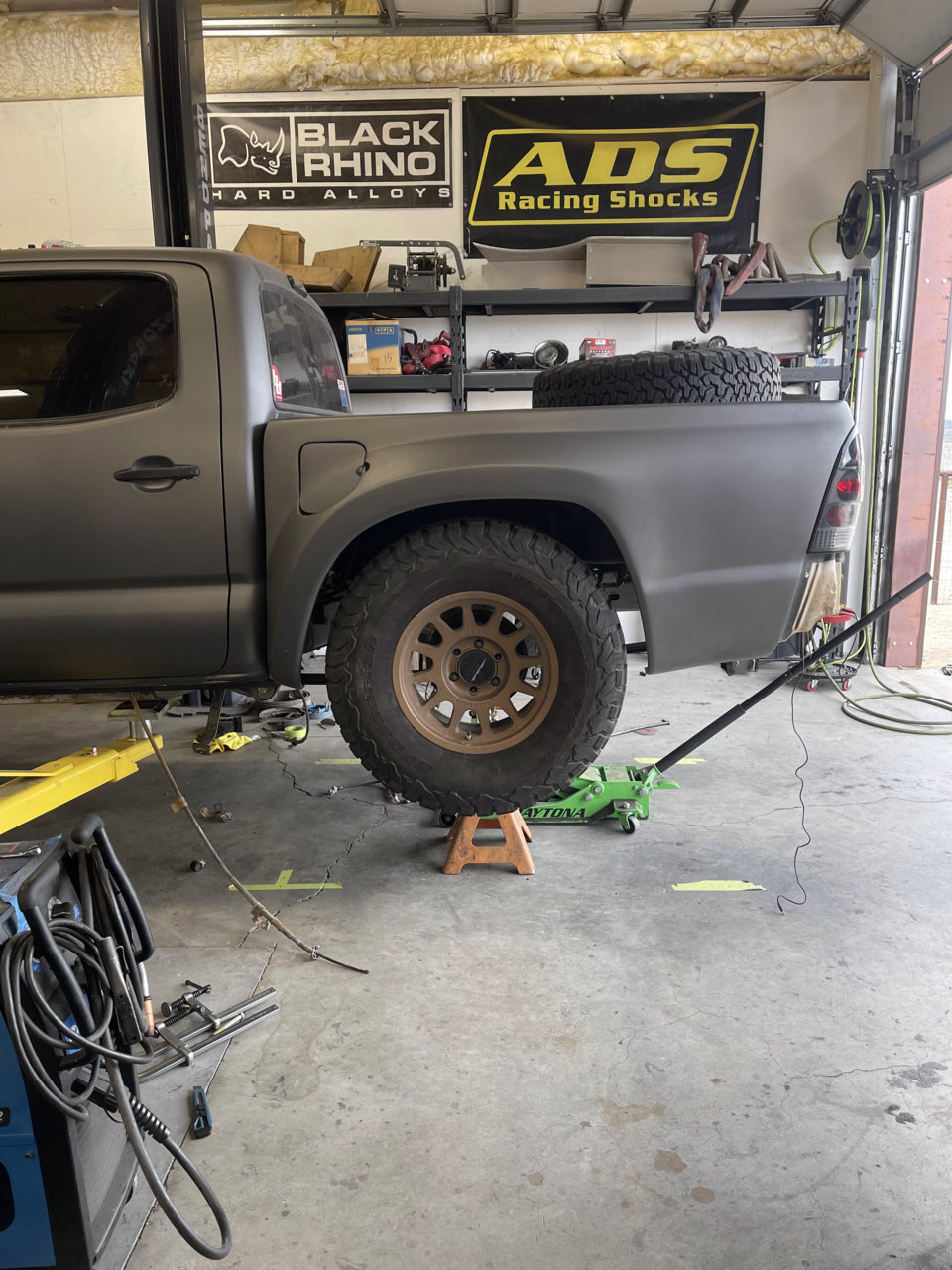

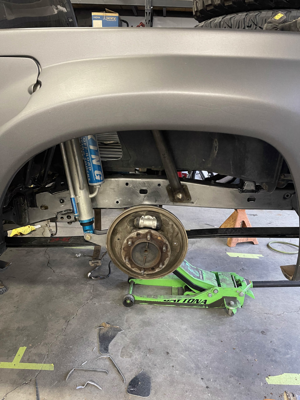

    IMG_3841.HEIC.jpg \
    Full Bump!
    Spring perches just tacked, since I don't have a driveline. Cant set pinion angle without it! Once the motor is in Im going to bring it back and have it set and finish welded in.
