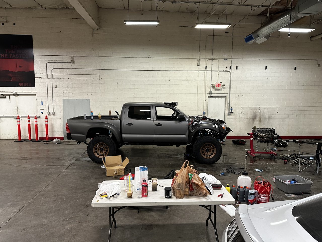

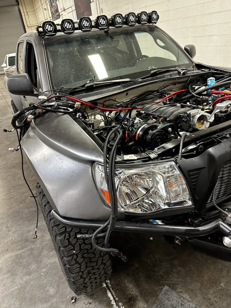

    Everything is disconnected from the engine, harness, fuel lines, power steering lines, vacuum lines:IMG_6291.jpg
    All that’s left is the exhaust, engine mounts, transmission bell housing bolts, and torque converter bolts and I should be able to lift the engine straight up and out.

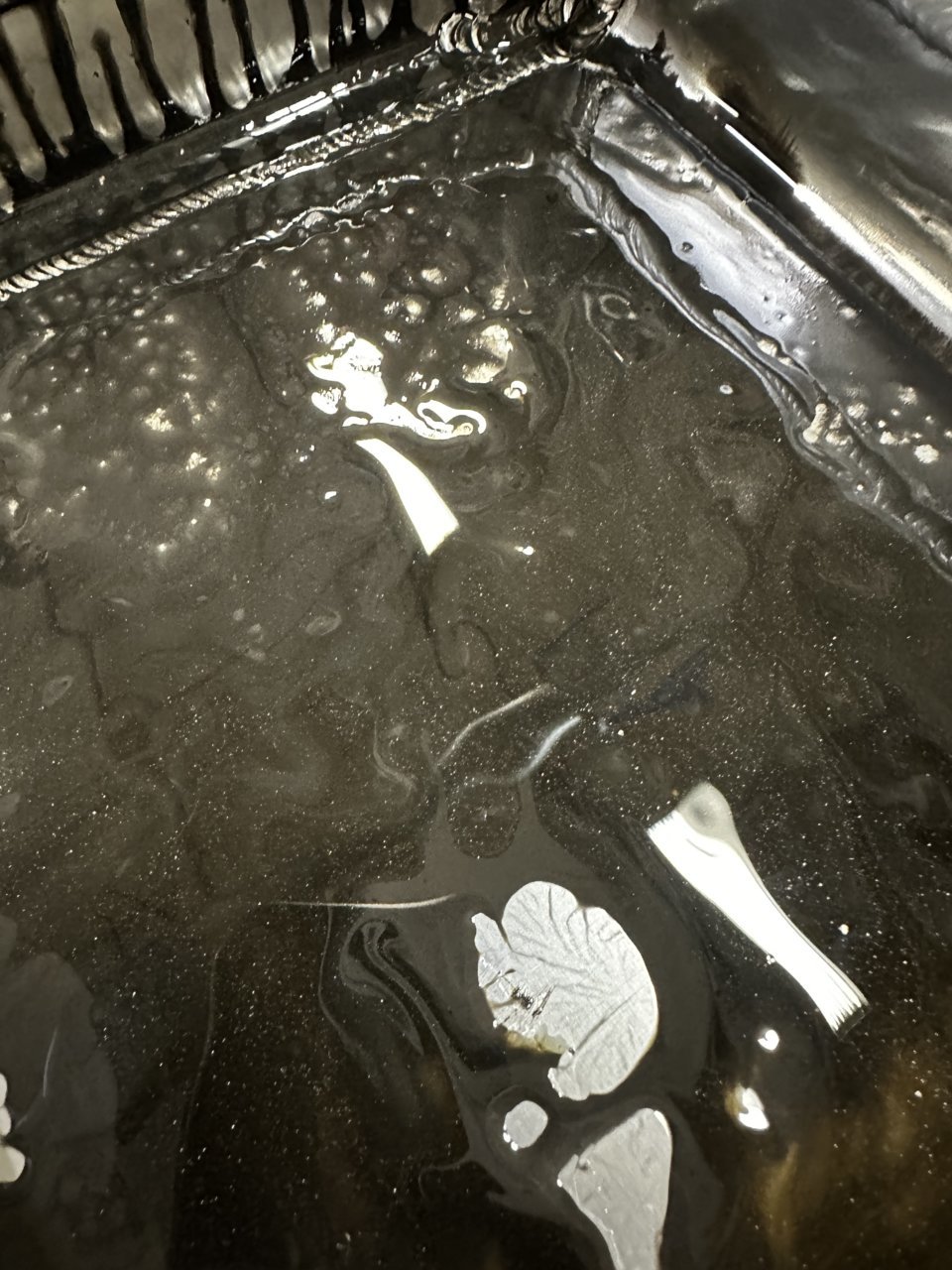

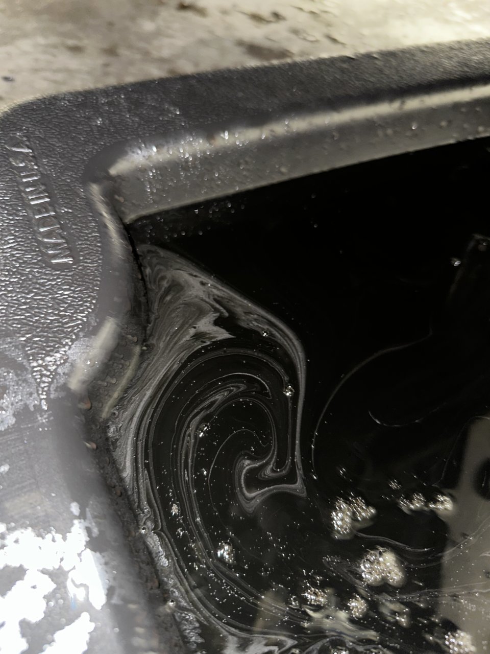

    When I was draining the oil, I found this: IMG_6288.jpgidk if this is from other shit in my drain pan or not, but when I captured some of the oil in my Dr Pepper cup, I couldn’t sss anything close to that amount of metal. It’s incredibly fine, and I’m not even sure that it is metal. This oil has maybe 200 miles on it too. LS’s make oil super murky super fast. In either case, I guess it’s good I’m pulling the engine. This is kind of convincing me to have someone who does this every day to look over the engine. If it indeed does need some work, I’ll probably put some higher compression pistons in it, over bore them, and go for about 500WHP, ~600 crank Hp NA on this motor. That’s where I’d like to be ideally. I don’t even know what to do lol. But the good news is I have everything needed to reseal this engine top to bottom. Should have the engine out this weekend. Tomorrow is the wife’s birthday so I won’t be working on it tomorrow.

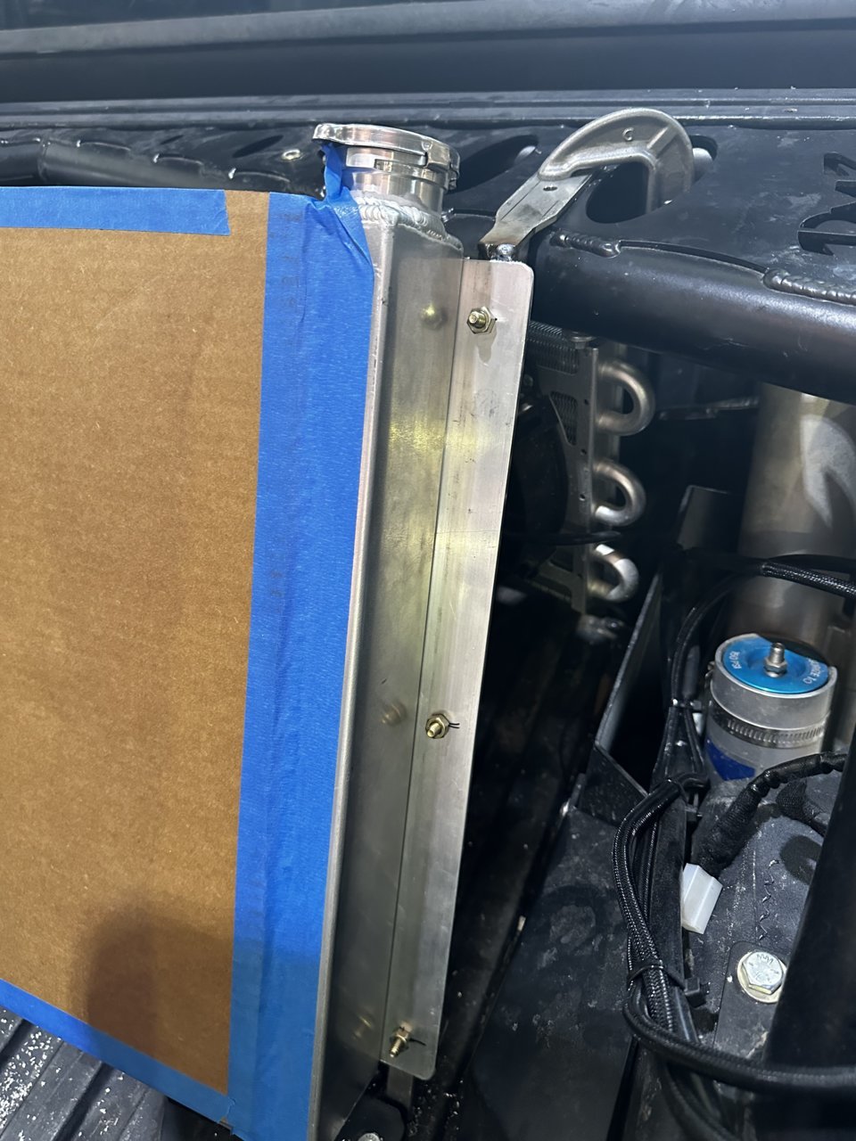

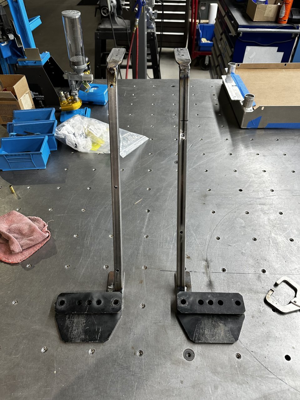

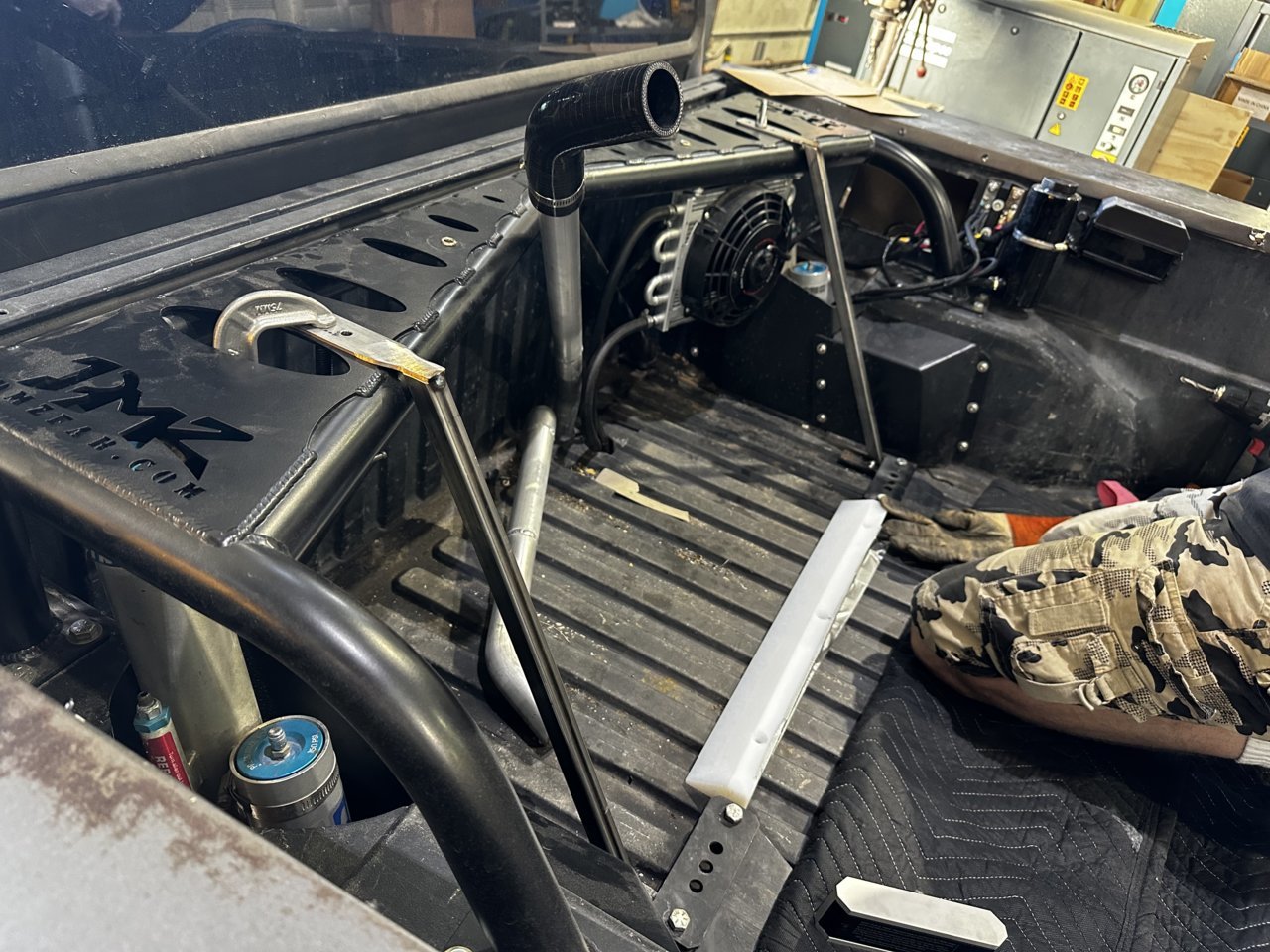

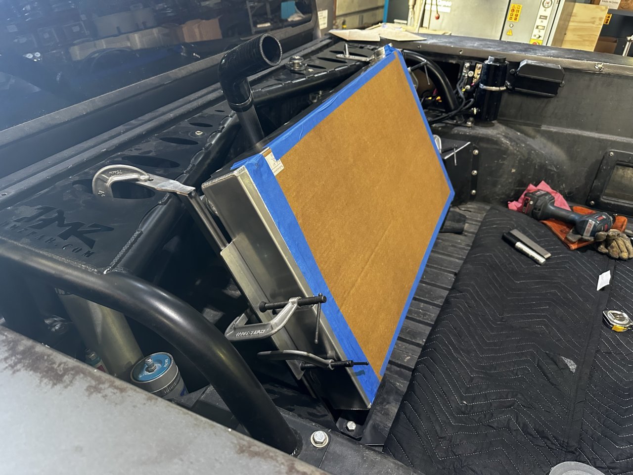

    Radiator mounts are done!
    everything is bolt in, nothing permanent in the truck which is really nice.
    Everything is finish welded. Going to hit it with a few coats of steel it and call it good.
    Only thing left is to finish welding up the new flanges on the radiator and final assembly.

    Did you have assembly lube in there?

    In the engine? No

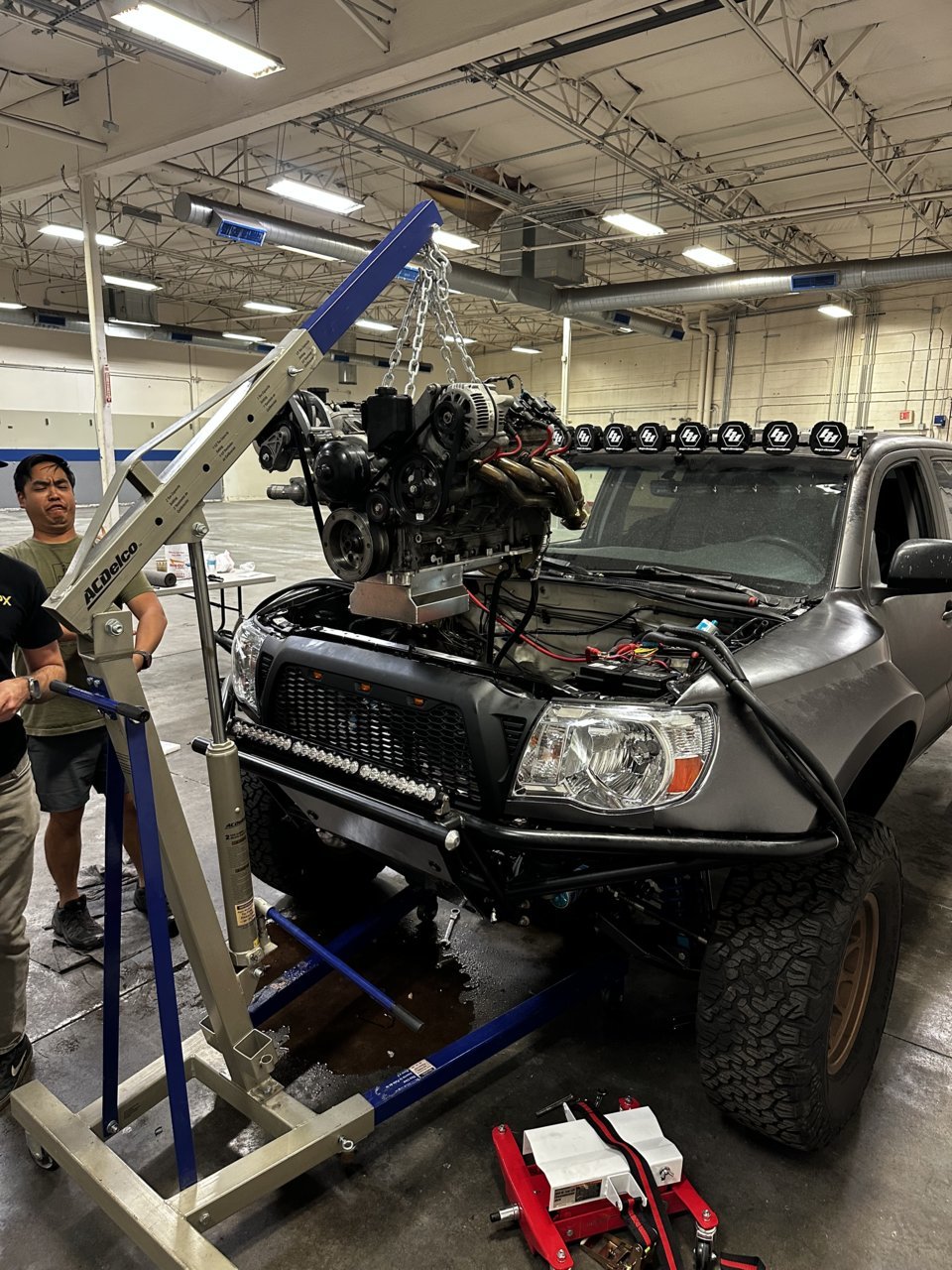

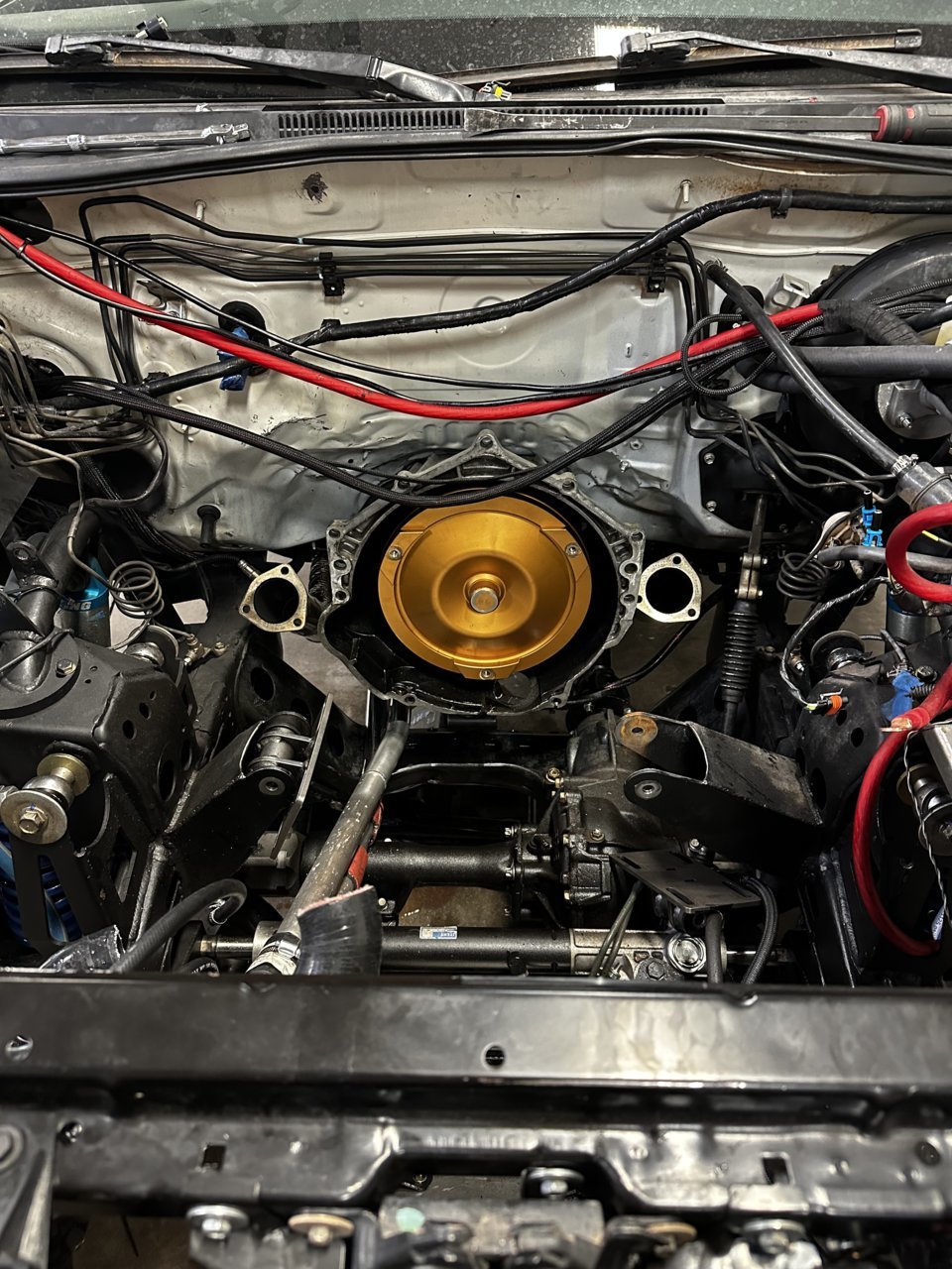

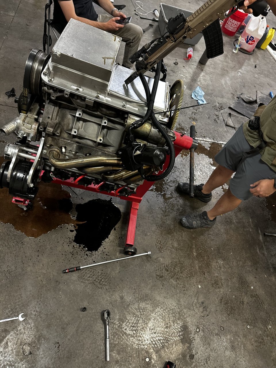

    Tonight’s progress. Going to call van tomorrow again.
    Pulled a rod bearing and a main bearing, they don’t look great but they don’t look bad.
    im glad I was able to pull the motor while leaving the transmission in its place. Makes life just a little bit easier.

    How many miles where on the motor? And how many on that oil? My ls had about 90k on it and I change the oil about every other outing(only get it out a few times a year) but my oil always looks damn near new every time I change it so shocked it’s that dark

    50k miles on the motor, 150 miles on the oil

    yeah definitely a failure somewhere cause that’s not right… that sucks, especially with 50k on it.
