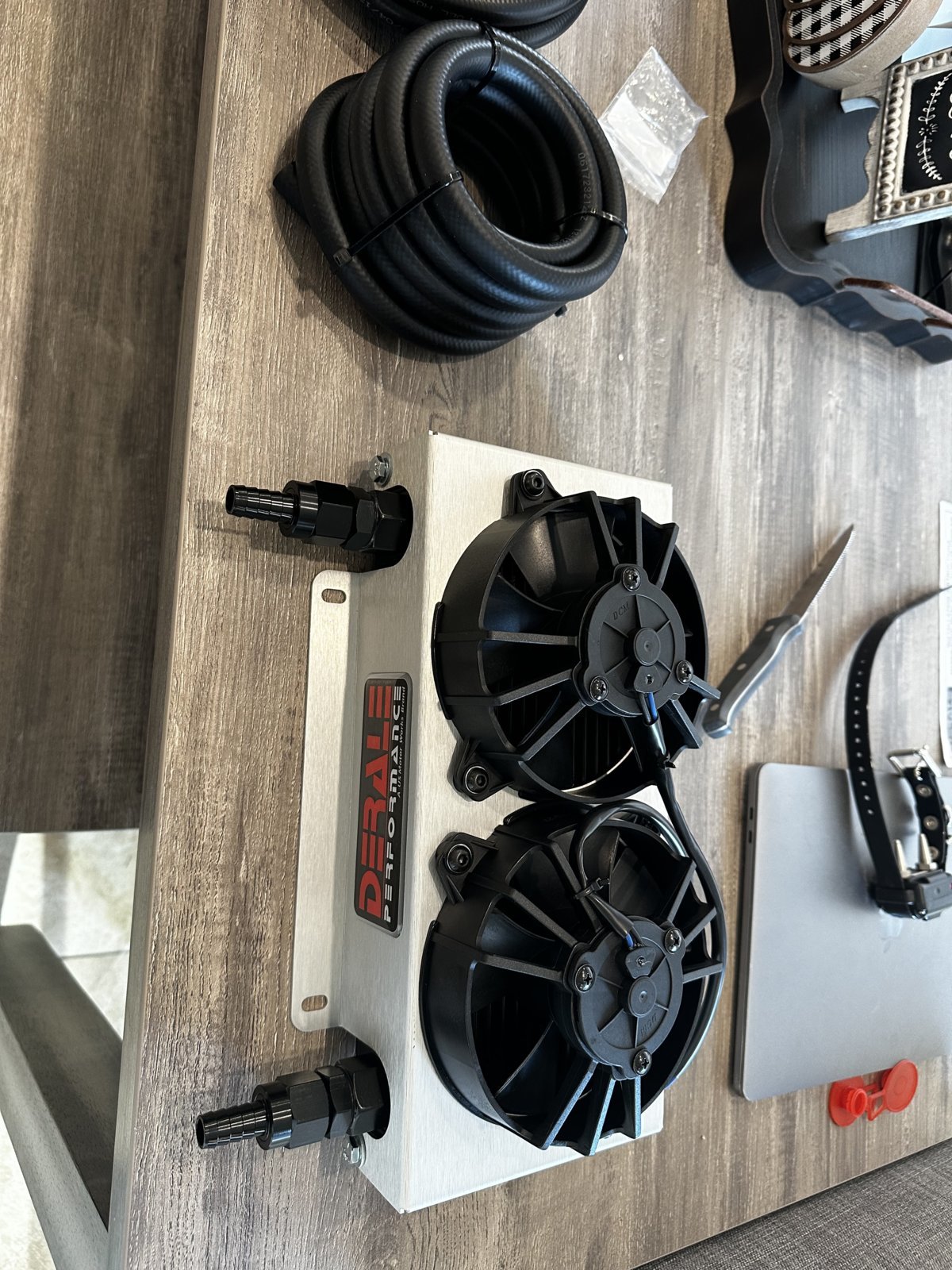

    Derale trans cooler. This thing should keep the temps under control. It’s pretty beefy. Ordered a nice inline thermostat to control power to these fans. The thermostat can run up to 15 amps continuous, these fans pull 7.5 amps combined, so I won’t even need to run a relay. Makes life easy, and makes this thing run the way it should.
    Amazon keeps delaying my packages, but I have the necessary adapters for the ARB breather to get my breather lines setup for the front diff, tcase, and transmission.

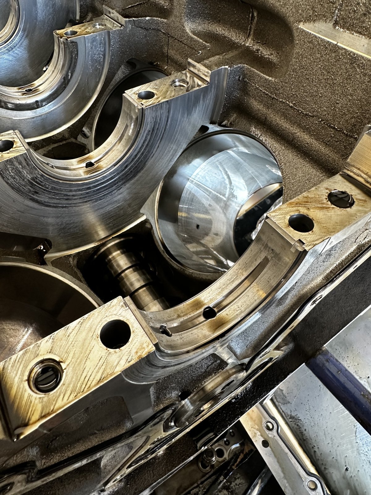

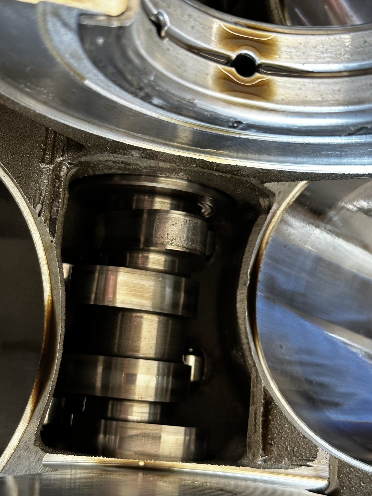

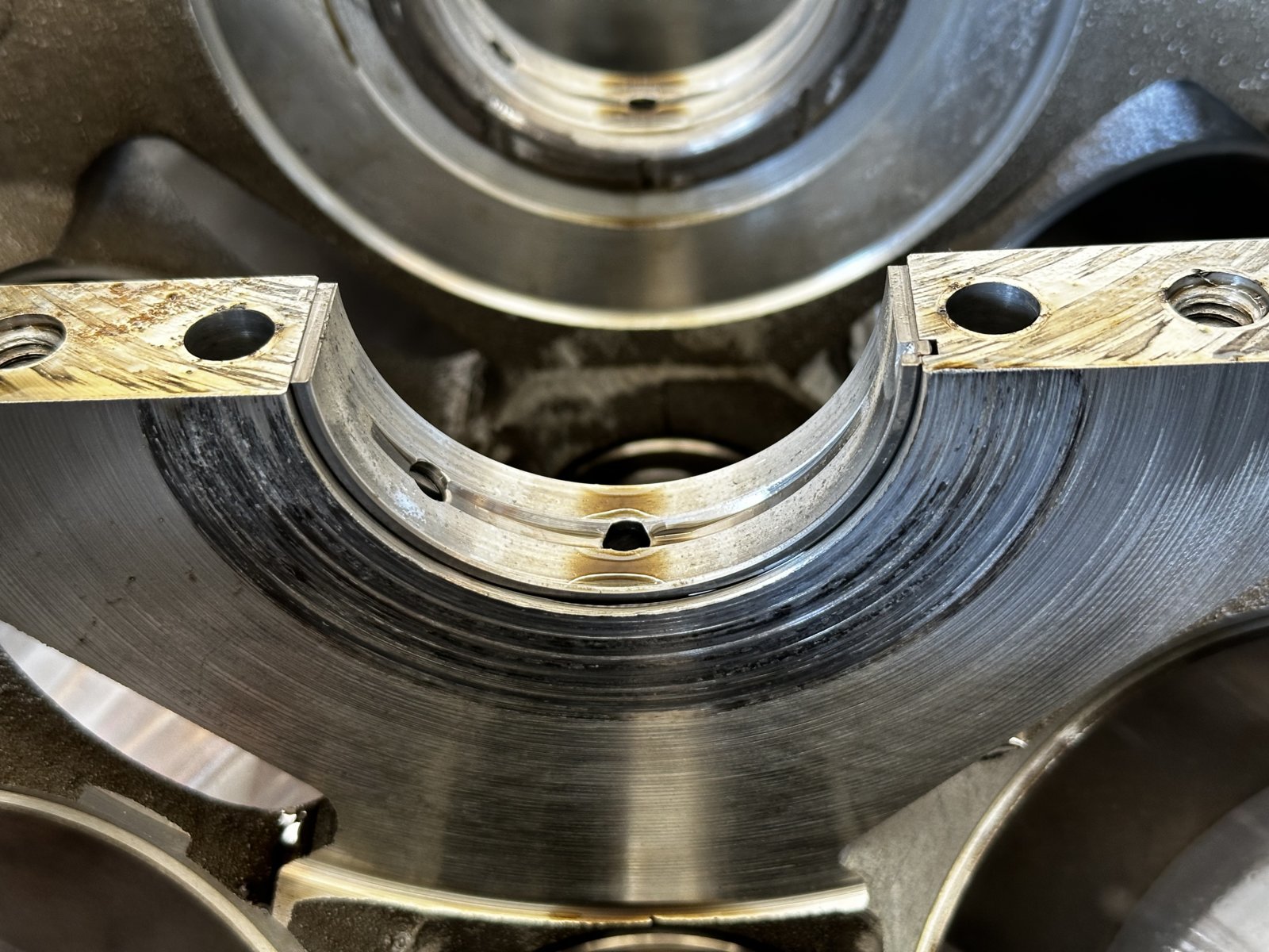

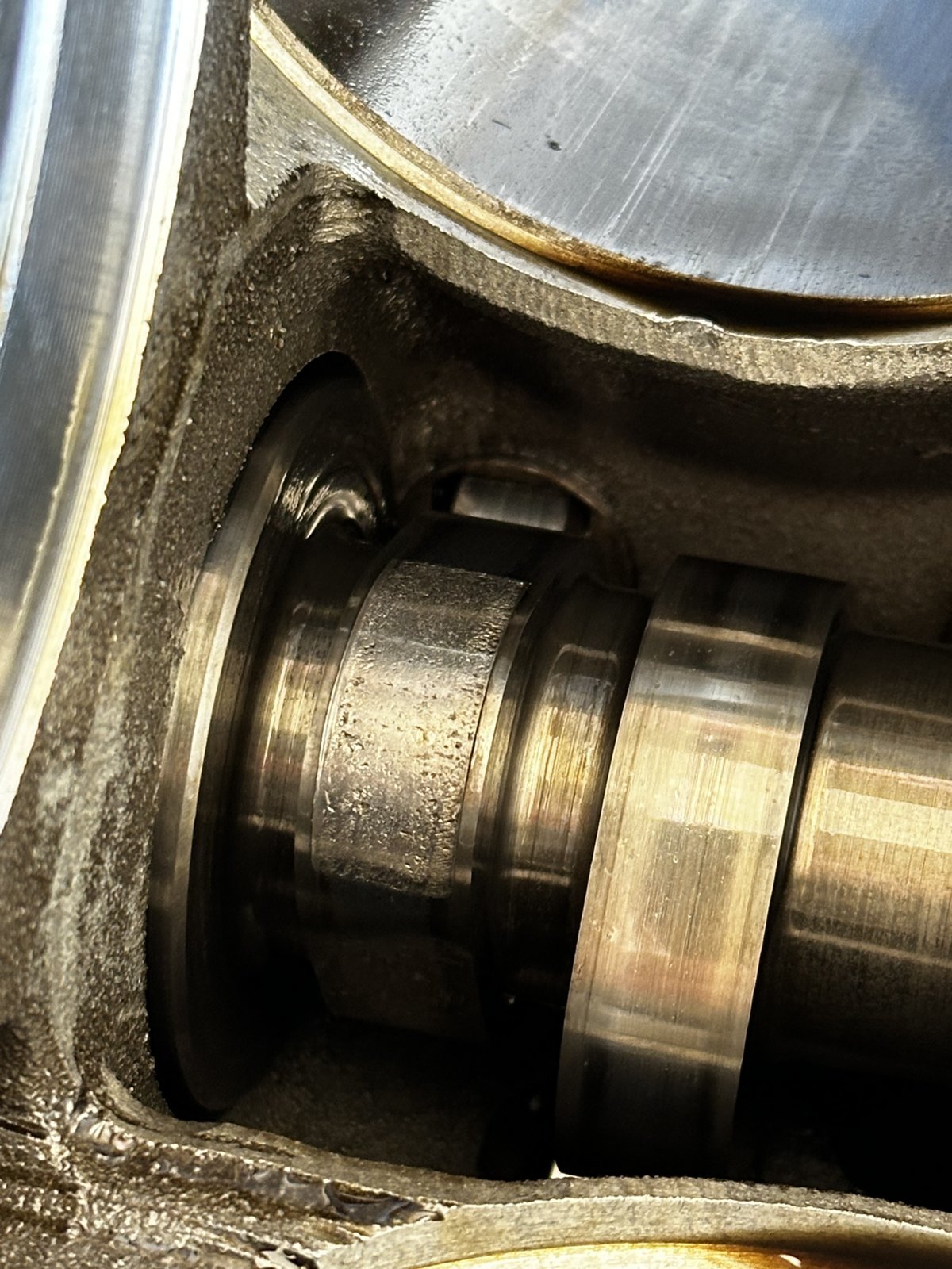

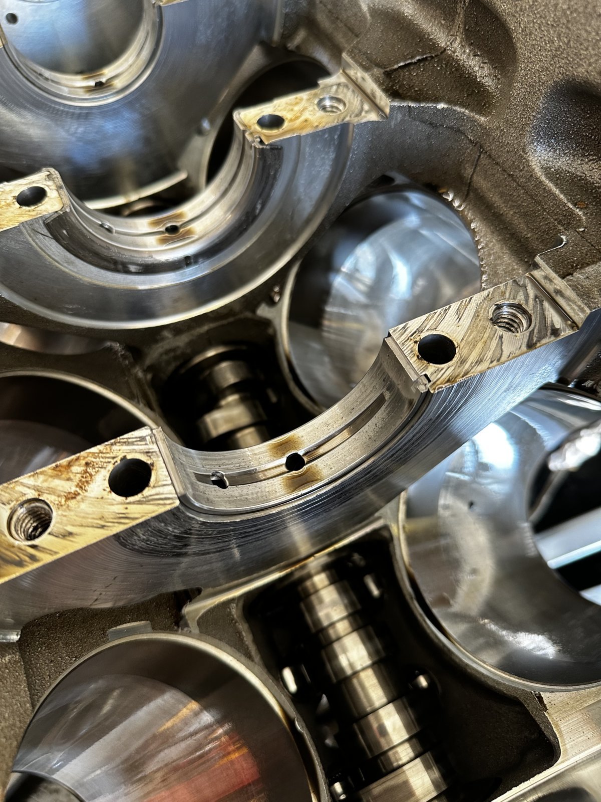

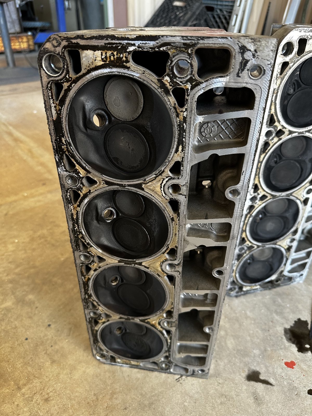

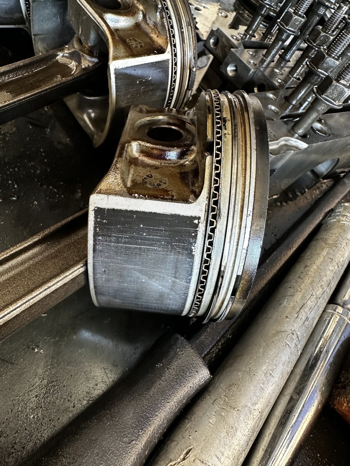

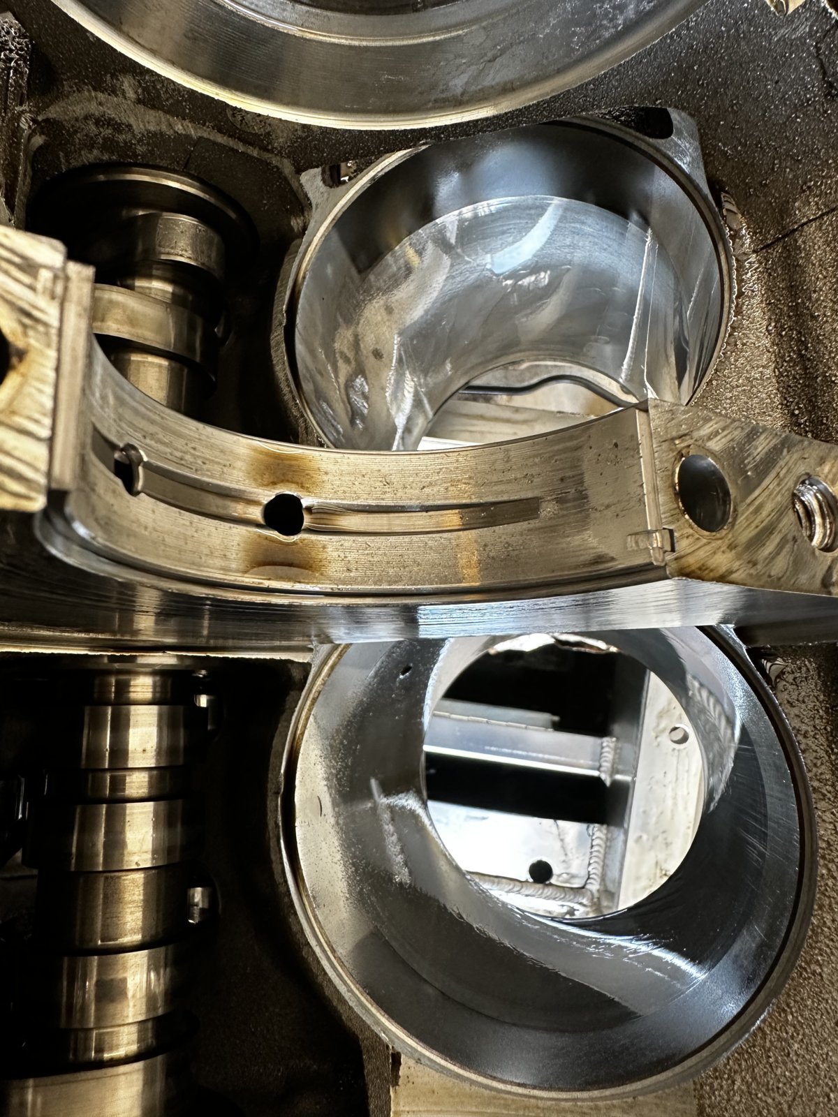

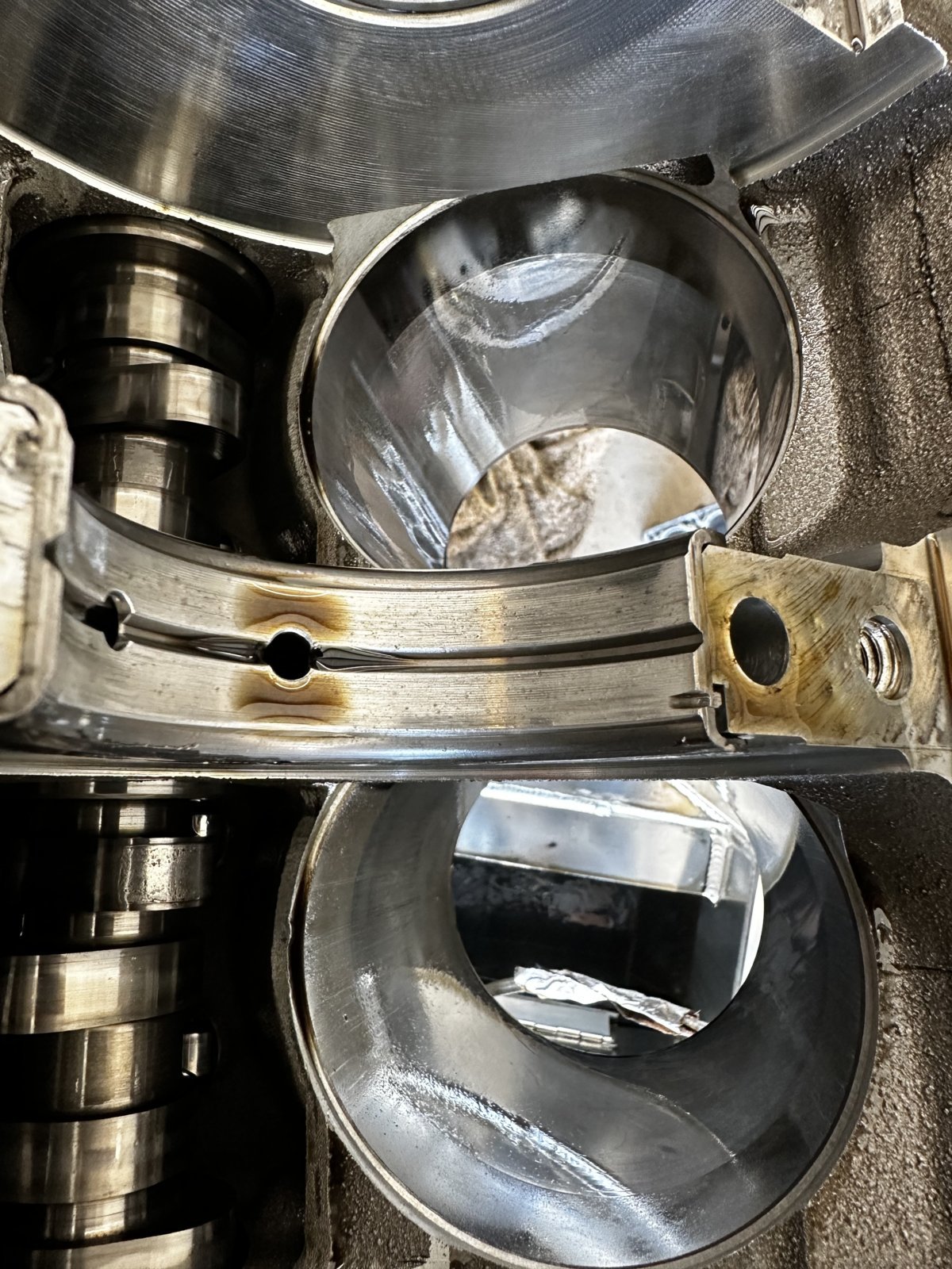

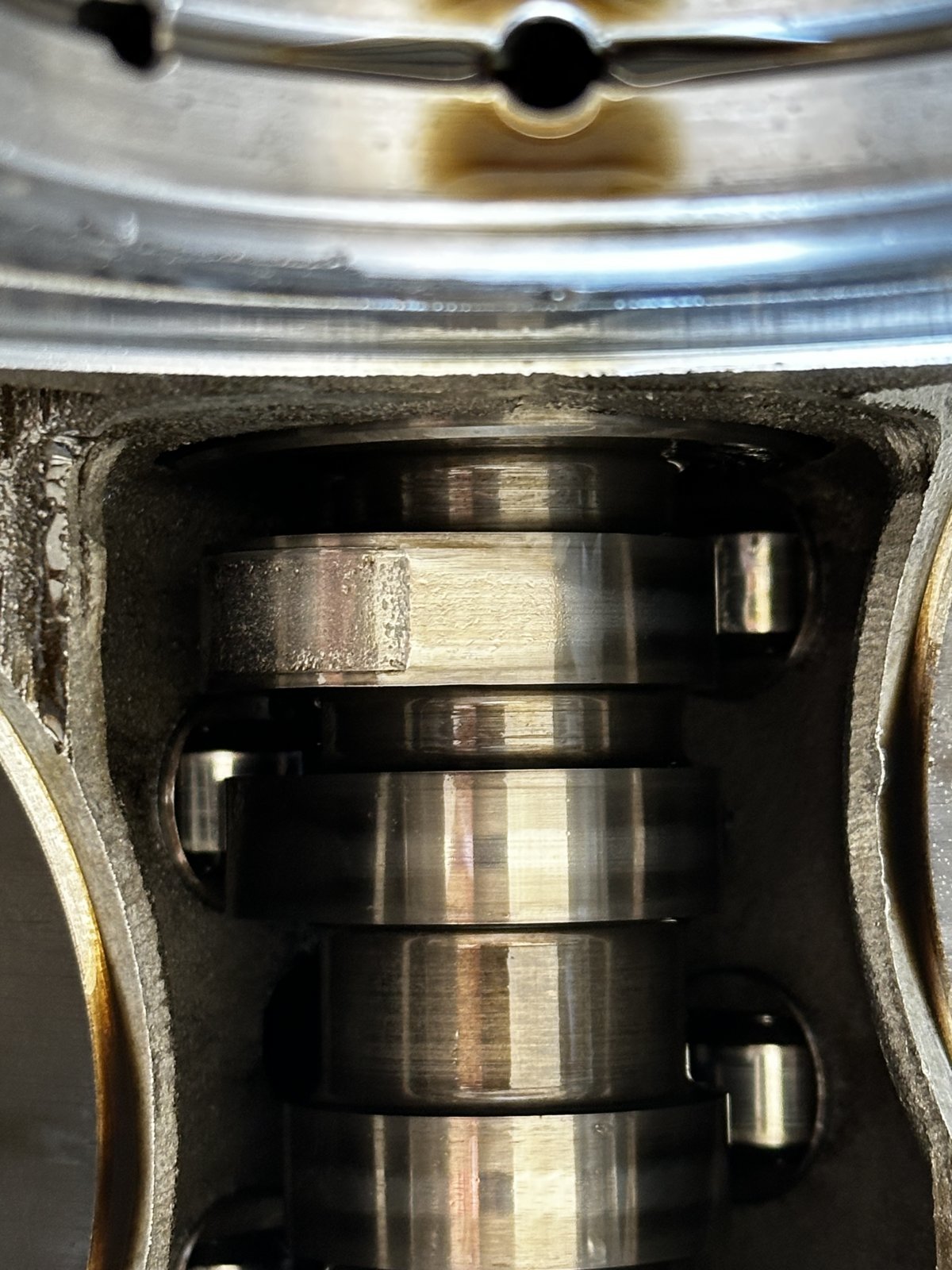

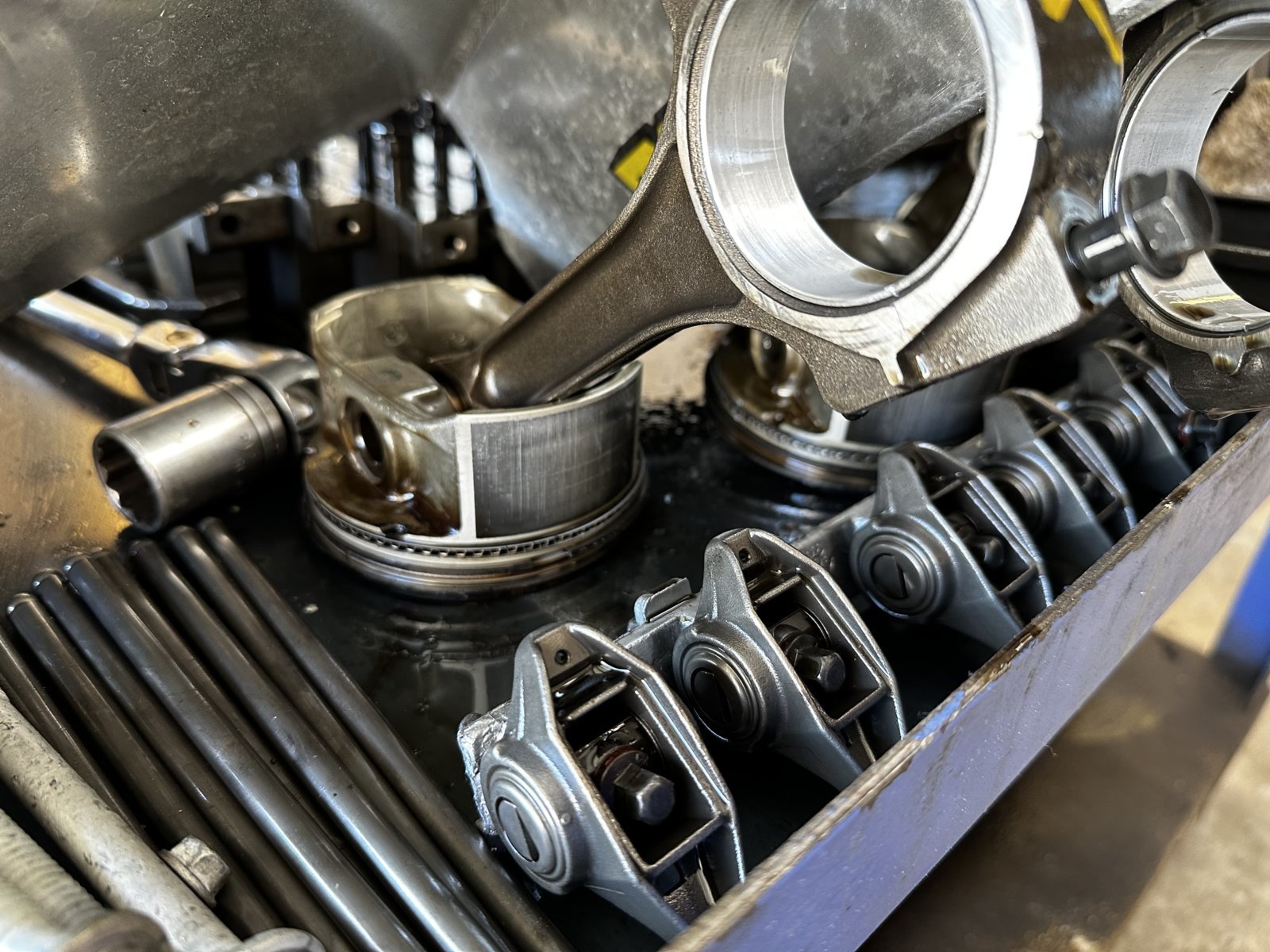

    IMG_6778.jpg IMG_6779.jpg IMG_6780.jpg IMG_6781.jpg IMG_6782.jpg IMG_6783.jpg IMG_6784.jpg IMG_6785.jpg IMG_6786.jpg IMG_6787.jpg IMG_6788.jpg
    Well the engines trashed. Thrust bearing put metal all throughout the engine. My guess is the previous owner of the engine trashed it and sold it. When I got the motor the pan had some sludgy shit in it but I just assumed it was an LS moment.
    Block and heads are okay, but I need an entire rotating assembly, set of bearings, timing kit, camshaft, pushrods, roller rockers, etc etc. going forged everything. Will be about 9k for parts, labor, and machine work, but I’ll have a 550HP NA motor that I know is for sure good.
    Oh, and once parts are ordered, I’ll have a complete sealed long block back to me in 3 weeks. Kinda sucks I’m out this much for an engine again, but it’s what it is I guess. I’ve got a really cool STI costa carry comp I’m going to sell to put towards this thing. I don’t wanna just set 9k on fire lol.

    Shitty man. Why even bother spending that much to rebuild that motor when you can just order an already built motor for less?
    I kinda wish that I had just gone that route myself, but when I bought used I pulled mine all apart to check everything before installing it, just incase there was something like what you found inside. Luckily it looked in pretty good shape.
