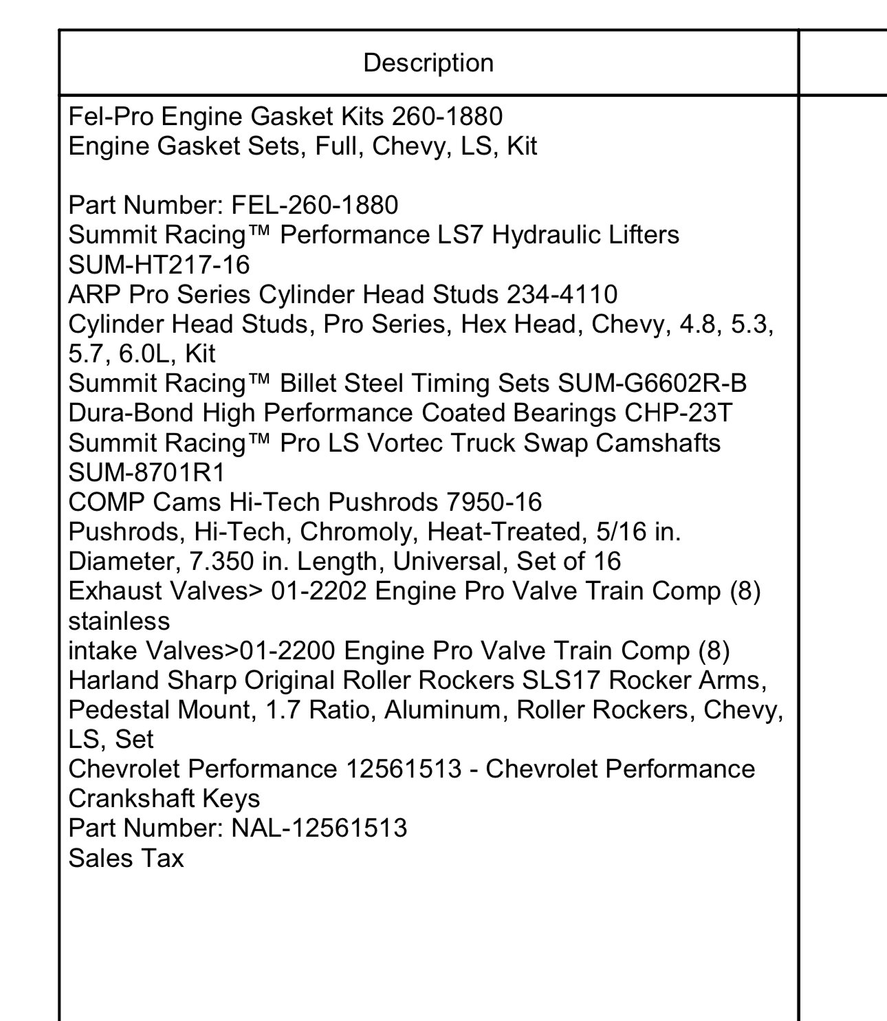

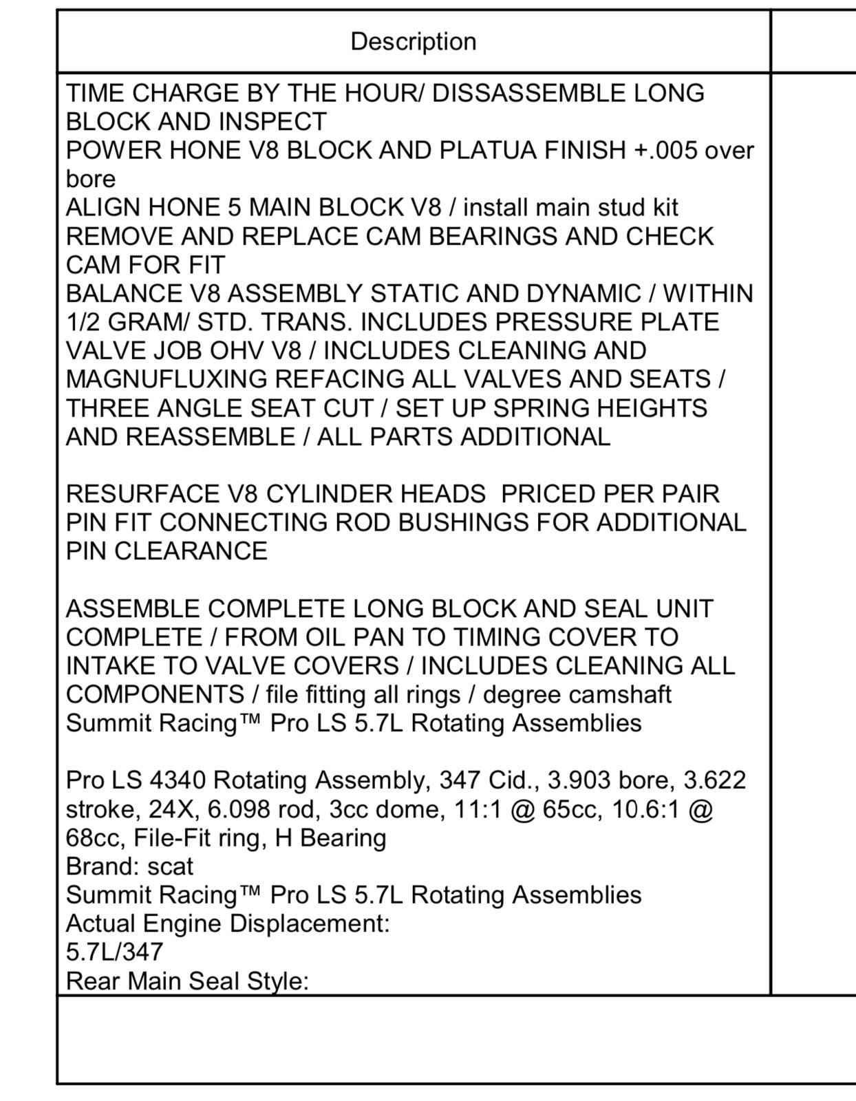

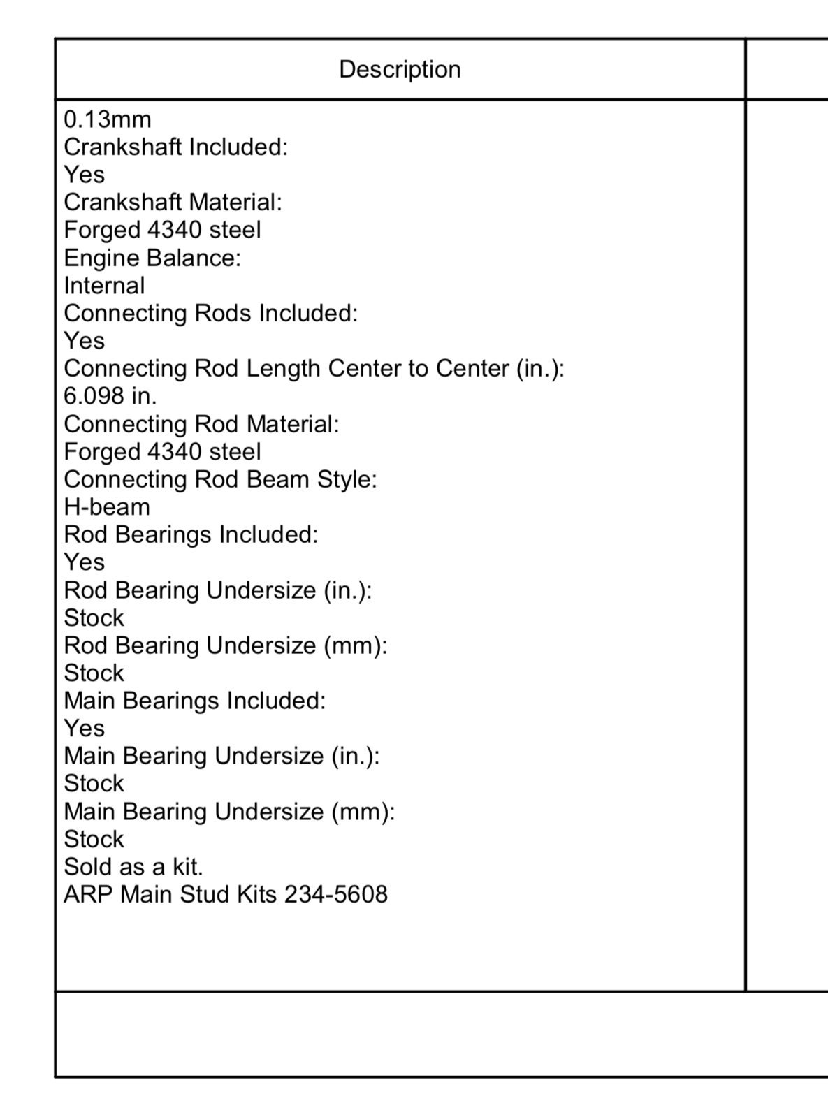

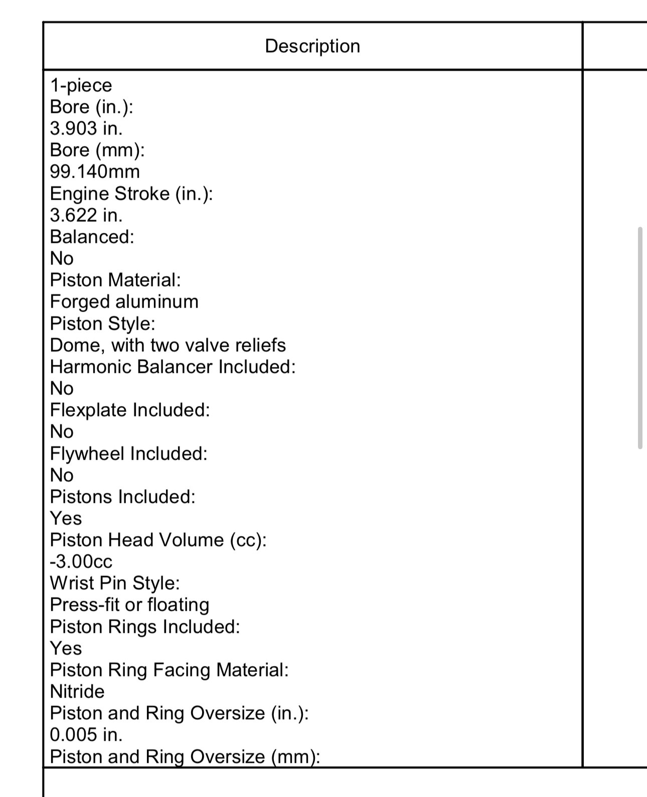

    $9700 all said and done for the completely built and sealed long block. Any objections to this here?

    Nope it’s a factory 5.7 LS6
    this is the cam he spec’d:
    https://www.summitracing.com/search...fts/duration-at-050-inch-lift/222-int-232-exh
    this is the one I’m going to ask him about using:
    https://www.summitracing.com/parts/sum-8703/make/chevrolet

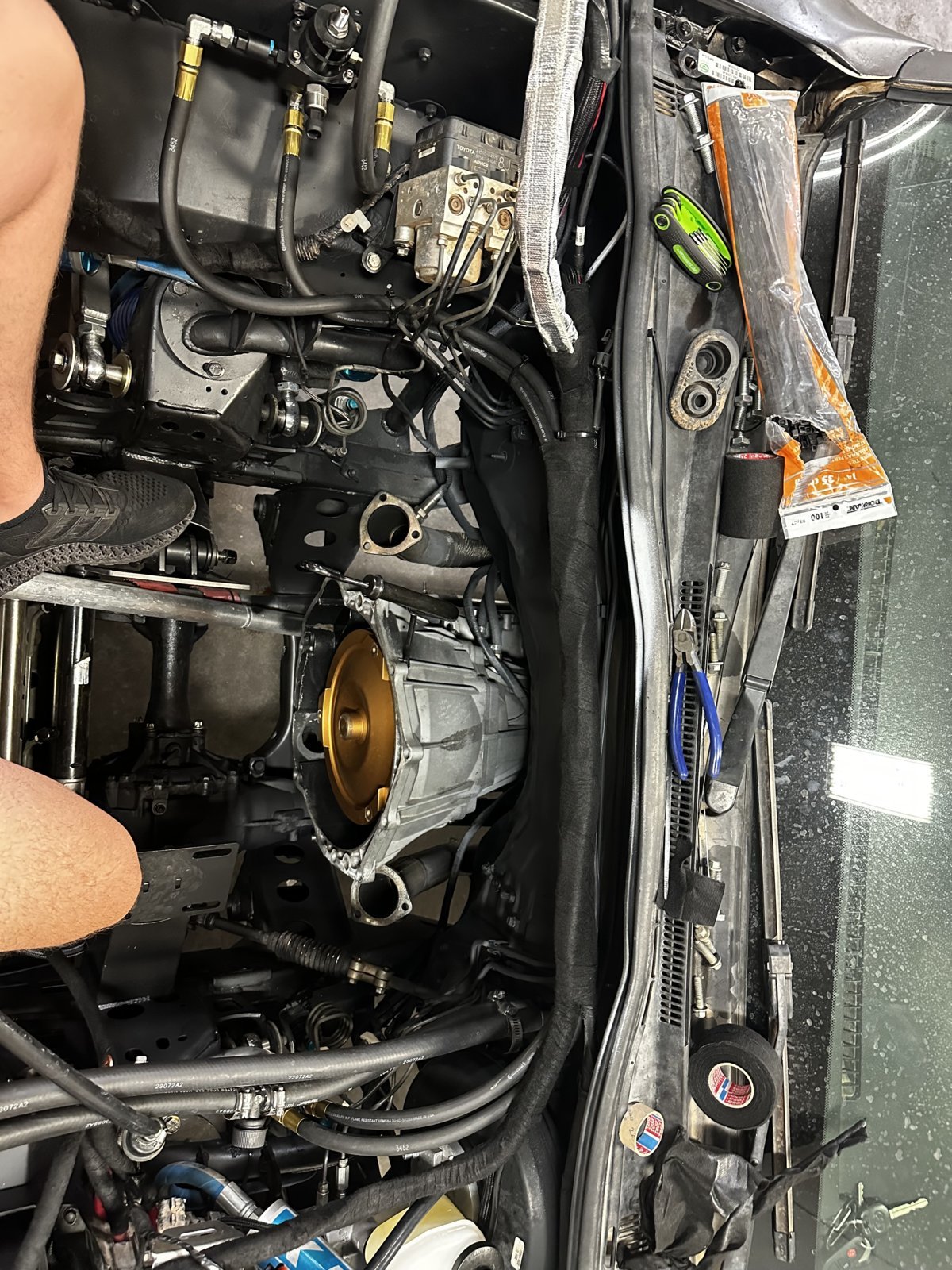

    Fuel regulator reinstalled and fuel lines ran and tucked up. Trying to make my life easier when the LS gets back.
