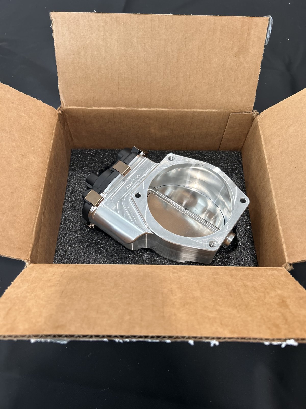

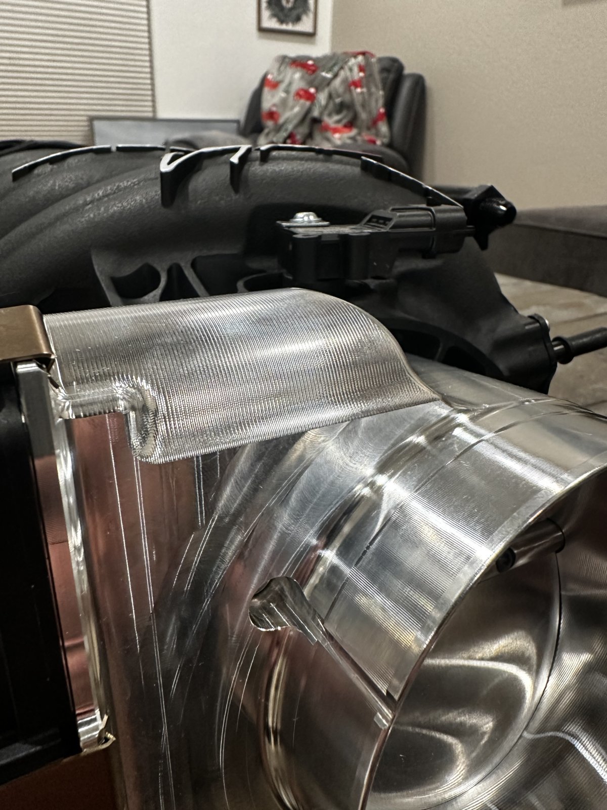

    Nick Wilson Billet 102mm DBW throttle body just arrived.

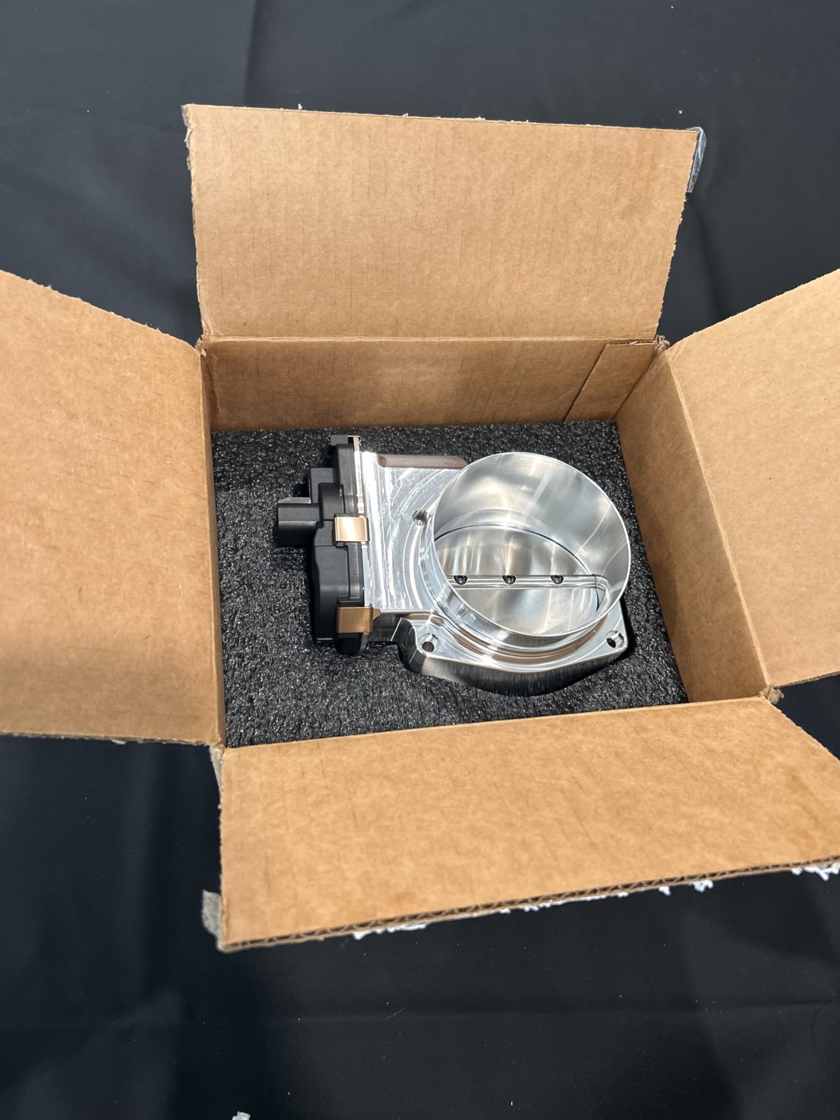

    He’s larger in person than in photos. 102mm. The machining is beautiful.

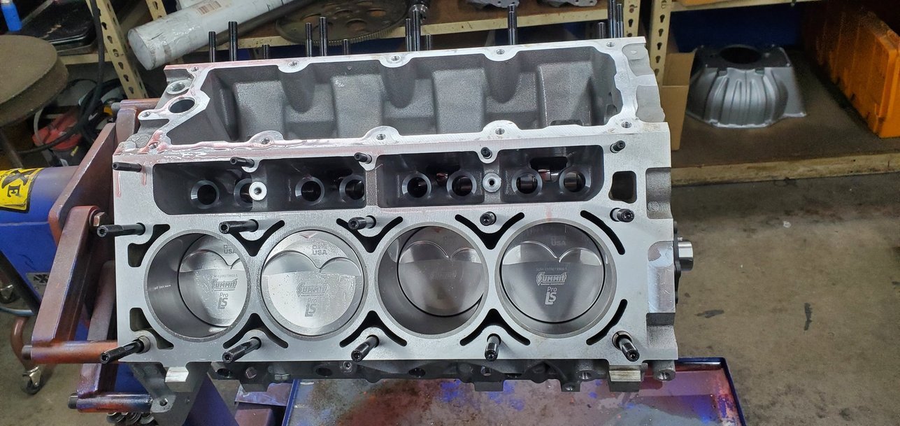

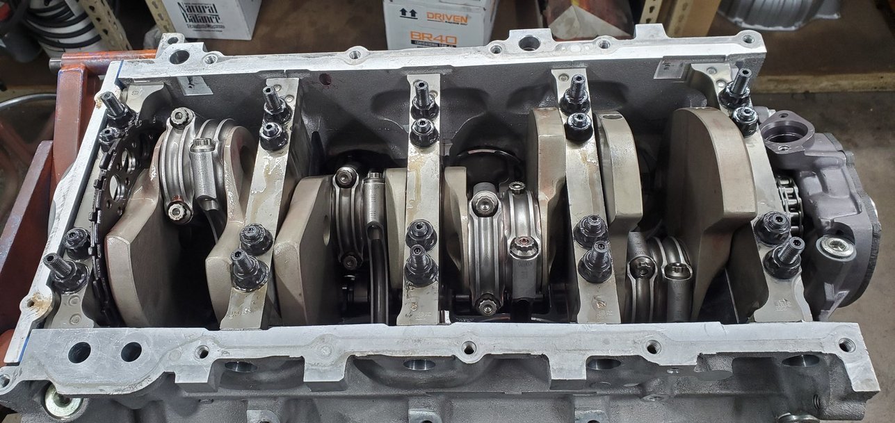

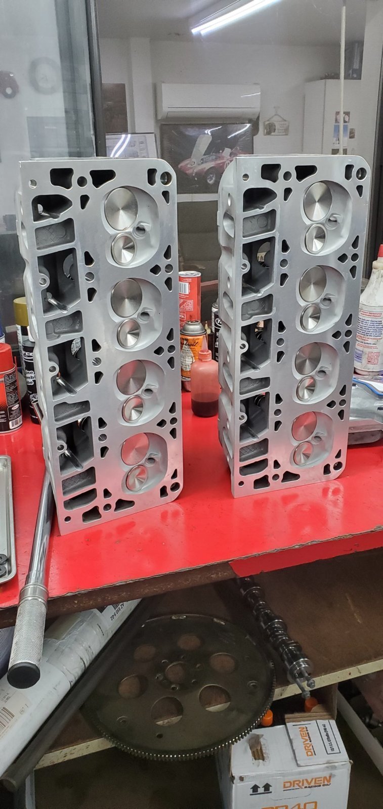

    IMG_7736.jpg IMG_7738.jpg IMG_7740.jpg IMG_7741.jpg IMG_7742.jpg IMG_7743.jpg IMG_7744.jpg

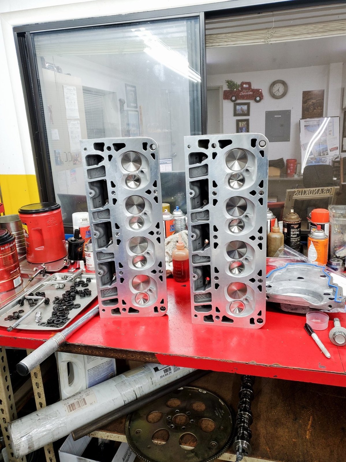

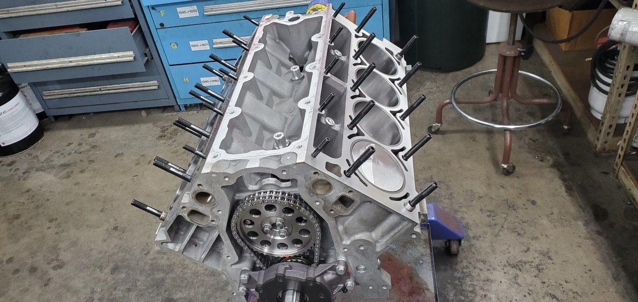

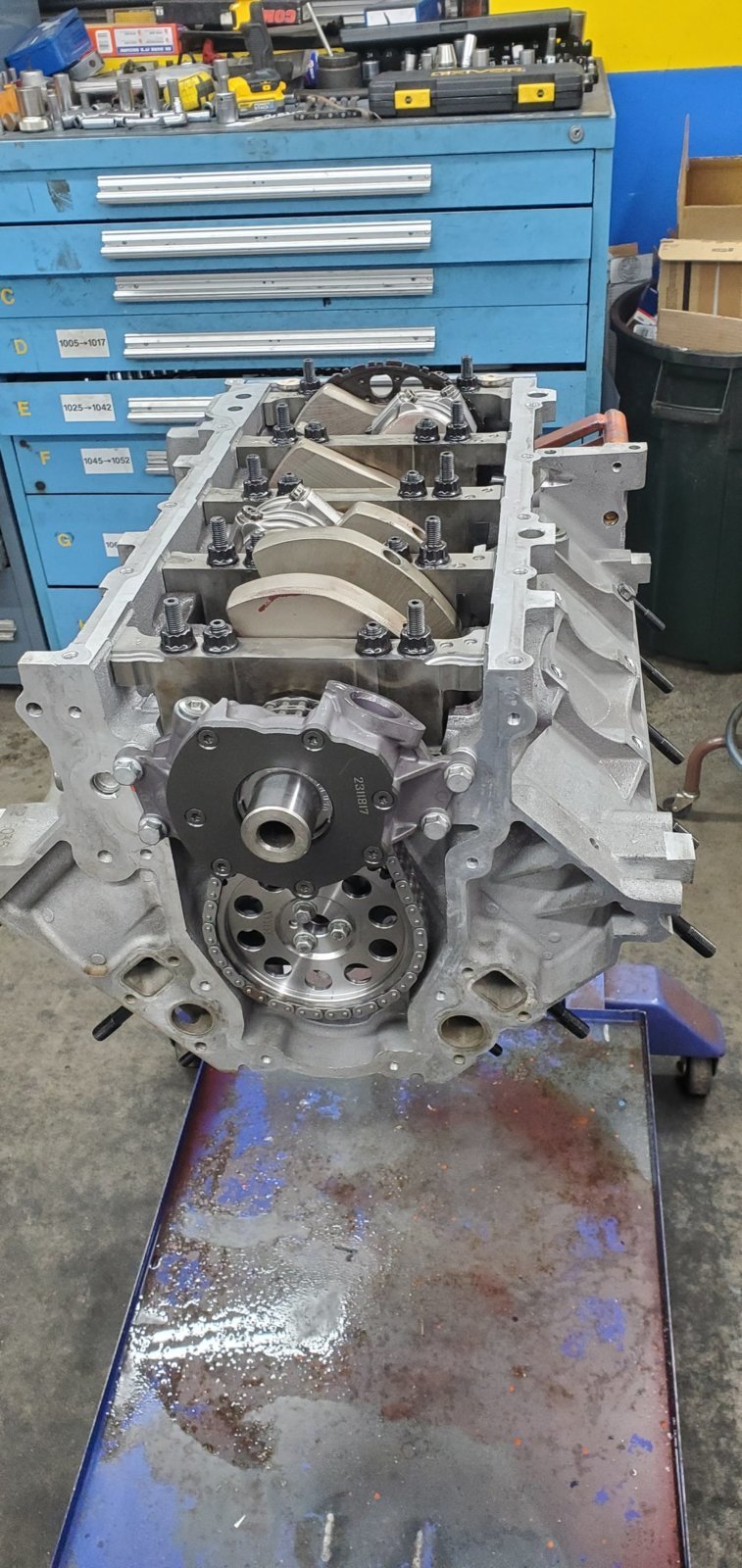

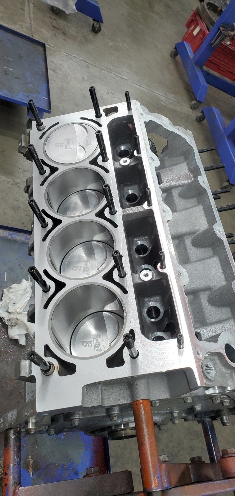

    Just got word that the engine will be ready to pick up on Wednesday. All thats left are the push rods. He has the length and can get the engine bolted together!
    this thing is 6.3 liters of beauty.

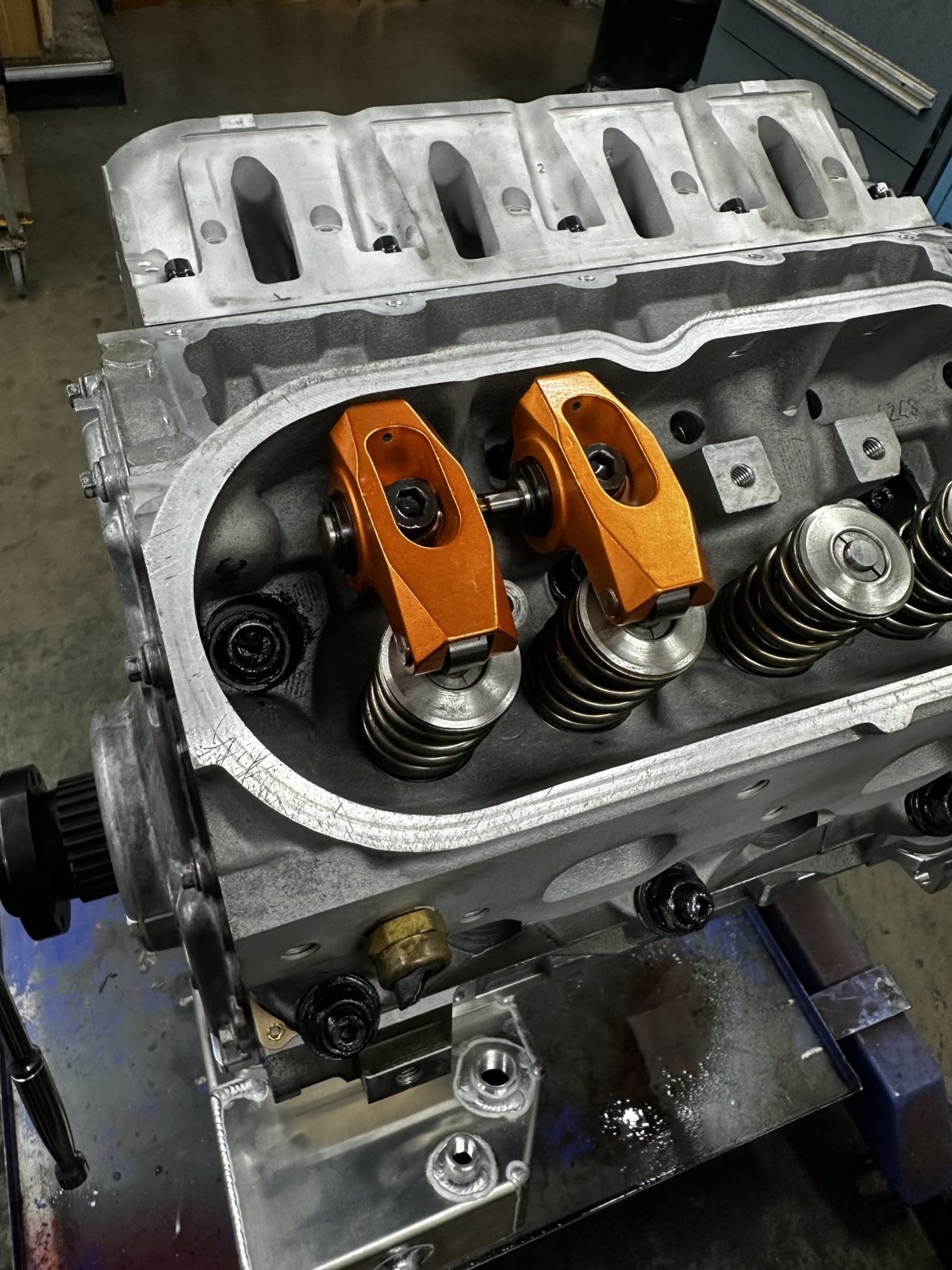

    Reviving this thing to 10k.
    Roller rockers are beeeeefy

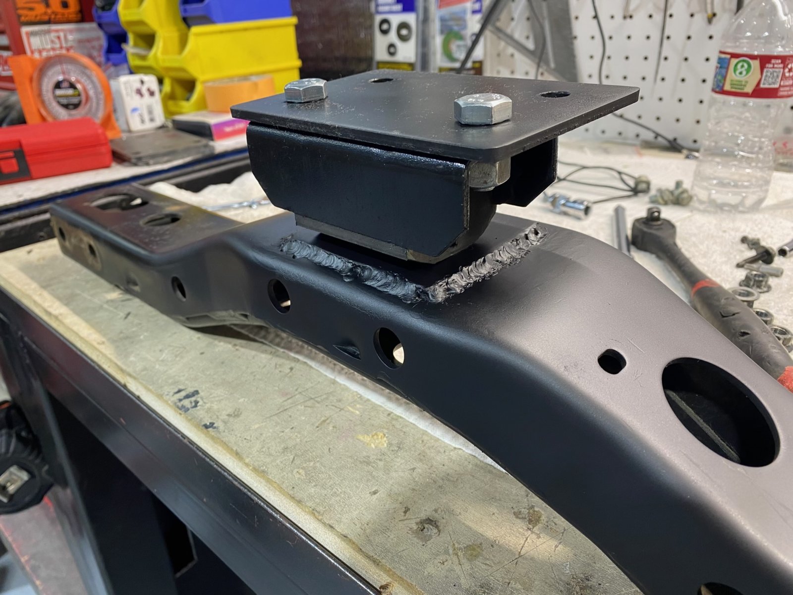

    Sure not a problem. Will take
    Some tonight.
    trans mount is done off of my transfercase, but I basically just have an extension off of the stock cross member. Lined up perfectly by coincidence. I doubt his mounts will work for 4x4. The front diff is in the way.

    This is all that was needed to mount the Tremec TKX to the OE trans mount.

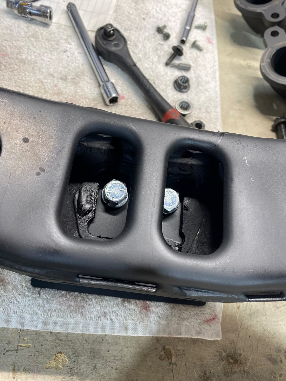

    huge thank you to JD fab for taking these tie rods back and lengthening them for me. Given the circumstances, they had no obligation to help me out but they did free of charge anyways. Stand up guys over there. New tie rods fit perfect!
