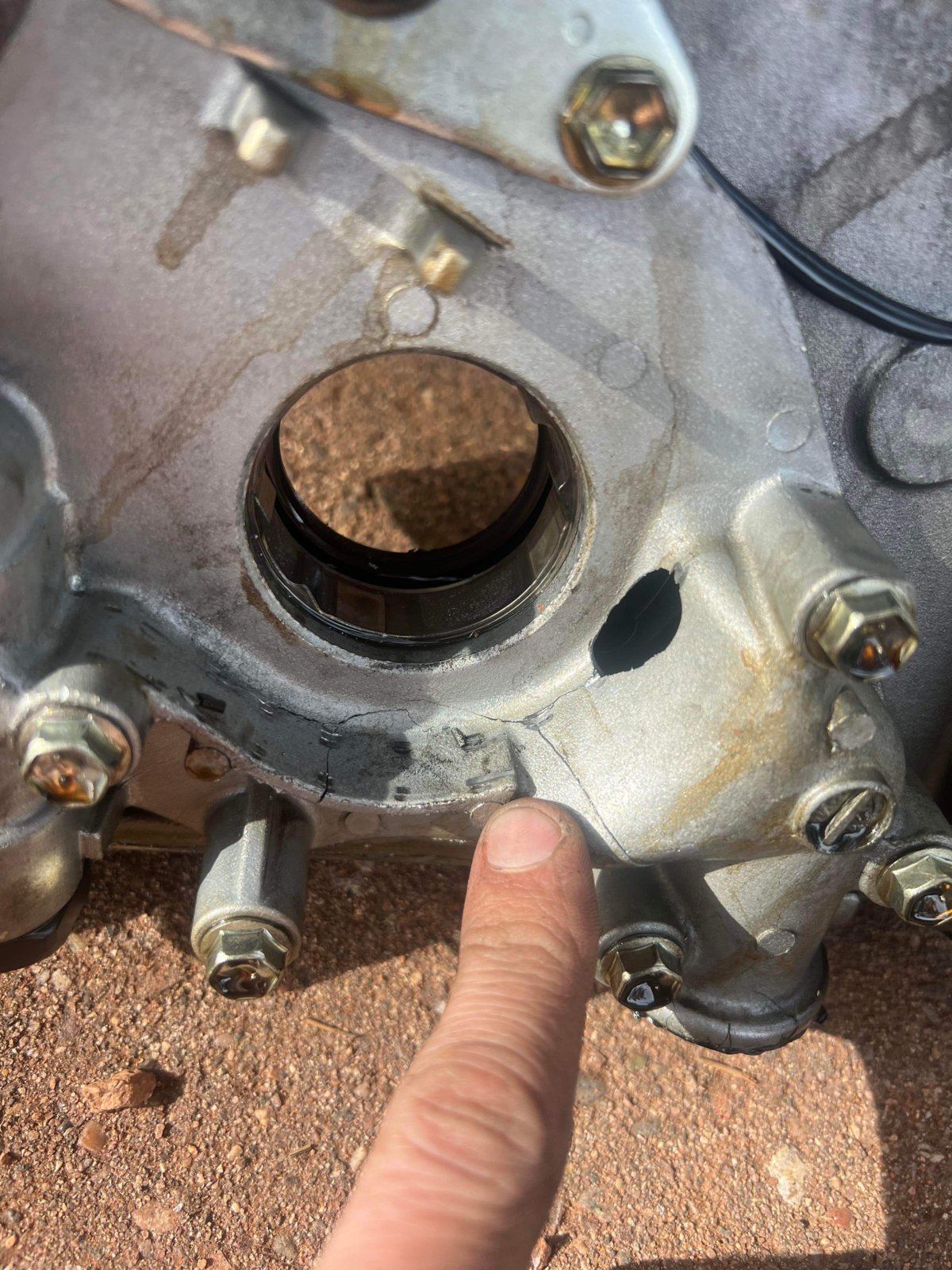

    The gentleman I sold my original 4.0 V6 to took the engine apart finally and lo and behold. Massive hole in my oil pump. You can actually see the chain marks on it too. Looks like a tensioner failure. Maybe vvti failure. Maybe chain stretched so huge. Maybe all 3. But that’s why my engine blew. Oil pump failure.
