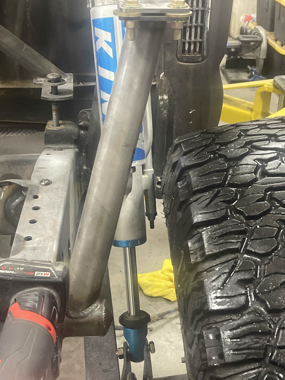

    Current clearance with my 1.5" spacer, need to get a 2" just for a little more wiggle room.

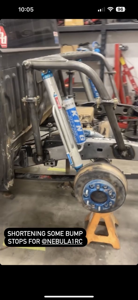

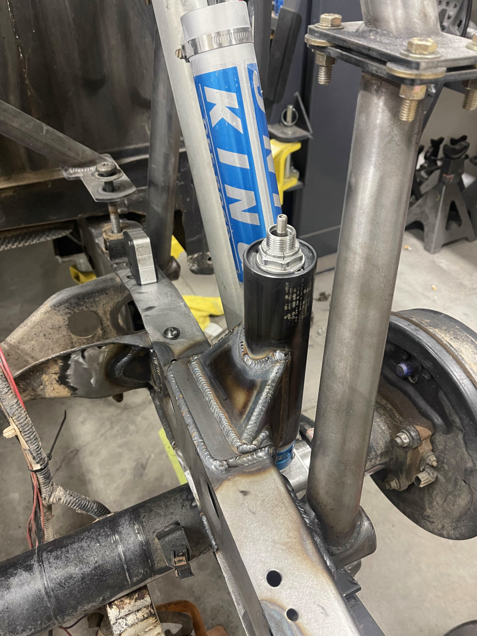

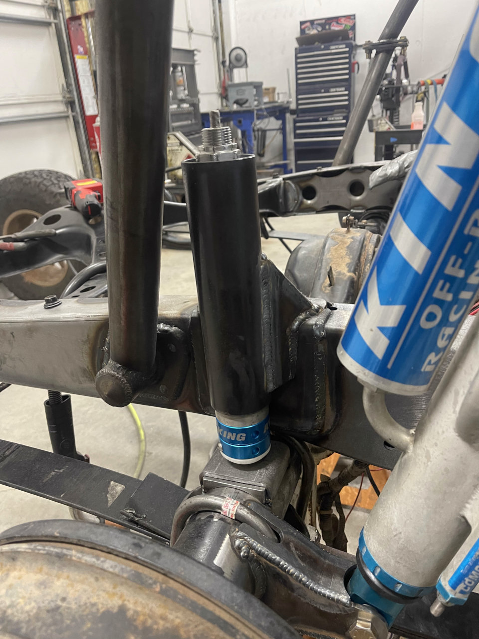

    Bumps installed and shortened, they were originally a 4" stroke, but 454 explained to me that he added a bigger spacer in there to effectively make the bump a 2" stroke. Gives me 2 more inches of up travel that is exclusively tunable via the bypass, rather than the bump. Makes sense!
    TBH, I don't really understand much of this, hence why i'm not touching the truck during this process. Well, really, now that Im thinking about it, I really have no business doing any of this, the LS swap, the suspension, lol. But I guess you gotta learn somewhere. You don't know how to do something until you do it.

    From the pictures you are going to have to move your shocks waaaay further inboard to avoid any tire rubbing on the shocks.
    Mine are moved about as far inboard as possible without the shocks hitting the frame during articulation, and with the tire stuffed they still rub quite a lot, and I only have 2.5 smoothies. With your bypasses they stick out even further. For no rubbing, you'll realistically need to notch the frame and move the shock even further in.
    This is just for articulated travel. Straight up and down isn't a problem. I am running 37s, which makes it worse, but they still rubbed with 35s as well

    He did a full range of travel and it cleared completely, I know it looks close. Even with tire flex I think I'll be alright how it is, but Ill definitely be adding a slightly bigger spacer to give myself a bit more clearance.

    I'd love to see a picture of one side drooped out and the other side fully compressed, cuz it doesn't make any sense to me how you have ~4" of shock stroke left, and 1/2" of clearance to the shock and it doesn't rub when compressed any further.
    Either way, the fab work looks great and I'm sure these guys know what they're doing, I just haven't been able to get tires to clear at full articulation very easily.
