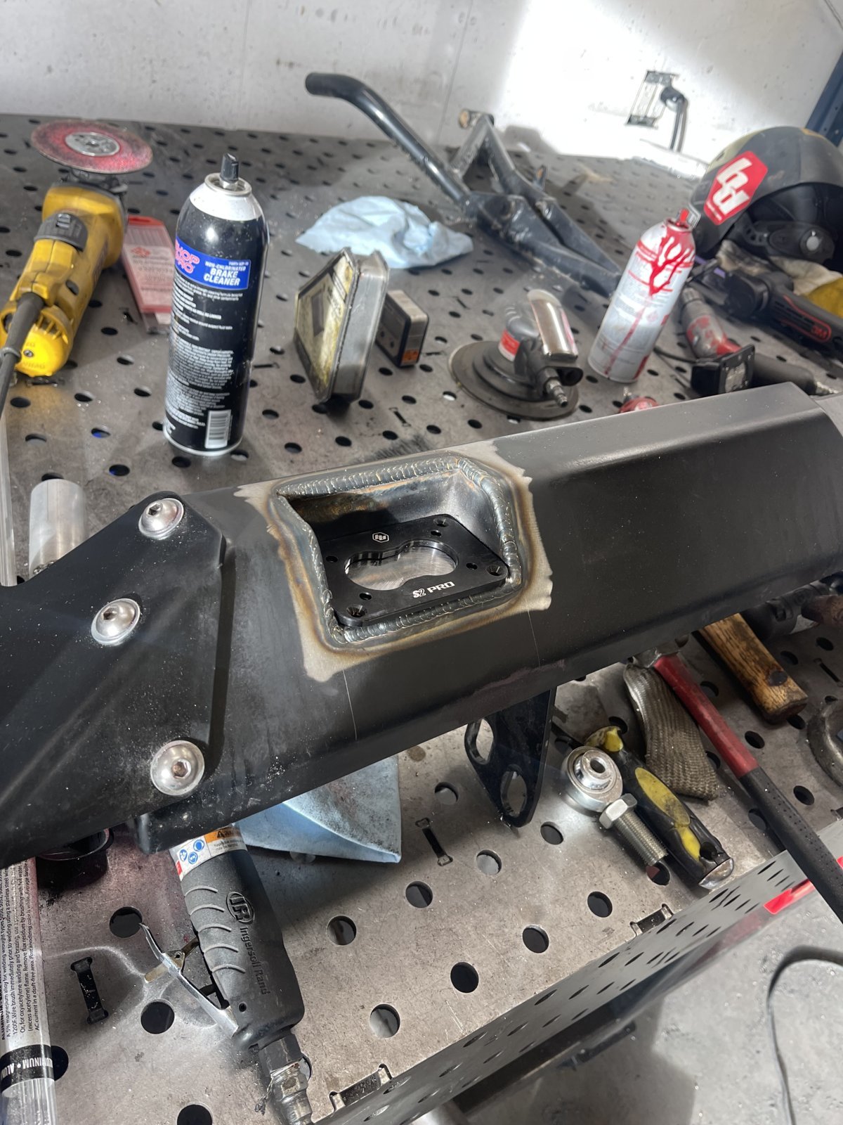

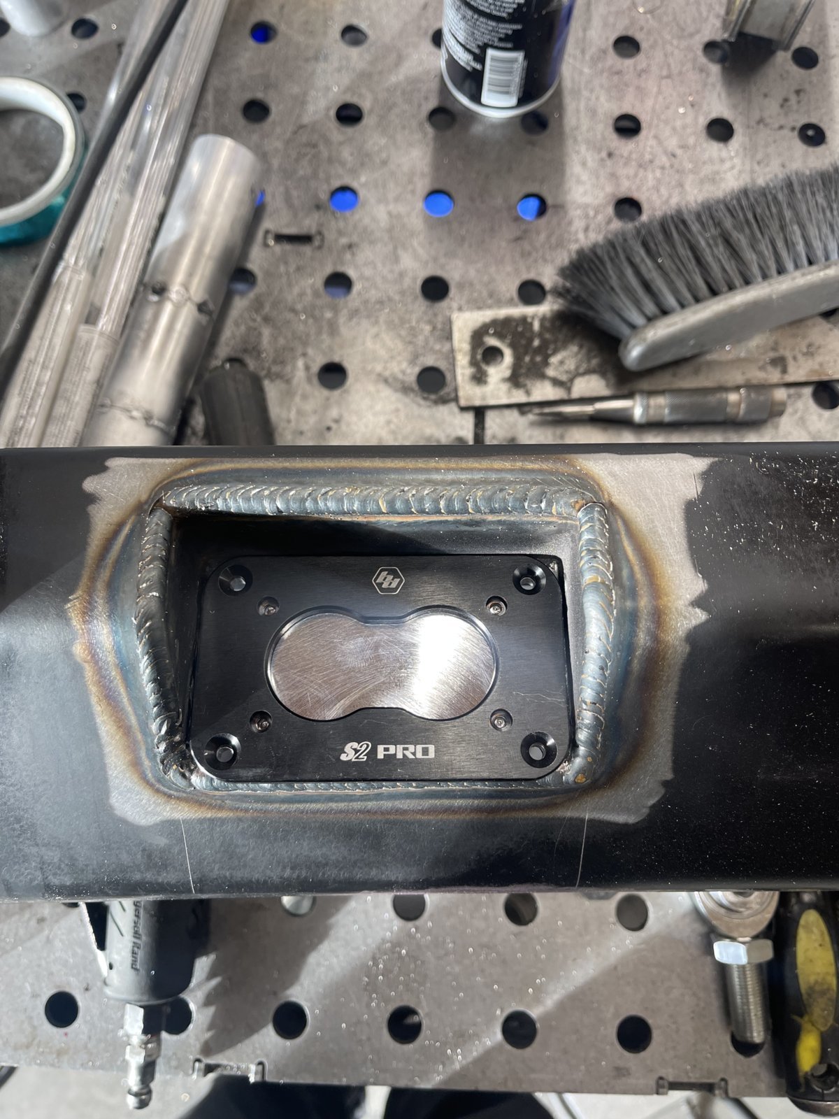

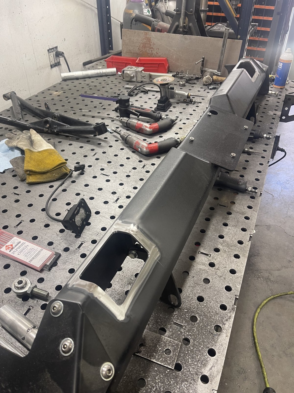

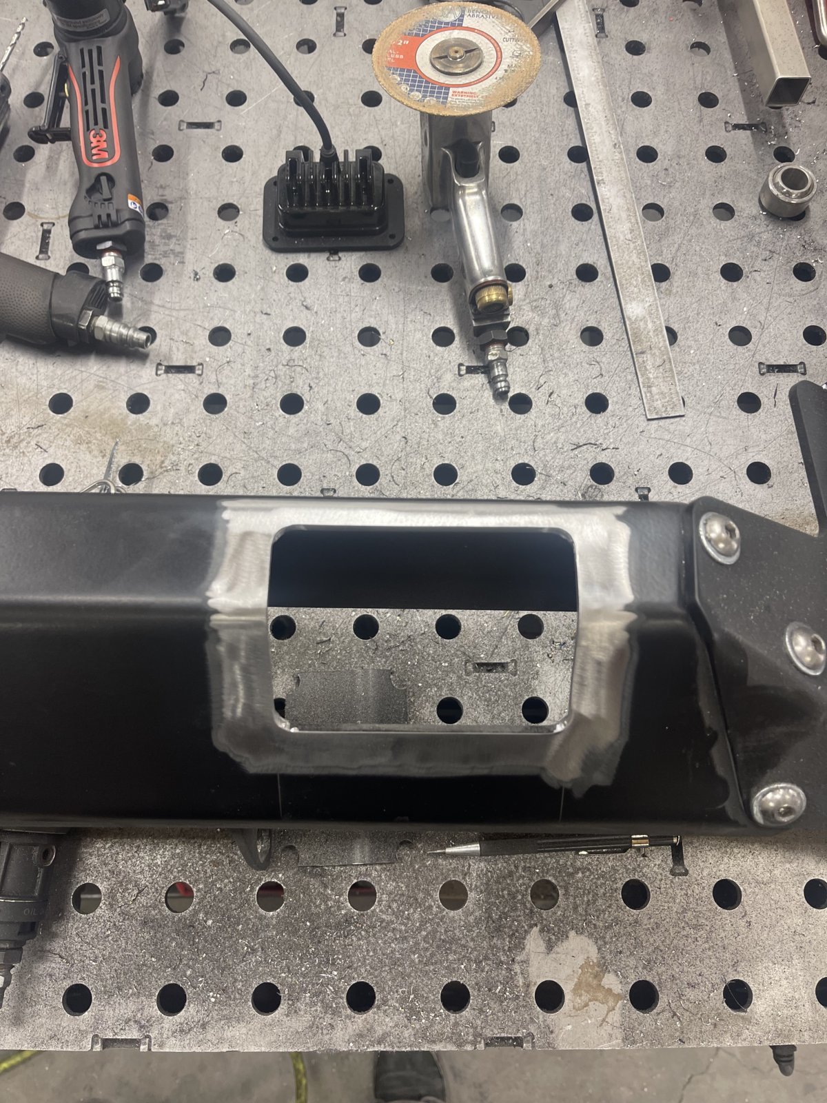

    454 killing it with the @Baja Designs S2 pockets in my Mazzula rear bumper. Meant to have him do this in January of last year when he threw the bumper on but I forgot to mention it :rofl:
    It’s looking killer.

    > BUILD LINKS >
    Does 454 do Tig? I've been wanting to modify my front aluminum bumper with full hoops and some flush mounted s2's for ditch/cornering lights. If so, one more reason for me to finally reach out to him/get the truck over to him for last little dial in details.

    I think I see some tungsten sitting on the bench behind the bumper so looks like it. Shoot him an email or PM him!

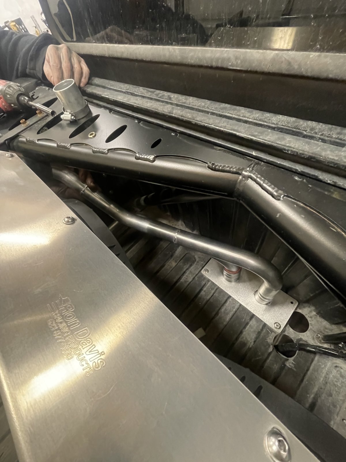

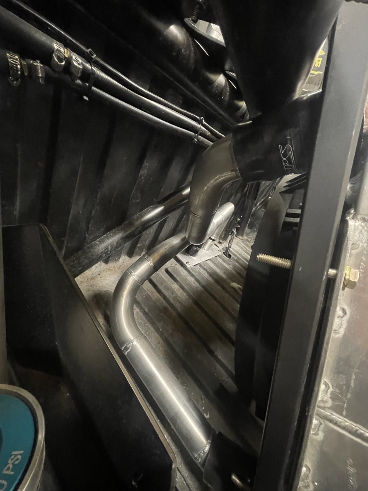

    Coolant pipes are pretty much wrapped up.

    Are there going to be support brackets on the rad feeders. It looks like there's flex joints at the rad and the bulkheads in the bed. Once filled with coolant, that will be a lot of mass to vibrate around.

    The rad isn’t going to move around. It has. Small thin rubber isolator but that’s about it. The whole system is relatively stiff. Flexible where it needs to be though. That run of tubing your referencing isn’t as long as it looks.

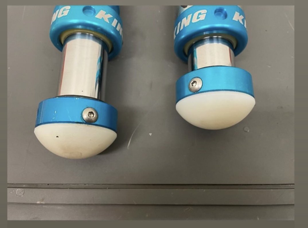

    Shorty bumps for the front. One day I’ll cage the truck and do engine cage and then bump off the upper arm. But for now, with the lower arm bumps, moved to 1” so I’m not constantly riding on the bumps on the street.

    Try making an aluminum radiant heat shield installed on the coolant pipes where near the exhaust. We use these a lot in aviation engines where the fuel lines run close to exhaust pipes. Very effective.

    I’m gonna move the exhaust further away from it
