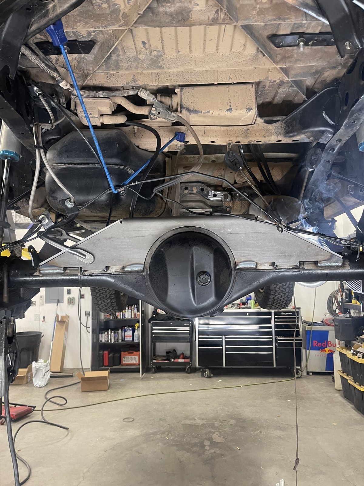

    Little by little. He said this part takes forever since you have to wait for the whole housing to cool to prevent warpage.

    Hopefully it stays straight and doesn’t bend on me until I can afford a full fab rear end.

    Oh definitely. I’m in a time battle because I am gonna need to regear soon, but if I spend money on Toyota gears I wouldn’t be able to use them in a ford axle. And have to buy gears all over again. Guess I could sell the 3rd member.

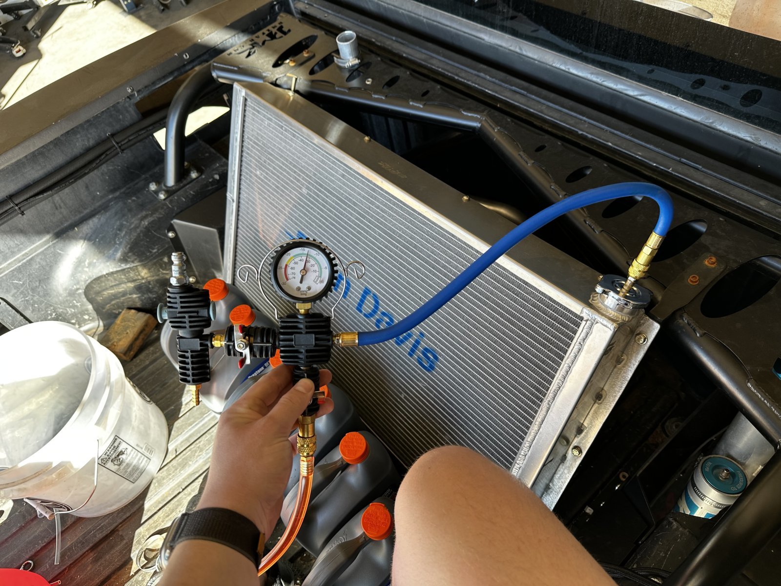

    Heading over to 454 tomorrow to see if we can vacuum bleed the cooling system. Everything will be done, but my bumper isn’t back from powder coating yet. Super super close. Haven’t driven this truck off road in a year and a half. Man I miss it and I’m so pumped to see how it feels.

    I went over to 454 tonight and we got a start on vacuum bleeding. Found a couple areas we need to work on a little more. Will give it a go next weekend.

    Everything is buttoned up and all the leaks are taken care of. tried a vacuum fill and still, we’re running in to the same problem I ran into
    Months ago, of not being able to bleed the cooling system. The new system 454 built does not have a full port at the front. In theory, it shouldn’t need one either. We can always add one, but what haven’t we tried? We lifted the rear end of the truck in the air, pulling the return line off engine and filling the block, manually filling the lines, pressurizing the rad to force fluid into the block, vacuum filling by the steam ports. No joy. He’s doing some brain storming tonight and tomorrow.
    I don’t even understand why adding the fill port on the “out” of the water pump even worked on the last setup. It doesn’t make sense, but it worked.
    Any ideas?

    Uh we just kept letting it run till it got hot and shutting it off then it eventually stopped getting hot. Problem solved?
    I drove it home so. Driving it to work. Temp stays right at 205. I have a huge laundry list of shit to do but I’m gonna start breaking in the motor now.
