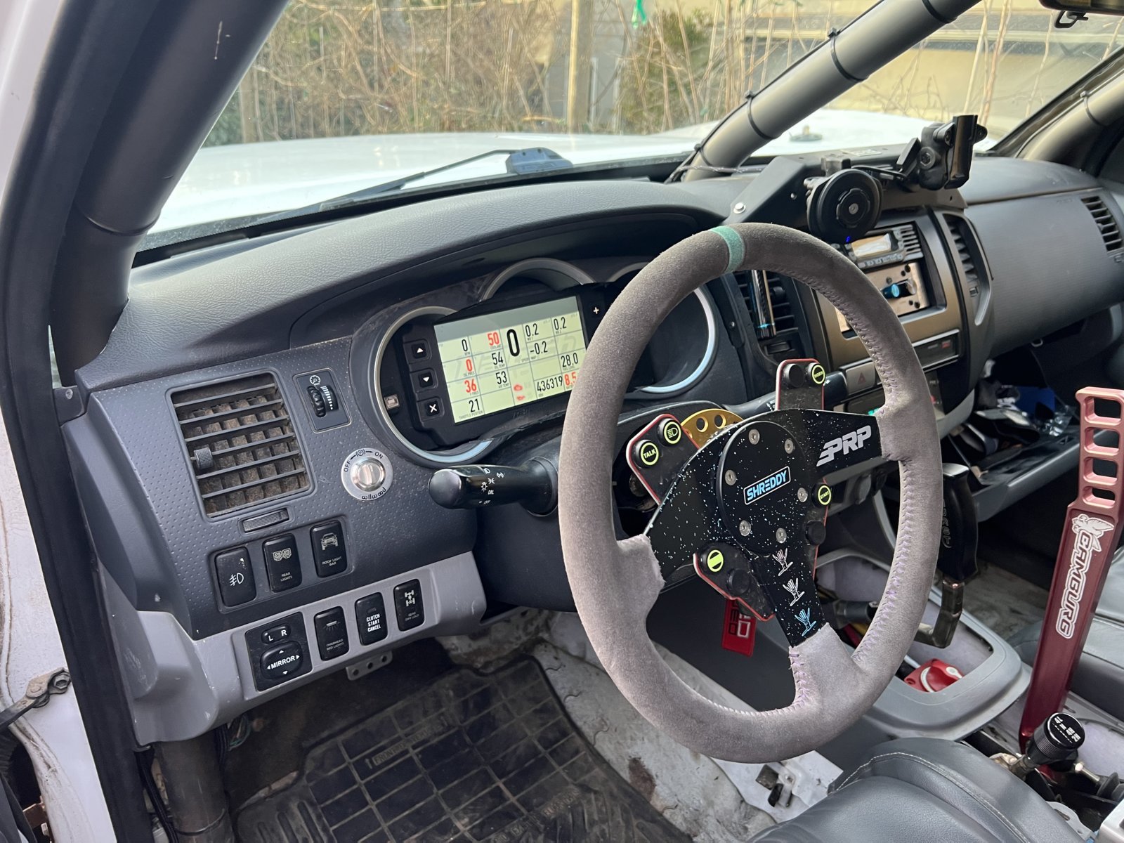

    one thing I want to figure out, and maybe @Dm93 can speak to this. The Holley has outputs for ECT, RPM, and Speedo. Piping these into the OEM gauge cluster isn’t going to give me any pertinent information because everything is going to be off. My RPM is like 500 rpm off right now.
    I want to pipe all the data into an arduino or something to adjust the inputs and output them correctly for the gauge cluster. Orrrrrrr I just nut up and buy the Holley screen and somehow mount it in the stock location, and then get the fuel level data from the sender into the ECU.

    You can use a Dakota digital box and it will adjust all your inputs so you can get them dialled for your dash. @tacotunner06 ran one so he knows more.
    Or do the screen.

    I thought you had the Holley little 3.5 in display that you could add display whatever data you wanted? I’m running a full haltech dash and ecu nowadays but for the stock gauges the Dakota digital box makes it pretty simple to get the rpm and speedo dialed in.

    BRO. that guy in that screenshot has exactly what I want my interior to look like. Even has the same shifters that I do. He probably didn’t have any of that made here in az though.

    I do, it’s currently rubber banded to my rear view mirror. I’m still terrified I’m going to lose oil pressure or start overheating or something. So I wanted it in my line of sight. Lmfao.

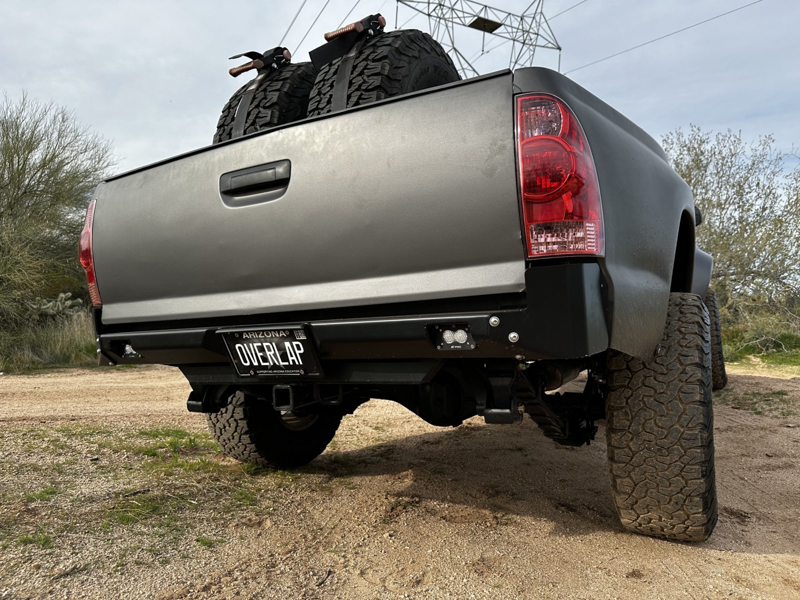

    Hey @Dm93 !!!!
    my tuner just setup a positive output for when the trans is in reverse!!!!!
    any idea where I should run that wire to that’ll kick those on for me?

    Is there a wire on the stock harness that recurves 12v when the truck is in reverse? It used to be an MT truck so there’s no range selector, just the reverse switch I’m assuming. If I feed that wire 12v my reverse lights should come on right? Just wondering where I can find that wire.
  13. Feb 20, 2024 at 5:04 PM
    #1053
    Dm93

    There’s my dash for now.
