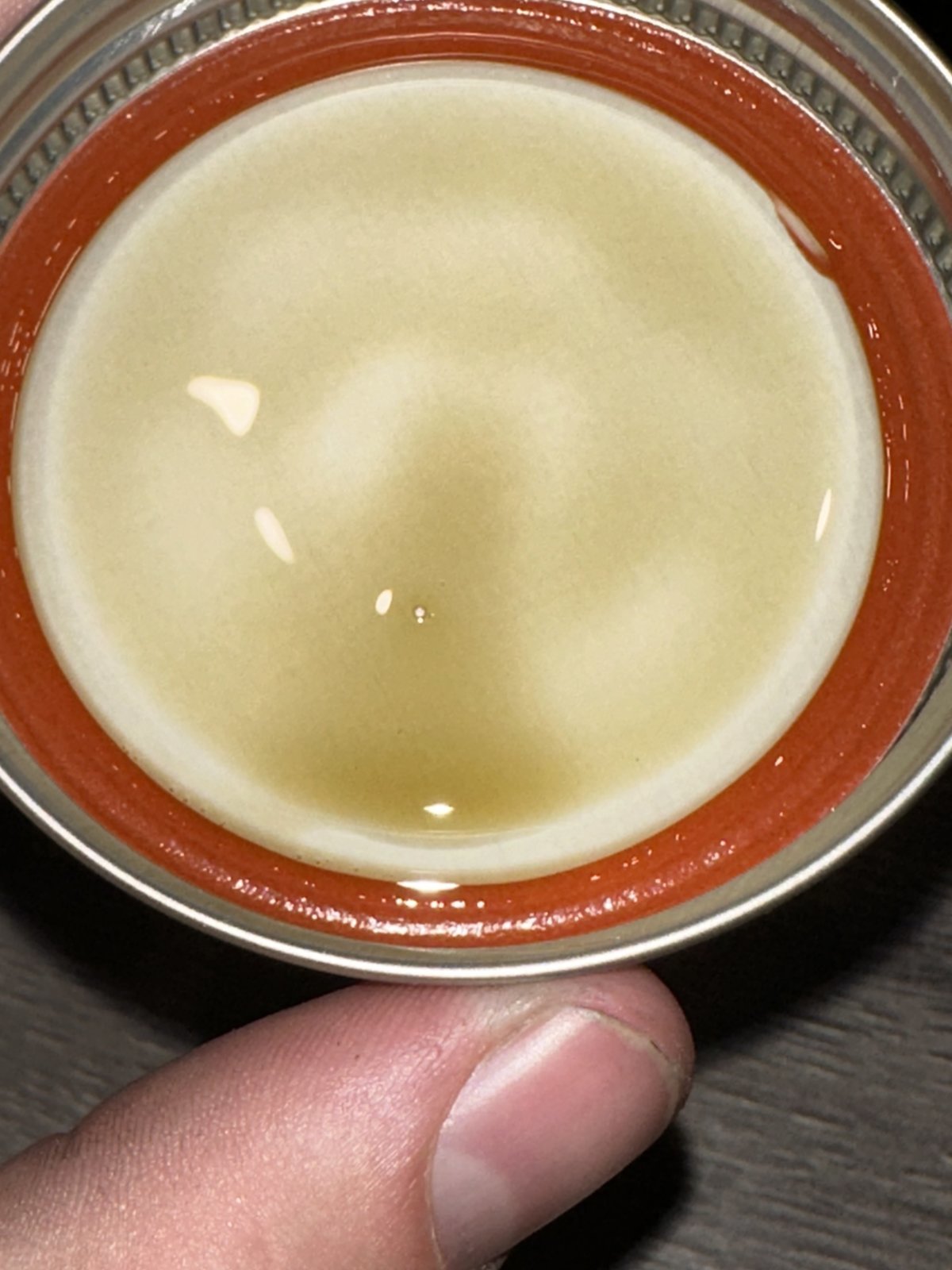

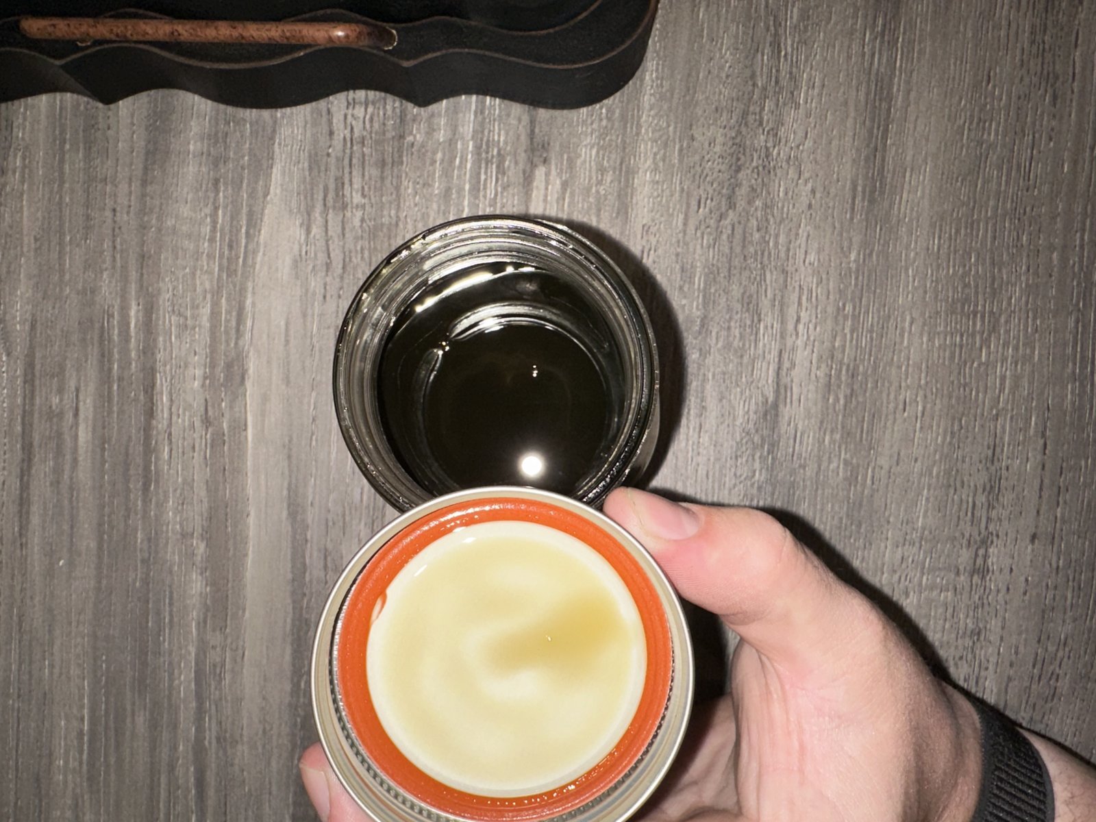

    First 150 miles are behind me, this is the oil. Doesn’t appear to be sparkly which is good. Drain plug magnet had stuff on it, which is normal I suppose. Brand spanking new engine, so I guess that’s pretty normal. The oil is pretty dirty though. This oil was high zinc break in specific oil.
    edit forgot to mention I’m sending the sample off to Blackstone to see what’s up. I’m really paranoid of issues.
    I replaced it with 10 qts of shell 15w40. Slightly overfilled this time, but rather have slightly too much than not enough.

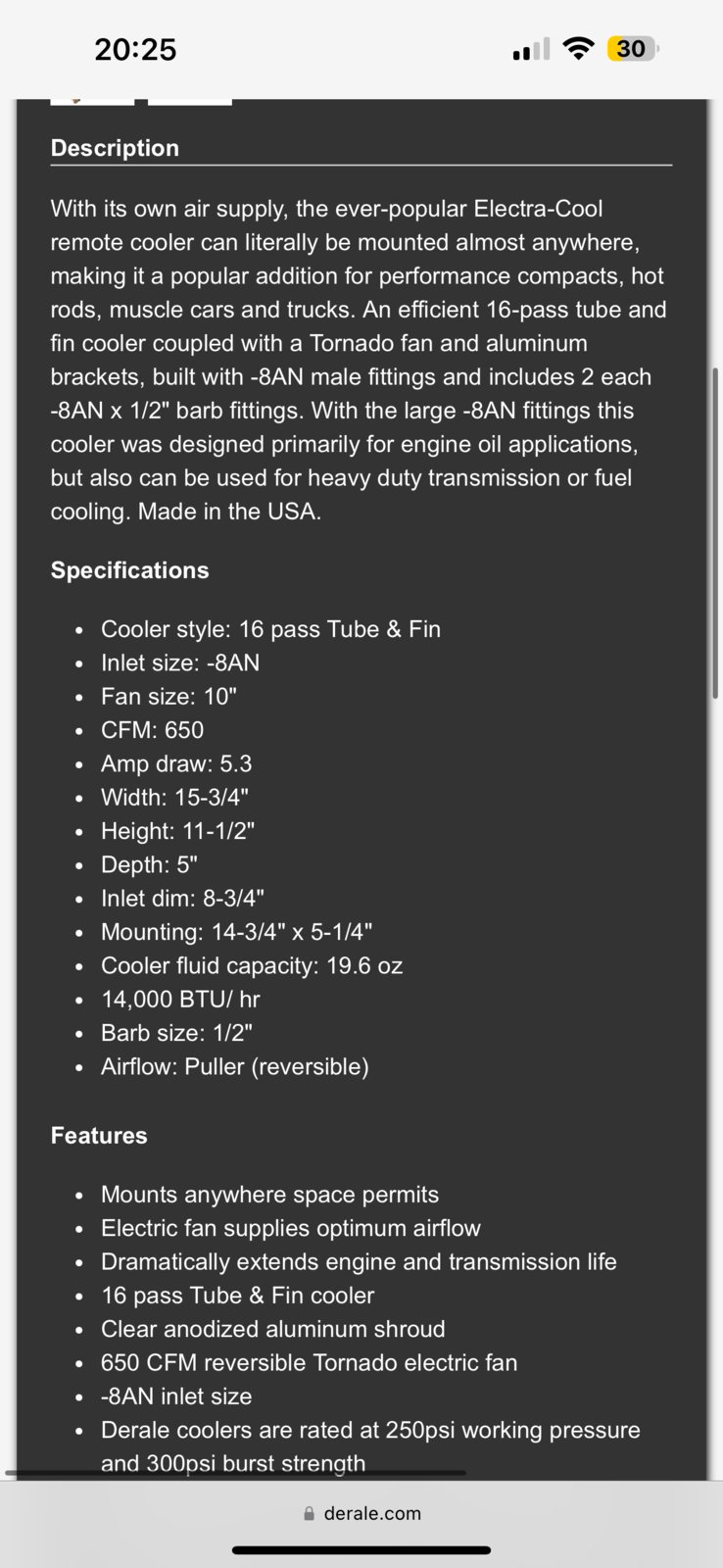

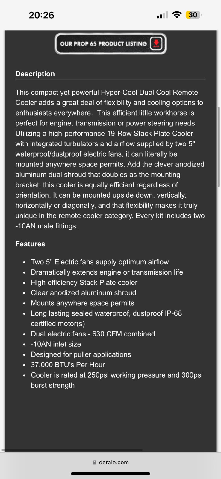

    Uhhhh
    you’re 15800’s: IMG_0904.png
    times 2 is 28000 BTU’s
    my 15845:IMG_0905.png
    37,000 BTU’s.
    am I missing something? My cooler setup seems like it’s a whole third better than yours almost. Maybe we’re both screwed?

    That makes sense, cuz a converter only really creates heat when its slipping, so when you're just driving normal it's not slipping. Going up hills it will be slipping a lot more and heat up.
    yep might both be screwed lol. That's crazy the difference, seems like yours has way less surface area and half the fan area, but what do I know

    I have no idea man. Btu might not even be the right spec to be looking at.

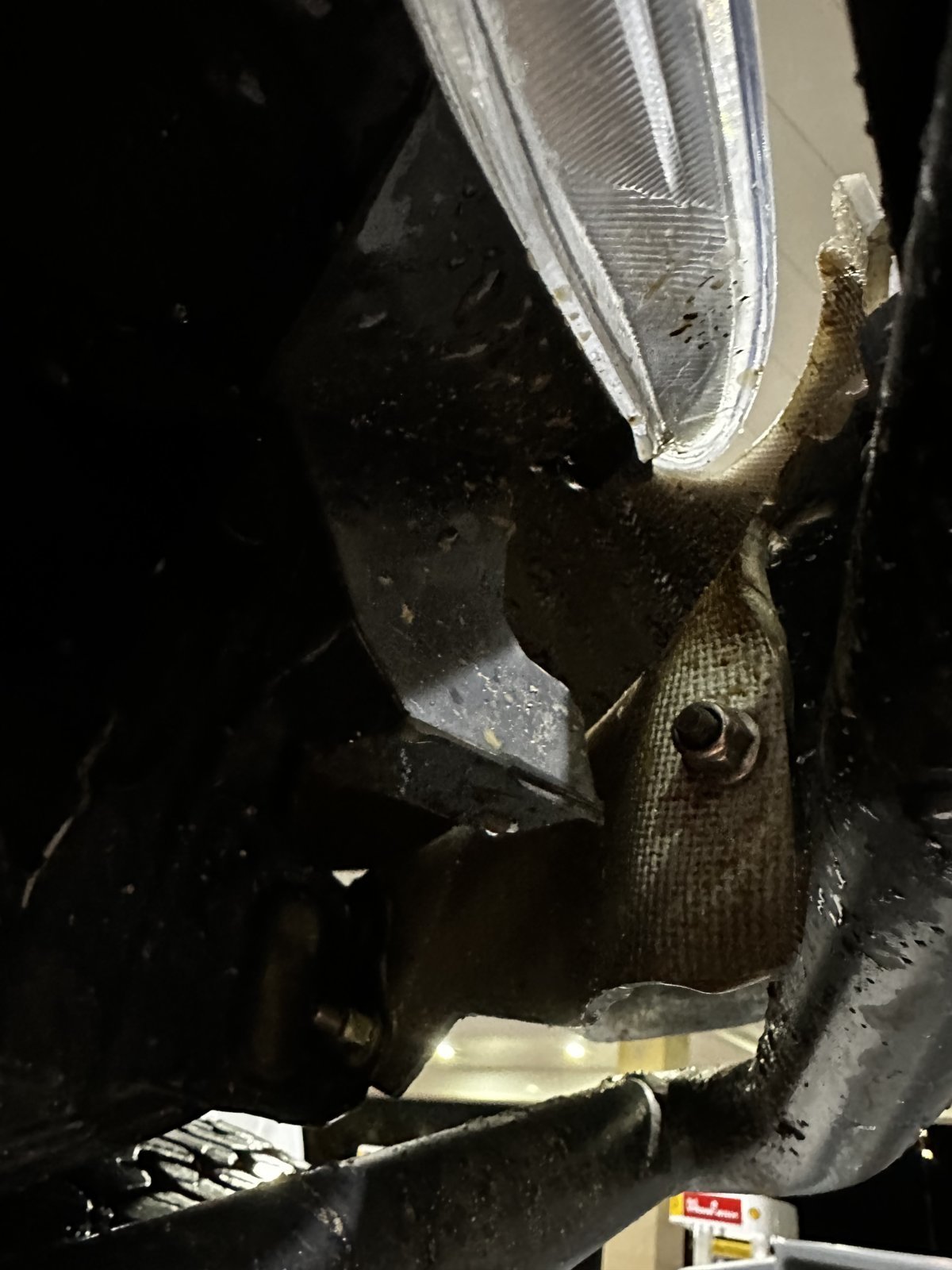

    Welllllll, first rips on the truck. These videos don’t do it justice, average speed was probably 40-45 mph. Covered about 2 miles in the video.
    officially broke the truck too…..
    The driver side headlight is no more. Broke 2 of the 3 mounting tabs. Crazy how fragile that shit is. I don’t really know what to do to prevent that from happening or how to fix it without replacing the headlights.

    one thing to note is @WormSquirts fans flow as much cfm per fan as your both your 5" fans which will make a big difference.

    Honestly i'm glad all this came up, learned lots about derale coolers. So mine are a tube & fin style. @Pittsy 's are a stacked plate style which is much more efficient. Basically, I cheaped out. But now I know.
    So I'm going to run one of these coolers for engine oil, and I'll run the other one on my Tundra as a tranny cooler (I've been needing to do that badly anyway). I will order two more coolers for my trans. I've already cooked one stock trans, and this one will be run a lot harder, and I paid a lot for it so don't want to risk it.
    Probably two of these at 46,000 btu each: https://derale.com/product-footer/f...ne-oil-cooler-kit-with-spin-on-adapter-detail
    Or maybe save a couple hundred and just run one of these: https://derale.com/product-footer/f...rs/hyper-cool/hyper-cool-extreme/15870-detail
