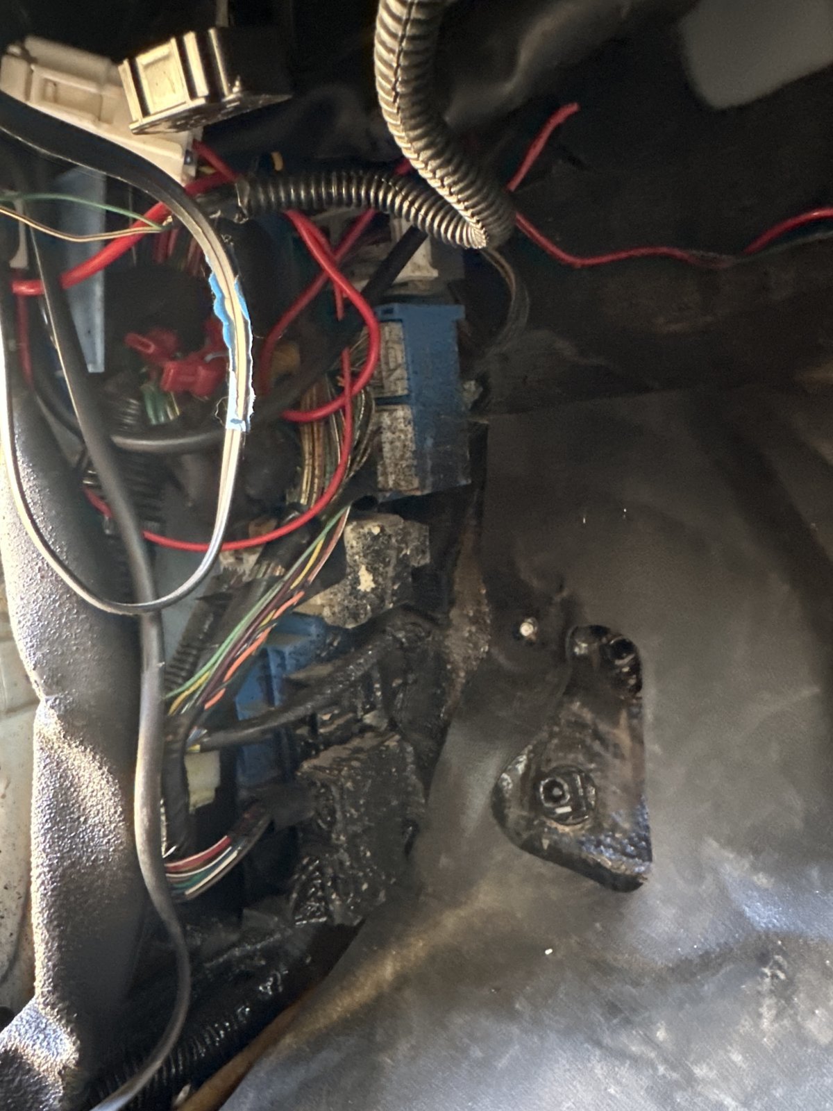

    Do you have a pic of ID2? I don’t think I’ve touched that one yet so I don’t know what I’m looking for. image.jpg

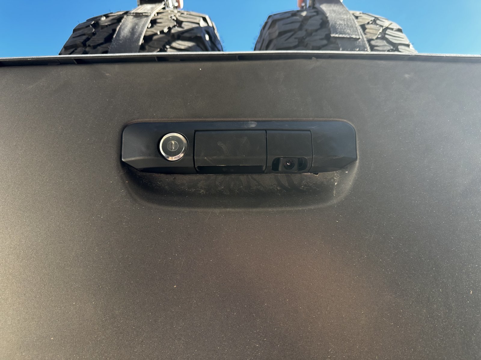

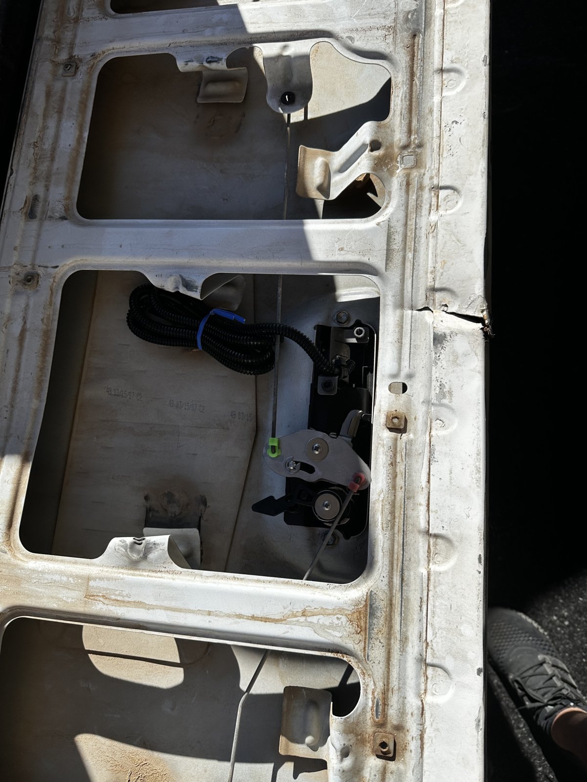

    Lockable tailgate handle with camera installed. Just wired it all up. Gonna pull the reverse signal from the Holley over to that pin @Dm93 mentioned if he can send me a pic of that connector. I unfortunately do not know what I’m looking for.
    edit, I found it, but when I wired it up, nothing happens. I think I need a relay in line. Is there a good 12v source from ID1?
    double edit, I pulled a source from my engine bay. Disregard.
    I think the Holley trigger isn’t acting as it’s supposed to because reverse lamps still aren’t coming on.

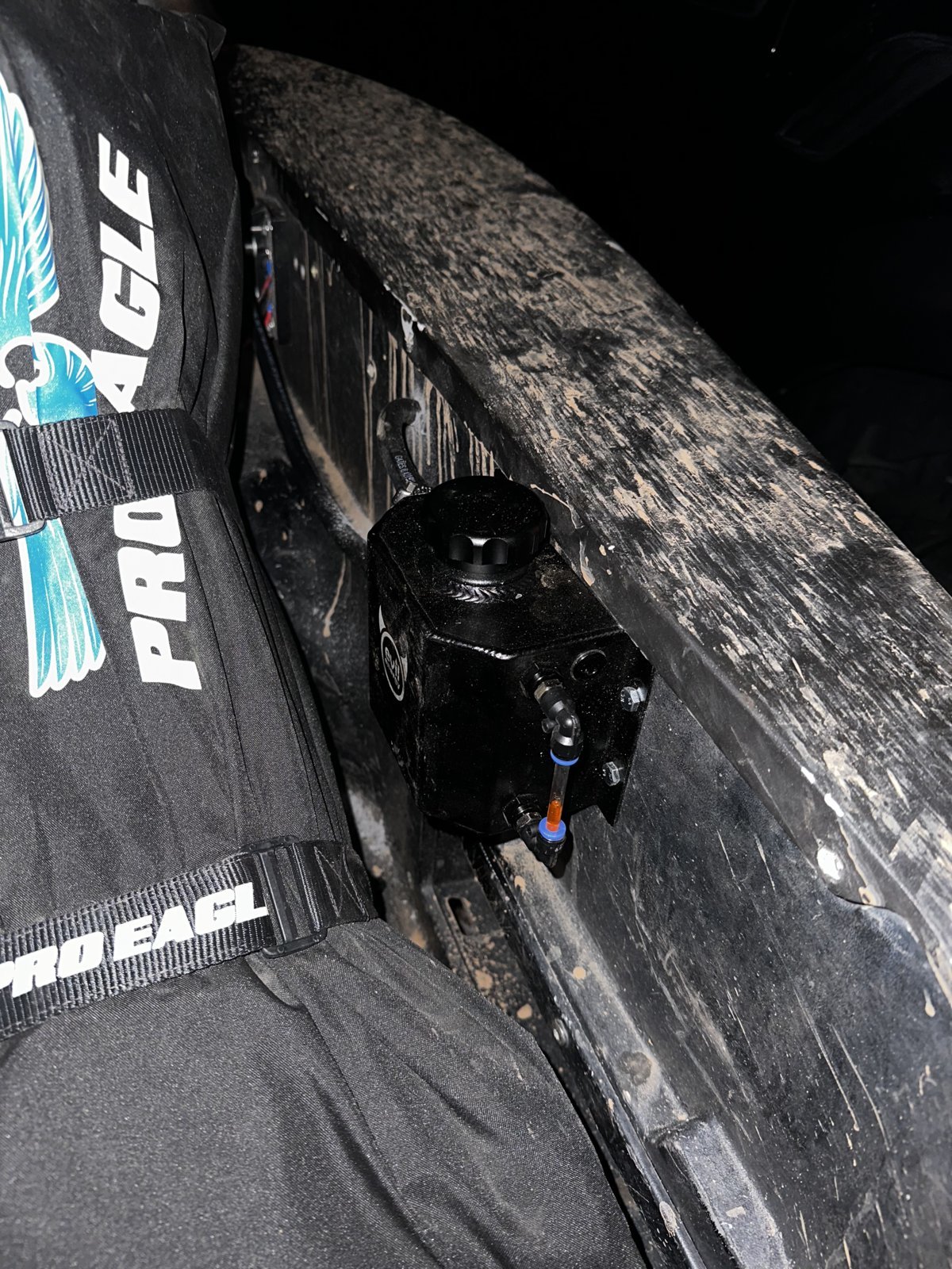

    Expansion tank installed.

    Should be the 2nd one up from the bottom.
