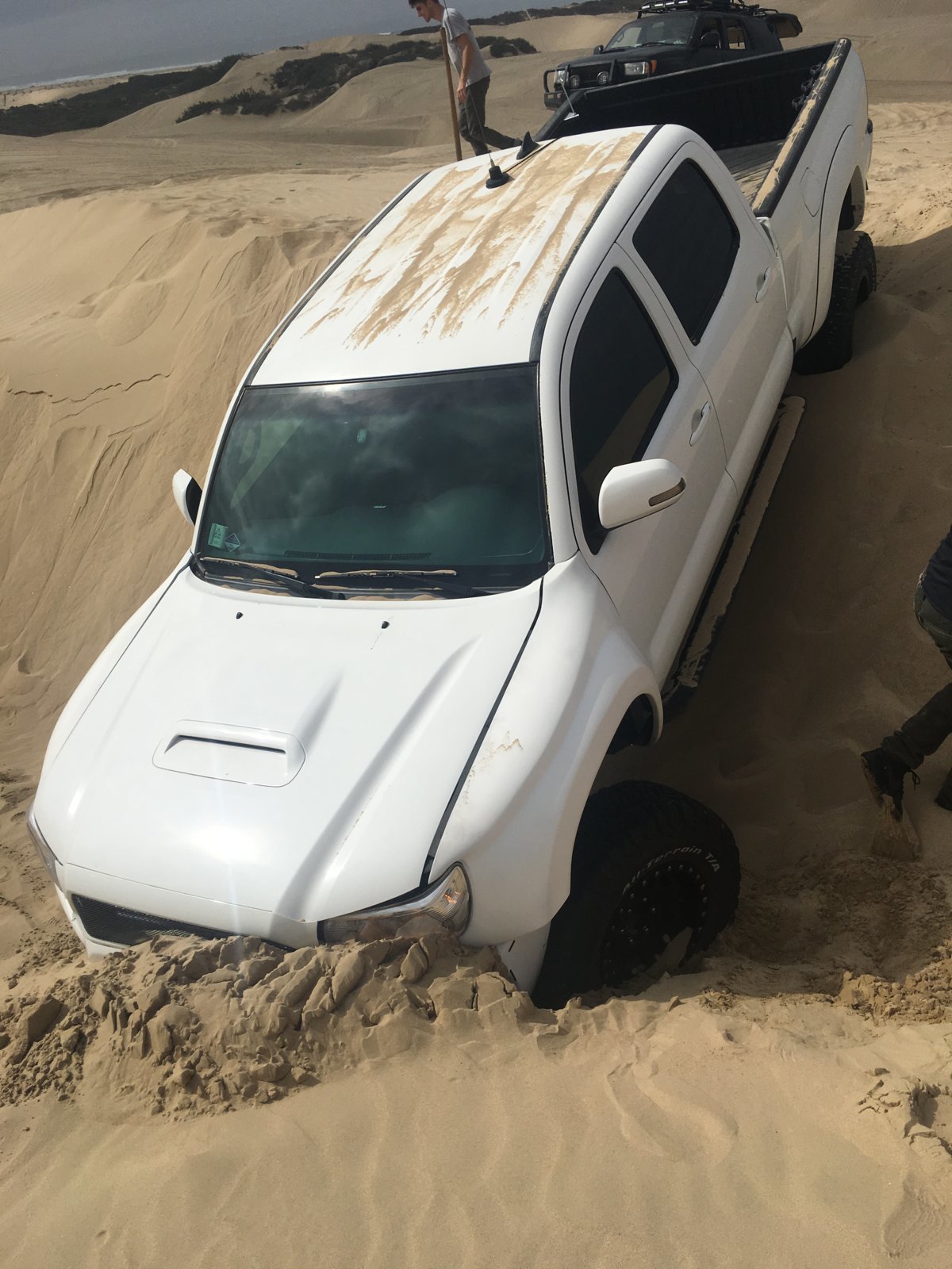

    Like I said there’s a special technique to running the dunes! NEVER CREST a DUNE at a 90‼️ ALLWAYS GO OVER a CREST at A MINIMUM 45 degree angle. Run a circle until you’re at the top then over to the other side. Think of a long winding turn. It’s really fun when you learn the technique!!

    This is why I’m scared to go to the dunes lol. I’ve never been and don’t want to be *that* guy that gets someone or myself hurt because I didn’t know what tf I was doing, or was in the wrong spot at the wrong time.

    It’s really not that difficult‼️ Just watch some YouTube videos and you’ll catch on. Buy a whip and mount it. Like I said don’t drive straight over the dunes just remember to crest a dune / hill / blind spot at an angle. Plus driving in big loops, is what makes it FUN‼️ When weather conditions permitted I would literally wear Motor Cross boots, (Starting the 2 stroke 500 w/ lots of compression) helmet, gloves and swim shorts when I was 160 lbs before I got old & fat! On the 500 you just need to learn to move your butt side to side. The lower off the side of the bike the faster you could do power sides. Plus razors and sand skates II helped a lot! Straight paddles, would high side you. Little straight paddles are for racing in straight lines. I used to love putting Yamaha banshee’s in place. Oh, the good old days when I made fair money.

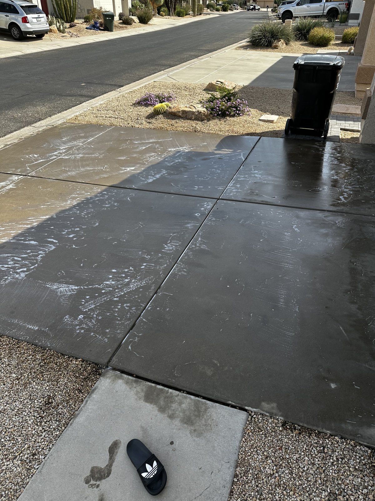

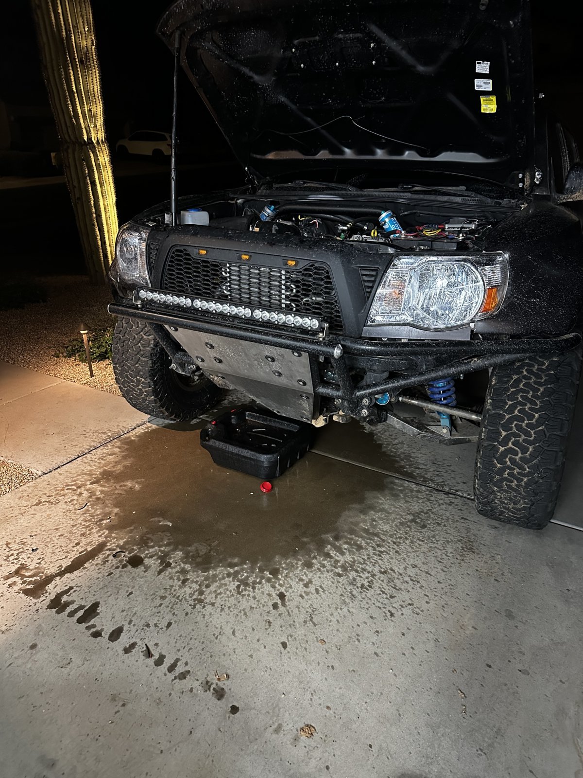

    Just bled the cooling system. The trick is to vent the steam port manifold and then it’ll work. Idle temps are now 185 driving temps are 180. Much more comfortable for AZ driving.
    also, now that this ole girl is done leaking…
    Can finally clean my driveway.
    I forgot to take pics of this, but I pulled out the 1/2” plug in the oil pan and replaced it with a barb fitting, and hooked my catch can up to it with a one way valve, so when the engines off it’ll drain into the pan, and when it’s running the vacuum system will still be sealed.

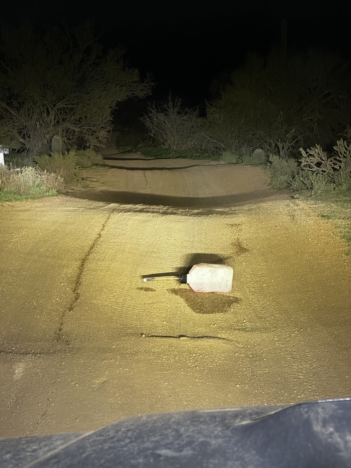

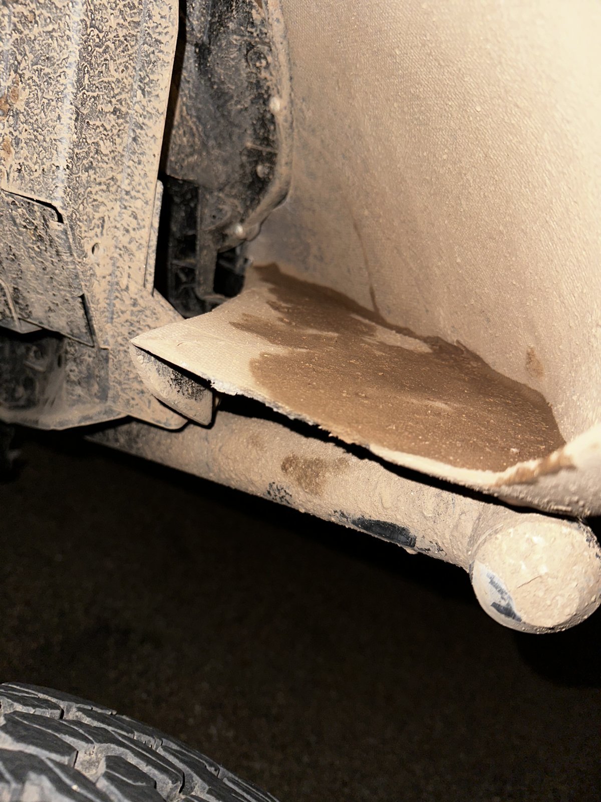

    Figured out the crunch noise from those videos. I’m chaffing the fiberglass. Super easy fix, just need to trim it away about a half inch and I’ll be good. Looks like some slight rubbing on the bumper but it’s not audible in the cabin at all.
    Also bucked my coolant jug out of the bed. That’s a first. Guess I need a strap or something.
    ripping this thing is fun though.
