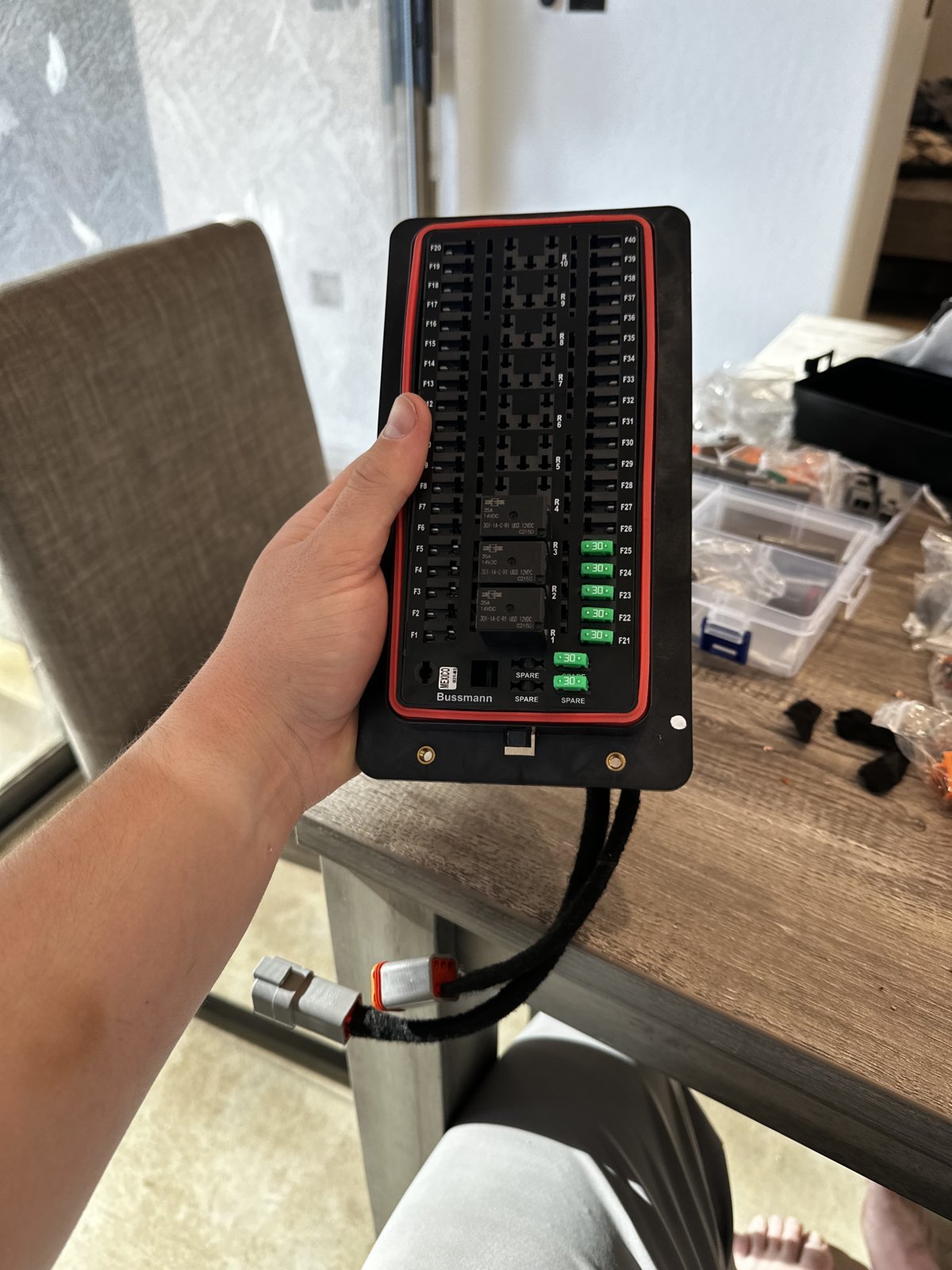

    Bussmann Fuse box arrived. Started putting it together for two ground trigger relays and 1 positive trigger. IMG_1110.jpg
    nice and neat with deutsch connectors.

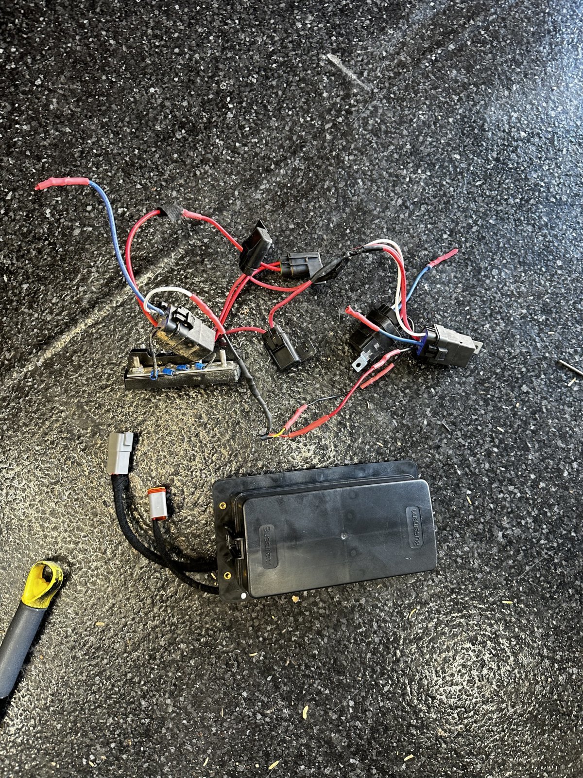

    this is what it replaced. I used to have An Amazon fuse box and it shorted, so had to make relay fuse spaghetti.

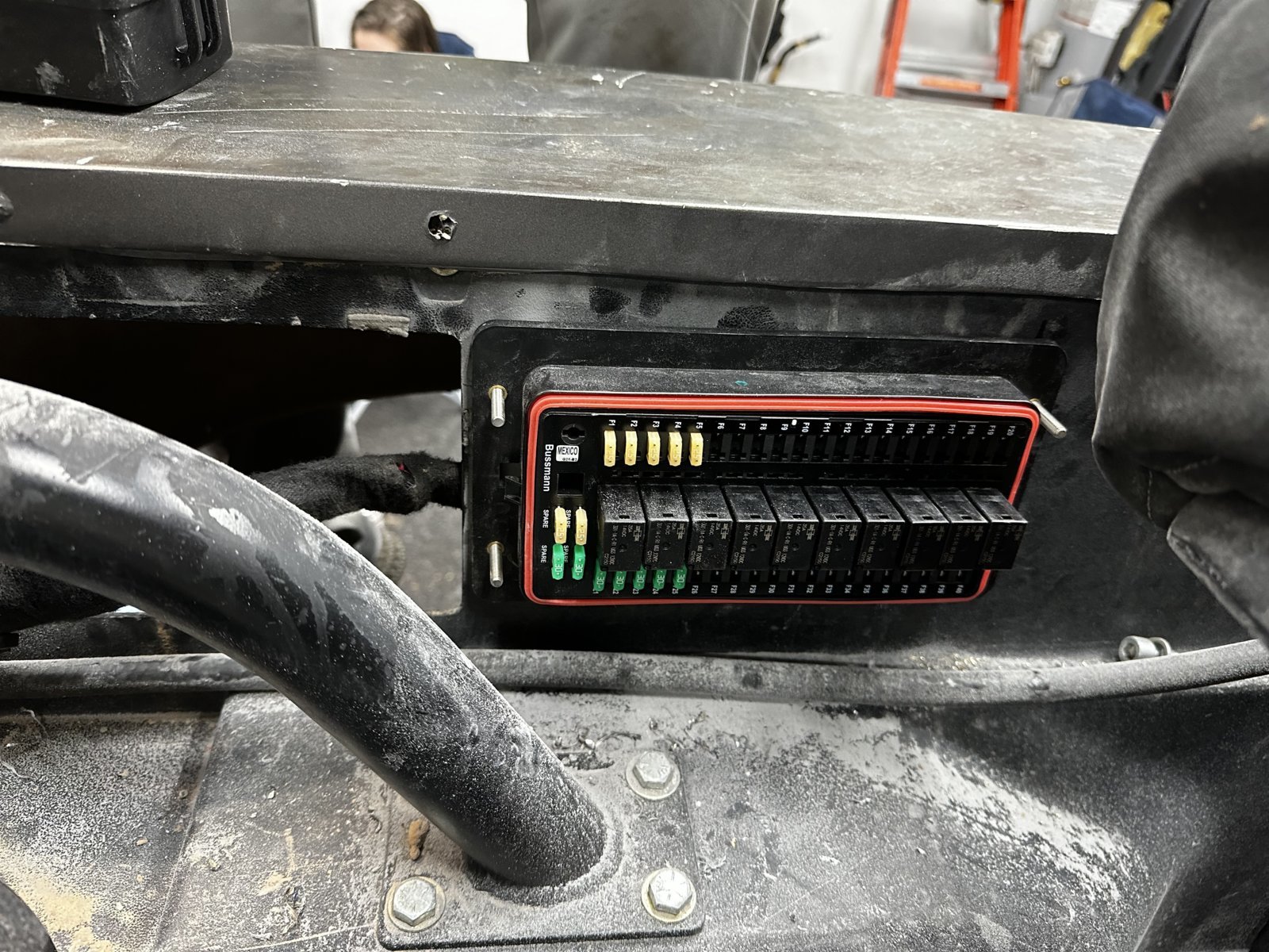

    installed in the bedside. I need to put the filler plugs in still, and put some abs sheets over the holes in the bed next to the fuse box. But it’s a super clean install and works great.

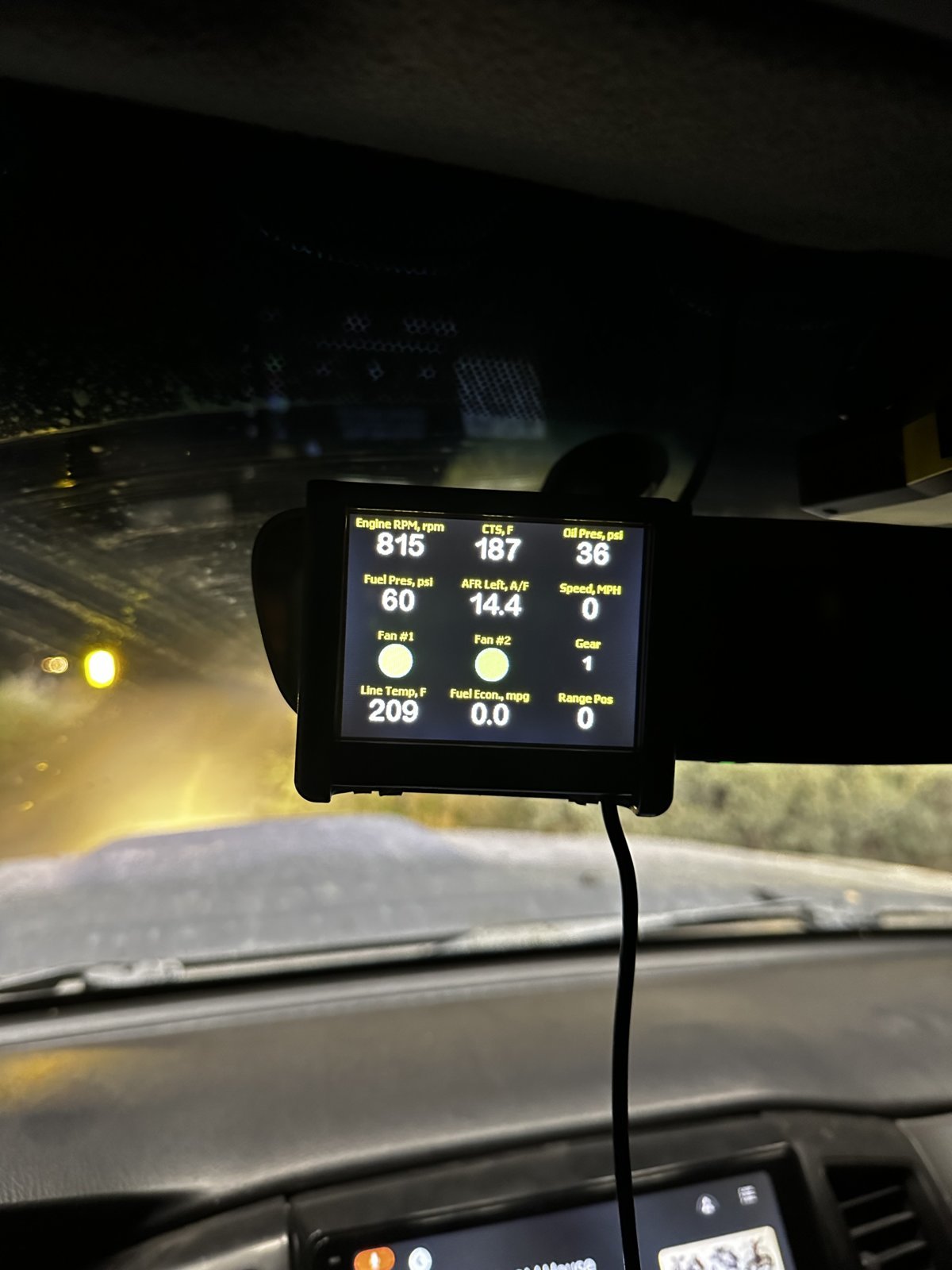

    Trans temp got to 209 while climbing the same steep hill that got me to 220-230 last time and made me pull over.

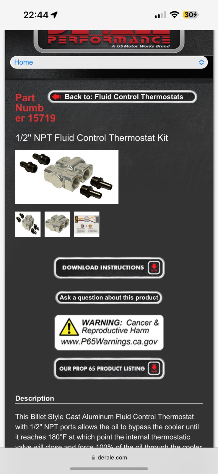

    just ordered the Derale race series cooler. When it gets here I’m gonna chop the bedside up too. No more trans overheating. I’m tired of it.
    Ordered this guy too. The current trans cooler keeps the trans right at like 160-165 without the fans on until I start to beat on it. I want to actually make sure the trans is at a good operating temp in the winter so this will be perfect. I think I’ll have the most capable trans cooling setup now.

    ah the good ol bussman boxes, those are always fun....lol. why so many 25 and 30 amp fuses though?

    because I’m not using it how they recommend. It has two busses, I’m using one of them as a negative bus. The 25amp side is the negative bus. The fuses are just there to bridge between the bus and the ground connectors for the relays and fans. I’ve since changed them for 30 amps. So basically I have two fuses on each circuit :rofl:

    oh okay i see now your just using the fuses as bridges to 30 and 86 or something. makes sense, i normally dont use the bussed ones for this reason, but they do simplify wiring for sure.

    Bingo. Yeah I wanted simple.

    Made it up to flagstaff. Trans got to 201 coming up the hill. Wife and I are having dinner per the recommendation of @snowsk8air2. Tomorrow we’ll get out to cinders!
