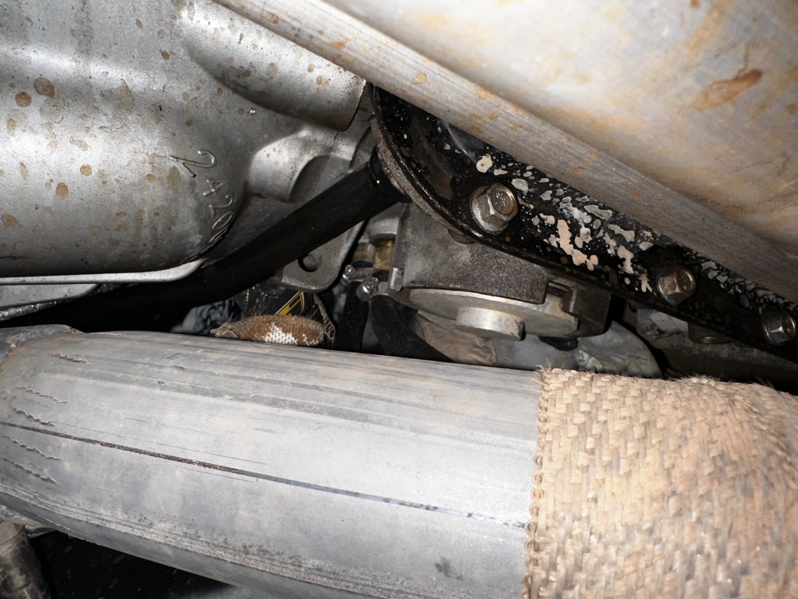

    the cooler lines going into the trans are extremely difficult to access, would require dropping the trans cross member, but then I’d run into my trans pan coming down on my coolant lines, so those would have to Scoot out of the way, but I’m not sure they have that much wiggle room, so they’d more than likely need to come out, which means draining my coolant. After that, it’s still a massive pain to access those fittings.
    Assuming I do access them, the 6an PTFE is a lot stiffer, and even with the banjo fittings or even some 90* fittings I’d probably run into trans tunnel interference issues.
    I'm currently planning just to chop the 3/8 hose where its first easily accessible (12” from trans fittings) and install push lock to 6an fittings, and go 6an PTFE the rest of the way back. I haven’t had so much as a drop leak from those fittings, nor have the hose clamps come loose or the hose slide or anything.

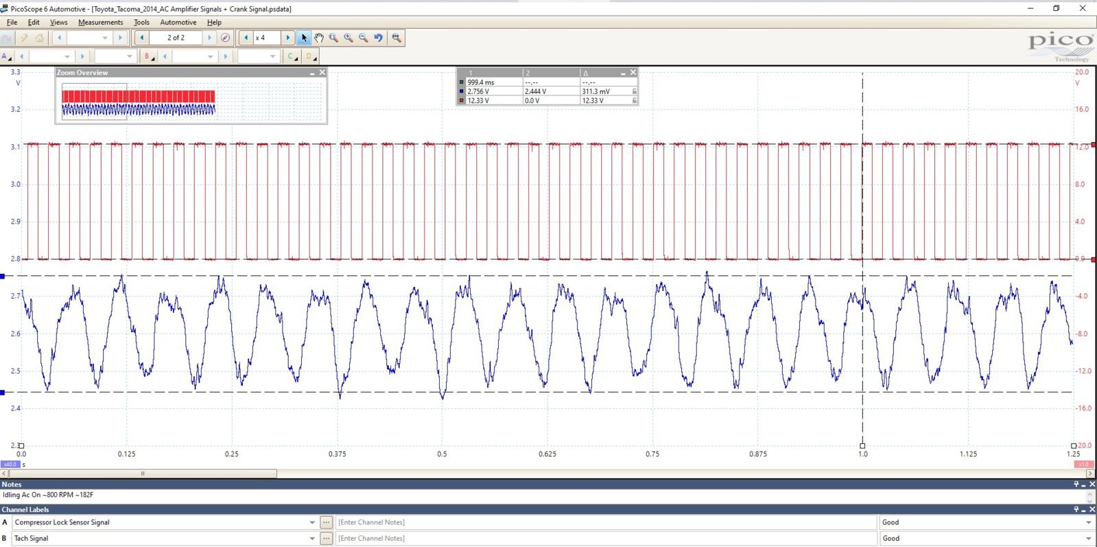

    @Dm93 Gopedully I can lean on you a little bit for this. I’m about to install my condenser and receiver drier, I need AC working sooner than later. Ideally, I’d like to have the stock AC amp control everything. Can you send me the pin out of the AC amp? Is the logic for turning on and off the compressor clutch all inside the AC amp? I know it’s looking for RPM and ECT, I’m assuming at a certain waveform. I’m thinking maybe a waveform generator to just trick it into working whenever I press the switch. What about the thermistor to prevent freezing? Or are there any pressure switches?
  15. Mar 5, 2024 at 6:43 PM
    #1235
    Dm93
    Dm93 Test Don't Guess
    Mar 3, 2015
    #150066
    13,580
    Texas
    2014 DC OR 6spd 4x4
    Predator tube steps, Ranch Hand grill guard, Magnaflow CatBack exhaust, Toyota tool box & bed mat, 2LO Module by @Up2NoGood, Rearview Compass/Temp Mirror, Tune by @JustDSM.
    Yes between that and the control panel.
    You also need a compressor lock sensor signal if you aren't using a compressor with a built in sensor.
    The waveforms for all the signals are in the pinout pdf.
    It's on the evaporator so if you haven't messed with that or the wiring to it nothing should need to be changed there.
    There is one dual pressure cutout switch on the high side line of the factory system that turns off at pressures below 27 psi and above 440 psi protection against excessive pressure and to shut down the compressor in the event of a total loss of refrigerant.
    There is also an A/C permission signal from the PCM and an idle up signal to the PCM, you may or may not want to use these but the A/C permission wire needs to be 12v to allow A/C operation.

    so, waveform generator for:
    RPM SIGNAL
    ECT SIGNAL
    COMPRESSOR LOCK SIGNAL
    AC PERMISSION SIGNAL
    And really just one pressure cutout switch. Should probably get an OEM one.
    and after that when I press my AC button, I should get cold air right?
    what RPM should the RPM waveform be telling the AC amp it’s at? The Holley has an AC WOT cutout that I’ll put in line with a normally closed relay to take care of over revving the compressor, I just want the AC amp to act and behave like it should.
    is that dual pressure switch on the high or low side? Edit: looks like it’s on the high side, please correct me if I’m wrong.

    You only need to provide 12v to the A/C permission wire not a generated signal.
    It shouldn't matter as long as it's in a valid range, the lock sensor signal doesn't have to be too precise as far as voltages go but it does need to be present.
    I have a scope capture of the tach and lock sensor signal at idle. I can grab the temp signal if needed but it may be a few days before I get around to it.
    If everything is correct.

    I have some guy on Fiverr making me an arduino program to generate these waveforms. For me right now based off of the TIS examples. We’ll see how that goes. Theoretically I just need to pipe in those 3 signals, the 12v to ac permission, and then hook up the pressure sensor and I’ll have working AC! Ya know, once I have the hardware installed.
