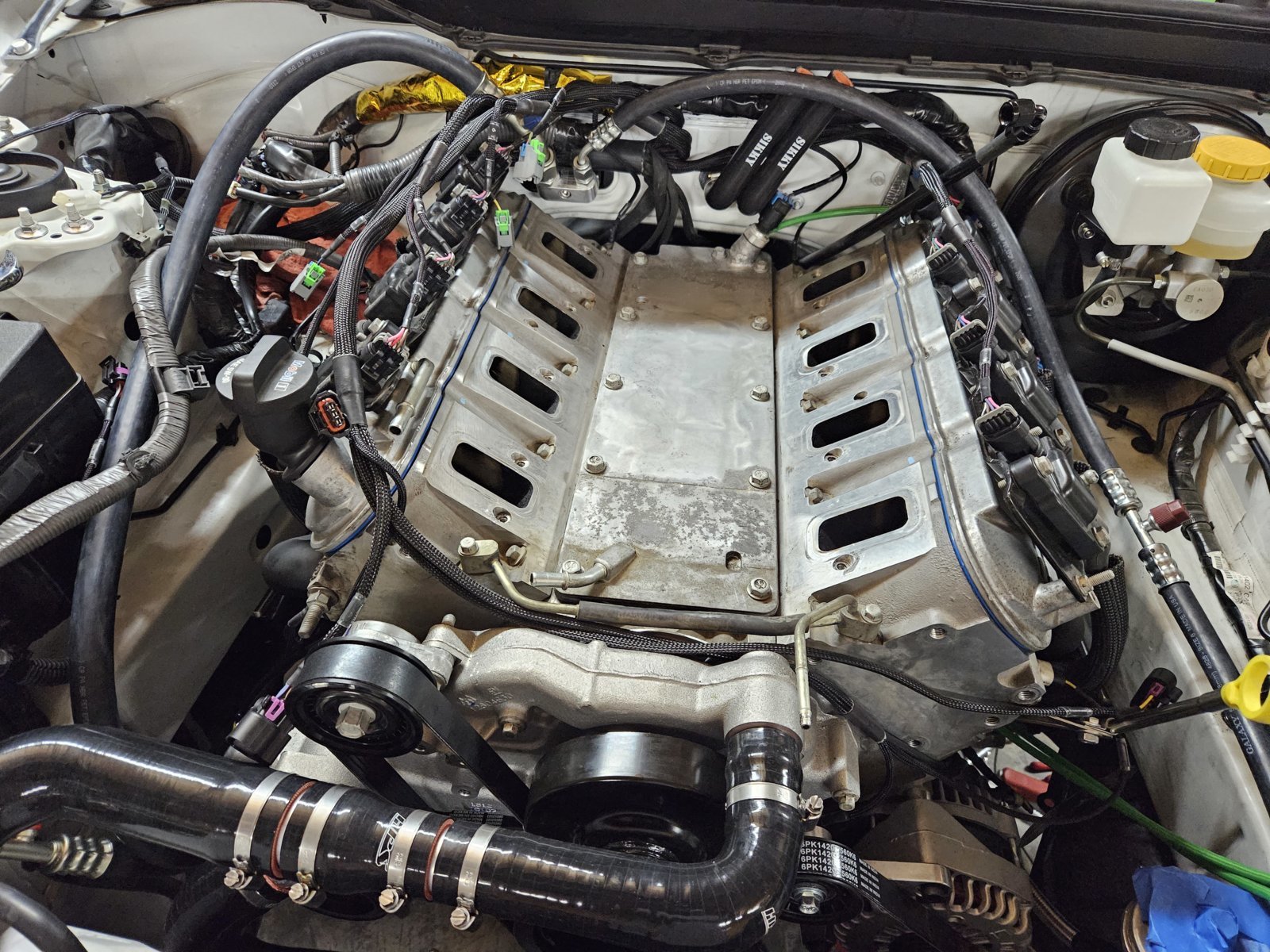

    Is yours one of the engines that had a specific valley cover, that was then swapped for a different valley cover, which removed some unnecessary function. There by taking the seals away from under the valley cover, and no longer keeping oil pressure? A lot of specific names that I don't care to look up at the moment.
    A variety of the above valley cover plate, can fit multiple iterations of engines. It is critical to make sure the o-rings are used on this style. To keep oil pressure.

    looks like the l33 does not have afm towers.

    I would say either that or the oil pressure bypass barbell might of failed.

    yeah factory is plastic and can break from what I’ve read, not sure how much of a difference it can make to oil pressure but if the engines coming out it’s always something to check. Also not sure what his oil pressure is running at.

    Orrrrrrr, the engine wasn’t assembled correctly or a bearing somewhere has failed.

    I don’t like to be the bearer of bad news, but it’s more like a probability than a possibility.
