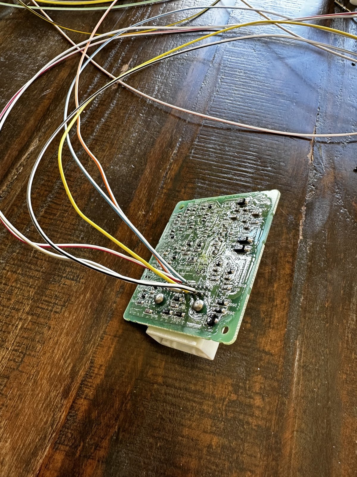

    @Dm93 Since I sacrificed my OEM harness, and cut all the connectors off, where can I tap into the wires that usually power the Ac compressor clutch? Can I access them on the back of the ac amplifier? If not there, where?

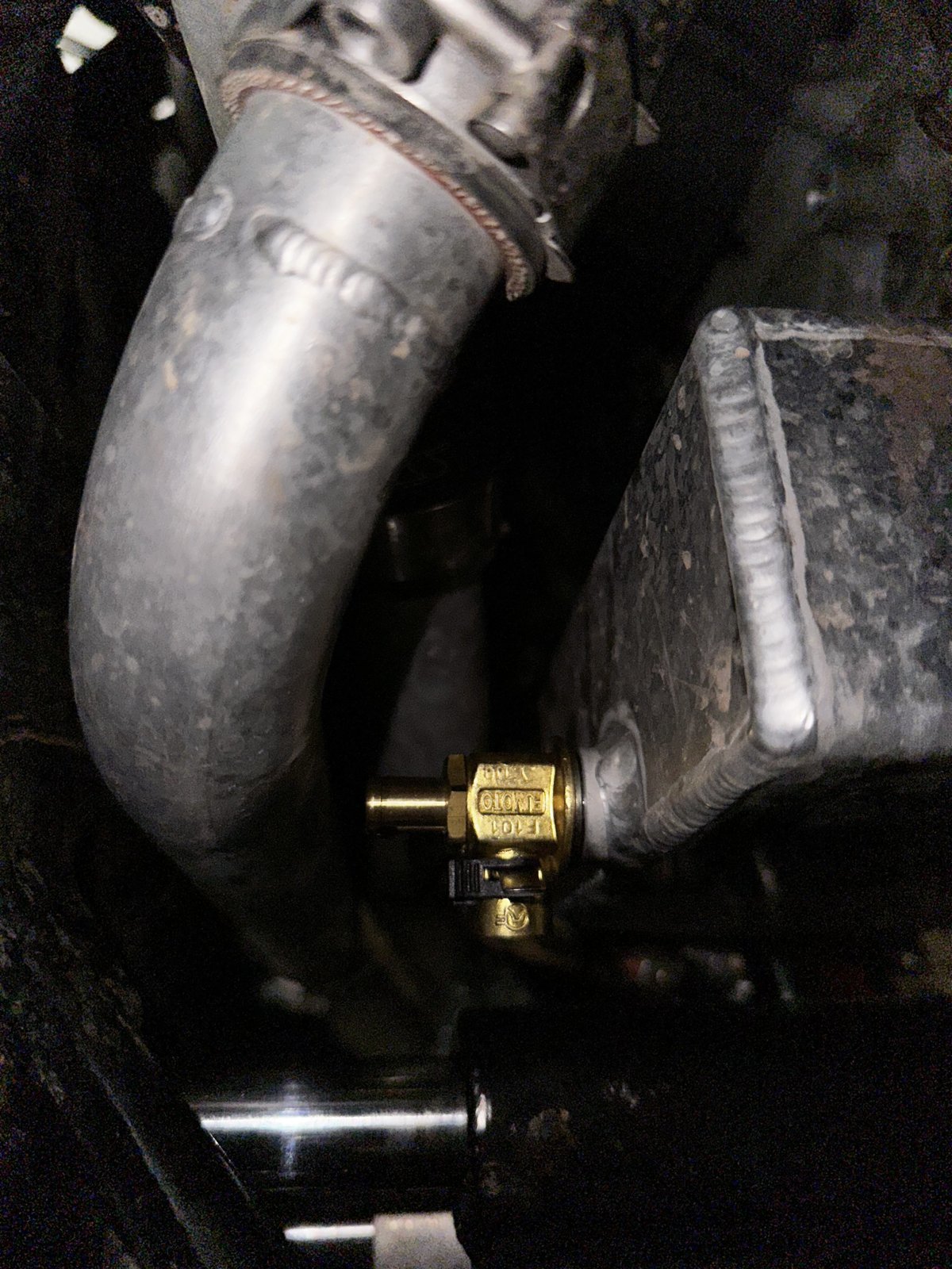

    Rife oil temp sensor installed
    Fumoto valve installed
    Torspd and TACOTU3 like this.

    Dm93
    Dm93 Test Don't Guess
    Mar 3, 2015
    #150066
    14,002
    Texas
    2014 DC OR 6spd 4x4
    Predator tube steps, Ranch Hand grill guard, Magnaflow CatBack exhaust, Toyota tool box & bed mat, 2LO Module by @Up2NoGood, Rearview Compass/Temp Mirror, Tune by @JustDSM.
    Do you still have everything in the underhood fuse box? The MG CLT relay is in there, the wire going to the compressor clutch is on connector EA1 Pin 3 (Violet). As long as you didn't cut any wiring between the A/C Amplifier and MG CLT relay you should be able to run that wire to your A/C compressor.

    Yeah everything still in that fuse box, but I’m not sure if the wiring between it is still there… time to break out the continuity tester I suppose.

    What wire on the back of the ac amplifier goes to the mg cult relay? Is it a positive trigger or a ground trigger? I’ll just add an extra relay.

    Pin 21 (Green), it's ground side switched.
    The A/C Amplifier is behind the glovebox.

    Oh I’ve been mistakenly calling the ac controller where the knobs are as the ac amplifier. Oops. I don’t even know what I’m looking for now.
    so pin 21 green is the ground trigger for the ac compressor clutch. Could you give me the 3 pin locations and colors for the RPM, ECT, and compressor lock signals where I need to inject those waveforms? Safe to assume it’s in the amplifier as well?

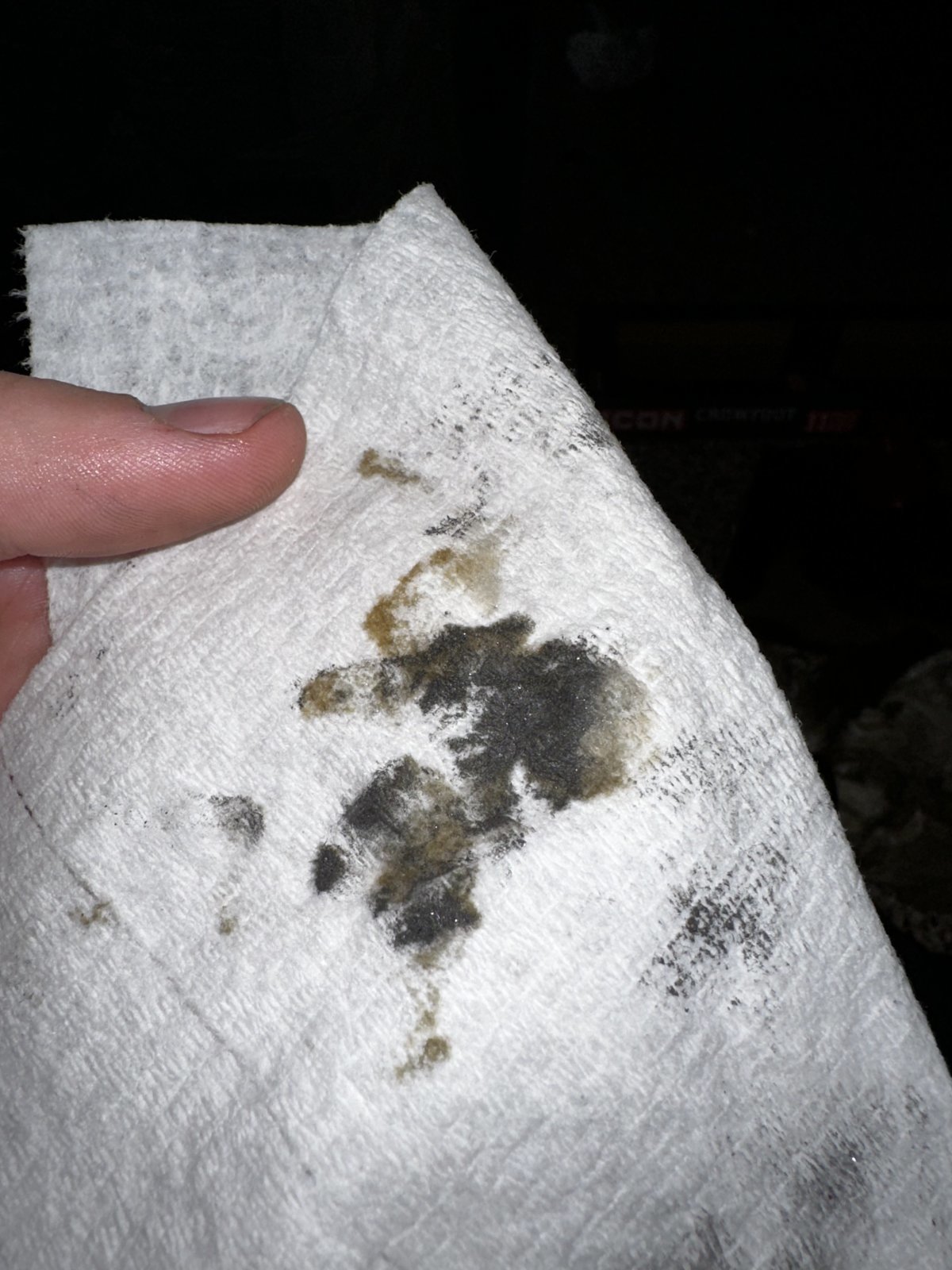

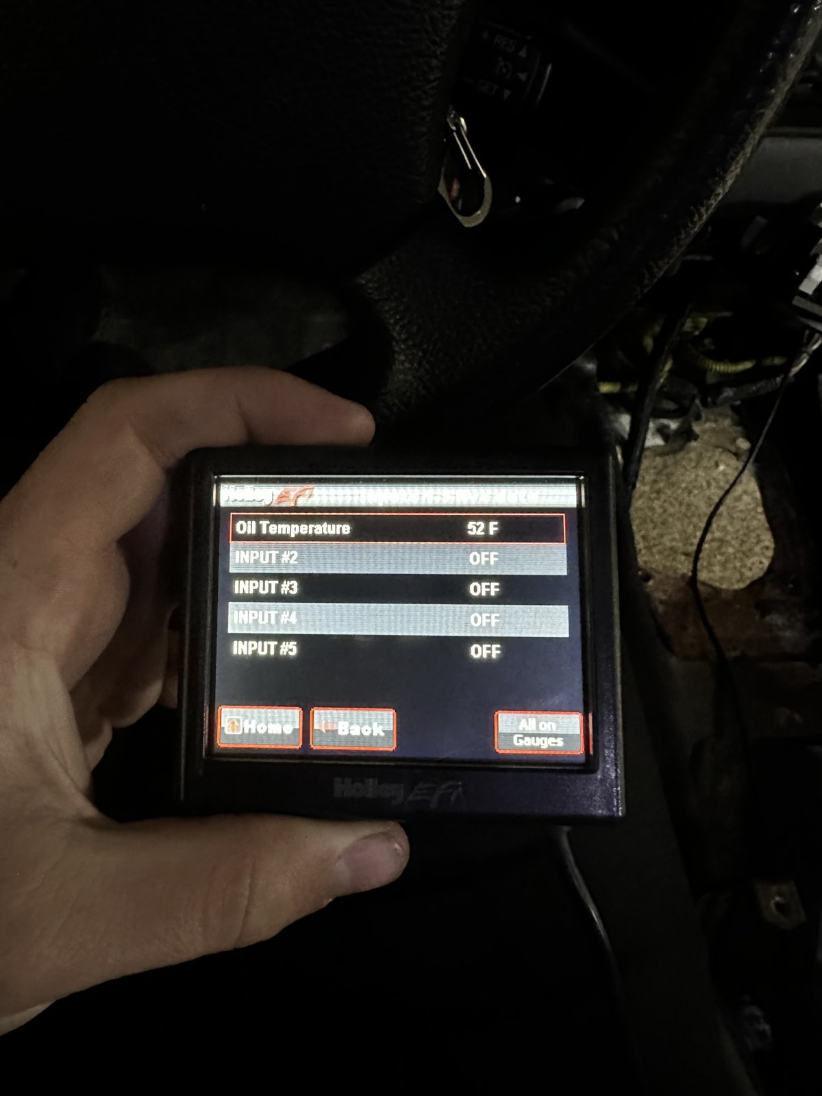

    Well we have engine oil temp now! Also using this to trigger the oil cooler fans on and off. Pretty surprising there’s no way to monitor this.
    This is what came off the magnetic drain plug before I switched to the fumoto valve. Took a sample of oil to send to blackstone again. I’m around 750 miles. I don’t know that I should be concerned considering the engine is still breaking in, the oil was dirty but not metallic at all. This is my first built motor so I’m not sure what really is normal and what isn’t.

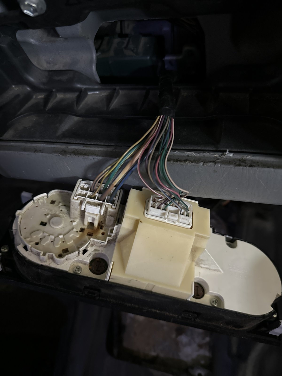

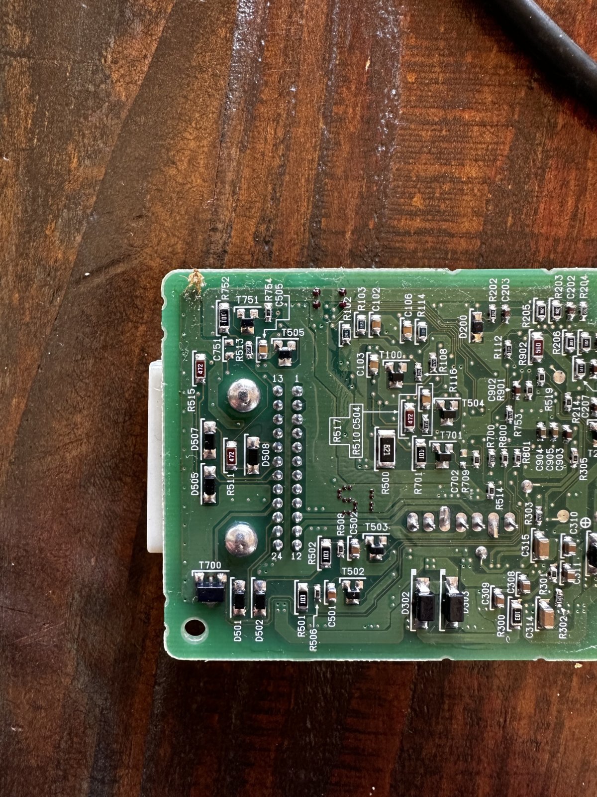

    It's a small black box with a single connector a bit bigger than a deck of cards, if you look straight up in the center of the glovebox opening it's right there. I'd get a picture of it but it's raining here atm.
    It's all in the diagrams I shared.
    Pin 5 (Orange): Pressure Switch
    Pin 6 (Red/White): Lock Sensor Signal
    Pin 7 (Blue): A/C Permission
    Pin 9 (Green/White): A/C Idle Up Signal
    Pin 19 (Grey/Black): ECT Signal
    Pin 21 (Green): MG CLT Relay Control
    Pin 22 (Black/White): Tach Signal
    Well I mean I've done some messing around with it and it seems to be happy as long as there's a signal on that wire, I think you could feed it a 2-3v square wave 30ms low and 30 ms high and it would be happy.
    found the module. Pulled the casing off to actually solder the wires directly to the board. Did everything with the exception of the idle up signal. The Holley will self accommodate when it notices the RPM drop from the ac being engaged. We’re cooking with gas now! @Dm93 thank you so much for your help.
    so the pressure switch wire goes to one wire on the pressure switch, the other wire on the pressure switch goes to ground?

    Yes.

    Well the AC wiring is 100% done. Just waiting on the dude to finish writing code for the arduino so I can plug that module in, and still waiting for my binary pressure switch to get here so I can plug it in as well.

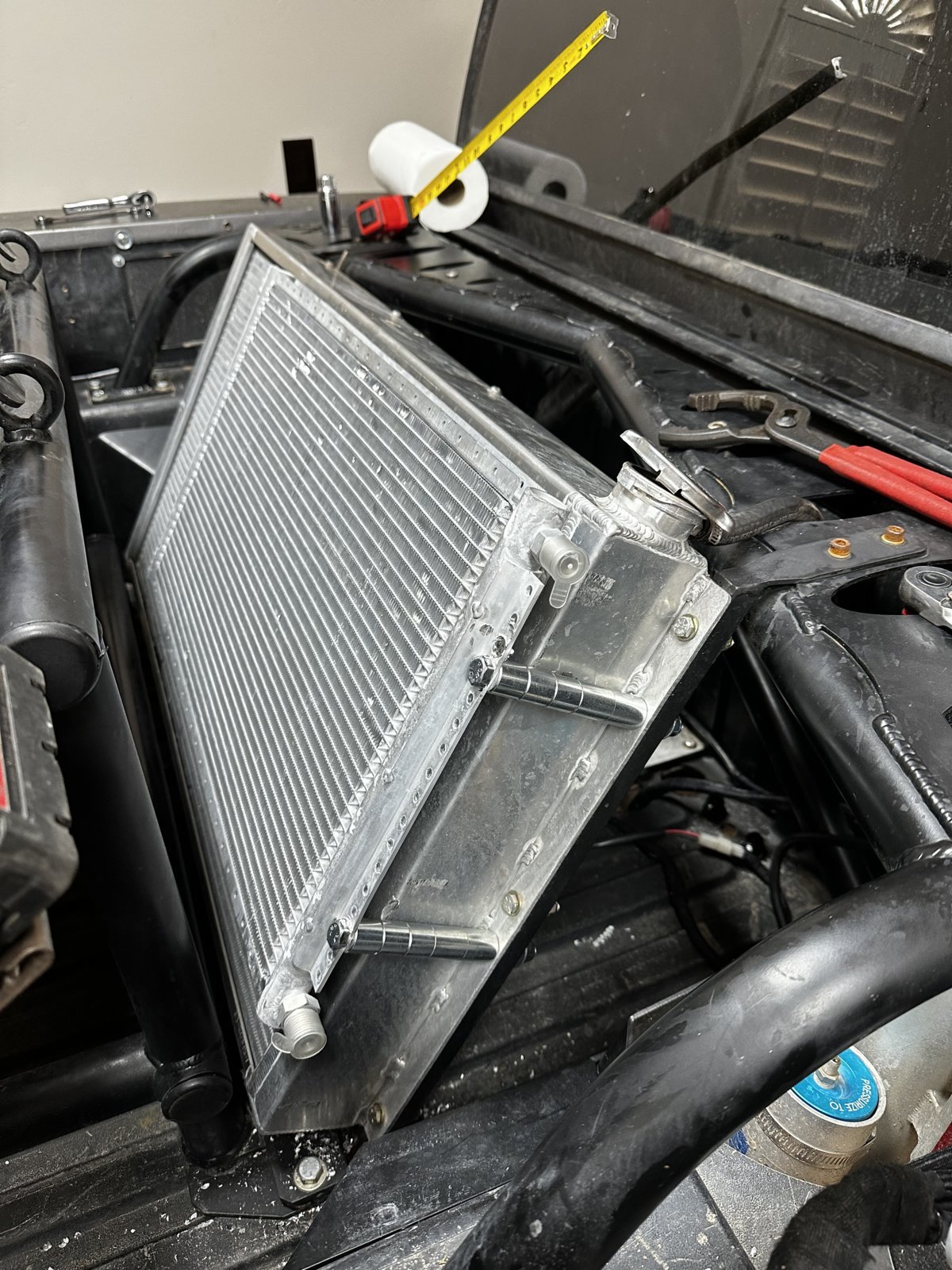

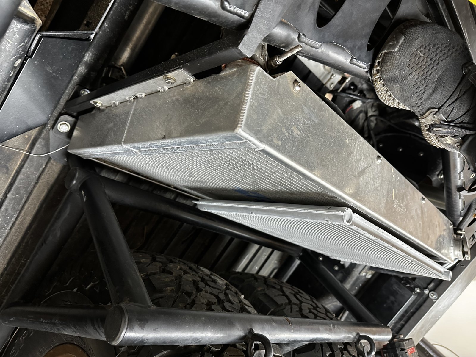

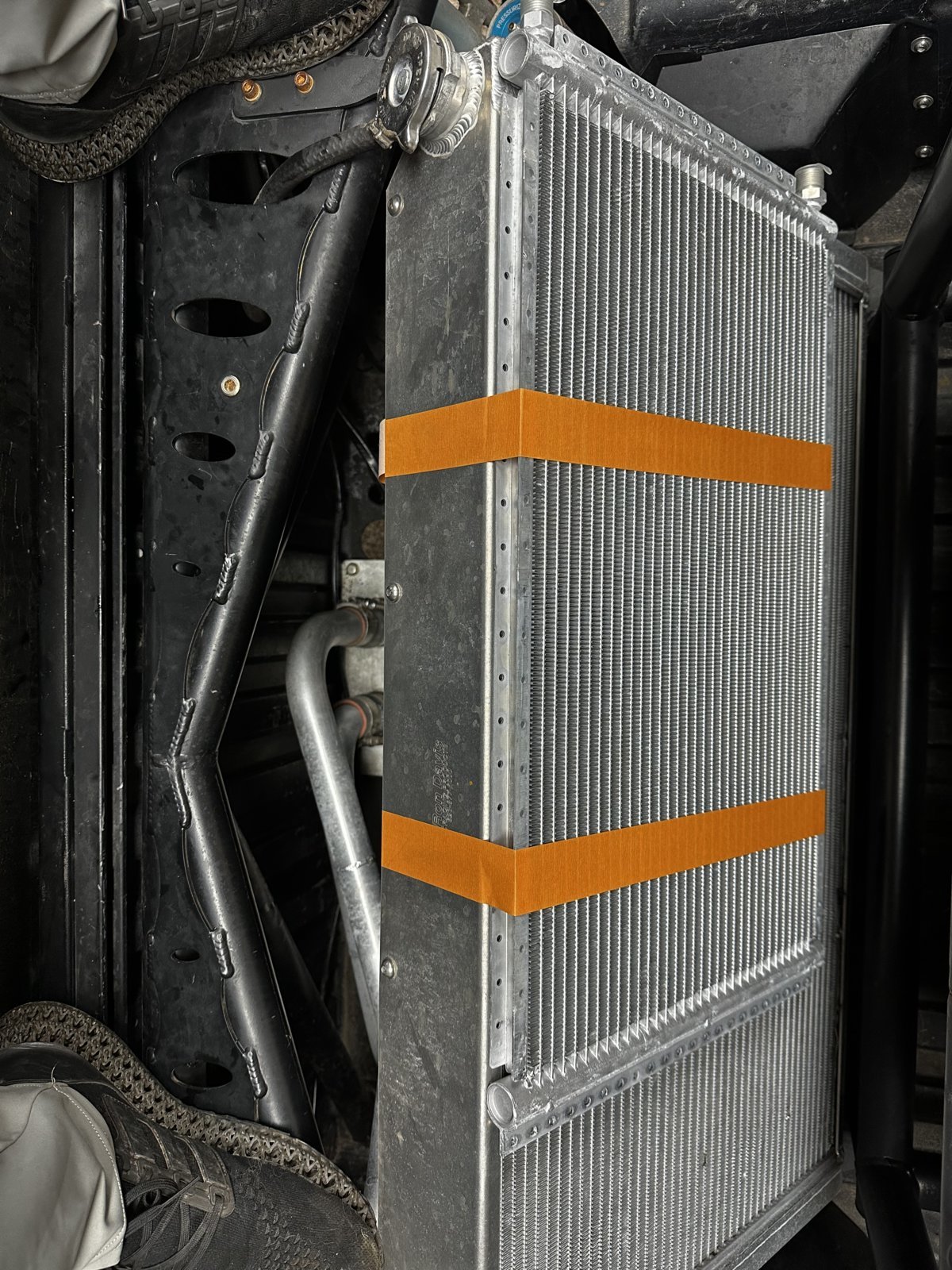

    condensed mounted on one side:
    Still haven’t exactly figured out the other side:

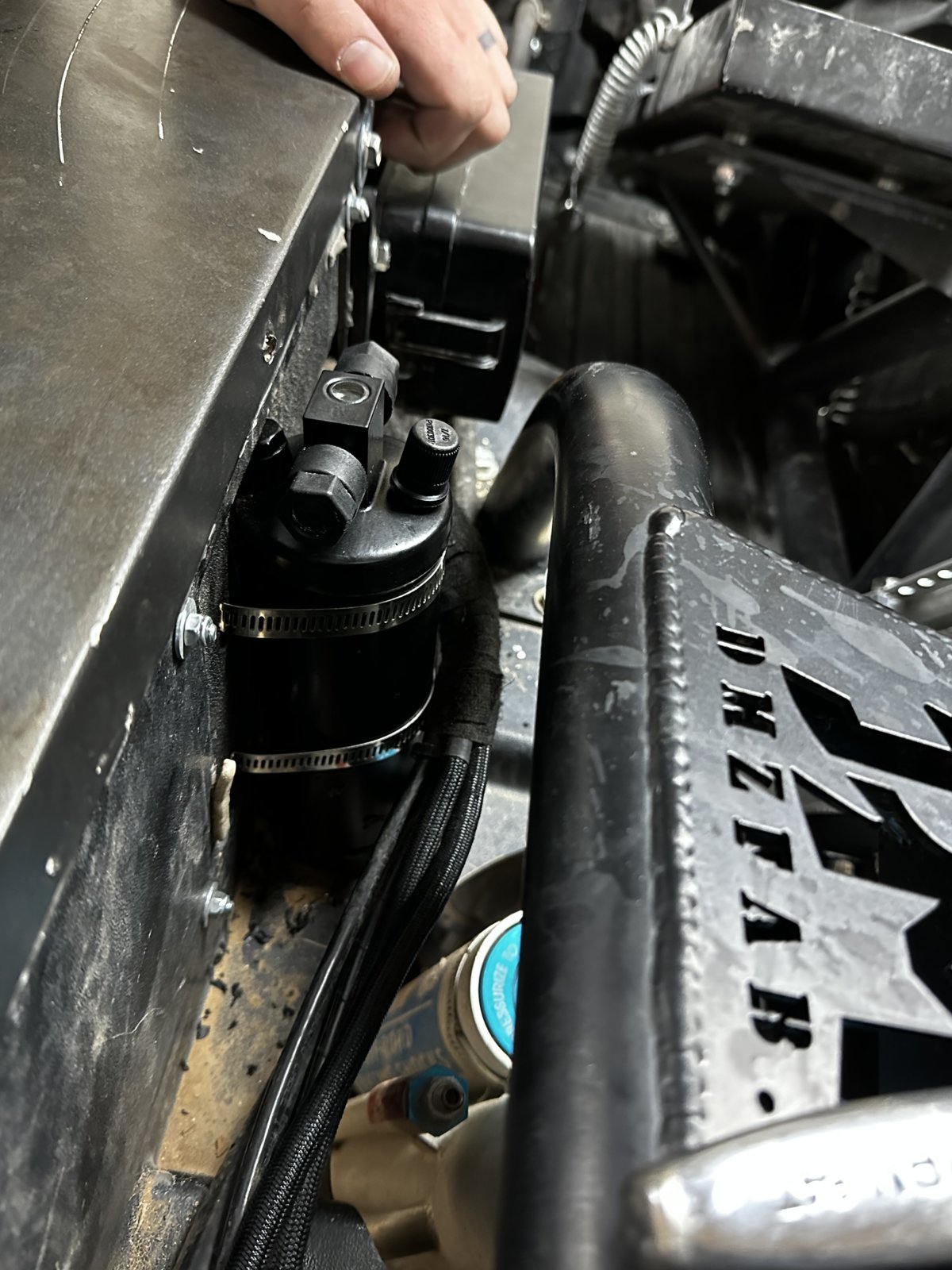

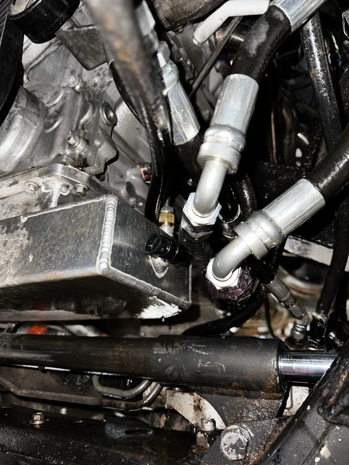

    Receiver dryer is mounted:

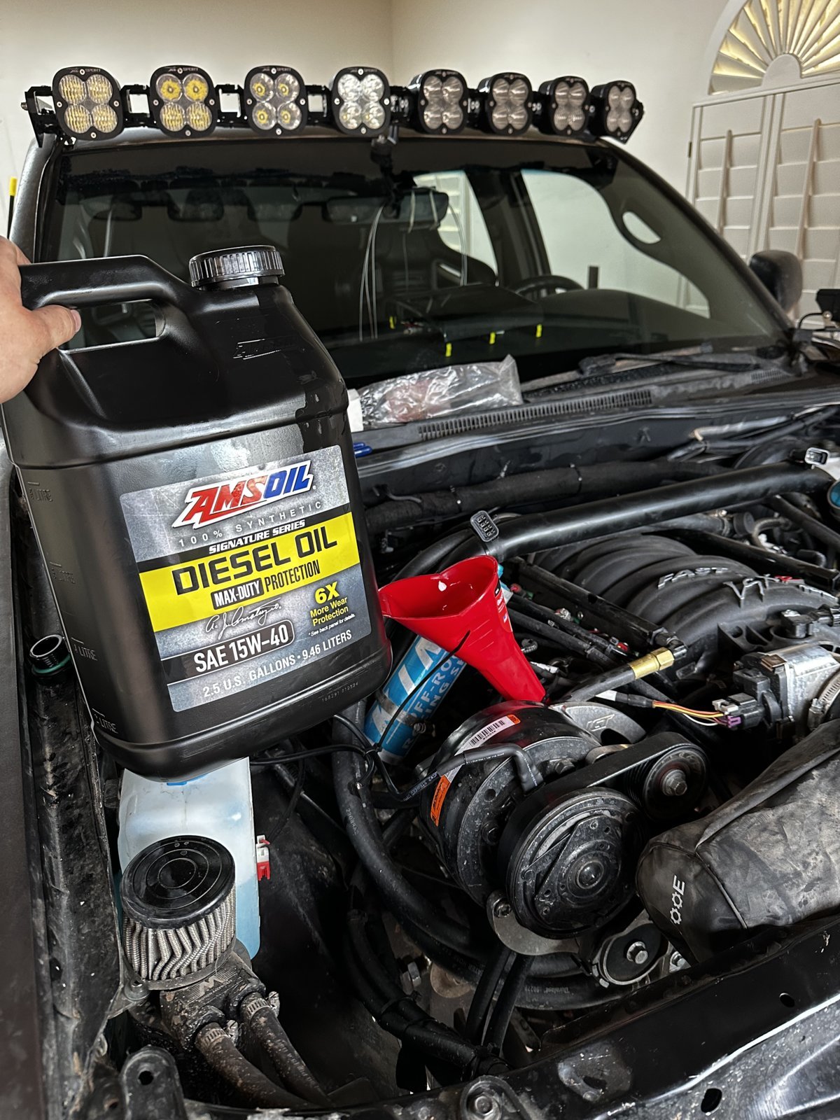

    “Changed” the oil again, only had about 750 miles on it. By “changed” I mean I drained the very little oil remaining after draining most of it out on the ground when I put in the temp sender and fumoto valve. AMSOIL oil and filter. IMG_1372.jpg
    Overfilled it a quite a bit, since the filter, new bigger oil cooler, and accusump are all empty. Will check the level again once it’s running again. Good news is if it’s still overfull I have a valve to open and drain the necessary amount!
