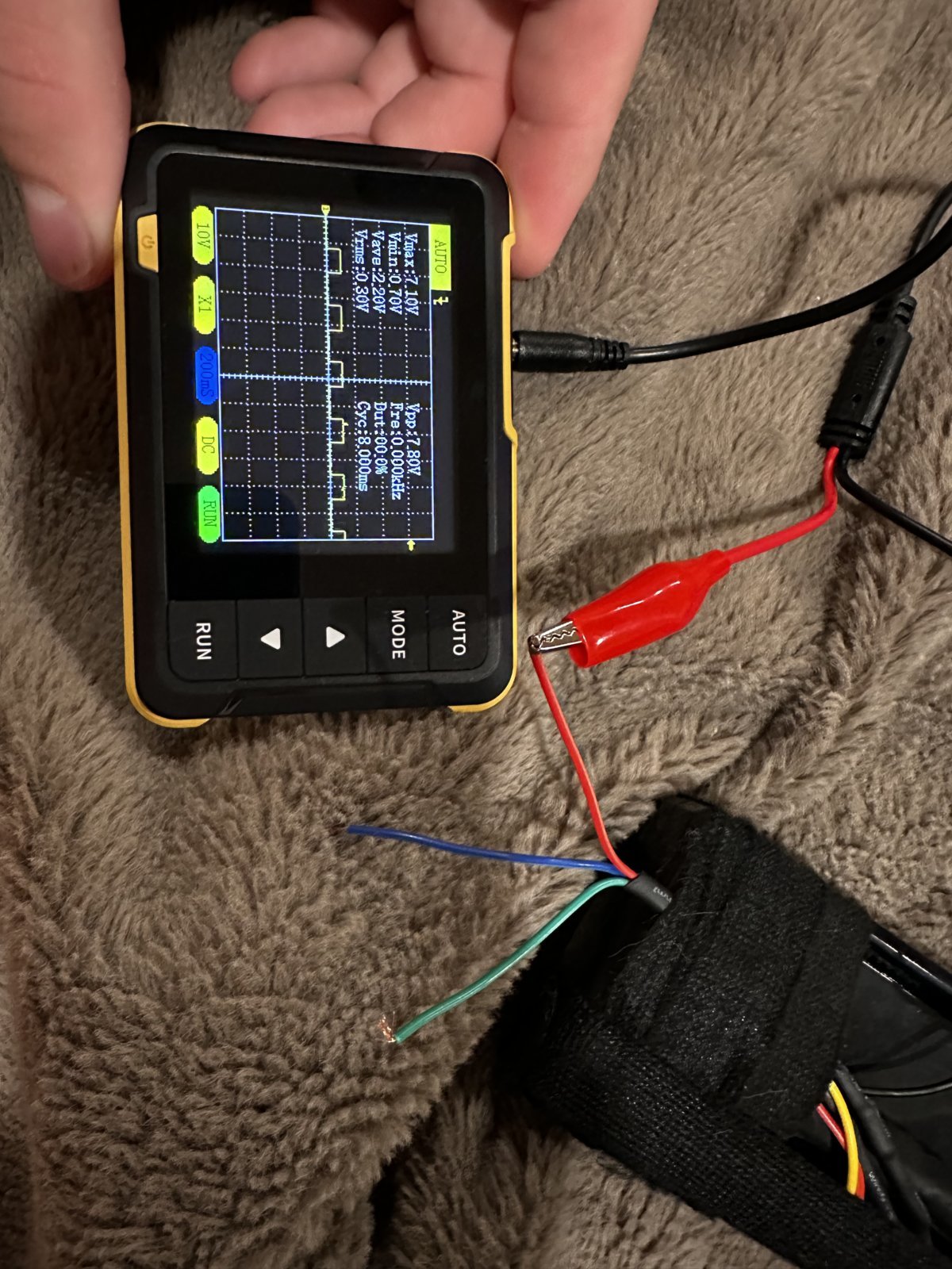

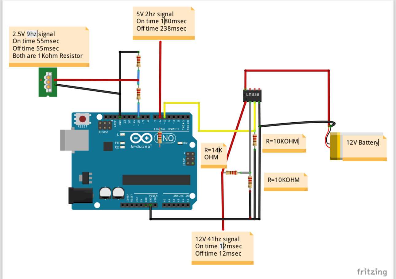

    Code is finished. Ordering parts, and will be able to test as soon as they’re here. Should be able to engage the clutch with ign on only.
    Had to get some circuitry to make the 12v RPM signal.

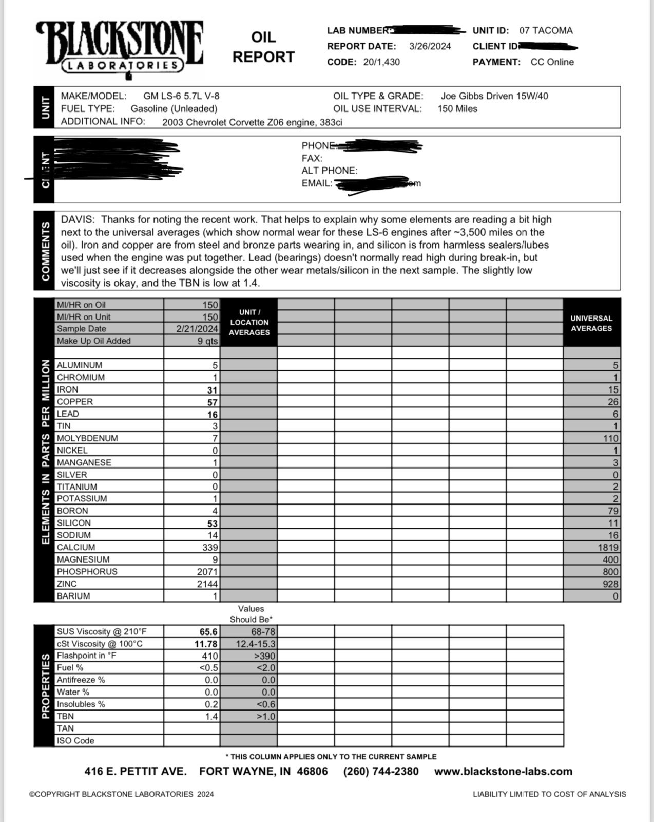

    Oil analysis is done!

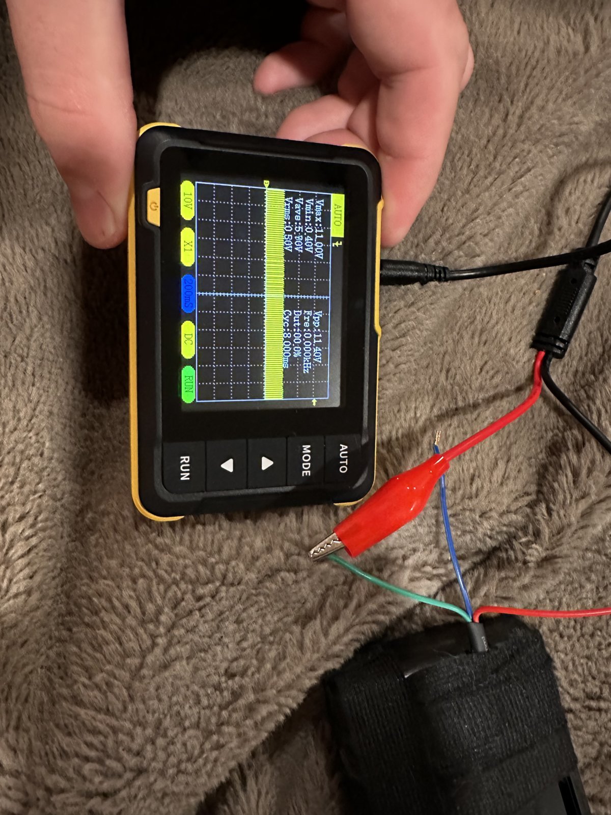

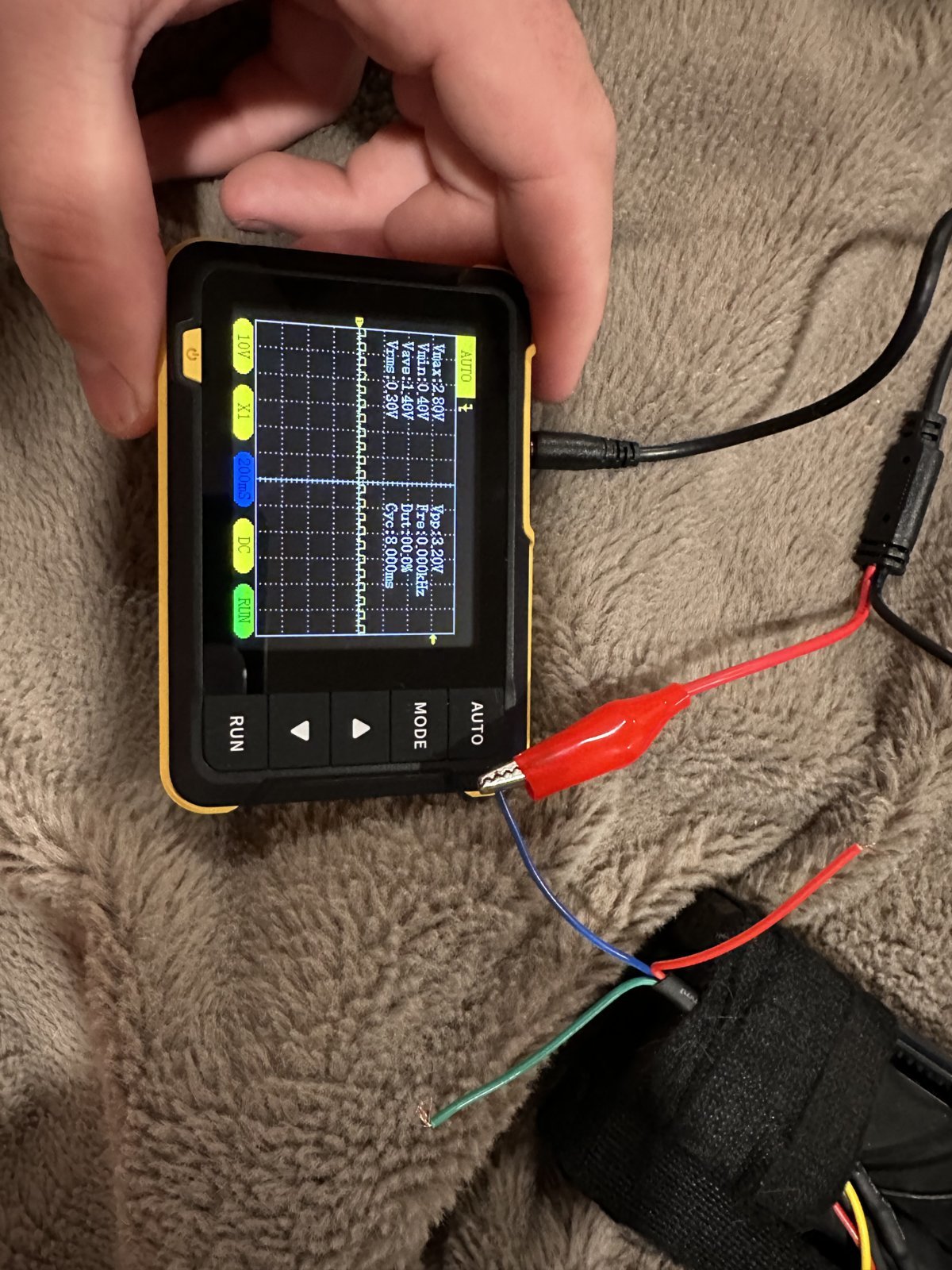

    ECT:
    Compressor lock:
    How do we look now @Dm93 ?
    If I get the stamp of approval, I’ll post the parts list as well as the code and wiring diagram so if anyone needs to do this in the future, they can use it.
    Taco 422, Torspd and Dm93 like this.

    For anyone wanting to do this, you’re going to need an Arduino Mega, and attached here is the parts list and wiring diagram. I’ll edit this post with the code here once I’m home:
    unsigned long previousMillisPin5 = 0; // Variable to store the last time pin 5 (PORTD5) was updated
    unsigned long previousMillisPin6 = 0; // Variable to store the last time pin 6 (PORTD6) was updated
    unsigned long previousMillisPin10 = 0; // Variable to store the last time pin 6 (PORTD6) was updated
    const long intervalPin10 = 55; // Interval at which to blink pin 5 (milliseconds) //9hz //voltage divider //2.5V
    const long intervalPin5 = 12; // Interval at which to blink pin 5 (milliseconds) //41hz //opamp //12V
    const long onTimePin6 = 180; // On time for pin 6 (milliseconds)//2hz //simple //5V
    const long offTimePin6 = 238; // Off time for pin 6 (milliseconds)
    int dutyCycle = 0; // Initial duty cycle
    bool pin6State = LOW; // Initial state of pin 6
    #define PWM_PIN 10
    #include <avr/io.h>
    void setup() {
    pinMode(5, OUTPUT);
    pinMode(6, OUTPUT);
    pinMode(PWM_PIN, OUTPUT);
    void loop() {
    unsigned long currentMillis = millis(); // Get the current time
    // Blink pin 5 (PORTD5)
    if (currentMillis - previousMillisPin5 >= intervalPin5) {
    previousMillisPin5 = currentMillis;
    PORTE ^= (1 << PORTE3); // Toggle pin 5
    // Blink pin 6 (PORTD6)
    if (pin6State == HIGH && currentMillis - previousMillisPin6 >= onTimePin6) {
    pin6State = LOW;
    previousMillisPin6 = currentMillis;
    PORTH &= ~(1 << PORTH3); // Turn off pin 6
    else if (pin6State == LOW && currentMillis - previousMillisPin6 >= offTimePin6) {
    pin6State = HIGH;
    PORTH |= (1 << PORTH3); // Turn on pin 6
    //PORTB ^= (1 << PORTB2); // Toggle pin 10
    if (currentMillis - previousMillisPin10 >= intervalPin10) {
    previousMillisPin10 = currentMillis;
    PORTB ^= (1 << PORTB4); // Toggle pin 10
    // analogWrite(10,1);
    // delay(55);
    // analogWrite(10,0);
    // delay(55);
    // DDRB |= (1 << DDB1);
    // // PB1 as output
    // OCR1A = 0x01FF;
    // // set PWM for 50% duty cycle at 10bit
    // TCCR1A |= (1 << COM1A1);
    // // set non-inverting mode
    // TCCR1A |= (1 << WGM11) | (1 << WGM10);
    // // set 10bit phase corrected PWM Mode
    // TCCR1B |= (1 << CS11);
    // delay(1000);
    // TCCR1A &= ~(1 << COM1A1);
    // set prescaler to 8 and starts PWM
    // myPwm(127, 7.5); //e.g. (127/255)50% duty with 7.5 Hz
    // delay(1000);
    // myPwm(13, 10); //e.g. (13/255)5% duty with 10 Hz
    // delay(1000);
    // myPwm(204, 5); //e.g. (204/255)80% duty with 5 Hz
    // delay(1000);
    //void myPwm(unsigned char duty, float freq) {
    // TCCR1A = 0x21;
    // TCCR1B = 0x14;
