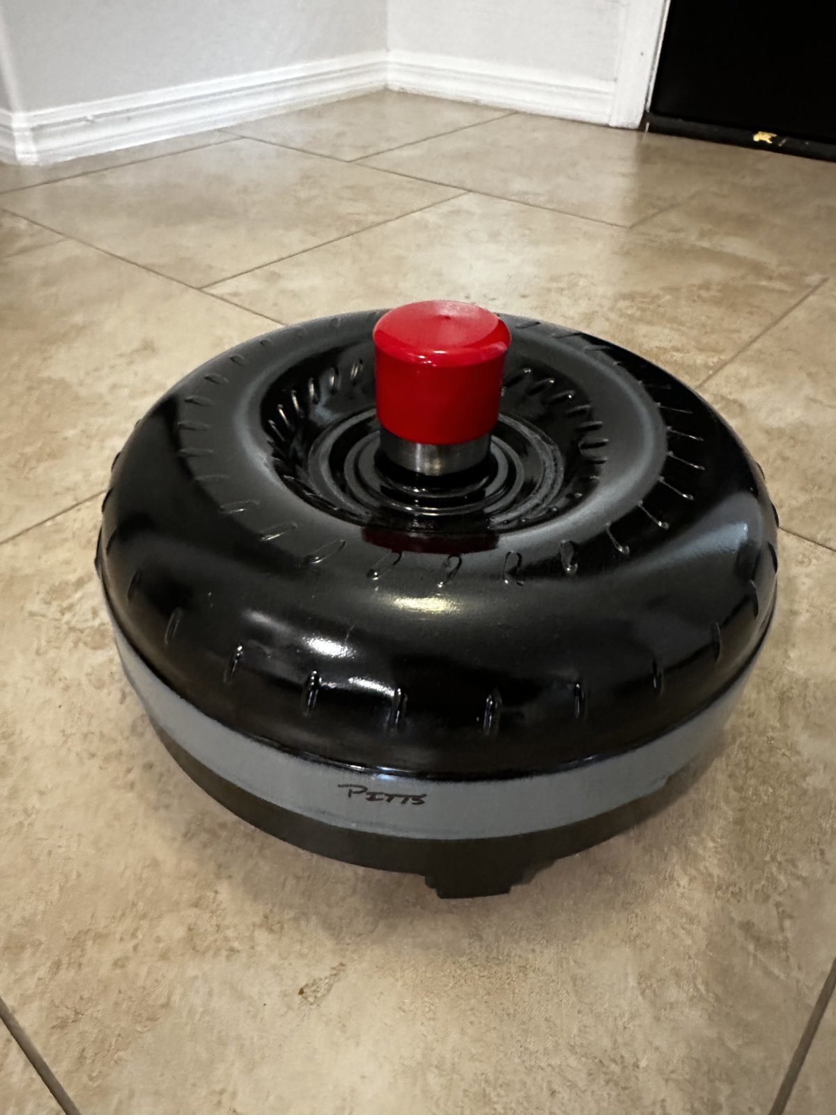

    Big boy 4L80 Billet converter from Circle D is back. They refurbed and converted it for $500 for me. Replaced all of the wear items too. Now just waiting on my transmission and tcase to come back from Maximum Offroad. They said they’d start building it next week is what it sounds like. They got everything torn apart today from my tcase.

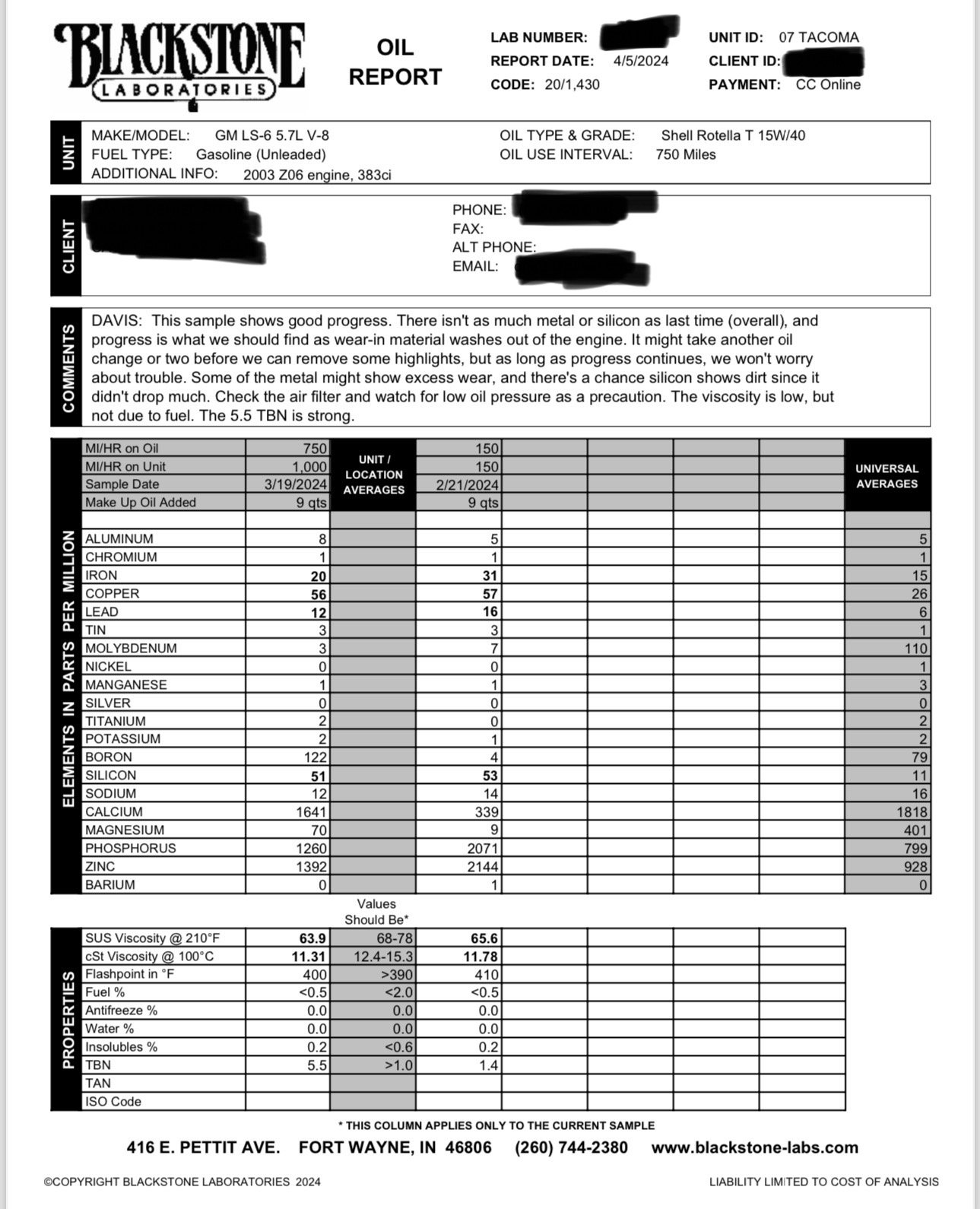

    750 mile oil report from Blackstone is here:

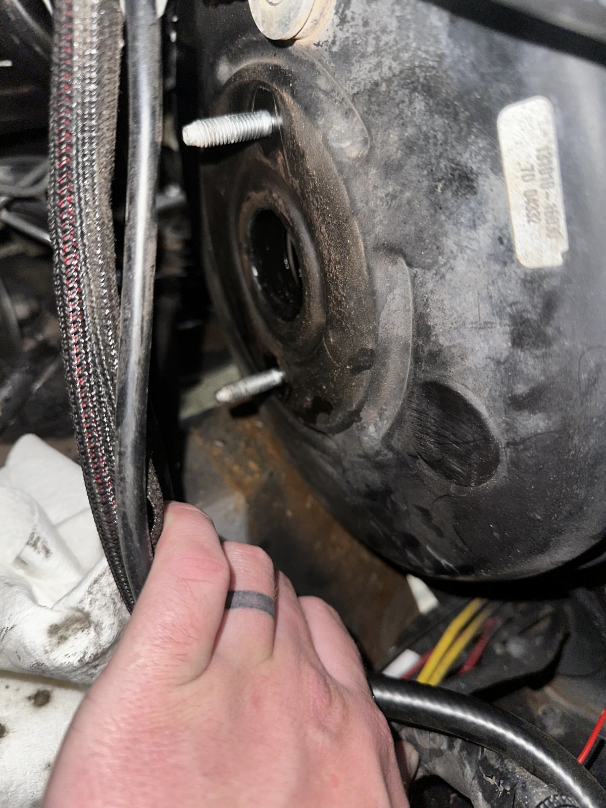

    Upgrading to a tundra booster and MC. Can’t get my OEM one out because of the JD fenders. Ugh.

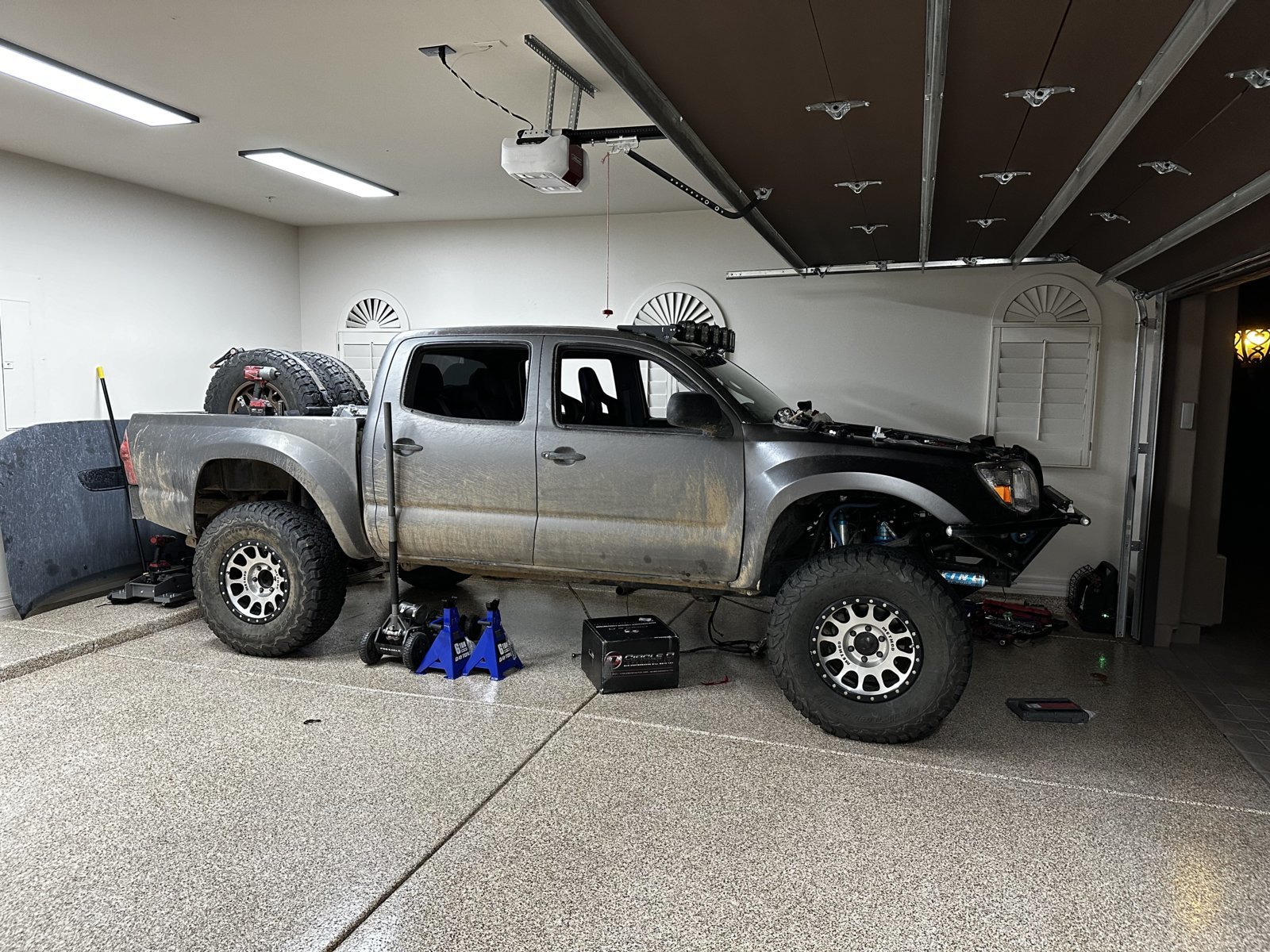

    Swapped wheels with a buddy. Love these a lot more. Still need to swap my spares.
    2001 4x4 likes this.
  16. Apr 16, 2024 at 4:50 AM
    #1356
    DesertRatliff
    DesertRatliff Well-Known Member
    Jan 14, 2012
    #70618
    2,514
    Mt. Hood, OR
    Mas Tacos Por Favor
    Shutters? I couldn't stop looking at that epoxied floor!
