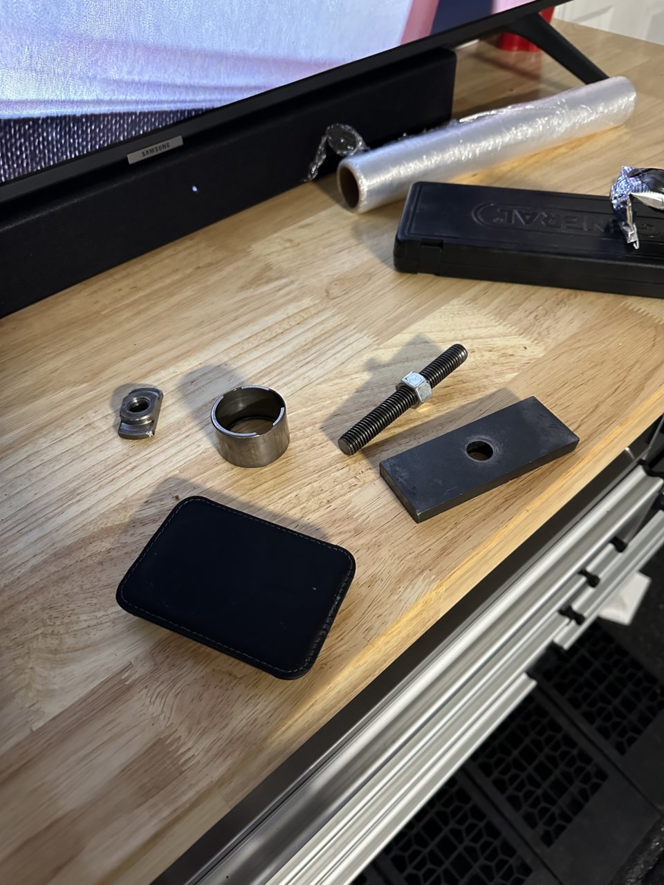

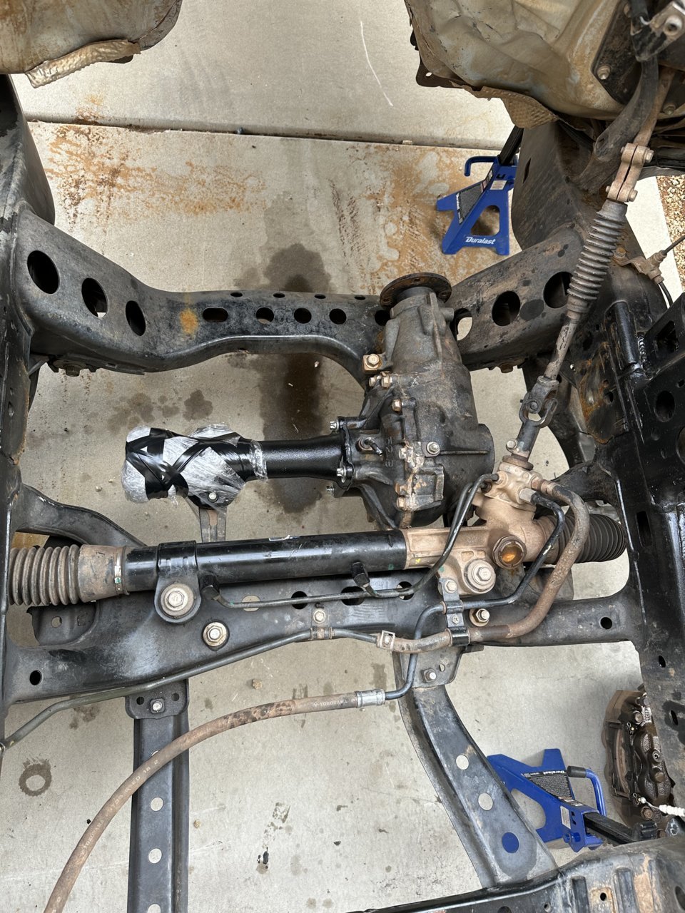

    Well I started my A.D.D. Delete. Got the diff tube assembled no problem. Went to remove the driver CV and I cannot get it out. Trying to do the ECGS bushing too. Ugh....
    Ordered a CV specific slide hammer. Adding to the list of tools I'll probably only need once but are too expensive to get rid of afterwords.

    Bigger pry bar did the trick. Now, to get the ADD stub shaft out. Another member recommended I use a punch and tap it out from the driver side. I'll try that tonight. Work is making it difficult to get time on the truck...

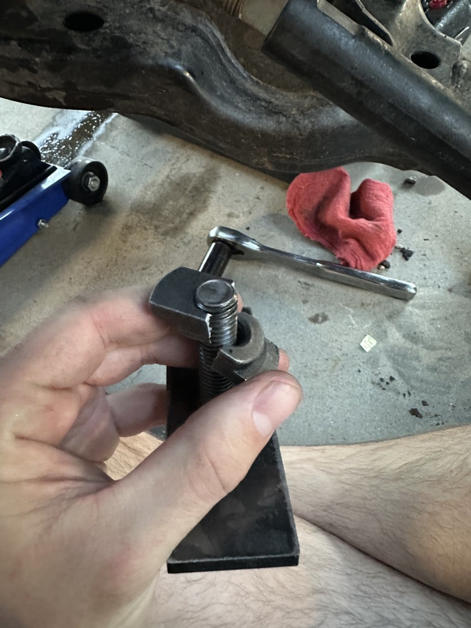

    Sweet. ECGS tool broke… glad I spent the money on it :/

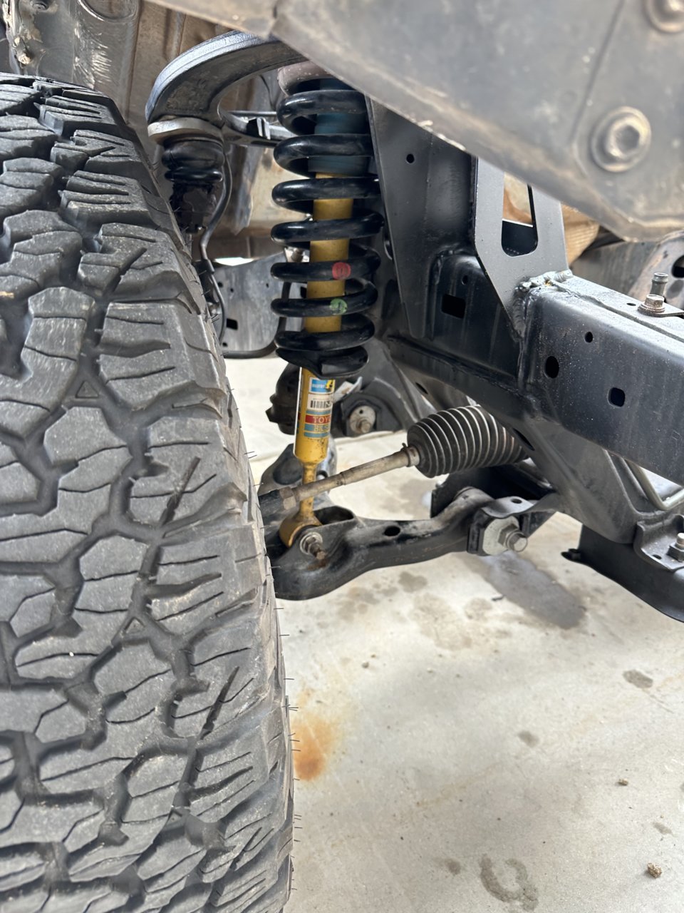

    Ewwww. Bilsteins.....
    I took the Kings off to sell them, since the truck is just going to sit until my LT stuff finally arrives. Based off my ETA from BTF, that should be in the next week or so.

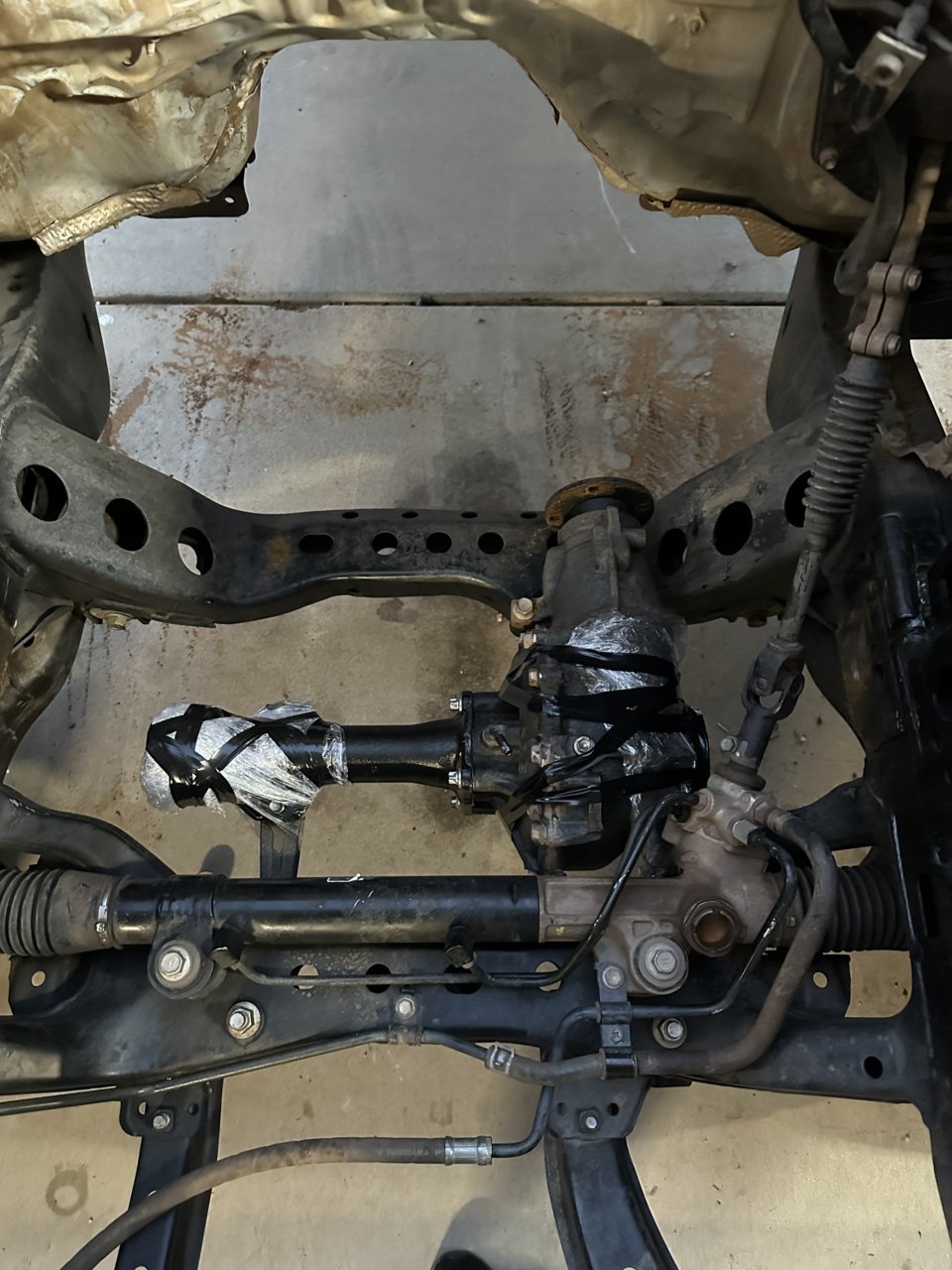

    ADD successfully deleted. No more stupid actuator. Huge thanks to @AllTacosFloat for hooking it up and sending me over his ECGS tool. Lifesaver. Should get it Monday and have the driver side back together.
    I left both CV's out, since the BTF kit comes with new axles. I cut the shafts off my current ones and inserted the hub splines and and axle nut to keep my wheel bearing together. Thats why my diff tube is wrapped up, to prevent FOD intrusion. Once the ecgs bushing is finally in, I'll wrap it too.

    ECGS bushing installed, diff all wrapped up.
    @AllTacosFloat Saved my diff....

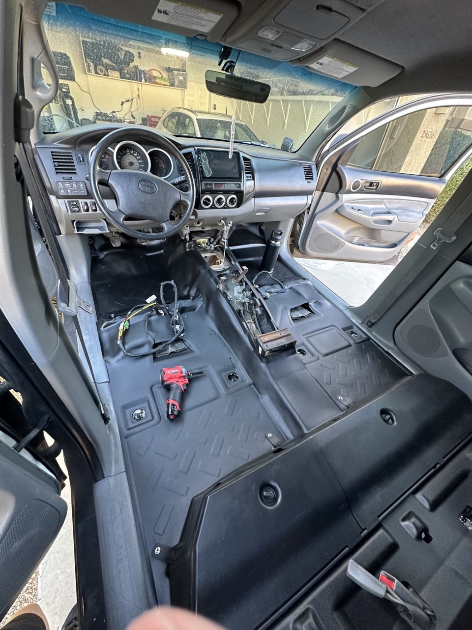

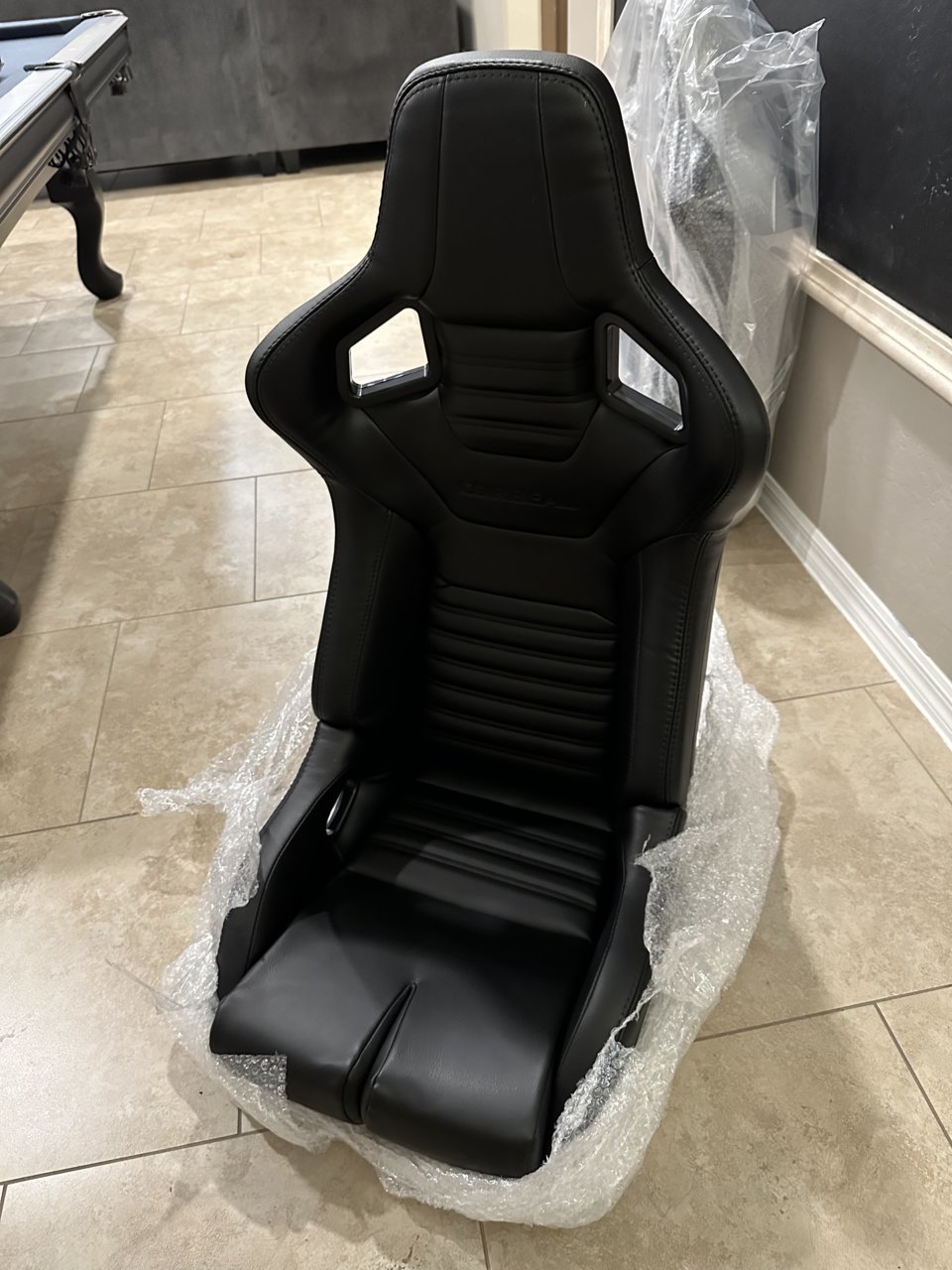

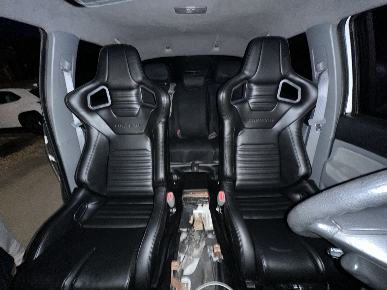

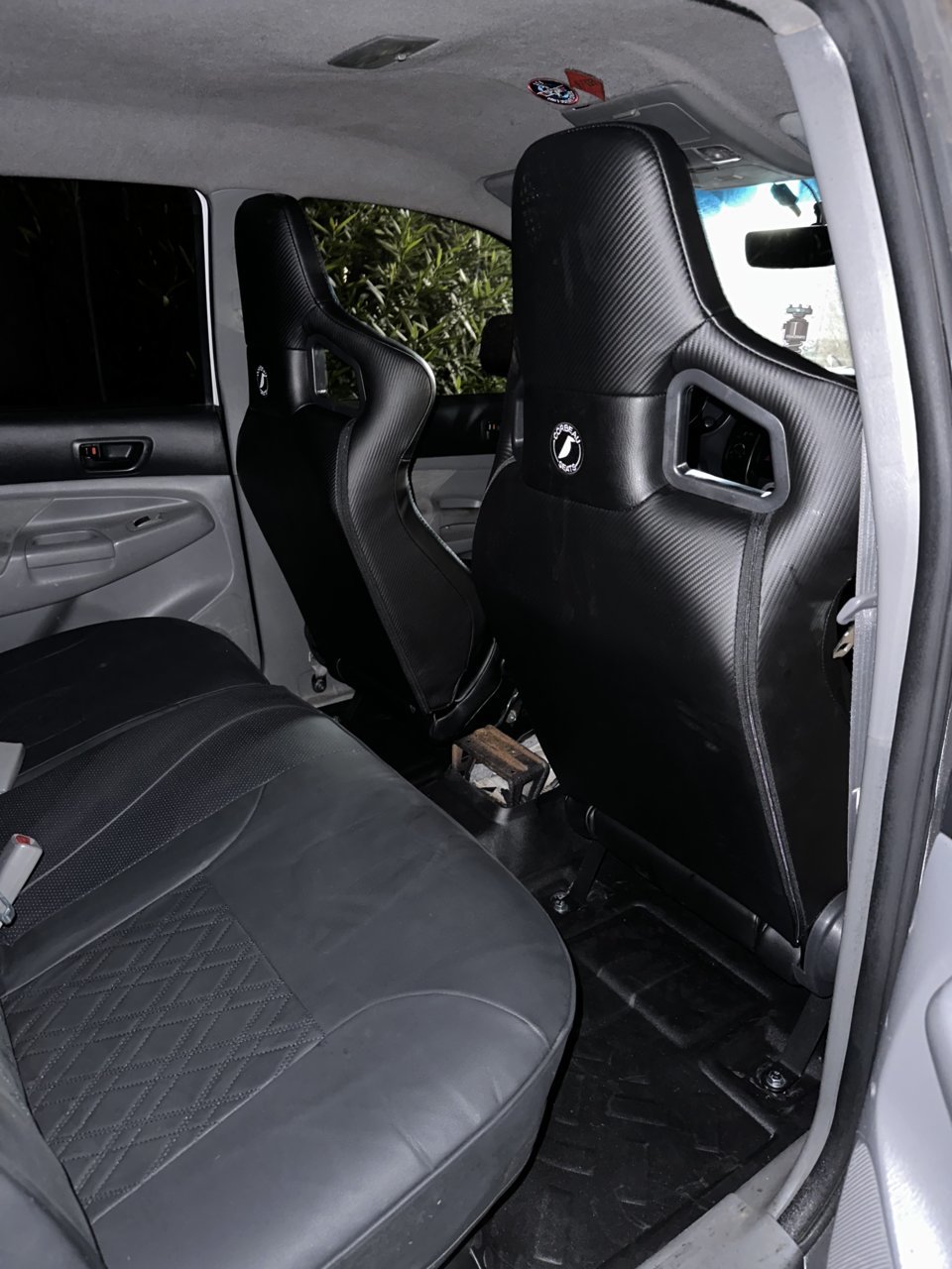

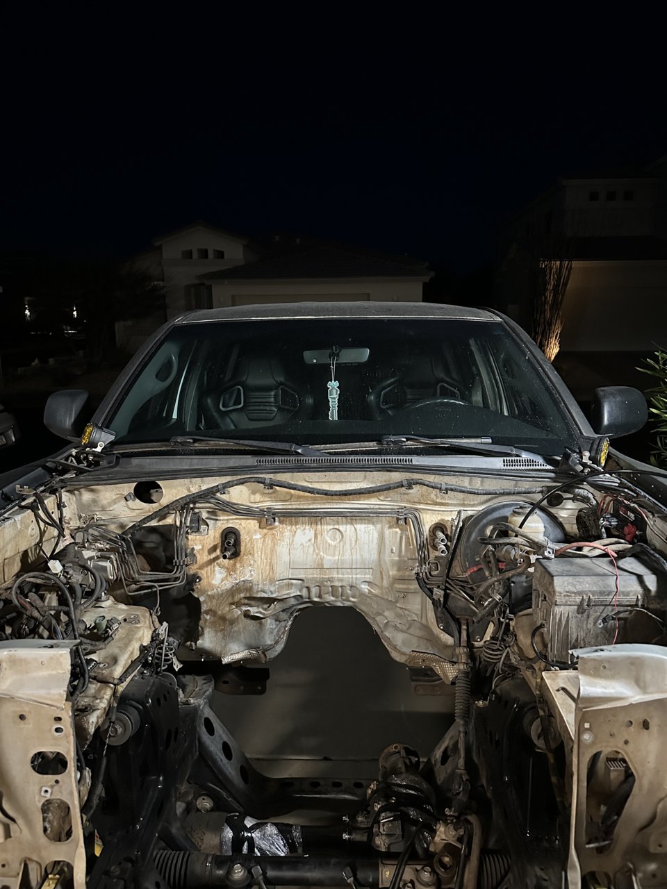

    0097250A-03A9-41F8-95EF-29461863BE12.jpg 8E3A58B0-D5A2-47FD-98FD-FD5A3C24DEE9.jpg C06E9EBA-0247-4112-8357-BA27DEA69647.jpg 9D4EDC29-D165-4C72-9765-D34DF6A69B4B.jpg
    Corbeau’s are finally in. Moved all the airbag and seat sensors wires over to the new seats. No airbag light for me, and the airbags will still deploy in an accident. Not that the light matters, I’ll have the Holley dash. Lol.
    I went with the planted seat brackets, the tall version. Seats fit great. Used those brackets for the seats in my RC and loved them.
    Only things to do inteiror wise are the roll cage and the center console. Maybe tomorrow I’ll tackle cleaning up the wiring for the front end, and put in the auto brake booster. Take the clutch out. Good stuff.
