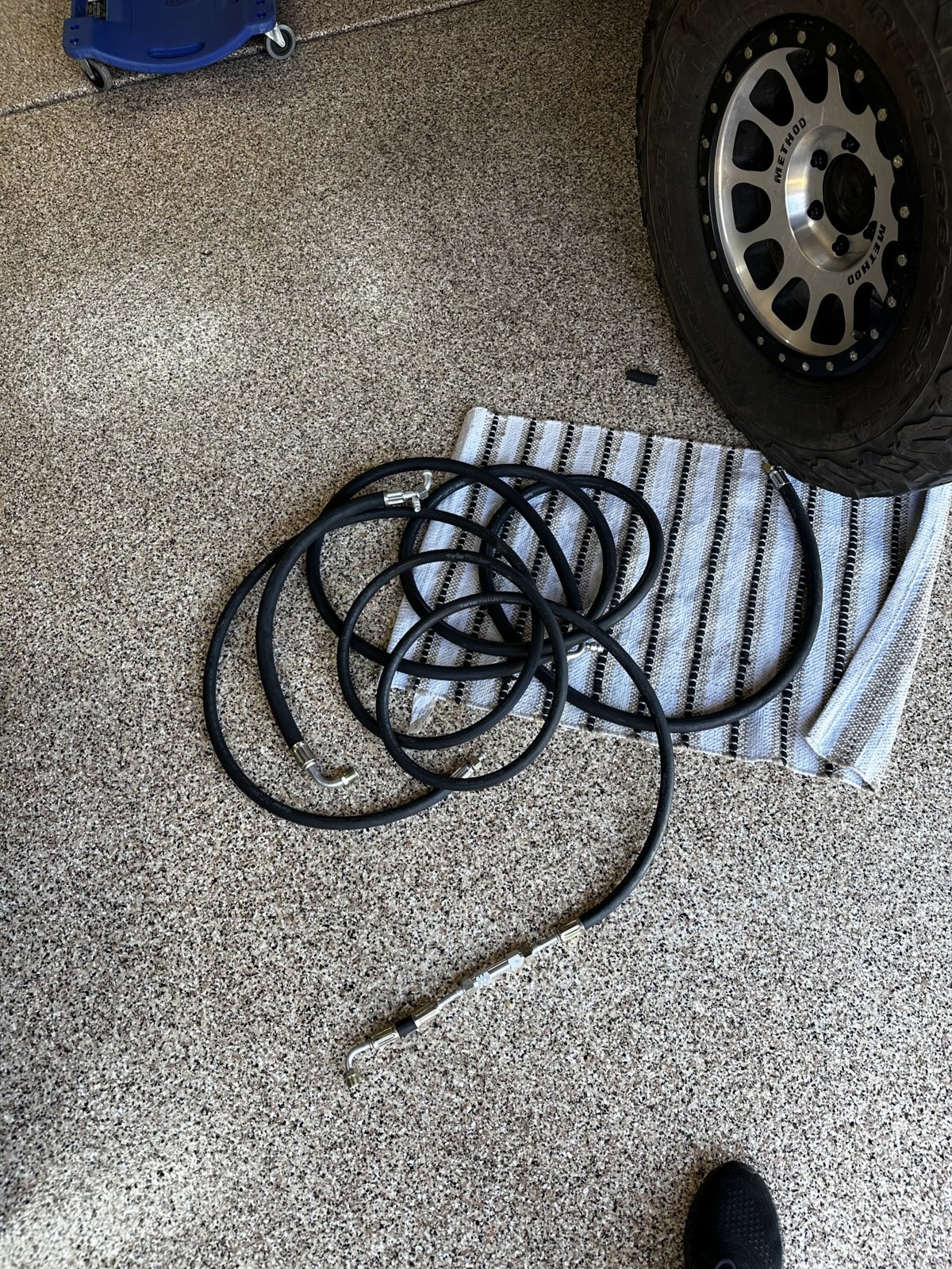

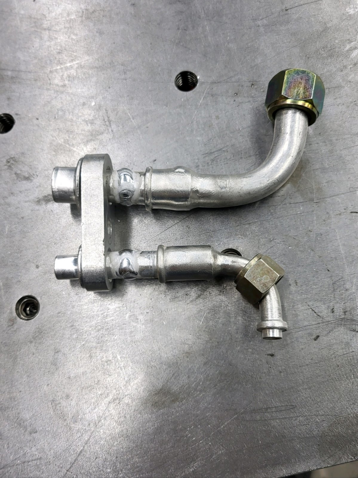

    Evaporator connections redone. Had to make them shorter because of value cover contact on the taller valve covers. Everything is officially in place now which means all that’s left are lines to be made, and charging the system!

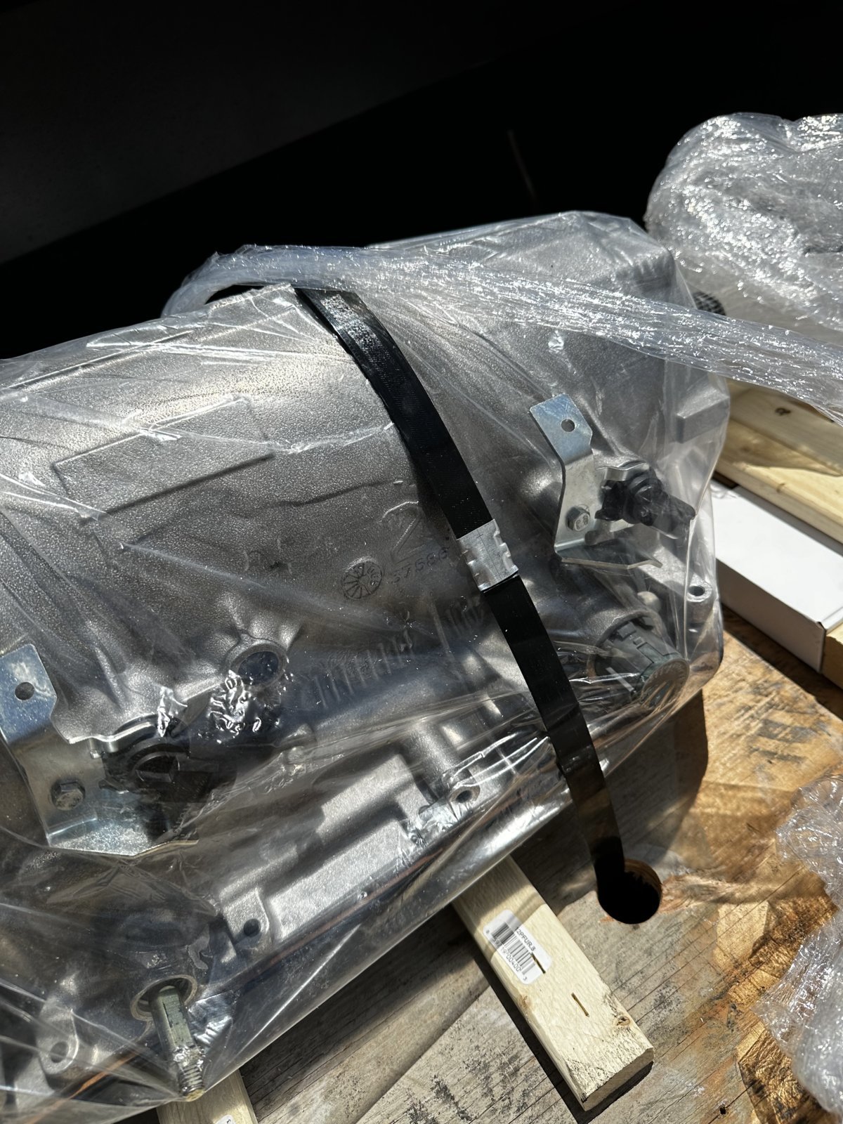

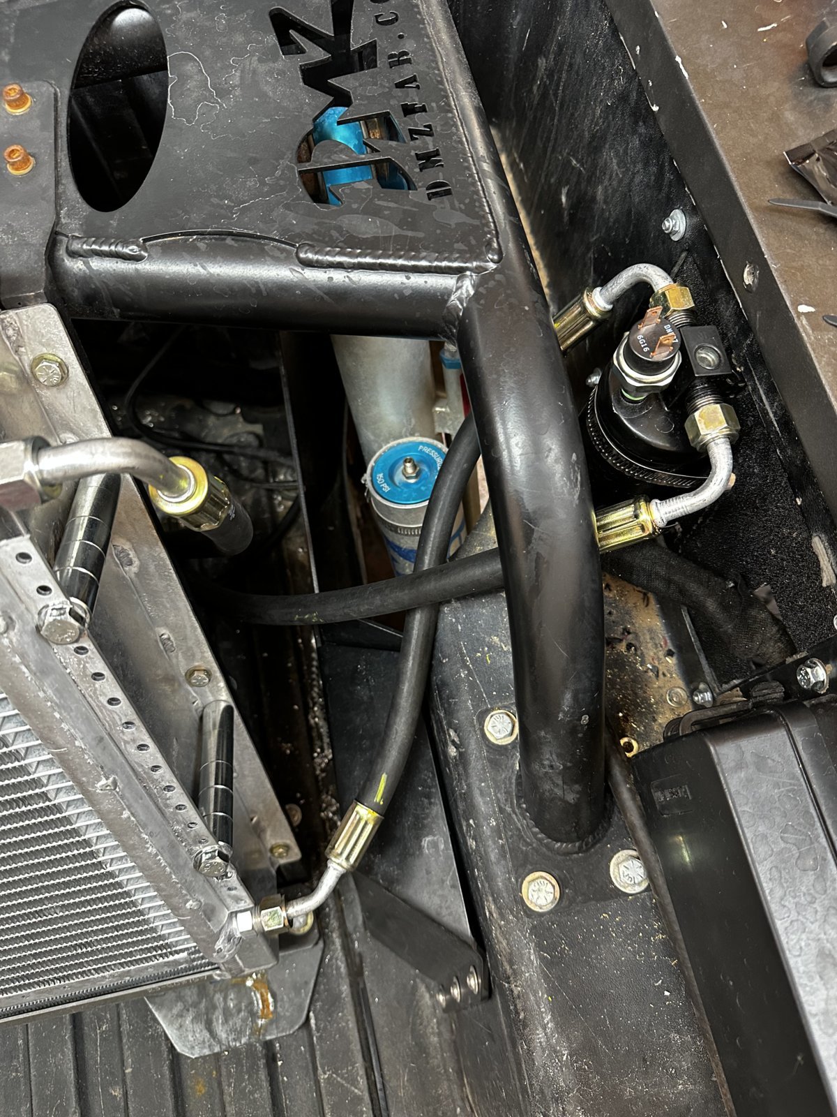

    Well we officially have AC!
    I am waiting on two bulkhead fittings to get here for the bed, I ordered the wrong ones. Once those are here, I’ll take all the lines off, add the necessary orings, and get it all sealed up.
    454 Motorsports is picking up the truck this week to get the new trans in and all the ancillary shit done that goes with it.

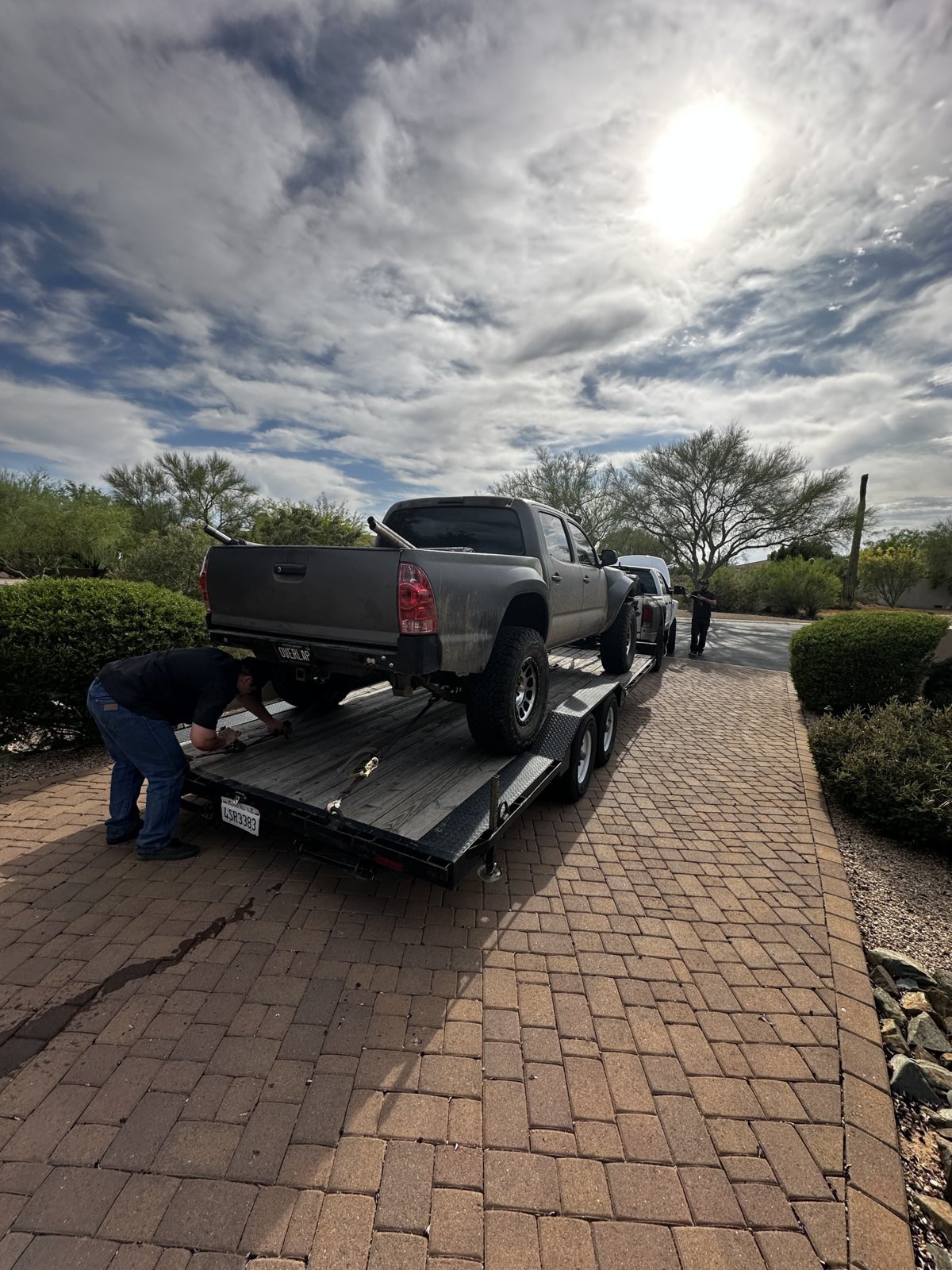

    Truck is picked up and gone. Sounds like he’s getting started on it beginning of next week!

    What oily liquid dribbled out as it was going on the trailer?
    Is 454 going to wash it before returning?

    It’s my coolant tubes. Had to remove the long straight between the bed bulkhead and the motor bulkhead to get the trans out. Some coolant sloshed out of it.
    And I’d guess probably not :rofl:

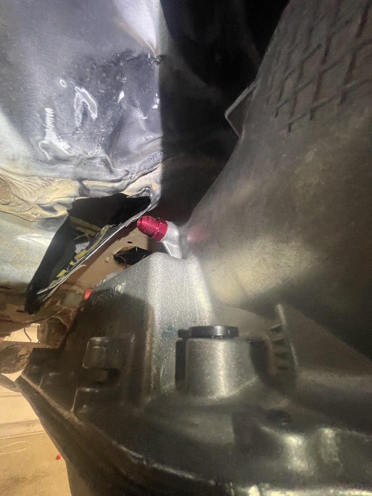

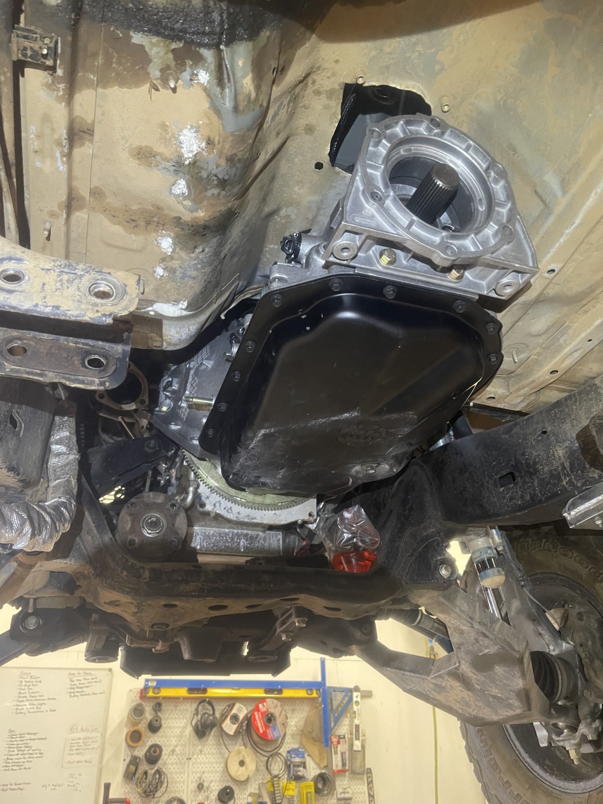

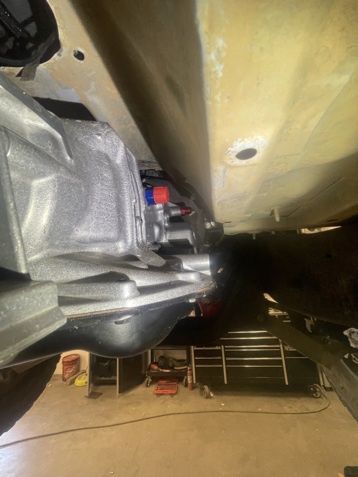

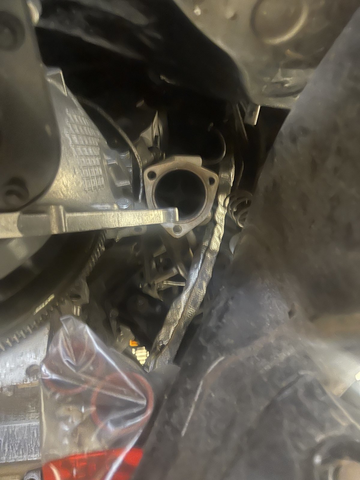

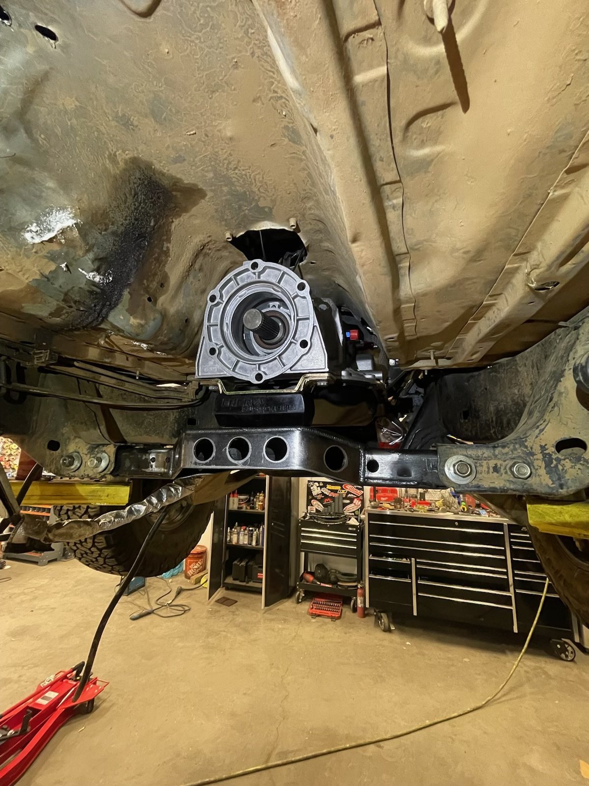

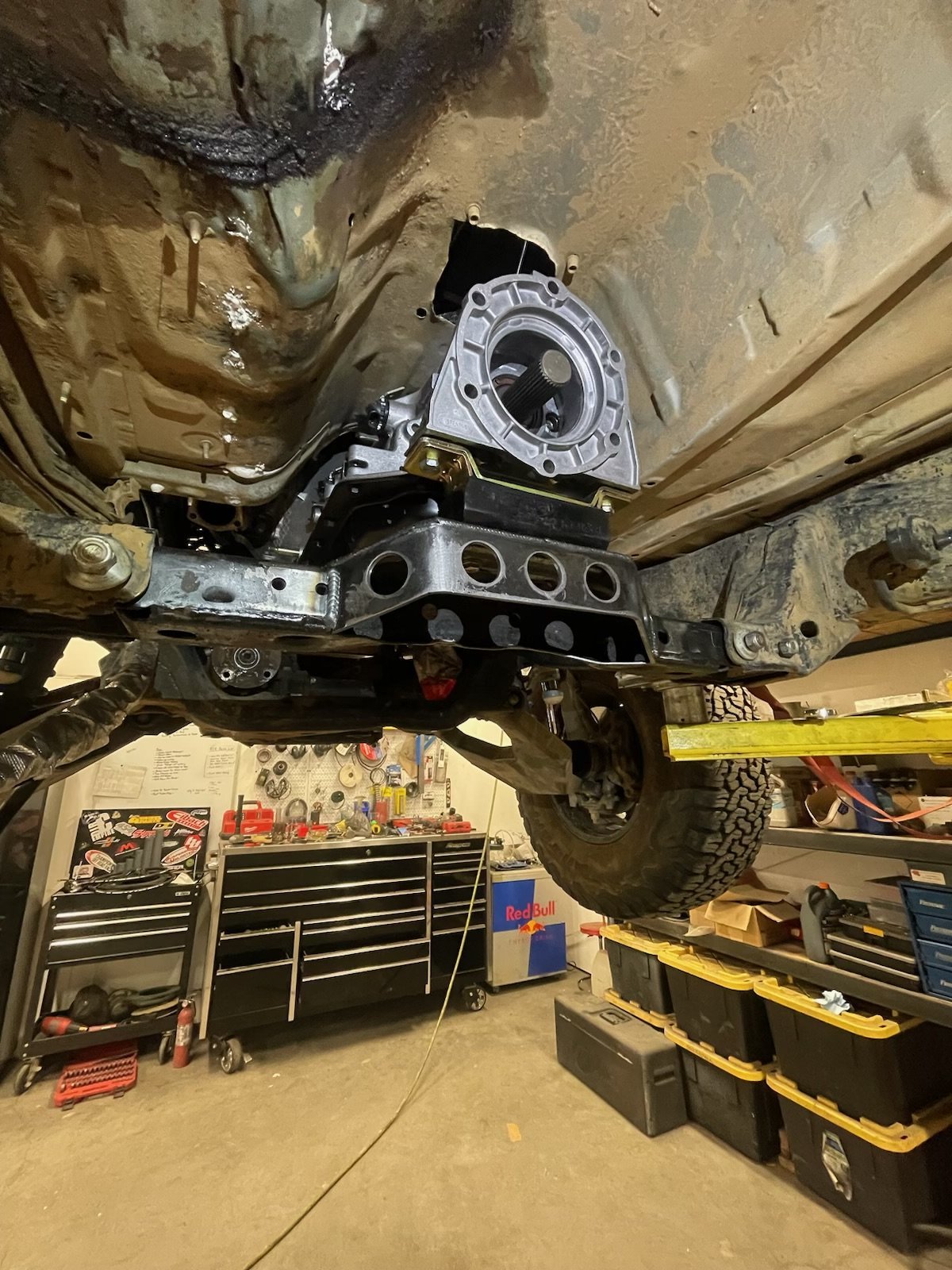

    Well the trans is in the right area! 454 had to put a hole in the floor for the cooler fittings. 4L80E is considerably bigger. So freaking excited to get this truck back. Gonna send it off to get a center console when it’s back.

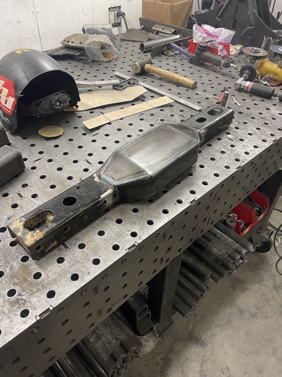

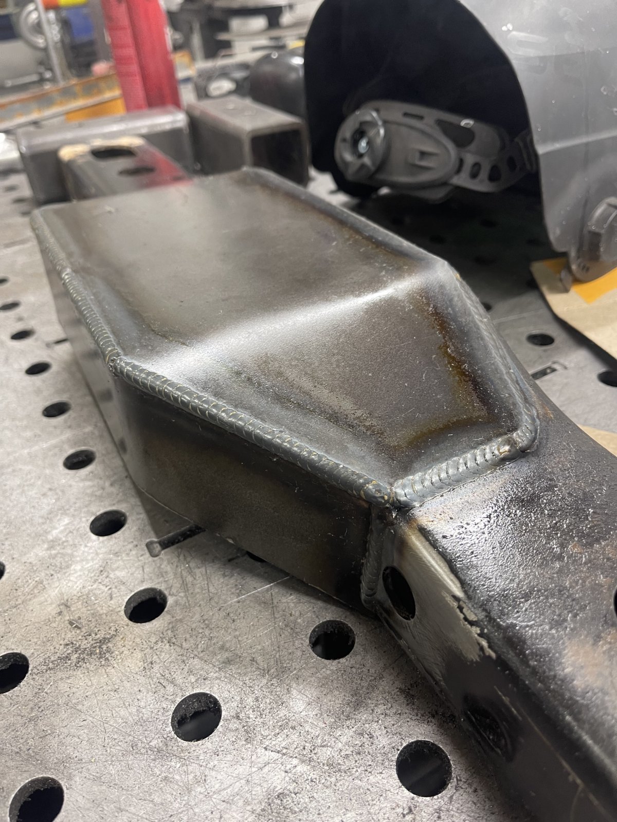

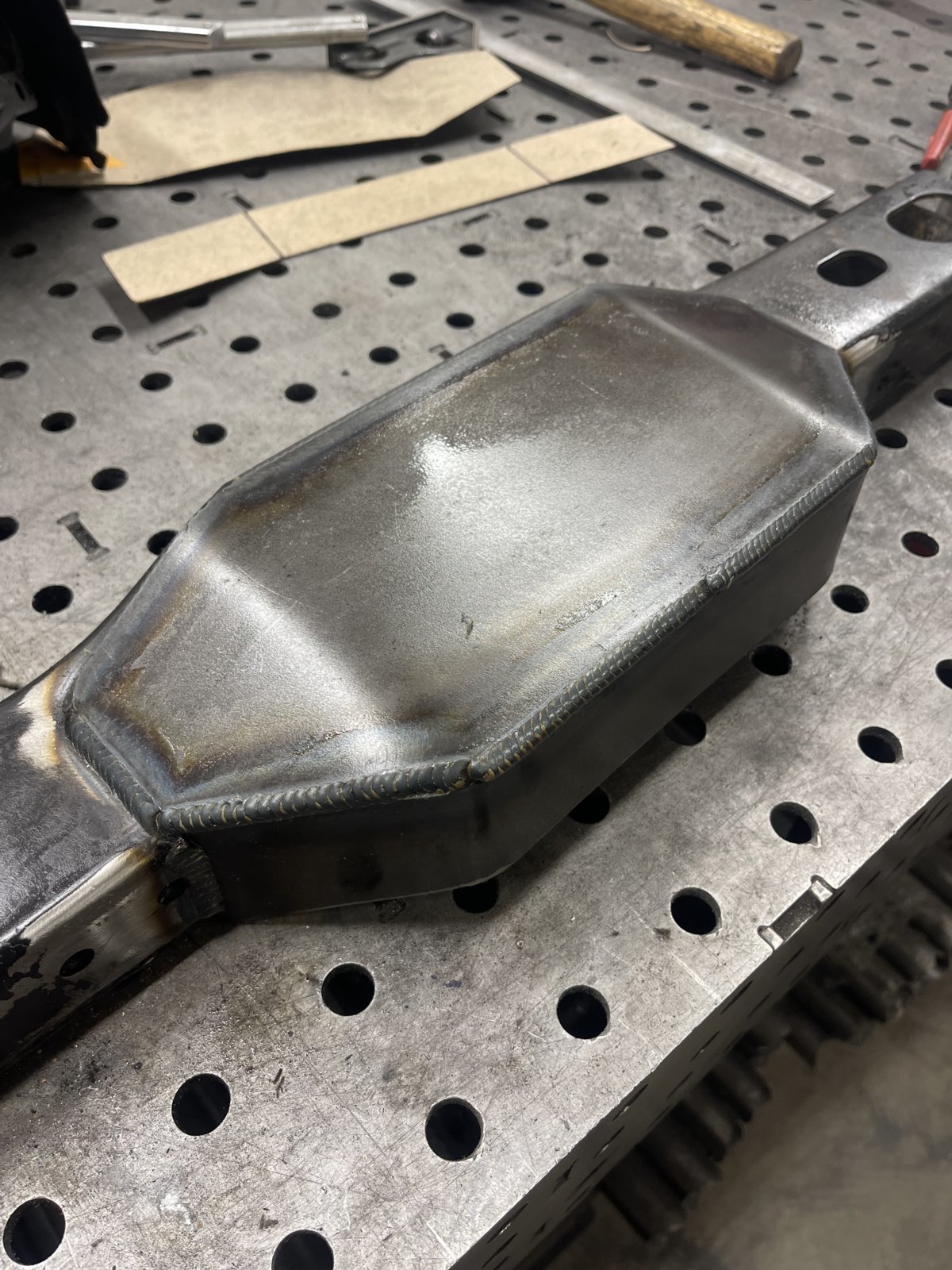

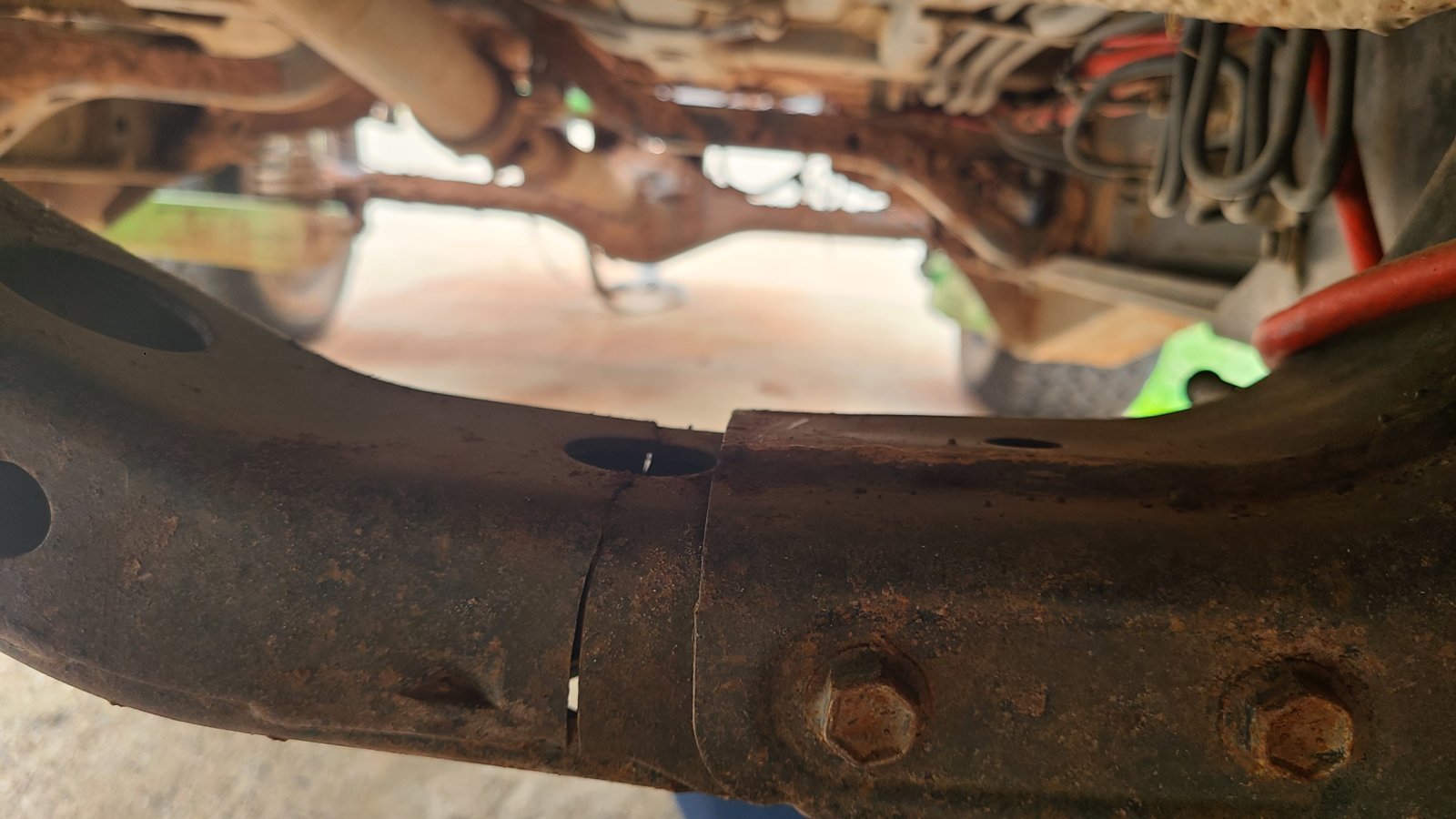

    Beeeeeeefy crossmember.

    The center is certainly beef! If they havent already installed it, see if they can add some gussets of any kind near the ends, so that this doesnt happen.

    Last time I had the crossmember modified, we rewelded just about everything on it. It actually used to have cracks in it. :eek:
