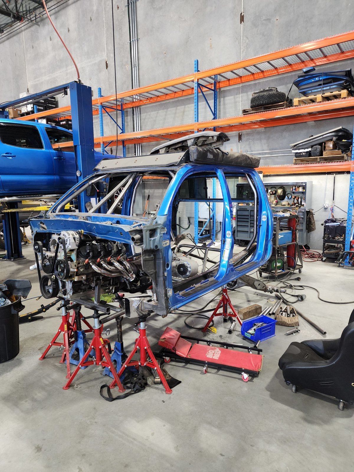

    Im so sick of it. The truck was 99% done. Now its all torn apart again

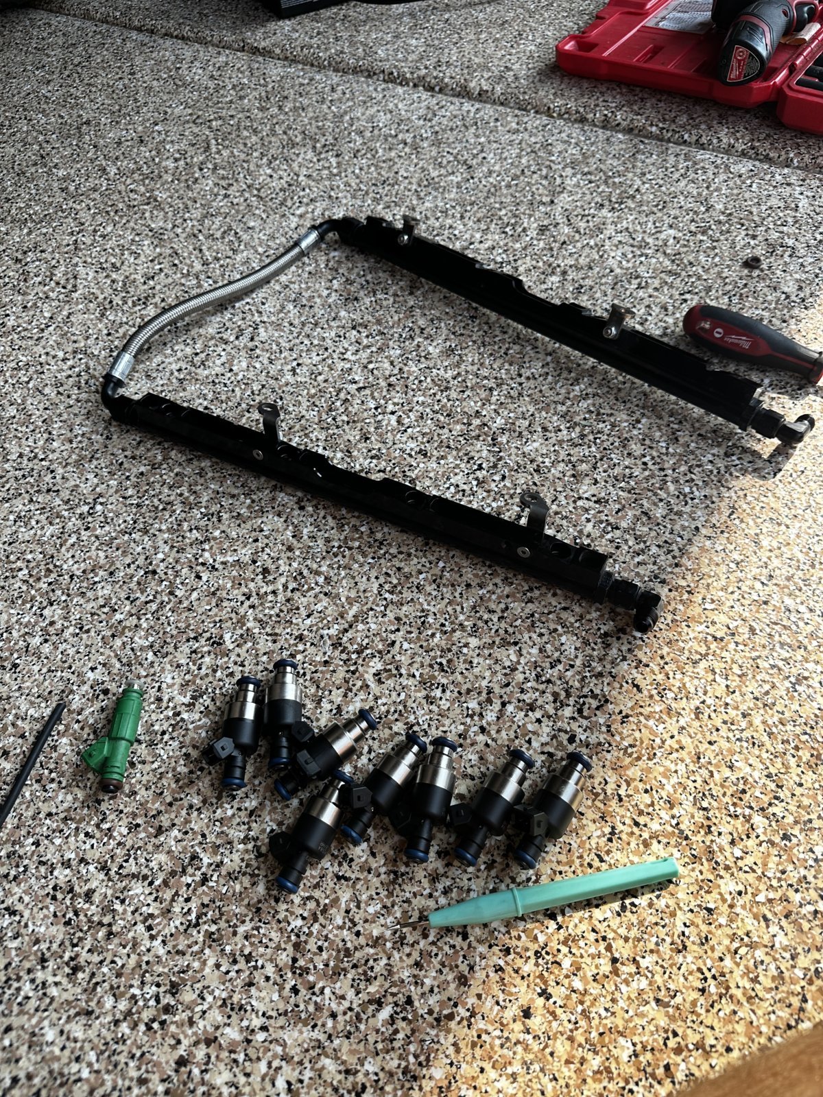

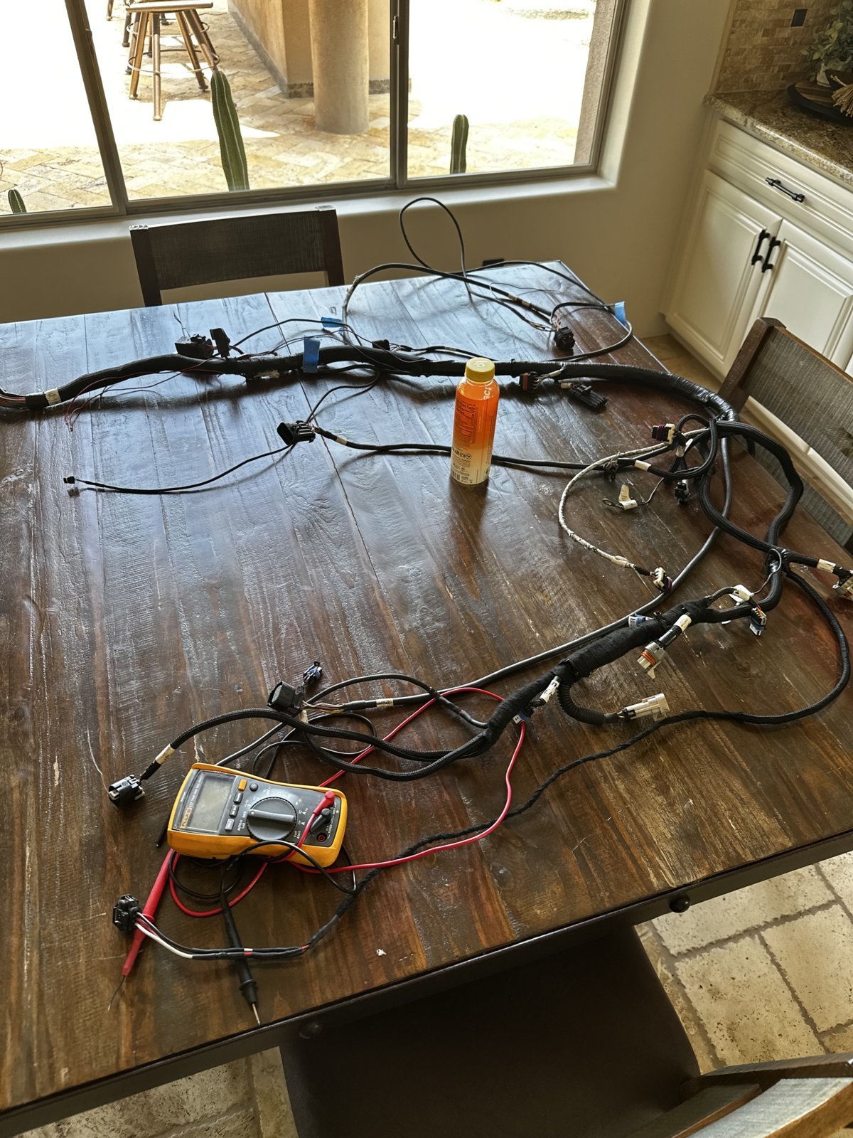

    I pulled the entire harness out of the truck and off the motor and went over every inch of it. I found some unterminated sensor wires that aren’t used for the LS6 that I guess could’ve theoretically shorted, so I heat shrinked them. I also did a resistance check on every wire and each one was under half an ohm.
    I resleeved the entirety of the engine harness to prevent future chafing.
    Injectors were being a bitch, need to get some hardware tomorrow before I can throw those back in, also need to throw the AC wiring back in the truck, but everything is so much neater and nicer in there. I put new MSD coil packs in and genuine ceramic plug wires, and while I was changing it I found a loose spark plug. So that, combined with my exhaust gaskets not being in the exhaust, combined with chinesium injectors/coilpacks, I hope the afr issue is solved
    I also wired up the Holley pro dash so it’ll be plug and play for the dude when he installs it. Only thing I haven’t really done is run power for the radio in the center console. Debating whether or not I even do it now or if I wait till the center console is done.
    The weird sensor errors haven’t come back yet. No tps errors either but I also haven’t really put it through its paces yet.
