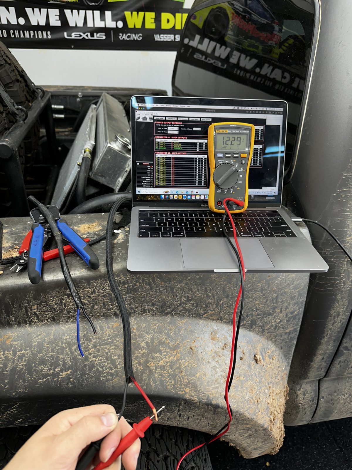

    I don’t understand… Holley output for the #2 fan is activated, I have 12v and ground on the fan connector. When I shut the Holley output off, it turns off, when I turn it on, it’s on.
    But….
    when I connect the fan, the fan doesn’t turn on.
    But….
    When I hook the fan up to my booster pack, the fan turns on.
    im lost.

    What is the voltage on the wires with the fan connected and turned on?
  8. Jul 28, 2024 at 12:22 PM

    Measure the voltage at the connector with it connected to the fan and turned on and not running.

    Voltage with fan disconnected but power on is 12v
    voltage with fan connected but power on is 0v
    resistance across the fan wires is 0.4ohms

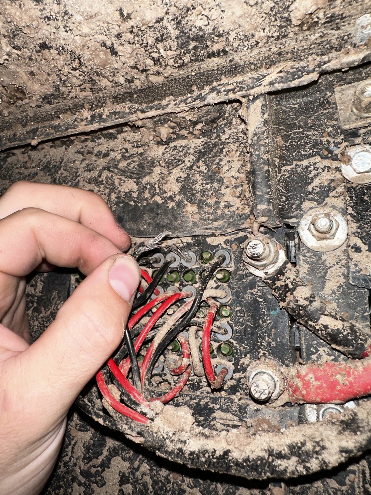

    This is a perfect example of why we want the circuits to be loaded when checking powers and grounds with a meter, you have a circuit that can supply voltage but can't supply any current.
    Now to see where the voltage drop is, do the same test (fan connected and turned on) with one meter lead to fan negative and the other to a known good ground. Measure that voltage, then go from fan positive to a known good power and measure the voltage.

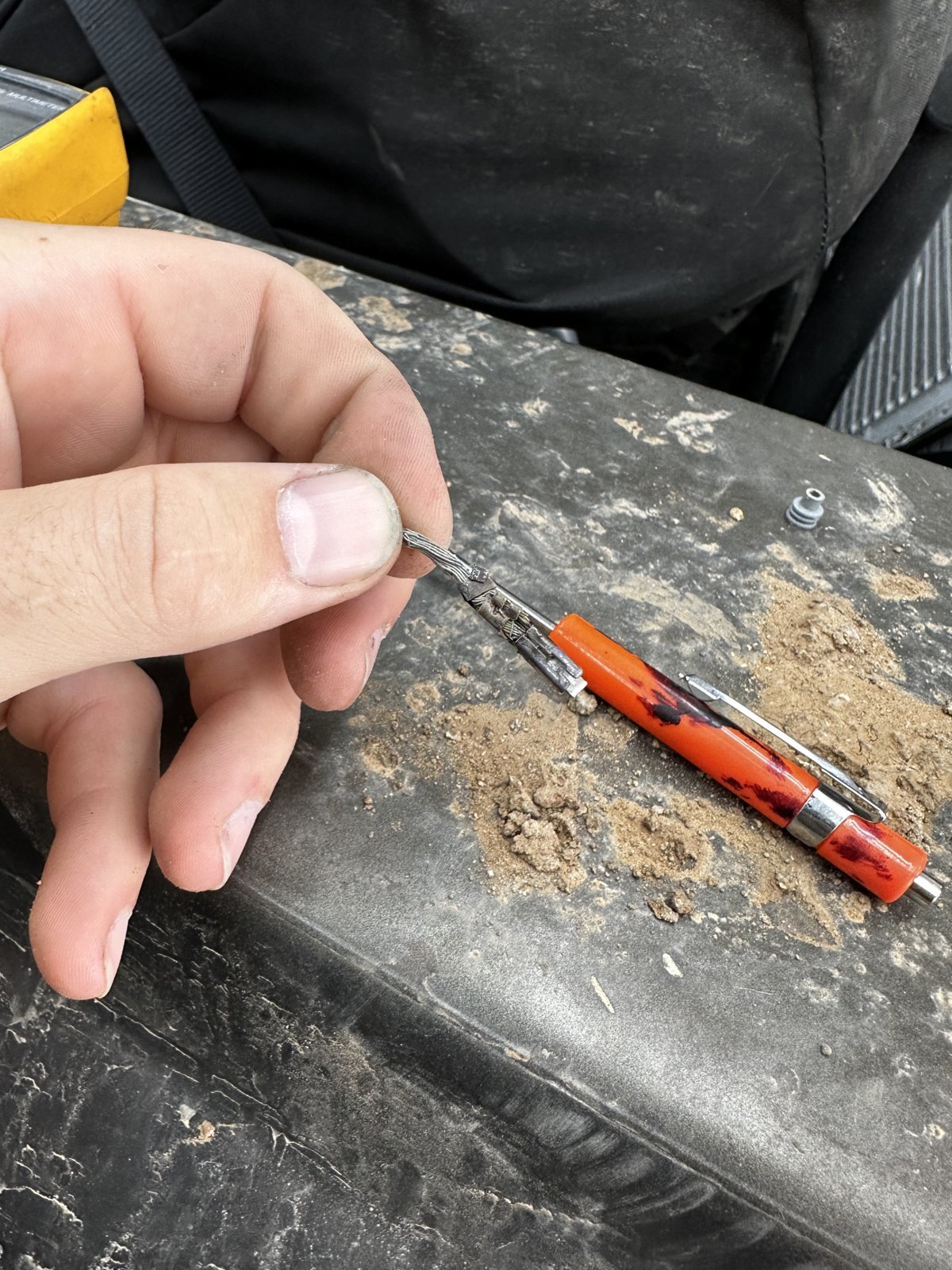

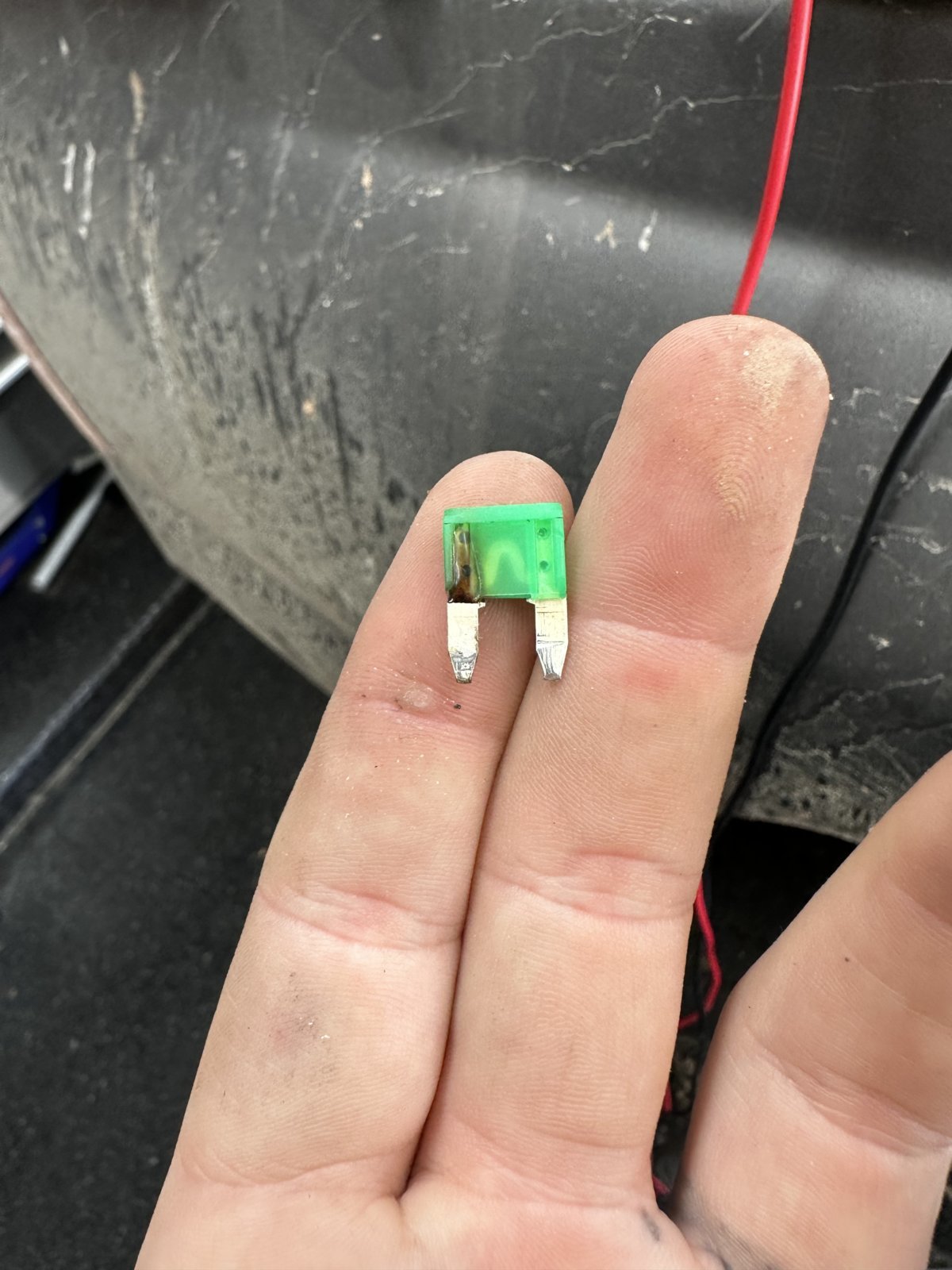

    Welp. There’s the answer. Ground had continuity, but like you were saying not enough to produce any current. Trying to find my other pins for this busman box so I don’t have to clean this pin lol
    Fuse was still conducting too. Wasn’t blown…

    Mmm crunchy.
    That wire looks awfully small for a 30A fuse though.
    How many amps do those fans pull?

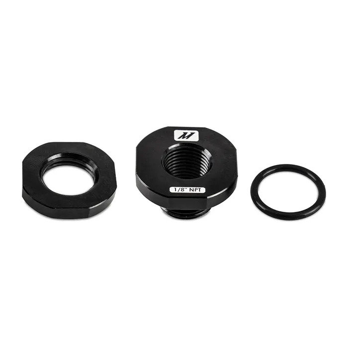

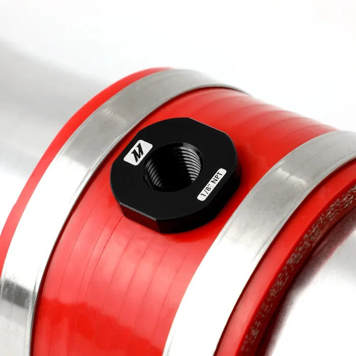

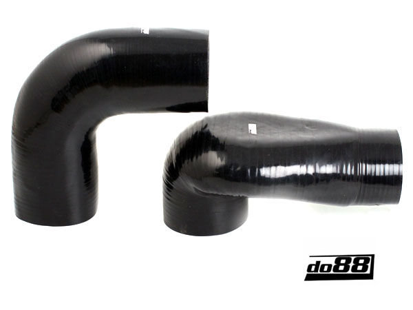

    So I wanted a really simple intake solution for the truck, basically just an elbow turn down for my air intake. Problem is, no one makes a tight radius aluminum elbow with a 1/8 NPT bung for my MAT sensor. I found this company in the UK, that sells 4" Cobrahead style silicone couplers! Ive used these before, on my supercharged lexus rc350 that I used to own. Really cool tight radius bend with no air restriction:
    wot-motorsport-do88-do88-cobra-head-intake-hose-102mm-4-inch-1627549814SCOB102-image5.jpg
    To pair to this, I ordered this mishimoto sensor bung for silicone intakes:
    mmft-nzl-18_1_6kx1ipik6vfsatxf.jpg.jpg mmft-nzl-18_5_rn8acpxjmgnhnybo.jpg.jpg
    And lastly picked up a stainless steel joiner for between the cobra head and the filter. Should pair pretty nicely. I would've liked to have one of those sweet particle filters like @tacotunner06 has where its filters using centrifugal air flow, but I do not have enough room in my engine bay. Not even close.
