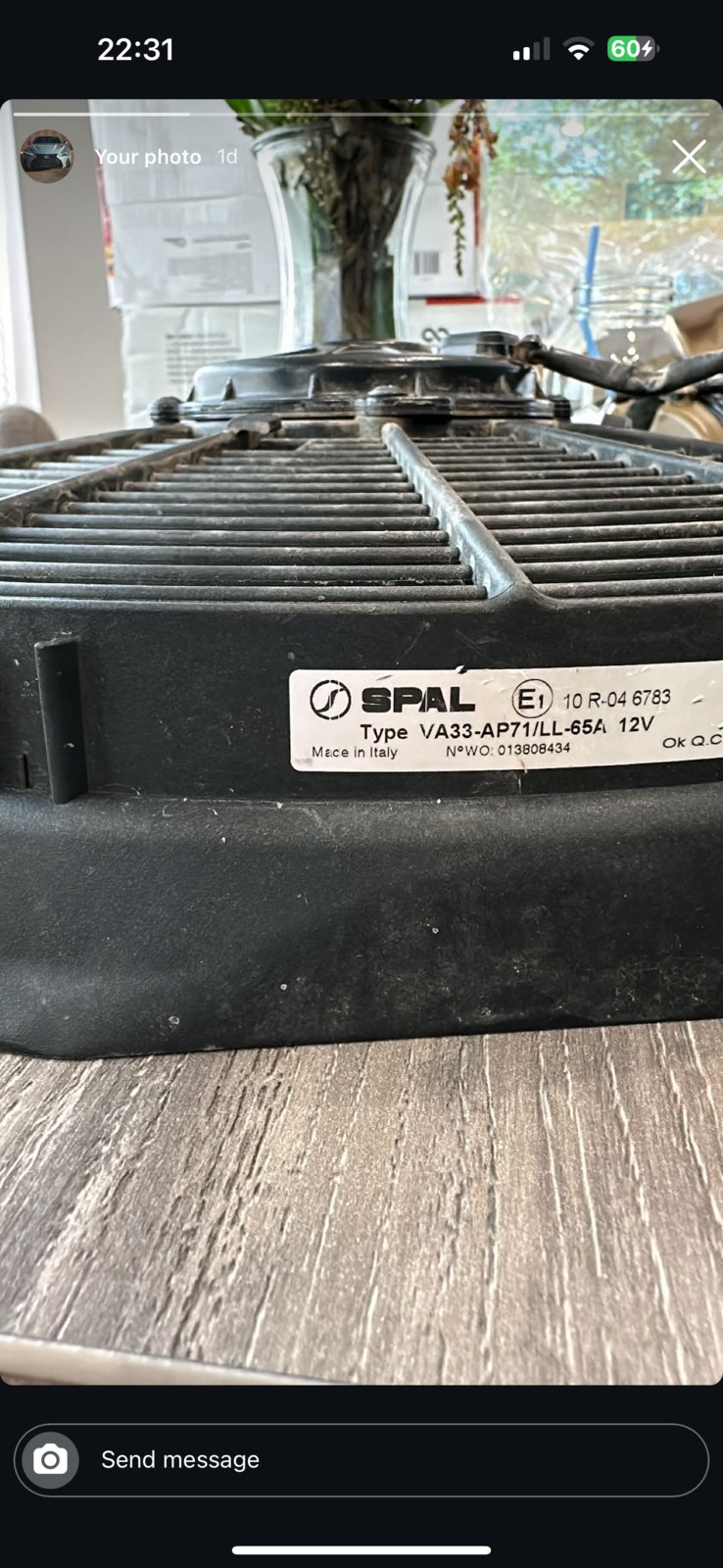

    The wire runs are only about 4 feet. The spec I found online says 65watts, which means 5 amps and some change, which seems low to me. And the wire I’m using is truly copper wire, no CCA. I’ll throw 20 amp fuses in there instead. Maybe that’ll help my problem.

    What diameter fans are those? 5 amps seems low for a radiator fan.
    If they are indeed only drawing 5 amps you have some serious poor connections for it to be melting like that.
    I'd throw an amp clamp around the wire and see what the actual current is.

    16” spal fans. Curved blades. That’s a really good idea about the current clamp. Will try that.

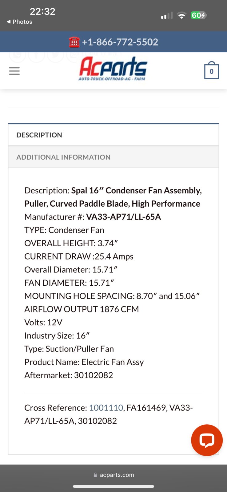

    Finally found some data that looks accurate. 25 amp draw.

    @Dm93
    What would you suggest be done here? Switch over to the MSD solid state relay? The fan wires are still 14 gauge, can’t change that.

    Now that's more reasonable, no wonder your cooking that fuse connection.
    So you probably ideally should have at least 12-10 ga wire and a 40 amp fuse as you typically don't want the normal working current of a circuit to be more than about 75% the current rating of the fuse protecting it but you also want a heavy enough wire so that the fuse will blow instead of the wire melting in the event of a short or over-current condition.

    I can’t do anything about the wiring coming out of the fan itself, but will run 12 gauge everywhere I can.
    do you think the MSD will be fine? It’s rated at 35a continuous through each channel.
