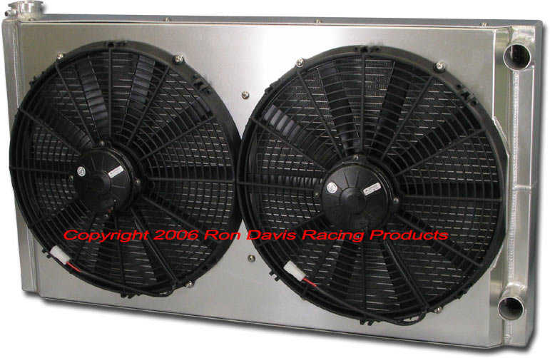

    • 34" wide x 19" tall x 3" thick (7.5" thick including fan)
    • Standard filler neck
    • Right side connections double pass configuration
    • 1.5" inlet & outlet diameter
    • Dual 16" Spal fans - 3836 CFM combined
    • 2 rows of 1" wide tubes

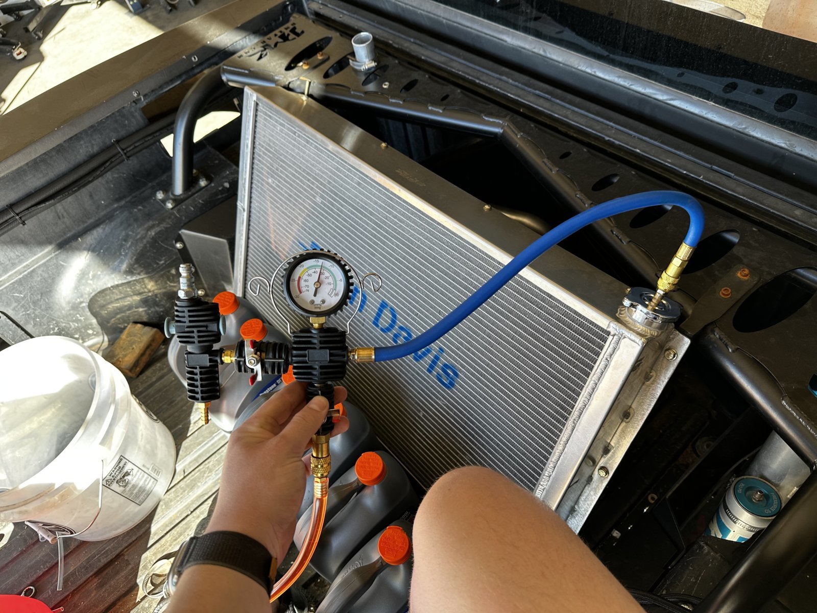

      Yep it’s mounted in the bed:
      And yeah I do have an engine oil cooler, 10AN lines, setrab 9 series 20 row cooler with dual fans, activated by the Holley above 170*. Haven’t seen temps get over that though.
      And for transmission, I have two Derale race series coolers with 8an lines and an improved racing fluid thermostat.
