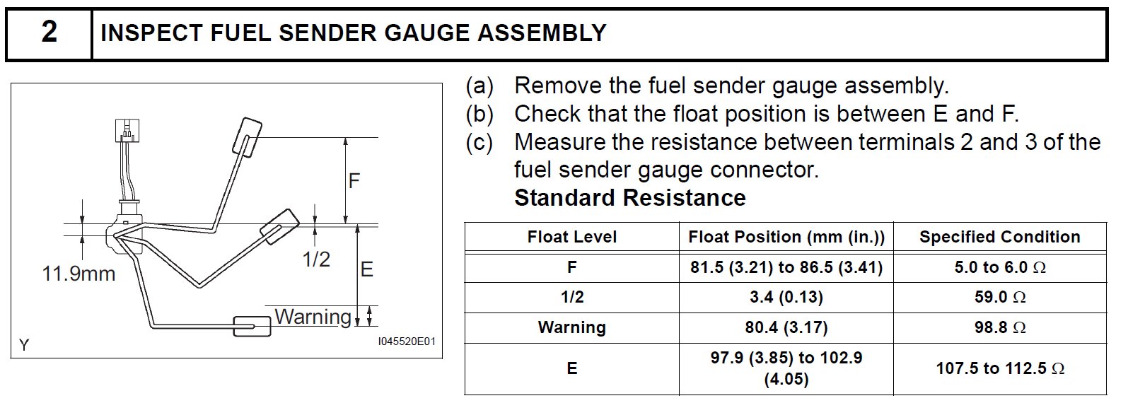

    @Dm93
    @caribe makaira
    could one of you look up what the fuel level sender resistance should bed with an empty tank and with a full tank? Need it to program the Holley fuel level gauge.

    Goat. I hope I don’t need anything else to call this project done!
