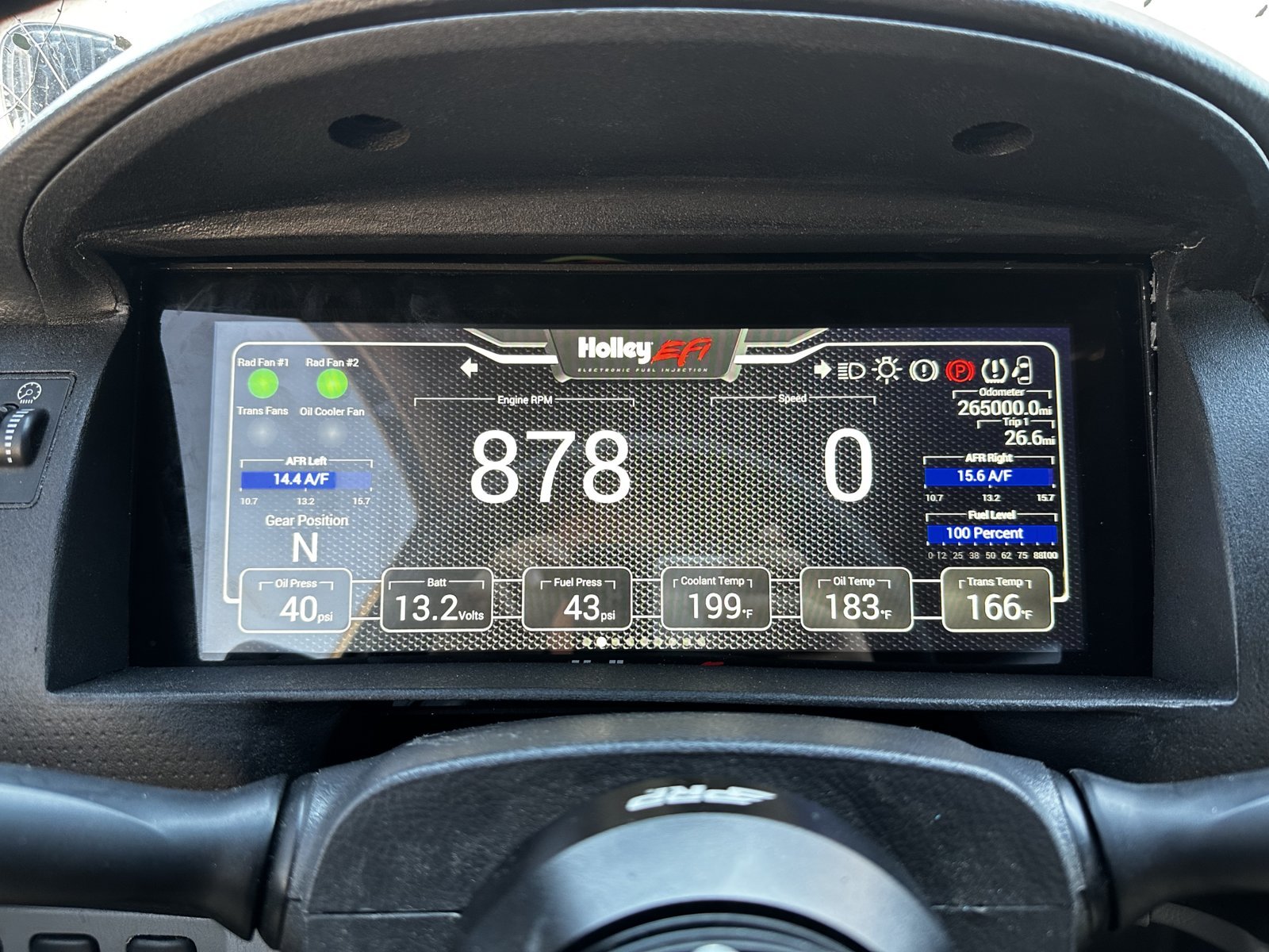

    Sooooo I have a theory. Whenever I got my truck back, I needed to continually add coolant to it as it burped itself after being freshly filled. If I remember correctly I was using a bottle of concentrate, not 50/50. So I probably have a very antifreeze rich cooling system. Antifreeze lowers the water’s ability to pull heat out, which might be contributing to my running warmer than I’d like issue.

    Well I think my theory is correct. I siphoned 1 gallon of antifreeze out of my radiator, and replaced it with one gallon of distilled water and my temps were about 10 degrees cooler on average. never got above 200! Im going to pull another gallon out tonight after it's mixed around. Tomorrow I'll do a refraction test and see where im at before I add the water wetter.

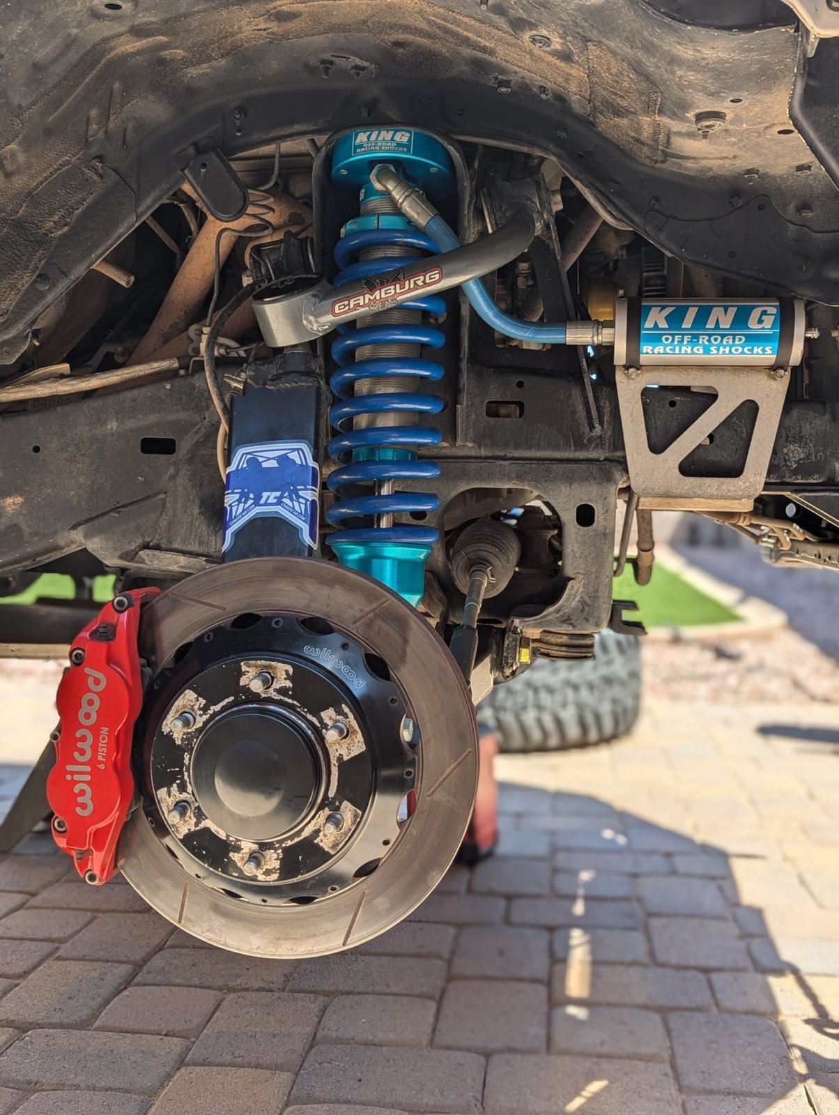

    The front driver side brake caliper is sticking. Should I do a BBK? I want to keep my 17” wheels. Or should I do a 4runner/GX brake upgrade?

    I'd go BBK... and I'm biased, but my Wilwood BBK has been fantastic. Drastic improvement in braking power, not to mention a significant weight savings.

    Just went back and checked purchase orders.. Bought from Autoplicity back in May of 2021.. Kit was $1500.

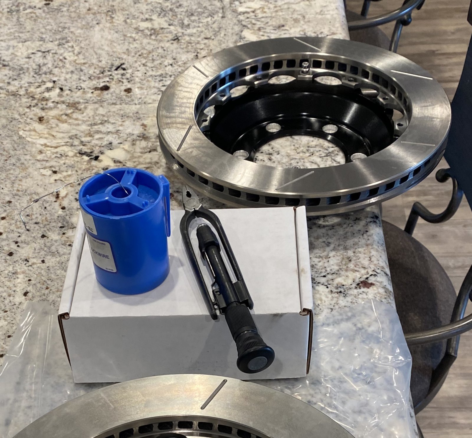

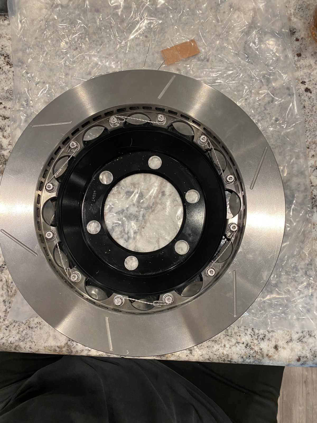

    Dec 26, 2012
    #93790
    4,883
    Tom
    SoCal
    https://www.tacomaworld.com/threads/airdogs-2012-prerunner-access-cab-slow-build.264263/
    Practice your safety wiring!!
    sicki, Slashaar, Hayden334 and 4 others like this.
