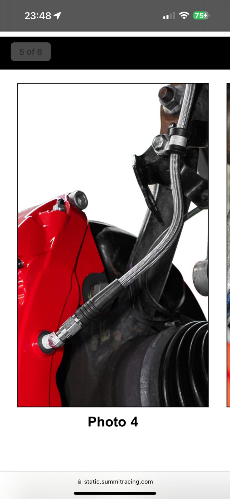

    Forgot to ask you, are you LT? Did the brake lines included with the wilwood kit end up being long enough? I have some super long extended brake lines on the truck right now with a male fitting on the end that goes directly into the caliper, but I’m not certain if the wilwood fitting thread 1/8x27 npt is the same as the stock Toyota caliper. They include an adapter fitting and lines that look like they might be long enough but not positive.

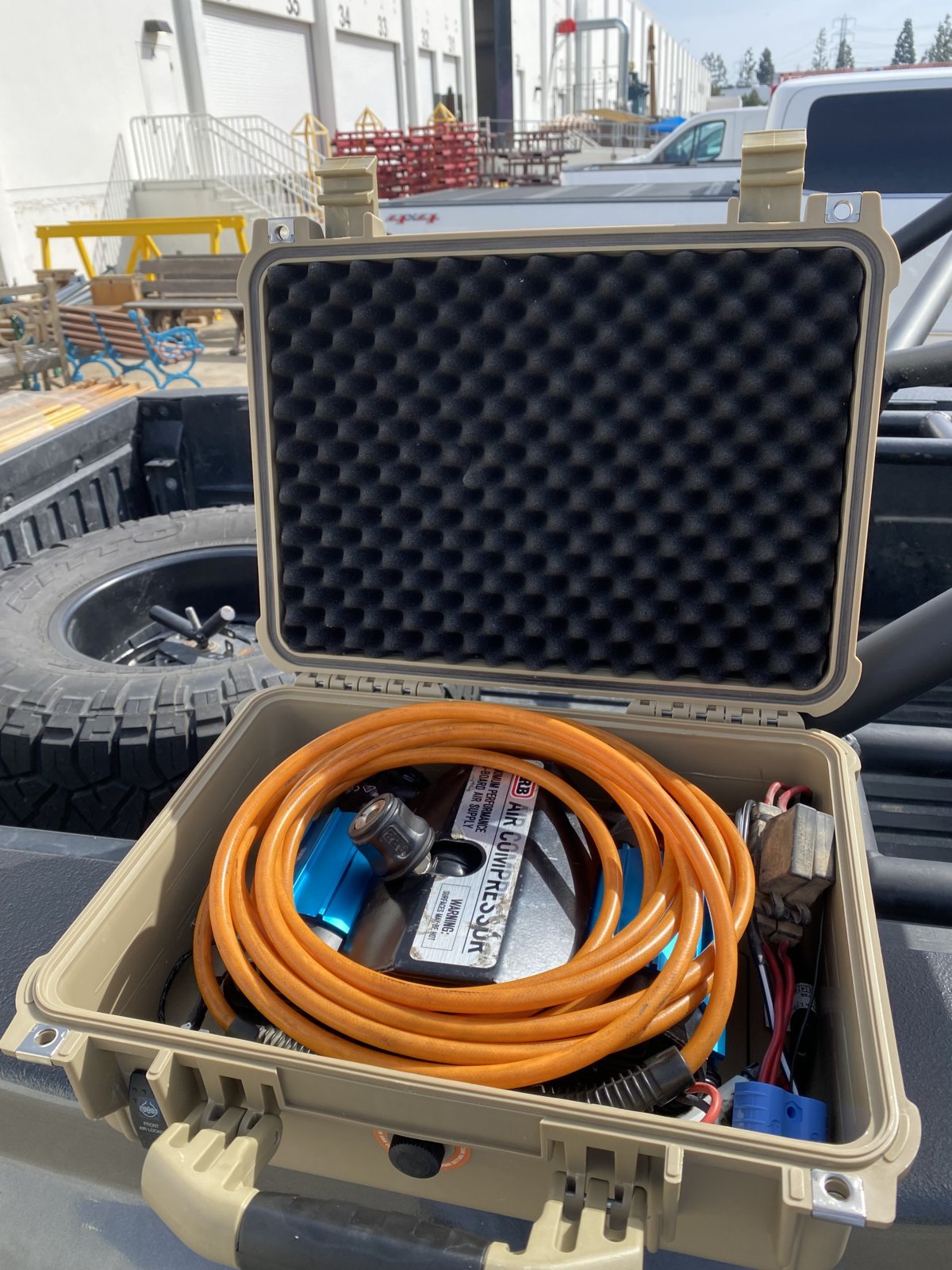

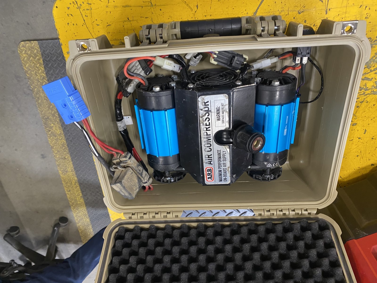

    Or this is what I did because I was too lazy to find another mounting area and run wires. I put it in a box from harbor freight added a switch on the outside and a quick disconnect at the battery in my bed.

    Not LT, but yes.. they come with new, longer lines. I already had longer stainless lines before the kit, but I had to switch them out for the Wilwoods because like you said, they have their own fitting. The lines are long, but idk.. I'd call and see if they have any longer ones. I think they do IIRC.. or maybe the included ones are long enough. I can measure when I get home if needed.

    I have my compressor mounted inside the driver bed cubby, a single power wire ran to it from the battery with a 100a breaker at the battery. Grounded on the frame rail where some of the other harnesses ground by the rear bumpstop.
    I simply use the switch that is on the compressor I bought.

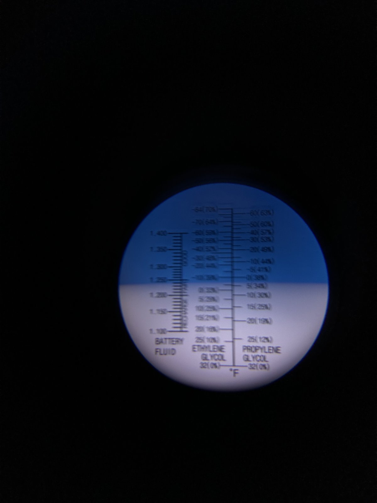

    Hard to tell, but we’re right at 40% antifreeze after removing two gallons of the antifreeze and adding two gallons of water. When I added the the waterwetter, I took another gallon out, added the waterwetter, and filled the rest with distilled water so we should be just under 40% antifreeze, which is still like -26* protection.
    gonna go drive it a bit and see how it improves.
    I also swapped out the interior lights today, they were this super ghetto blue color, ever since I owned the truck. Finally got some normal 6000k white led’s installed.

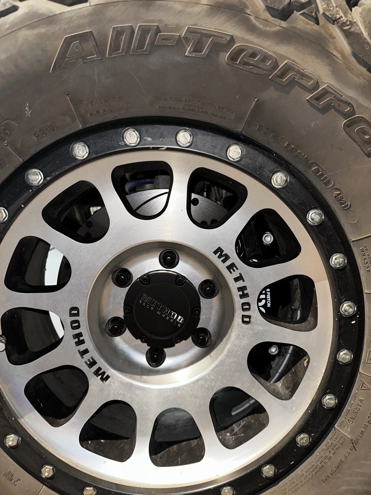

    Big wilwoods installed today:
