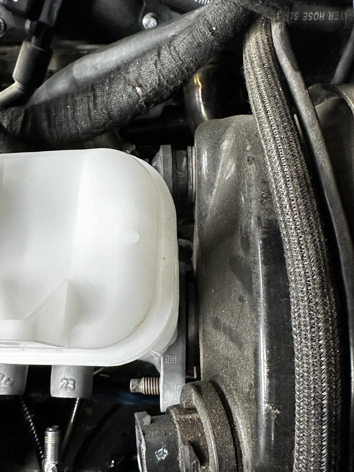

    Unbolt the master cylinder and see if the rod is putting any tension on it, it should sit flush agains the booster with no tension pushing it out.

    Not quite flush.

    https://www.tacomaworld.com/threads/airdogs-2012-prerunner-access-cab-slow-build.264263/
    Yup ...gonna need to shorten that rod on the pedal

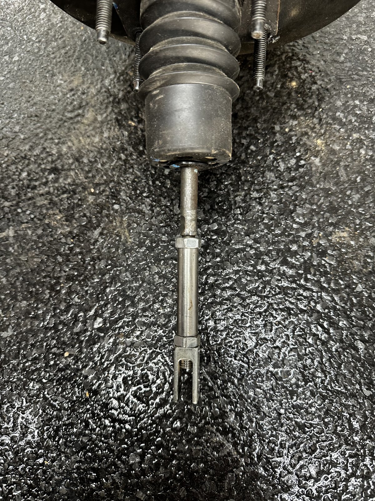

    Didnt you modify the pedal to get the correct rod length? You should only have to adjust that length. It doesnt require the removal of the booster....at least mine doesnt. But yes shorten it that length and a touch more. I adjusted mine so there is about 1/4 inch pedal movement when the rod touches the master cylinder....you can feel touch it by pushing the pedal by hand. hopefully im making sense to you.

    Nope the pedal is stock. Never modified it, only added the rod extension. You’re saying that the pedal moves 1/4 down before it engages the MC?

    This is my rod length. I’m going to have to remove one of those jam nuts.
