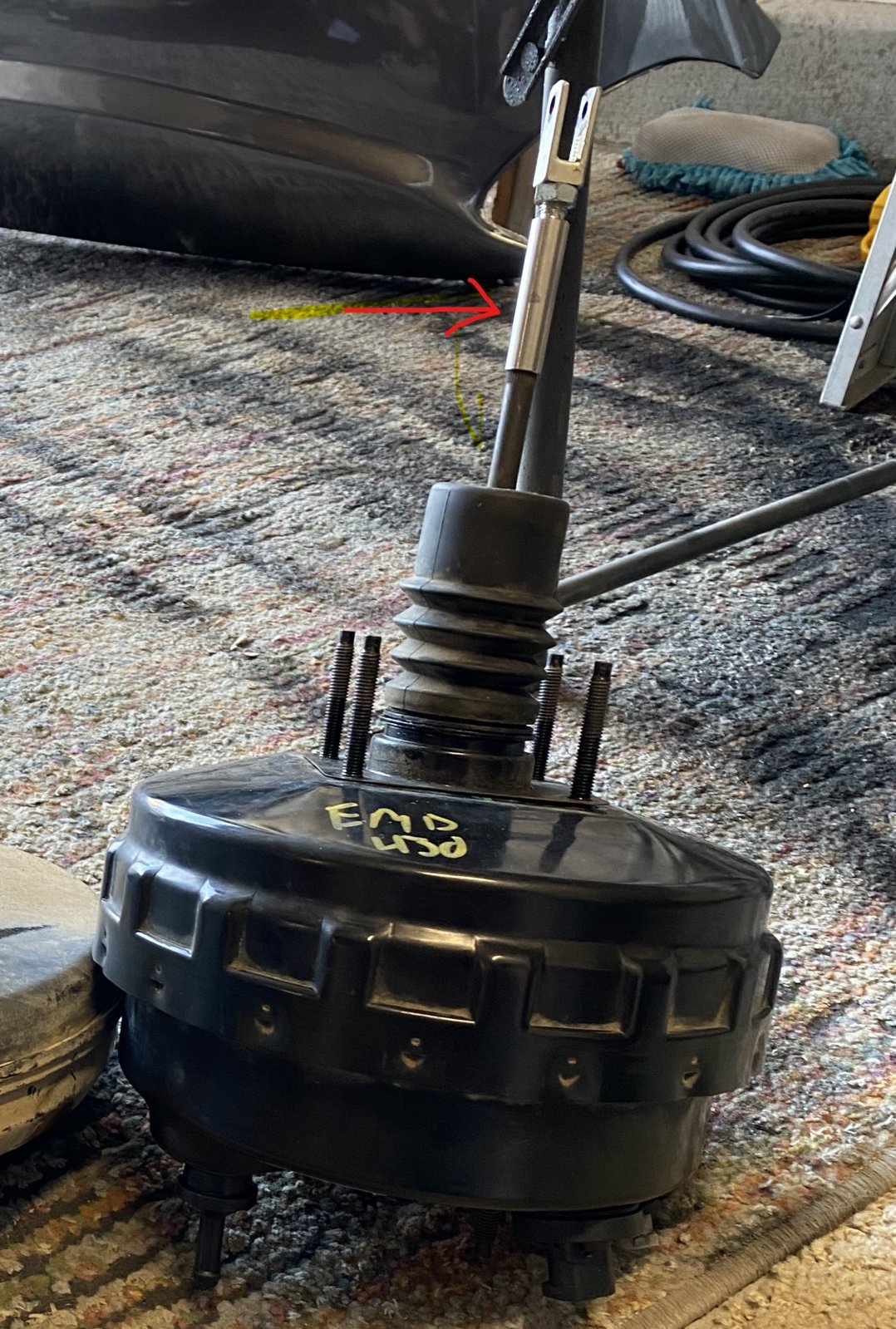

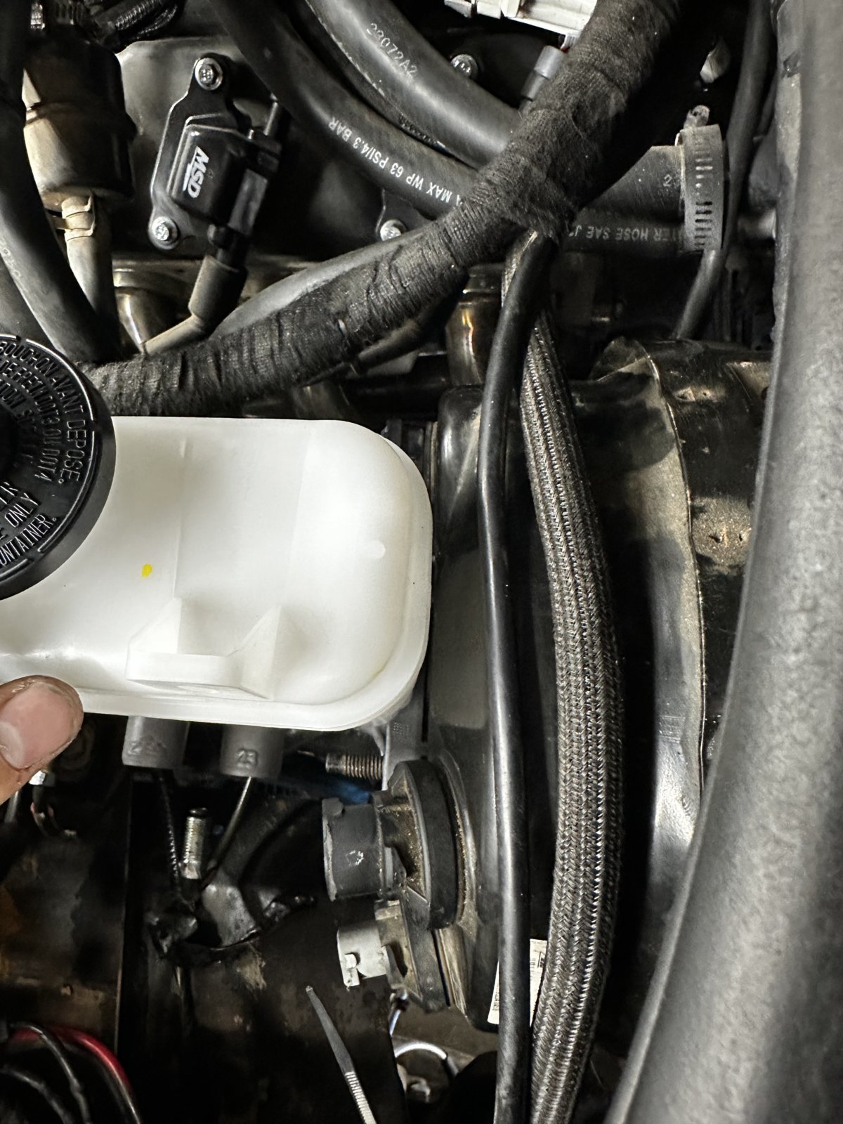

    You didnt have to add an extension? Here is mine...the arrow is showing the extension. EDIT....I now see you did do this. There isnt enough adjustment there to fix your issue
    But more is coming to me now. I had the SOS performance setup that had that rod extension that went into the master cylinder. I had to machine it down to get the right length to work with the Tundra booster. Without that rod, when pushing the pedal down it didnt reach the master cylinder. That rod at its original length had the master cylinder engaged...pretty much what you are seeing with yours right now. So removing the master cylinder and shortening that rod should fix your issue.....if I'm seeing and reading your post correctly. I also have the sequioa master cylinder that came with the SOS kit which seems to be different than the actaul tundra MC....so that may change things some depending on what MC you have installed.

    Well I took the jam nut closest to the booster off, put some loctite on, and put the extension back on, then jam nut then clevis. Torqued the fuck out of the extension to the booster rod.
    when I reinstalled, I actually had to push the pedal slightly to get the pin hole to line up, maybe 1/8”? So I think we’re in good shape now?
    I can’t tell if this is flush or not. There’s no resistance on it and I can push it flat, it just sits at an angle.
    tacotunner06 and WormSquirts like this.

    On the right track for sure. Hopefully this solves the issue.

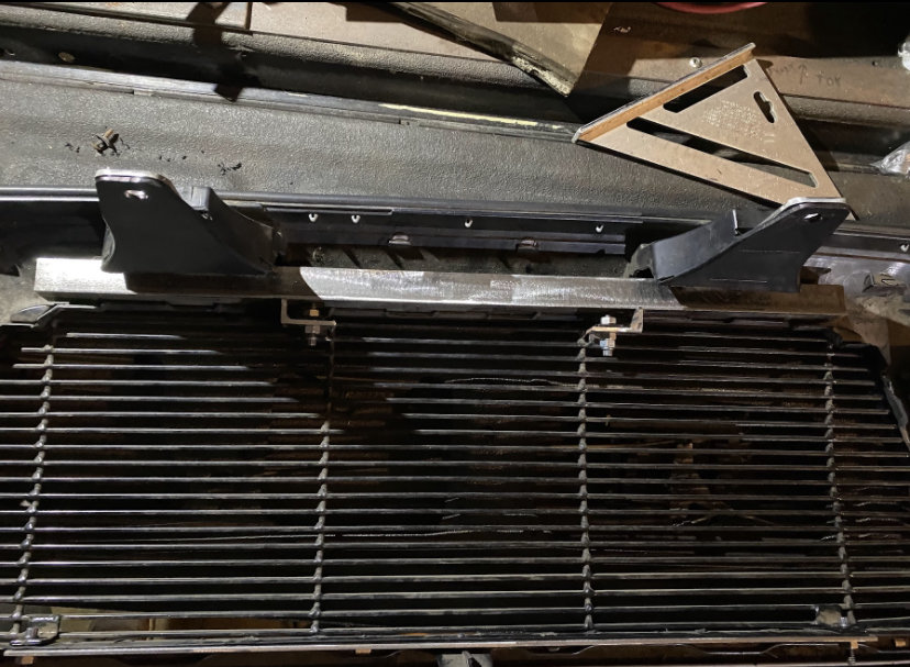

    If you're pretty good with CAD (cardboard aided design), I'm willing to bet @Kwikvette could make something for you. He seems to really excel in these random 1-off metal work requests. Idk how feasible a full steel grille replacement would be, but I'm sure he could dream up a solid way to reinforce/replace those tabs with metal with some sort of "cage" to capture the other grille mounting points. This is completely out of my realm though, so no idea what I'm talking about. Just recommending him for solid and proven metal fab projects around here.

    I added metal brackets to an aftermarket grill for the same reason.

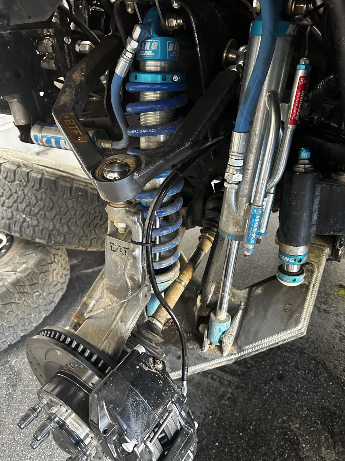

    Big thanks to crown for getting these made same day and overnighted for me.
