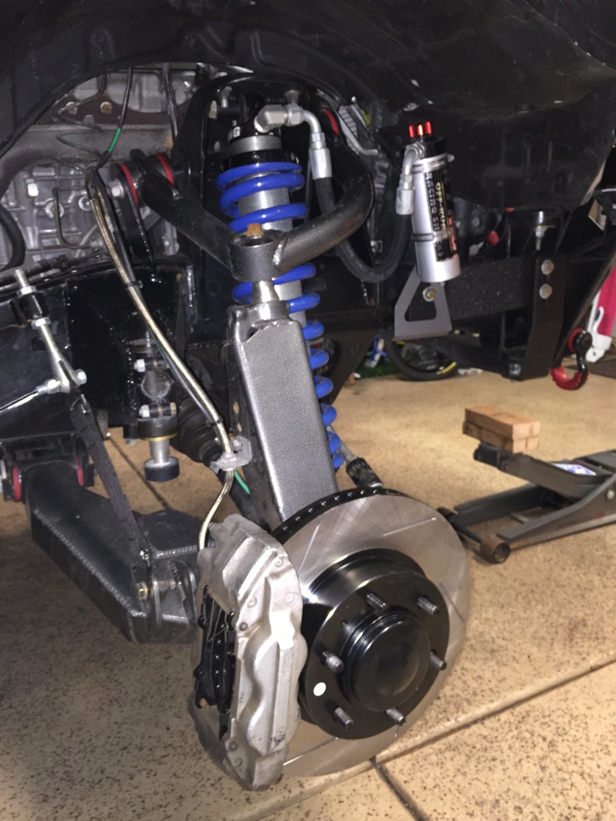

    That zip tie on the brake line is sketch, get a single hole strap and mount it to the threaded hole on the spindle, this an old photo from my previous solo Motorsports kit but same idea.
    you want the strap to not fit tight, you want the hose to be able to slide through it as the suspension moves

    My brake/abs line are all “hard” mounted with zip ties like his. Been like that for years no issues. Just need to make sure there is enough slack in the right areas for suspension cycling.

    I just made sure there’s good room for lock to lock turning, and room to flex at the UCA uniball and frame pivot

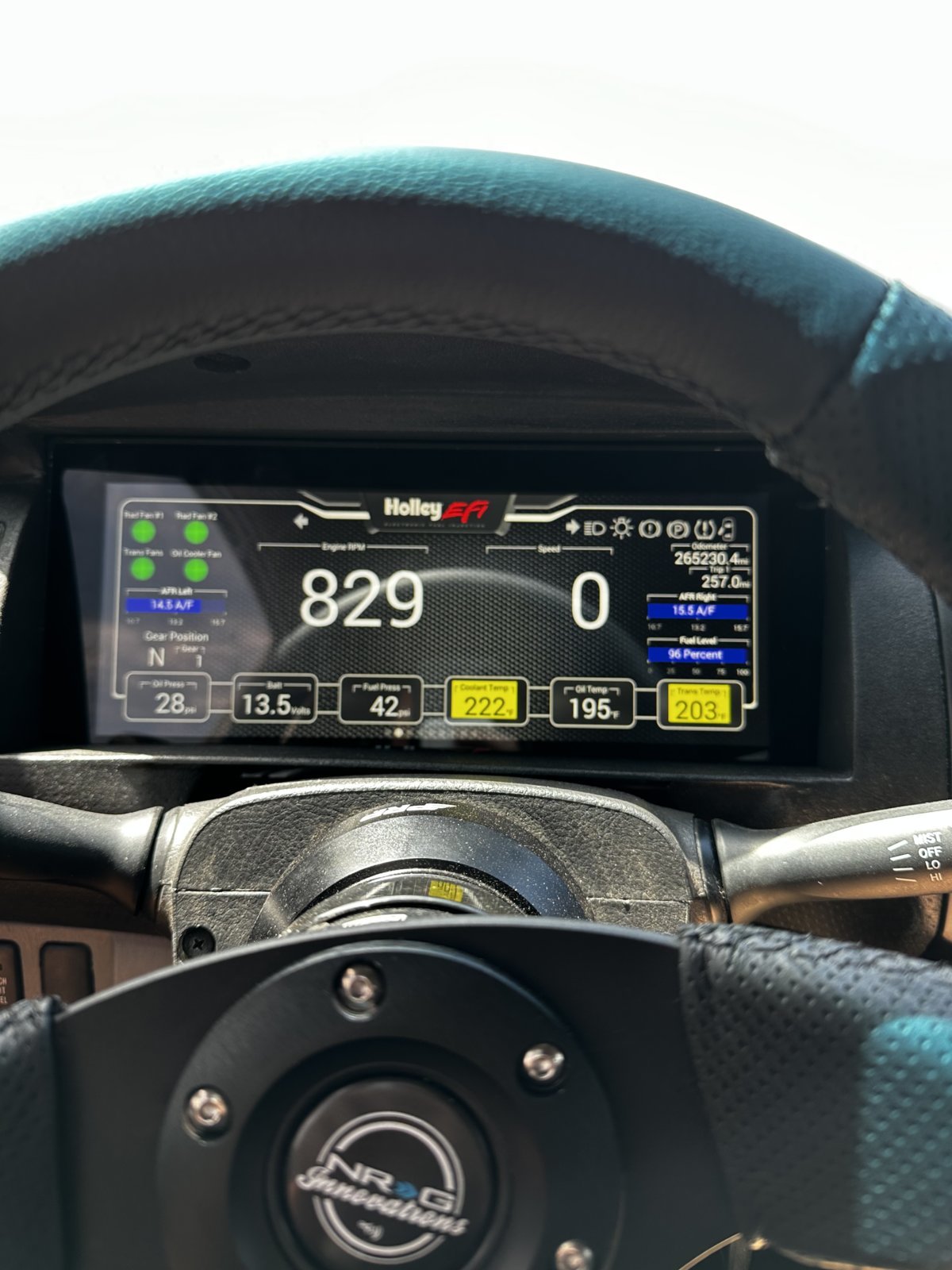

    Well, I crested Humboldt mountain again, my benchmark for testing out trans coolers. Trans only got to 203 this time! Coolers are doing their job well! Coolant got to 222 though. A little warm, but I also had the AC blasting. Everything cooled right off once I was at the top, and took that picture. Didn’t get hot at all for the rest of the trip.
    The truck did suffer a casualty though….
    my front turn signal bulb rattled the filament to death.
    All things considered, pretty good.

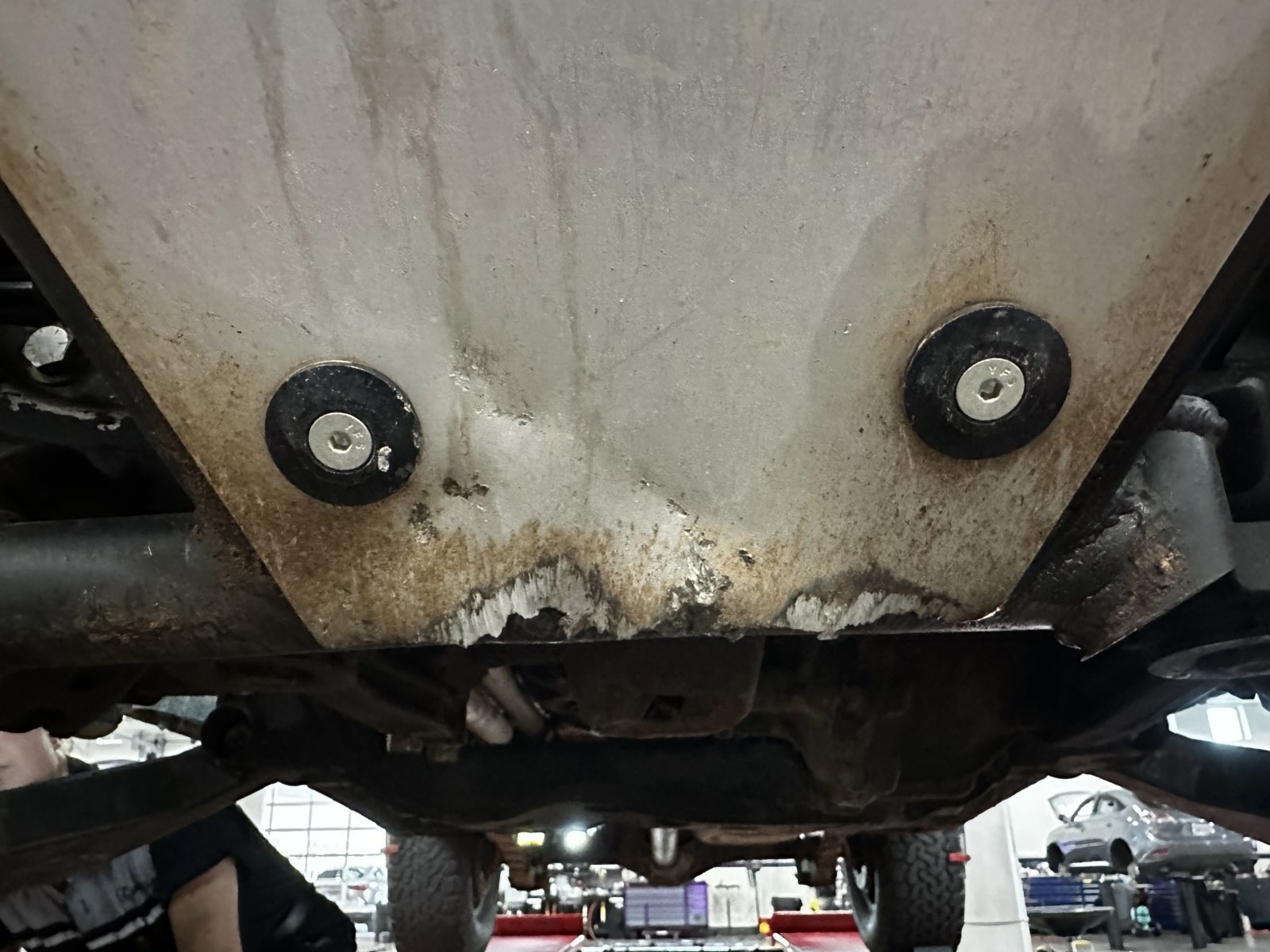

    Skid plates are good…
    My homies at Lexus took on my alignment. Got it dialed in. -0.4 degrees of camber, 4.0 caster, -.01 toe. Super happy with it!

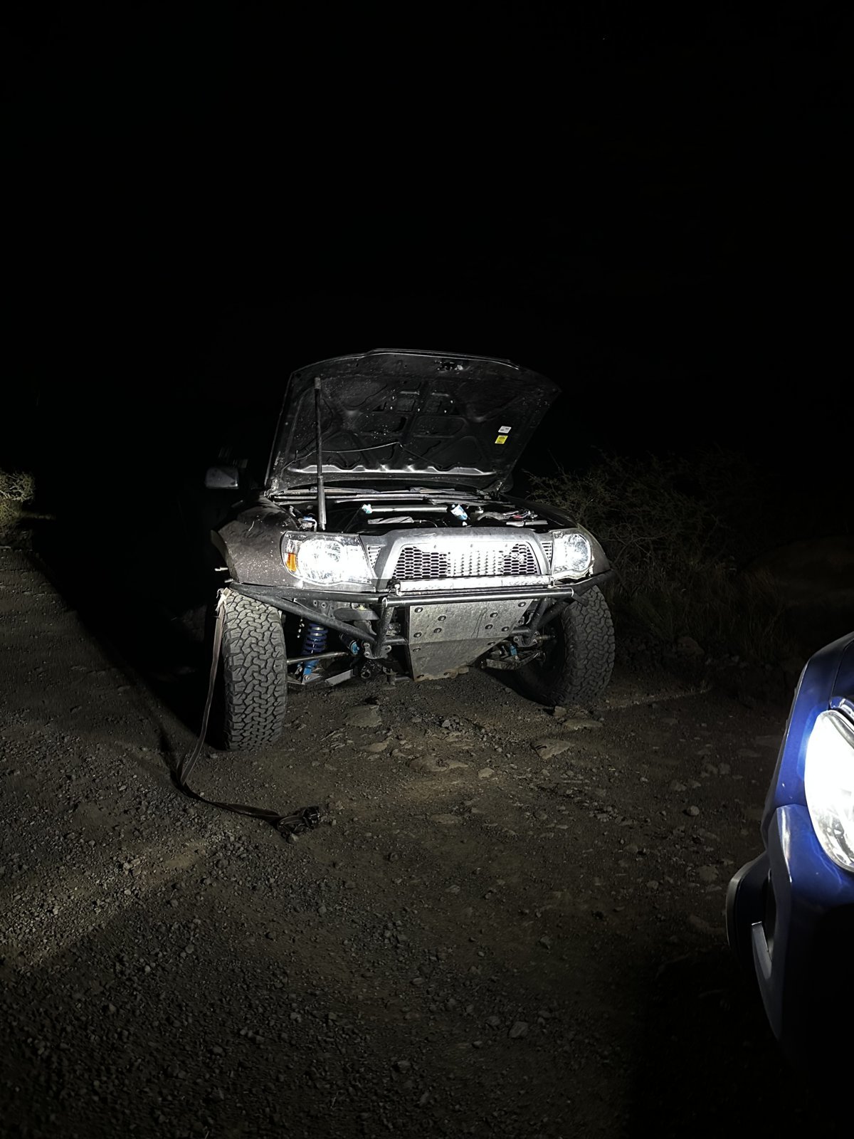

    Parting out. Who wants a built LS? BTF kit is for sale, brakes are for sale, shocks are for sale, DRT spindles for sale, jd slide rack for sale, you name it it’s for sale.
    I think this thing just blew a trans. It’s under warranty but like I fucking hate this truck. I never should’ve LS swapped it.
  20. Aug 21, 2024 at 12:11 AM
    #1840
    Pittsy
    Pittsy [OP] Ex car guy, currently in rehab
    Jan 20, 2022
    #387923
    2,454
    AZ
    07 DCSB 4x4, 25 Tundra Limited
    BTF Fab +4.5 - DMZ SUA - TE Cage - LS6 Swap
    It’s almost 12:30 and I’m posting on Starlink. I’m fucking stuck out here.
