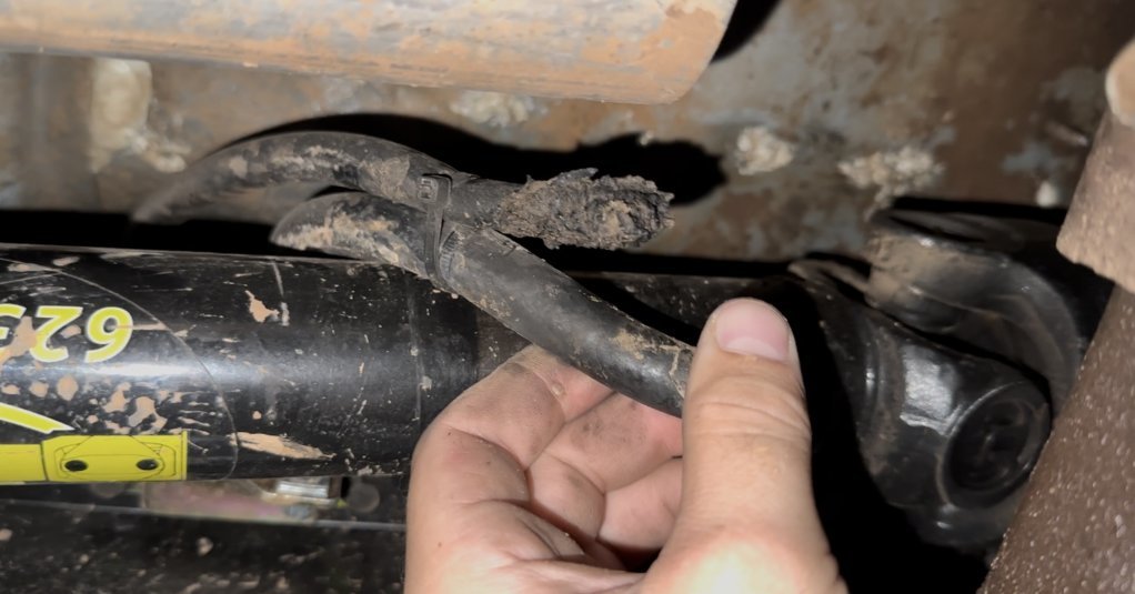

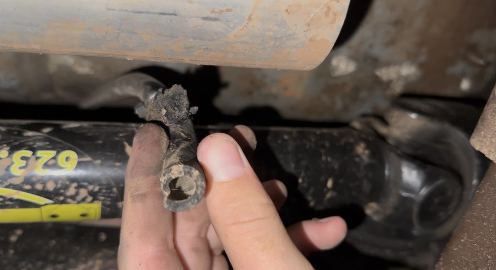

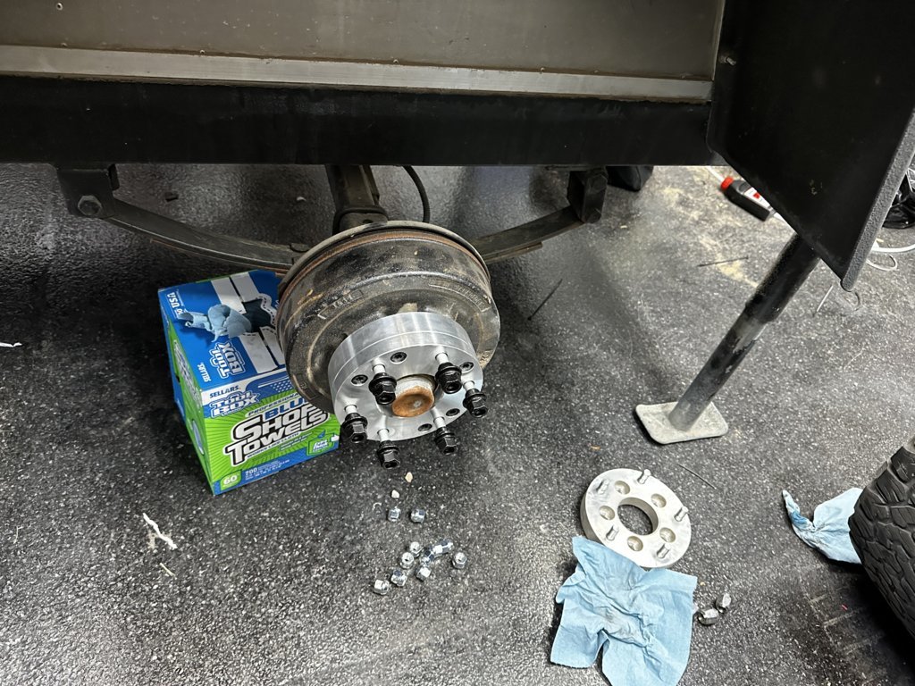

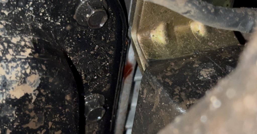

    Put these trick 5x4.5 to 6x5.5 wheel adapter/spacers on the trailer so I can run the factory TRD pro wheels on the trailer. IMG_4634.jpg IMG_4635.jpg IMG_4636.jpg
    While I was down there, I figured I might as well crawl down under the old truck and see if I was right. I was.
    the transmission breather line was getting bombarded by my exhaust, melted, and plugged itself. This caused the trans to pressure up, and push the rear output seal out, into the cavity of the tcase, losing all my fluid while it was parked, explaining why I have 0 movement. What a bummer such a stupid mistake caused this. Good news is, whoever buys it needs a 15$ part to fix it.

    Do you have a photo of your exhaust routing near that area of the vent hose?
    And what you're saying is that with some side cutters, a zip tie, and some transmission fluid and it will drive???
