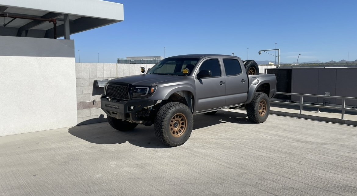

    Where we’re at now:
    Where we came from:

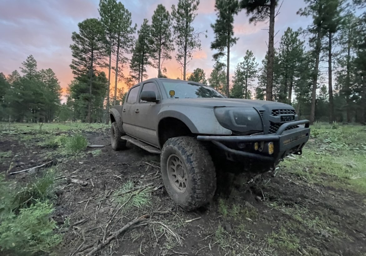

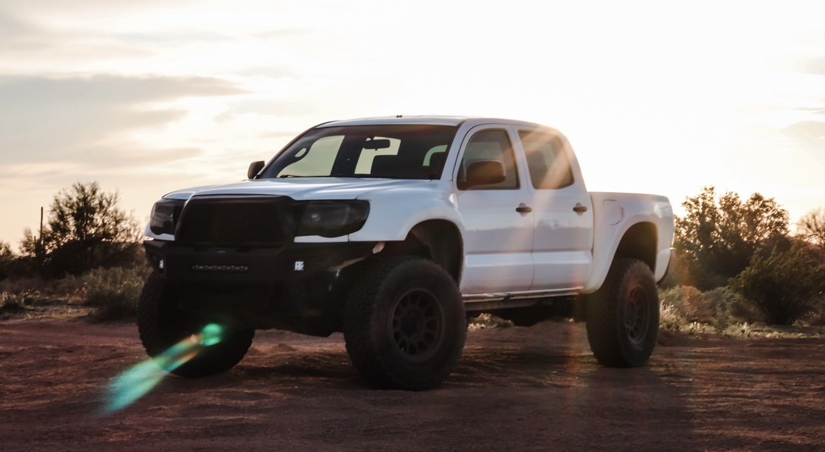

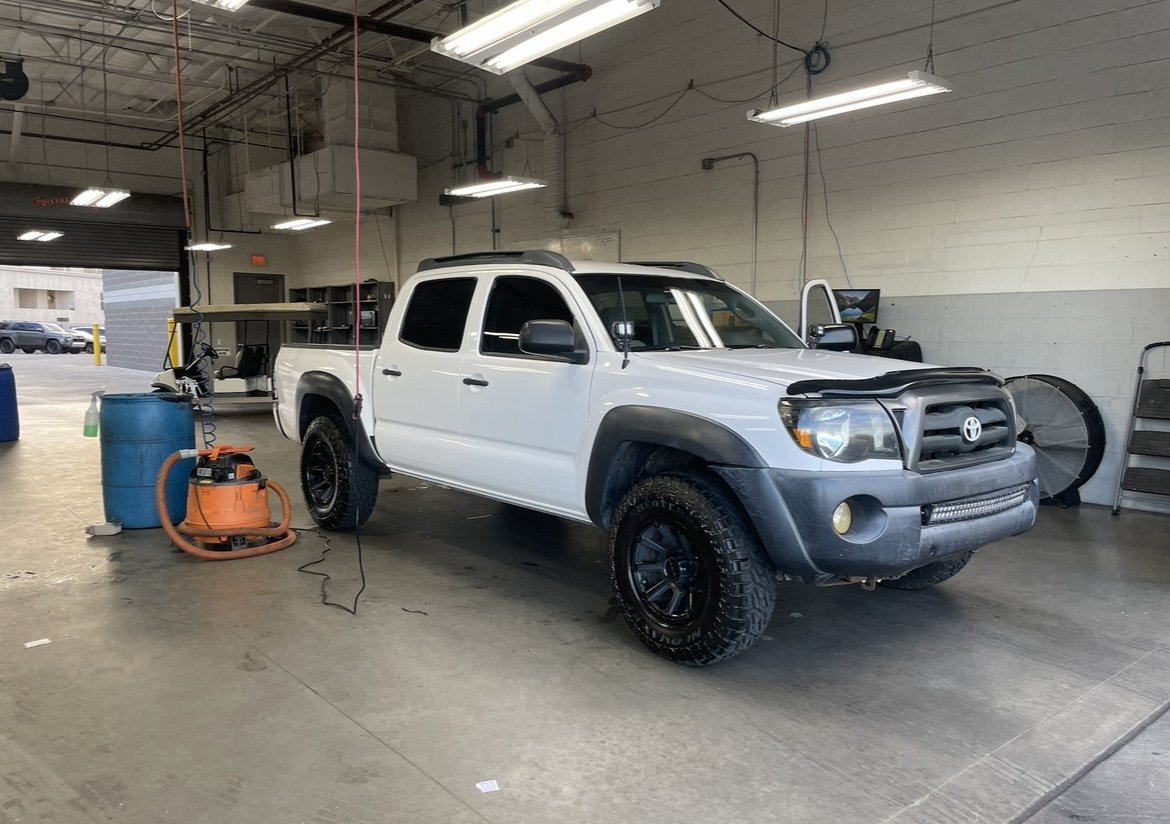

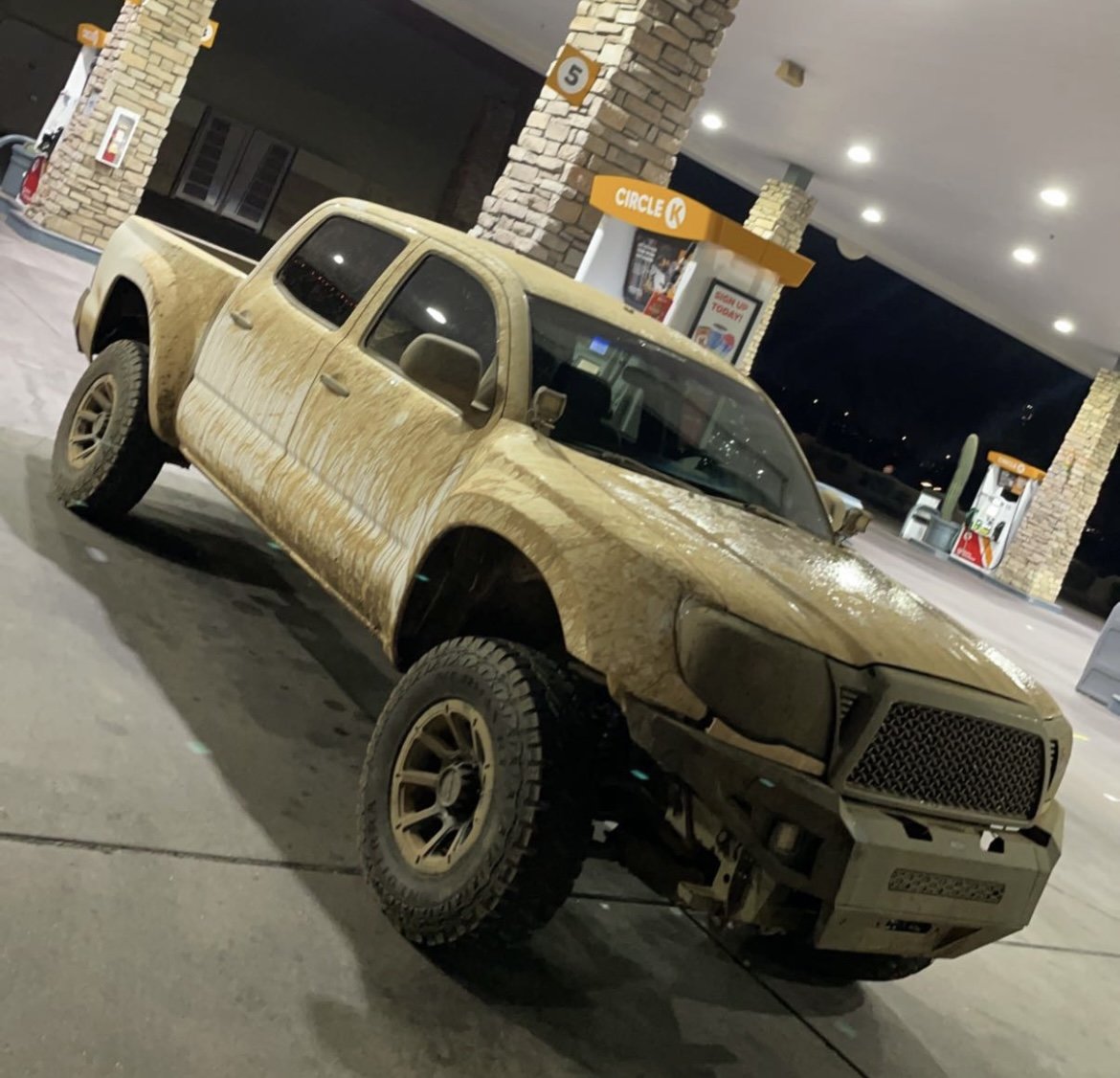

    Hi all. Starting this thread per the request of a lot of people on Facebook, also for my own record. This truck started as a daily for my daily. The old daily was my Lexus RC350, that's been caged and supercharged and wide-bodied. Obviously cant use that as a daily anymore, so enter: 2007 TOYOTA TACOMA DBL CAB 4.0L 6MT 4WD. Purchased it with 240k-ish miles. I proceeded to smoke a mailbox with It on day 2. Turns out fiberglass is cheaper than oem, so I glassed the whole truck. I now had a stock tacoma with fiberglass. great.
    Later, I installed king extended travel coilers front and rear with reservoirs and adjusters, spc control arms, OME rear leafs, and 35" tires. Wrapped the truck gray instead of white, got a CMC from DRT Fab, installed some goodies like a tire cage from 454 motorsports, got bumpers from c4 fab, a ton of lights from Baja designs. Life was great in the mind of my tacoma. I started ordering long travel parts from King, got all 10 shocks required for full long travel and then BOOM. The 4.0L V6 in my tacoma finally let go at 267k miles. I drive the thing like I stole it, so it really wasn't a surprise given the milage. I had always planned for a motor swap when It let go, but certainly wasn't ready for it when it happened. I have 10 shocks now sitting waiting to be installed, but what good is long travel on a truck that doesn't drive?
    I bought an LS6, holley terminator, and built 4l60e. I don't plan on keeping the 4l60e, id like to reuse the stock trans, but this thread is mainly to keep track of the swap so we can all learn along the way. I want to keep 4wd, specifically Toyota IFS 4wd, and I want to keep stick shift.
    all the attached pics are in chronological order. IMG_1900.jpgIMG_1901.jpgIMG_1902.jpgIMG_1903.jpgIMG_1904.jpgIMG_1905.jpgIMG_1906.jpgIMG_1907.jpgIMG_1908.jpgIMG_1909.jpgIMG_1910.jpg

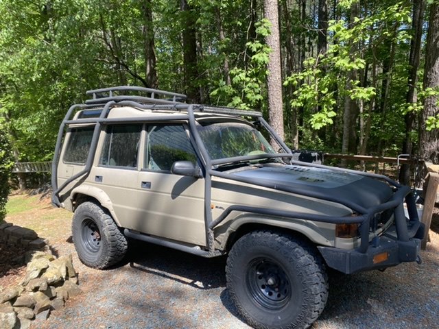

    I did a 6.2l in my Rover Discovery 1. Turns out....it was a pain in the ass....yet......it's so much more reliable, cheap to get parts for, and well...ya know what, I hated that lame assed 4.0 liter V8, that was actually a damned Dodge motor from back in the day. Your build has me VERY intrigued. Is there an adapter, and engine mount kit out for the swap?
