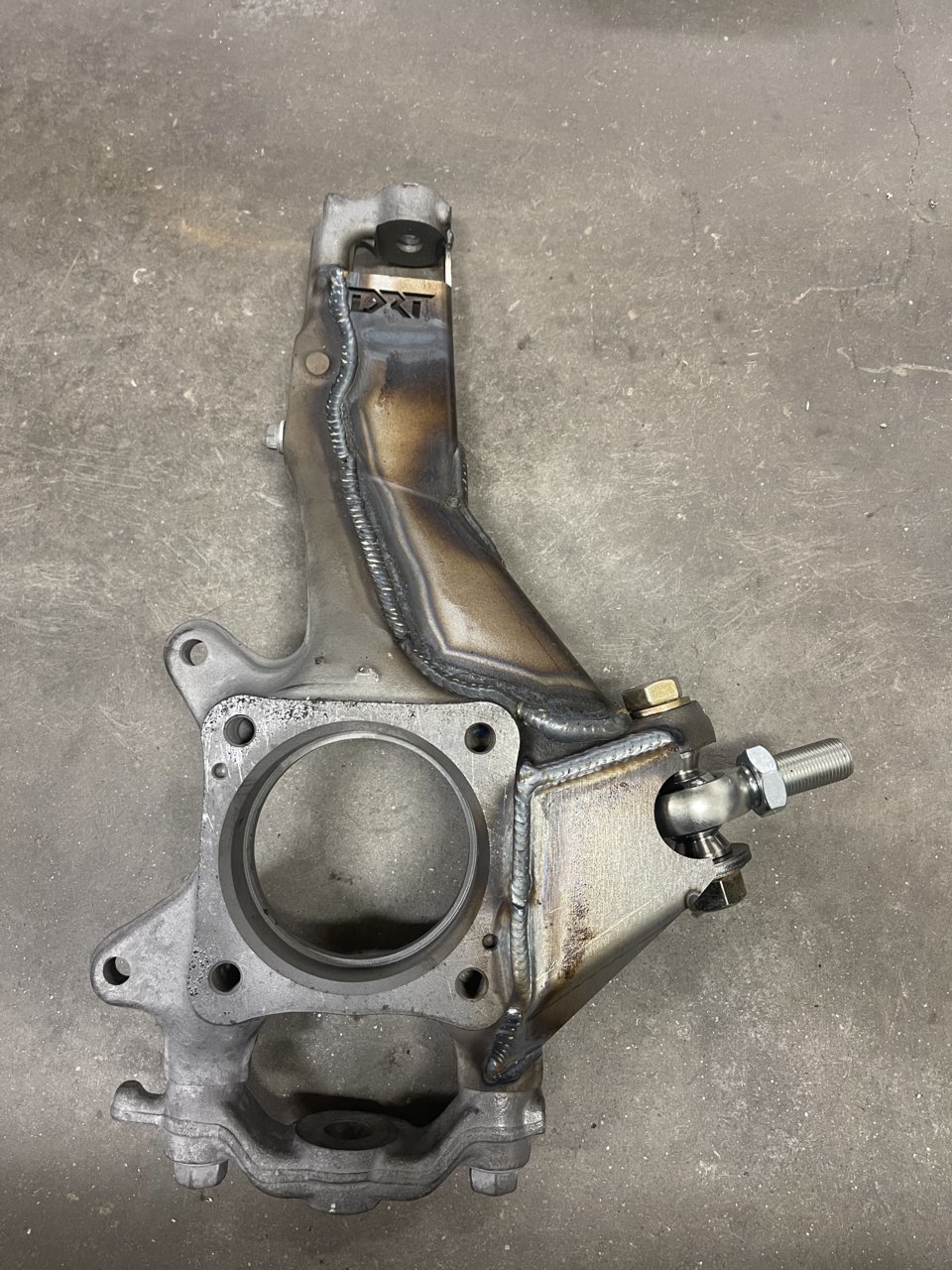

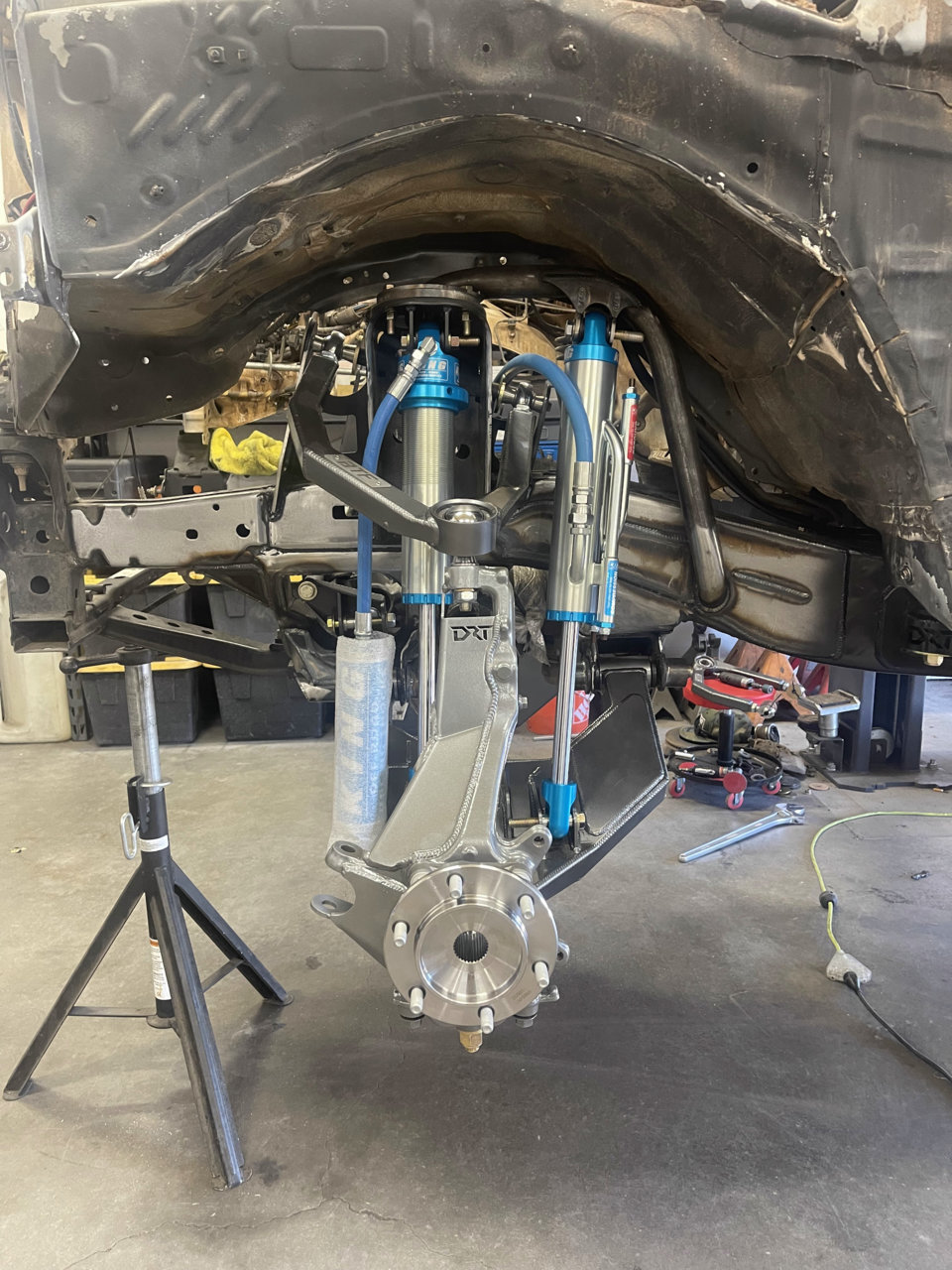

    4ED97726-D0B0-4CFE-A8CF-4E1FDB17ADC2.jpg 673605FB-A6F1-4D02-9441-F17A27B4A07A.jpg D2CEB68B-55E0-44E0-9226-FE892B44830C.jpg
    454 Motorsports is getting it done! Spindles all gusseted from DRT, also got the JD fab double sheared steering tabs for the heimed steering system and slide rack.

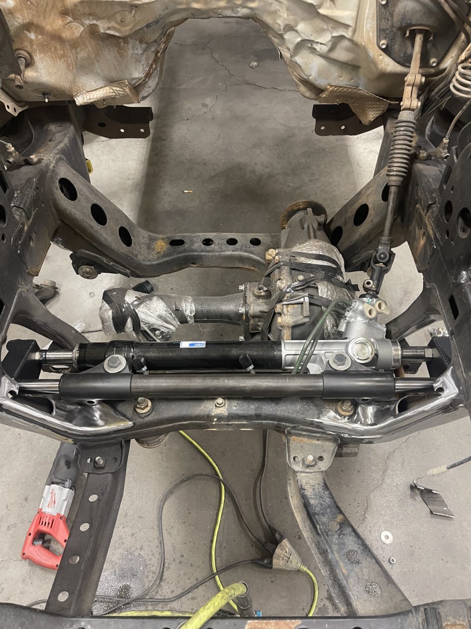

    97AD4D12-9A68-431F-8D17-DCEF567B6CD1.jpg 82B9B44C-47B3-4DB6-BDCF-38B0CF33550D.jpg
    New rack and pinion in + the new steering slide rack from JD fab! Once everything is set in stone, nylon rack bushings will be installed.

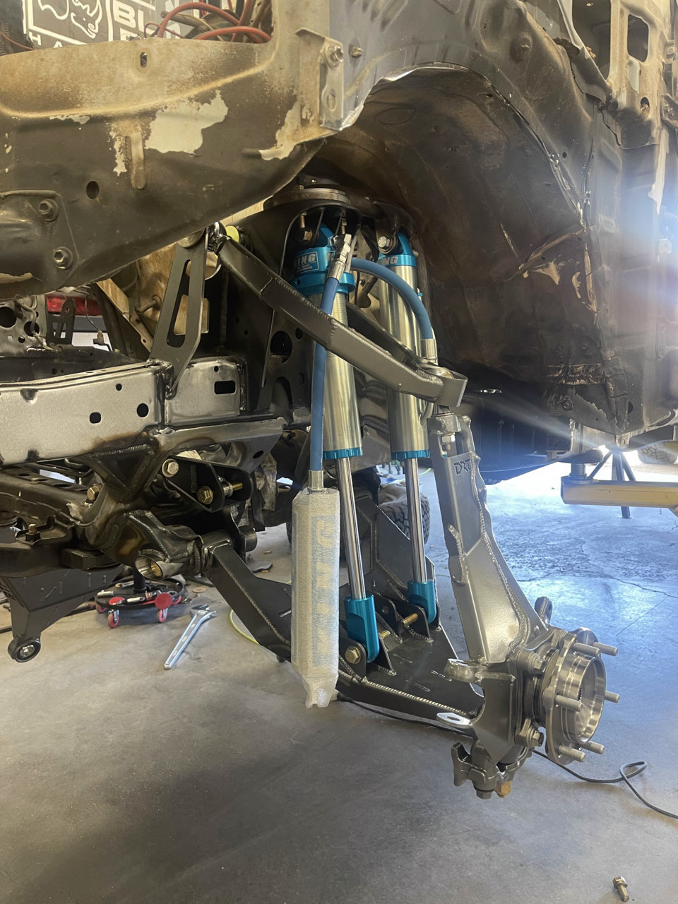

    F7AD6F83-89AC-407F-98BD-0796CEDD3212.jpg 926825D1-7D29-41B3-8EEE-6A3BDCC66D09.jpg 23DB9CE9-35C5-464F-AC7E-1F9EC64A902B.jpg
    Everything is in, it’s all gonna get boxed up, but it’s in.

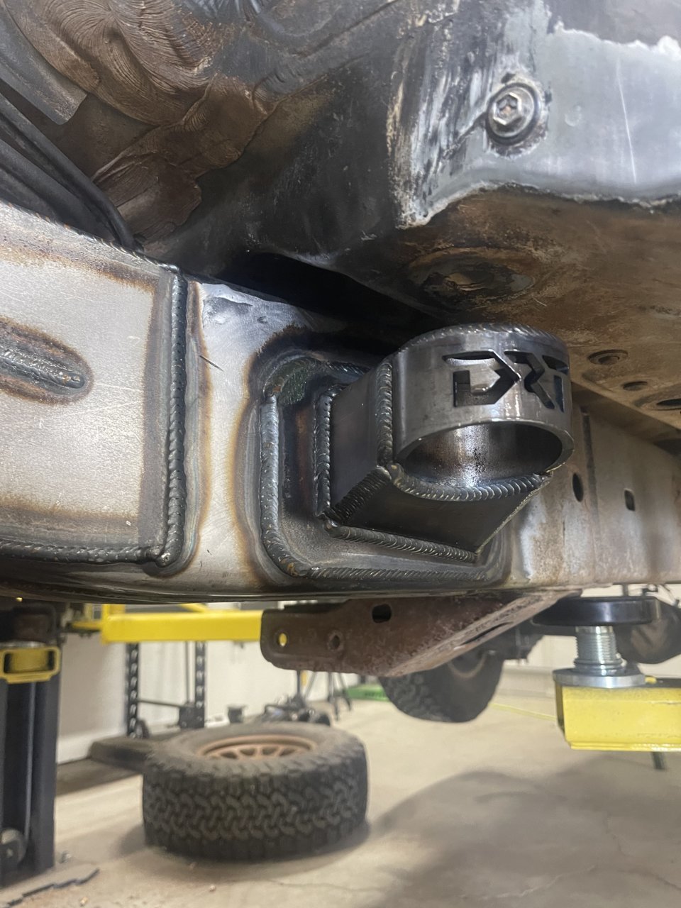

    Dirt king frame plate kit is on, as well as the BTF Fab bypass hoops.

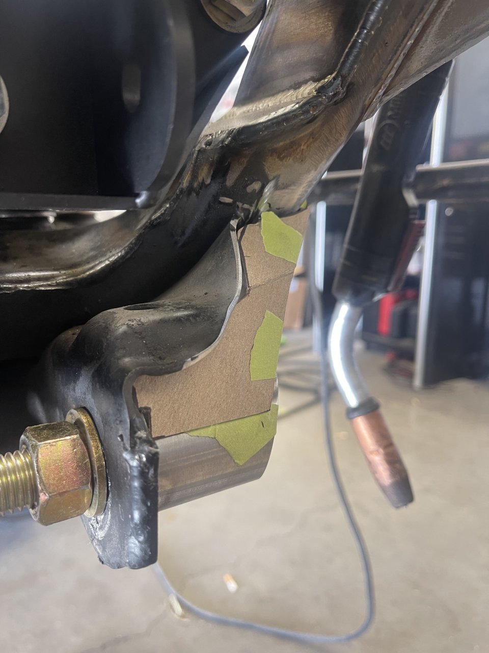

    49879873-3CC1-4889-812E-5C982B062D73.jpg 85C543A1-185E-4496-AF1A-8839ECBA26C3.jpg E77E82BA-6077-4B7B-ABB5-35603ADA2583.jpg
    LCA gussets coming along.

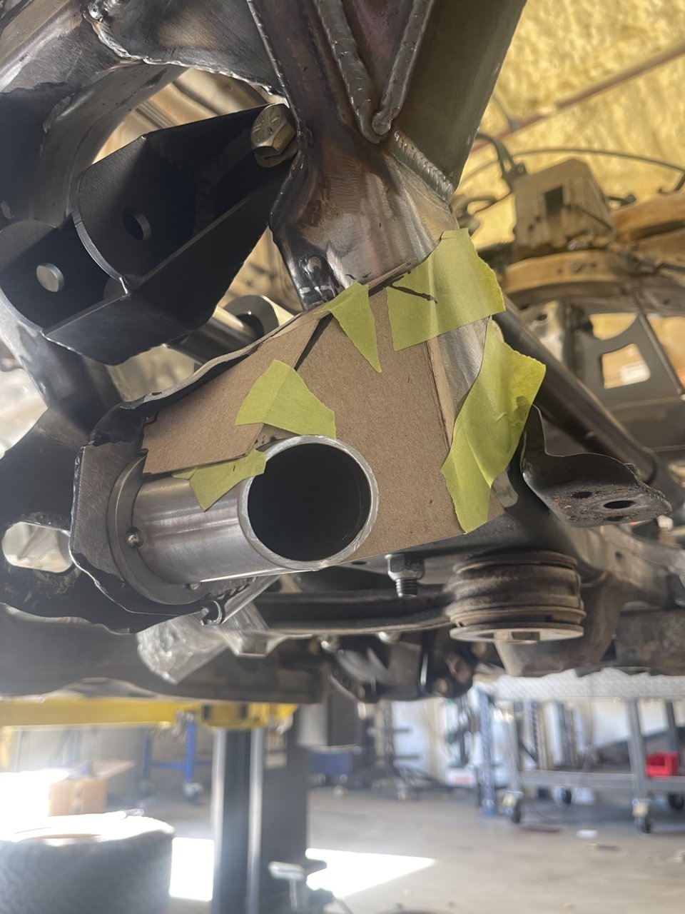

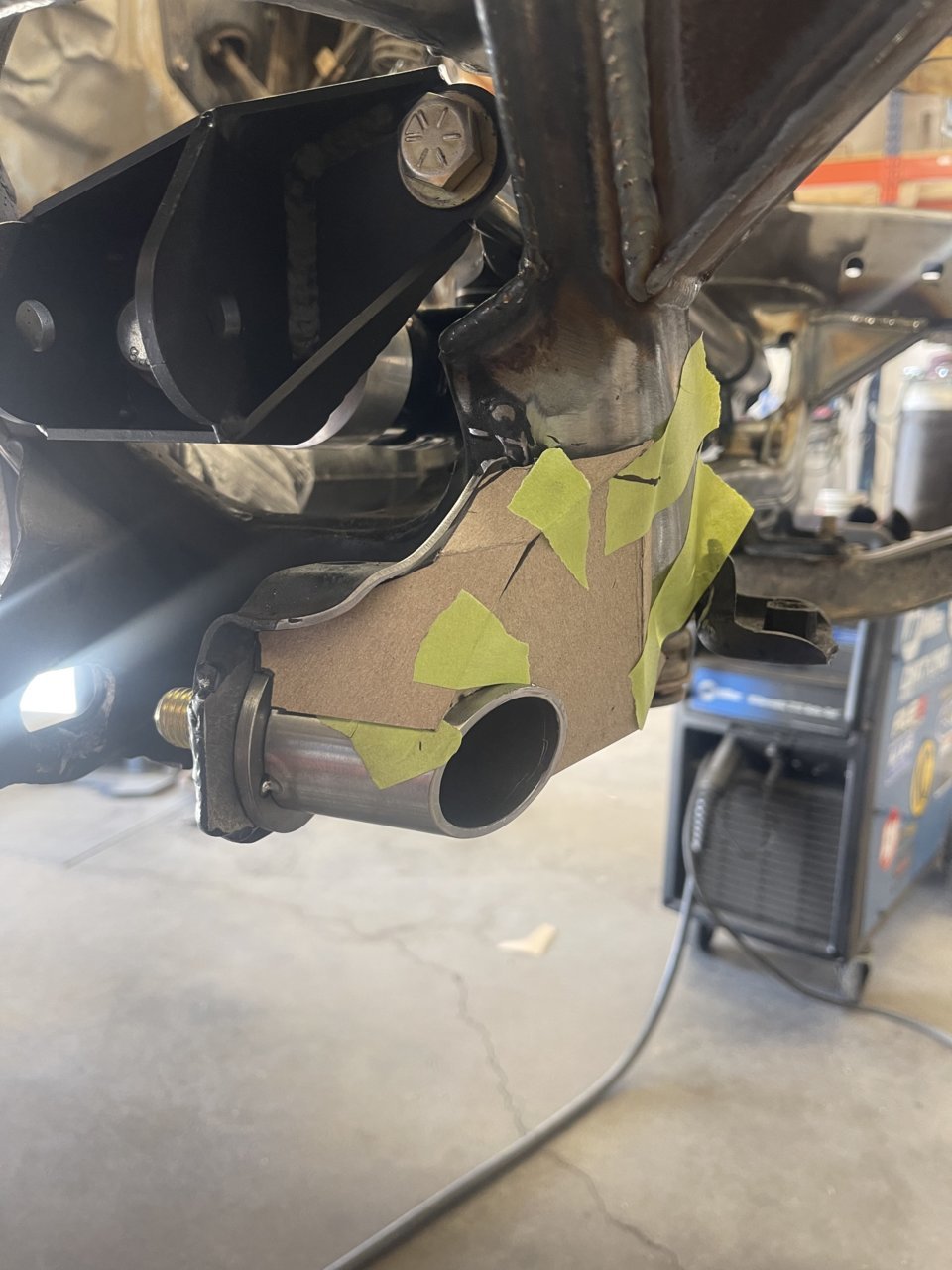

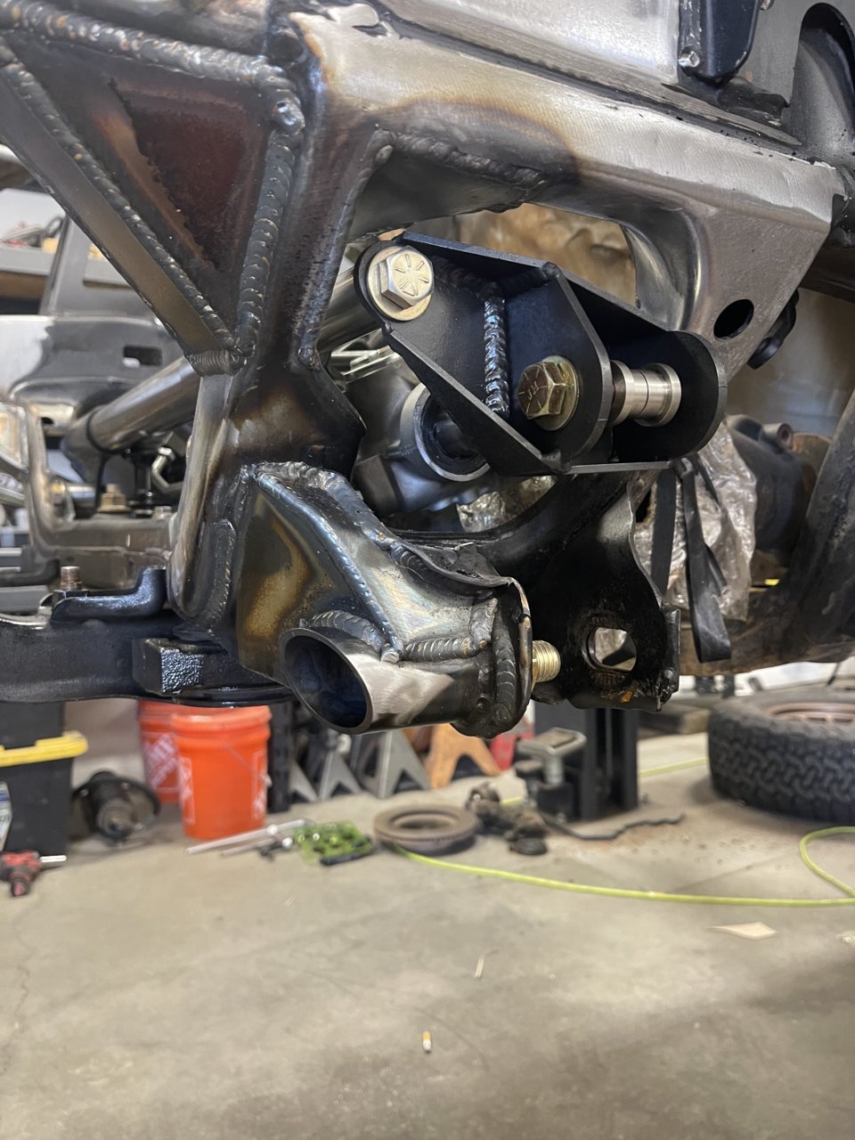

    When I first looked at it I didn’t think much of it, in hindsight it would’ve saved me time and money probably. And by me, I mean 454 Motorsports, they’re doing the install. Trucks already apart at the shop being worked on, and he’s gusseting the pivots. Speaking of which, here’s a pic of the finished pivot, still have to do the back side of the pivot but here’s the front:

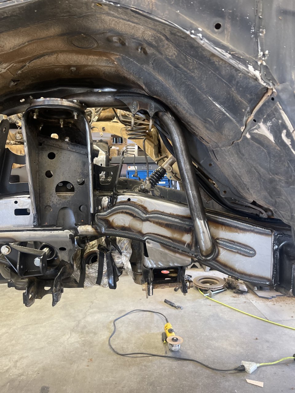

    Probably didn’t need to do this to clear my tires anymore since the kit pushed the spindle forward. I had DRT do a CMC right when I bought the truck, but I wanted to do it the right way so 454 did a full CMR from DRT.
    Tomorrow the last bit of hardware for the LCA pivots gets here, then suspension goes in and it gets cycled.
    After that, front fiberglass goes on, stuff gets tubbed and clearance’d, rear fiberglass gets braced, and lastly the front bumper gets built and put on.
    Words can’t describe how excited I am.

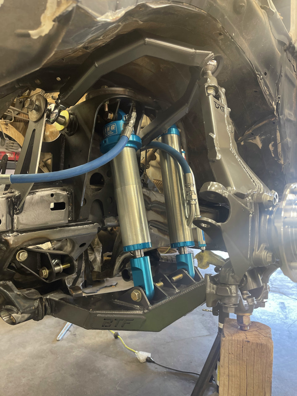

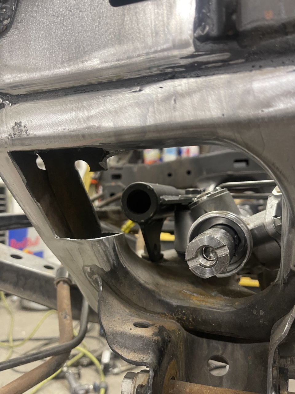

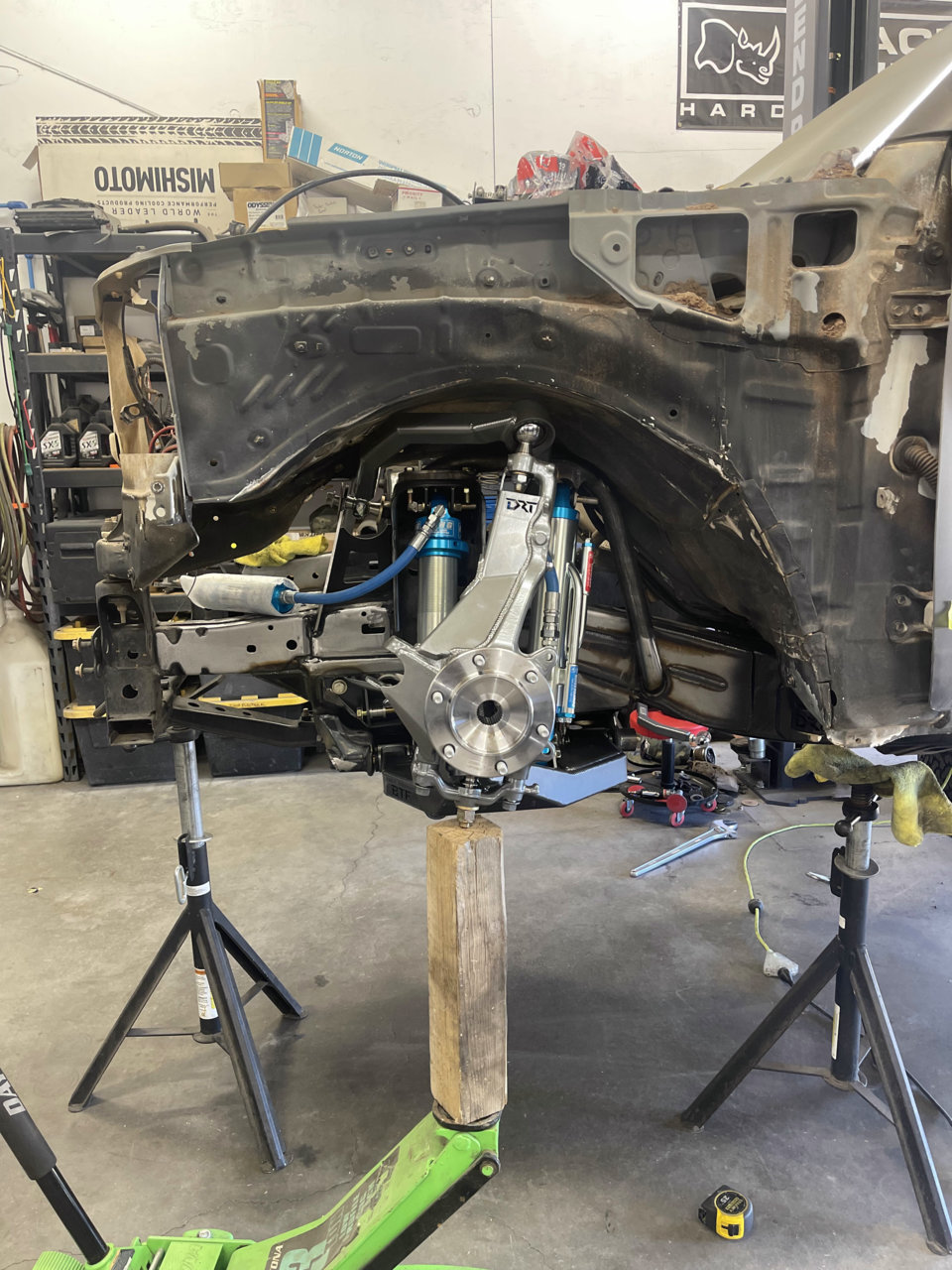

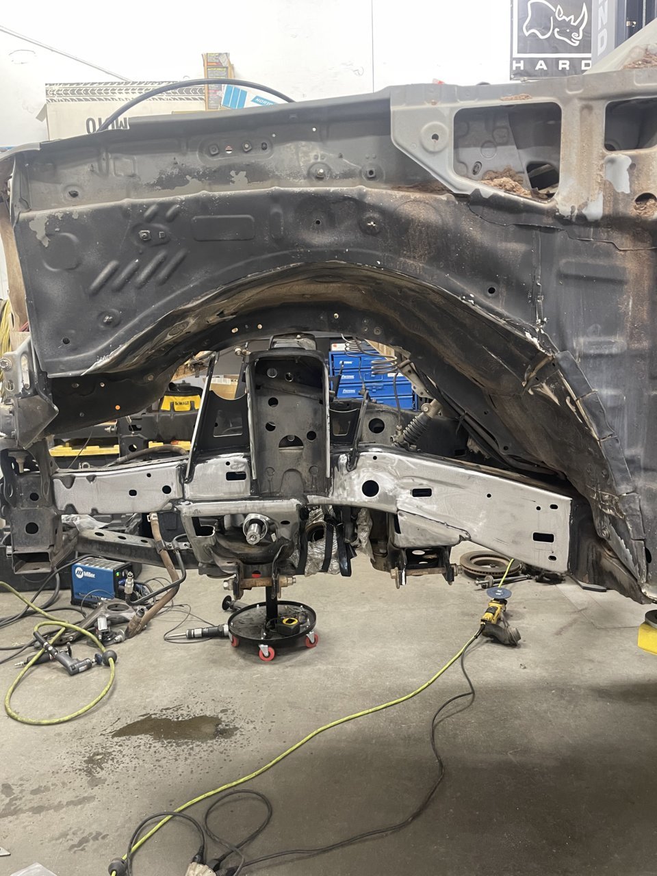

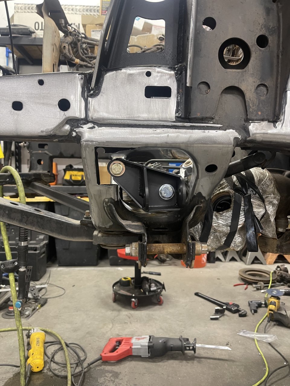

    IMG_4449.HEIC.jpg IMG_4448.HEIC.jpg 70422476290__A3362582-D249-4309-94B9-FB9C61687BD9.HEIC.jpg 70422475205__500E8FAA-B148-434C-8E38-3E790BDB3B12.HEIC.jpg
    This is hot. One problem, the way my inner fenders are, i'm pulling 14 and 5/16's of an inch of travel, stopped because the uppers hit the inner fenders. So, 454 is working out a plan, but the way it looks, he's probably going to end up cutting out the inner fenders. Fuck it. I don't want to sacrifice what might be almost an inch of bump travel and regret it later. Should pull close to 15-15.5" strapped once it's done.
    With the amount of cutting needed to clearance the 35’s at full bump, we’re just going to clearance it for 37’s at full bump. When I shred these tires I’ll do 37’s.
    the plan is as follows:
    Everything front suspension wise is going to get done this appointment, meaning the inner fenders are going to get cut that way we can bump and strap the suspension for 37’s, front glass is going to get rough mounted, and rear glass is going to get braced. We made an appointment for July to finish tubbing the firewall, making new inner fenders, and building the custom front bumper.
    In the mean time, I’m going to get the motor in and hopefully have the truck running and driving. Really pumped on this.
