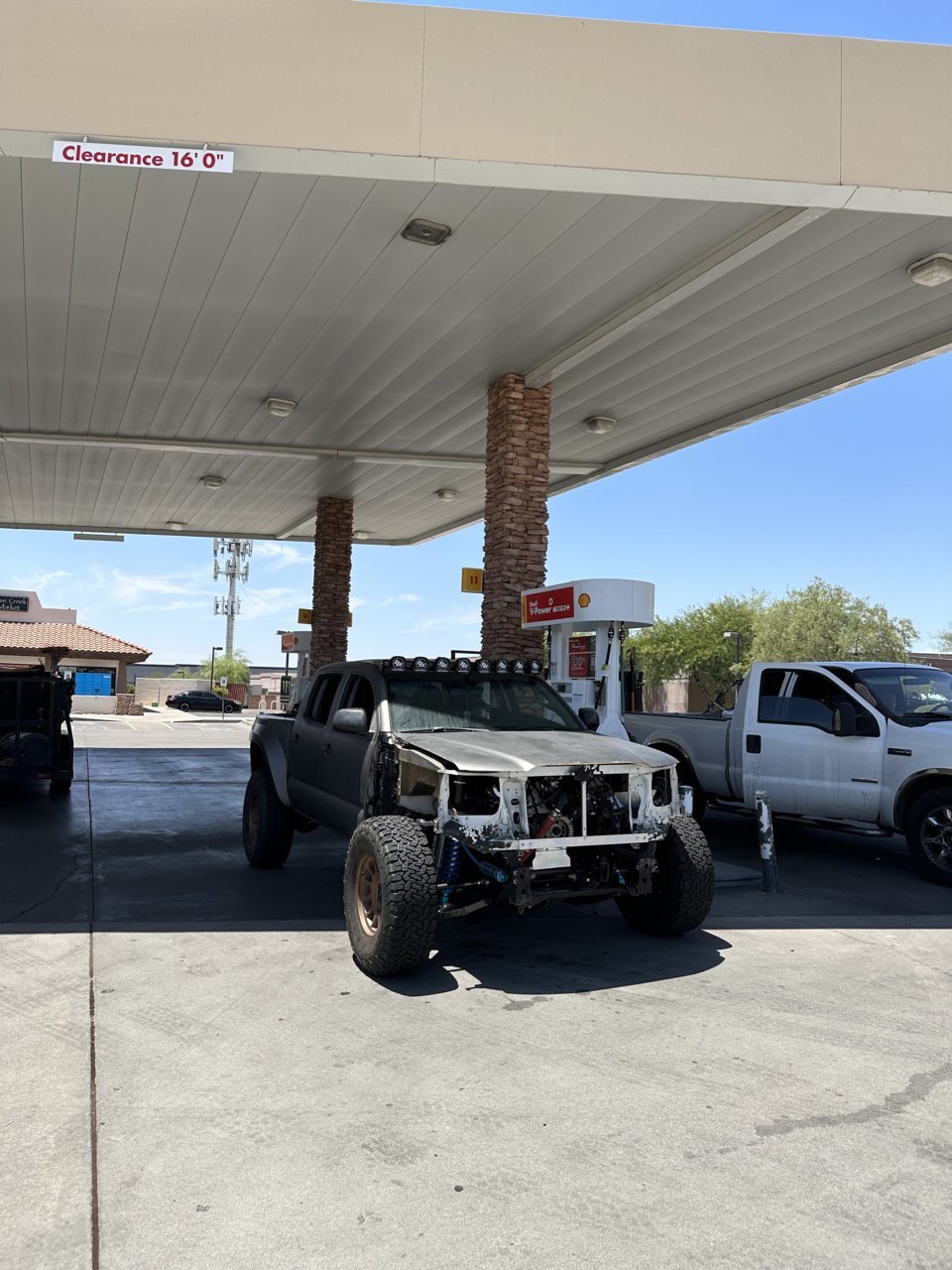

    I have a few drips coming from my power steering lines, not worried about those, but there are a couple small drops coming from the trans pan again. Guess I need to retorque those. My Speedometer and gas gauge don’t work anymore which is annoying, but not the end of the world.

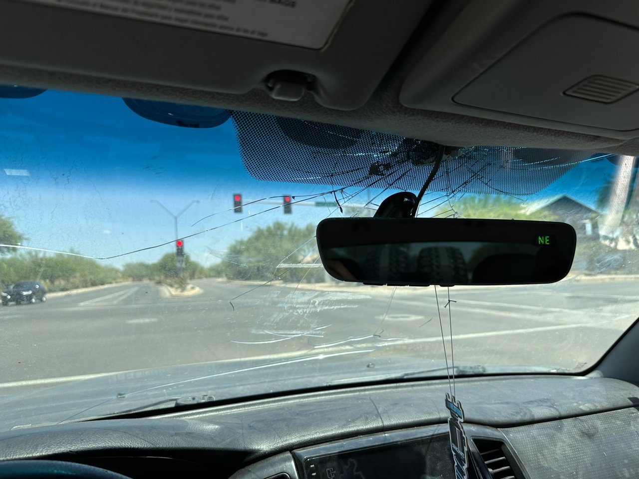

    the reason I’m upset is because it slipped my mind that I took my Home Depot core support out, so when I left, this happened: IMG_5335.jpg
    hood flipped up and shattered my windshield. Small price to pay I guess. Glad it happened at a lower speed and in my neighborhood and not on a busy road.

    Yeah it’s 112 today and it stayed right at 205 most of the drive. Crept up to 214 but it leveled off and fell back to 205. I probably need to bleed it again.

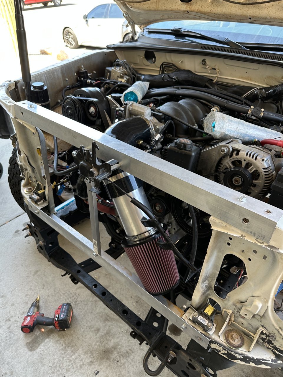

    She’s breathing filtered air finally, lol.
    need to redo the PCV system, the way I have it is wildly incorrect and led to me sucking a bunch a valve cover oil right into the intake:rofl:
