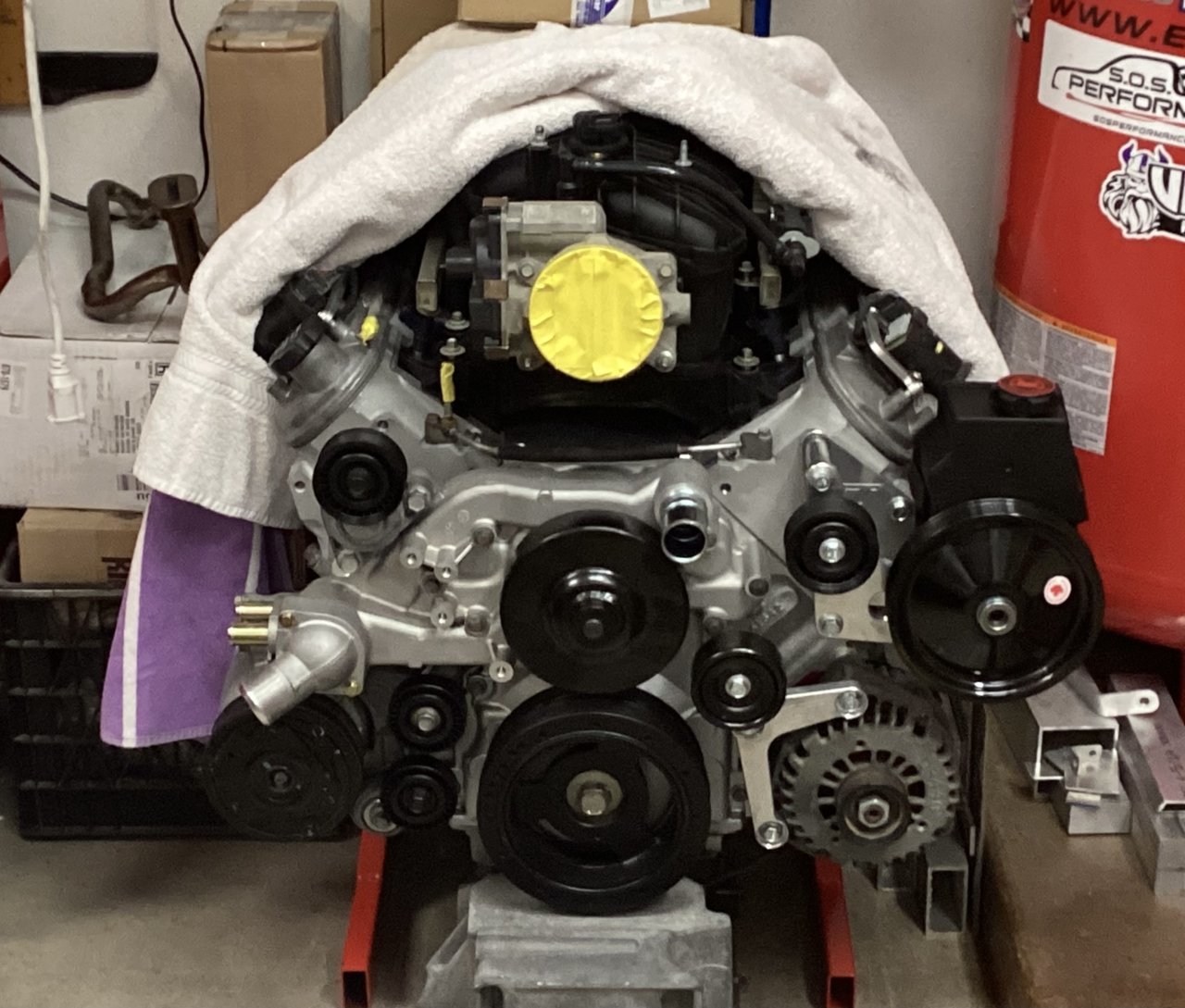

    First why move the AC up and out the same as the alternator on the other side?
    The Tacoma has room between the frame rails for the accessories to sit low. I also purchased 04 Vette accessories for the extra 1.5” of room in front the engine. Im also searching for someone who could LS swap for me.
    F1473439-4D34-4EFE-AE01-E0FE7830B5BA.jpg Q

    I moved the AC and Alternator up high because A, alternator was already up high, and B I didnt get a compressor with my motor so might as well Gert a big one and stick It on top. I have plenty of room. On top of that, im super space limited down low with the front diff and steering slide rack and accessories, so.
