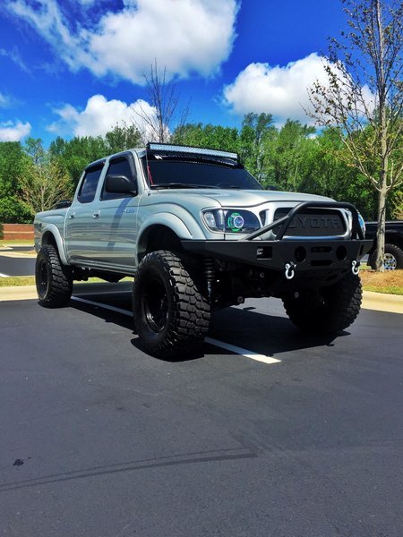

    Haven't up dated this lately. Here some pics

    I have the same eibach and 5100 set-up. From your pics you look higher though?. I am sitting on 285/75/16 but they should be close to your 33's in size . Are you running your springs on the 0" settings? You don't have a 1" B.L. do you?

    you can clear 33's with those coils and on the 0 setting

    we have the exact same lift with about the same amount of bs on our wheels too

    Maybe it's just a picture thing. His truck just looks like he is sitting higher than my current set-up. Thought maybe he had his springs compressed to the 1.25" setting or something else like a 1" body lift

    It's the way his bumper is cut and raised on the sides shows more tire gives the illusion of height. Same thing happened when I put mine on even though I actually lowered a bit.

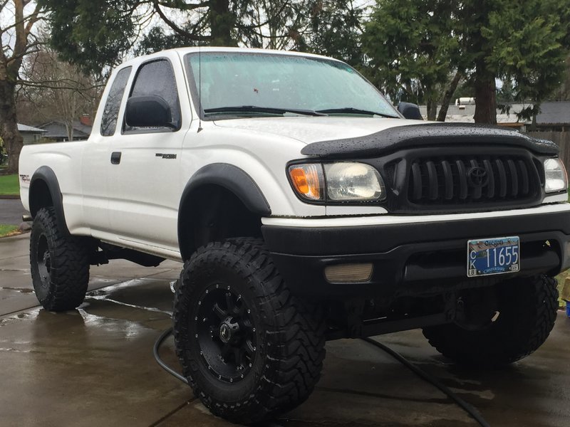

    See and my truck has the 285/75 Toyota MT's with race line 16" rims with a 4.5 back space and my struts are 5100 set at stock hight and then the 5 inch db lift . And your guys 5100 don't bottom out??image.jpgimage.jpg

    We don't have a dB lift. with our 5100's and eibach coils we sit around 3" of lift. Sounds like you need longer shocks and bump stops for that lift your running.

    That doesn't look like 5"

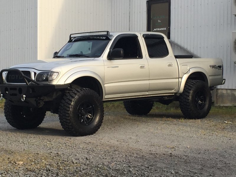

    I'm sitting on the zero setting with eibachs man. Here is a pic with stock bumper
