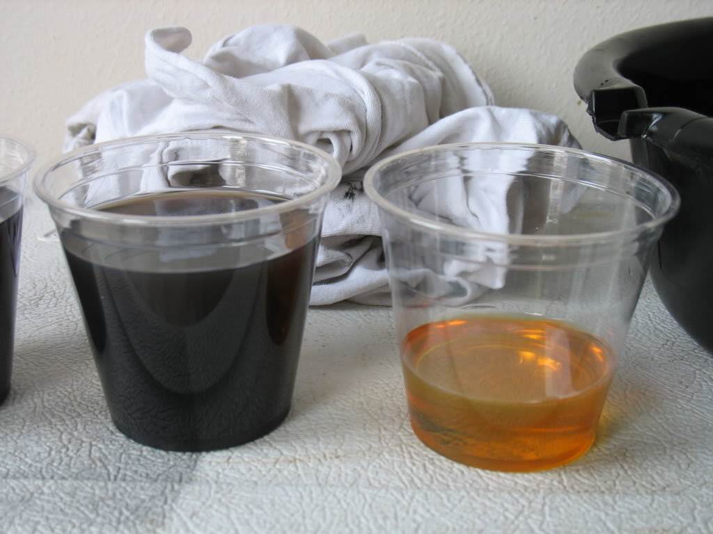

    To eliminate all possible sources of error, I replaced this Rear Diff Fluid.
    Tried new oil, 3 qts. of 80w-90 Castrol Dino Oil + 4oz of Champion brand LSD additive
    new vs. old oil, after ~2k miles since change:

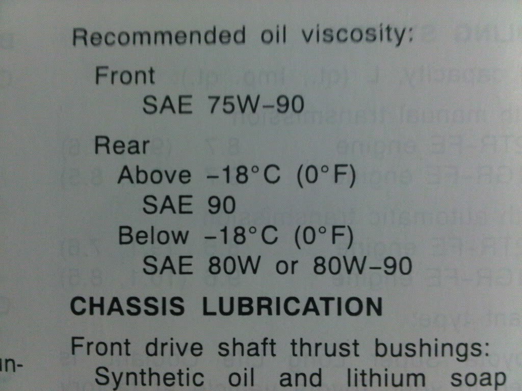

    That's strange, so are you saying we have different manuals ? Just to make things clear here is mine :
    And page 398 shows what type of oil to use in the front and rear diff :

    there is an appriciable difference Between 75 and 80 it's half the ISO viscocity. The ISO viscocity is what really dictates how thin the oil is. Too thin = less of a film to keep metal from metal contact. When that film of oil breakes then there is metal to metal contact = not good. Once the oil comes up to temp then The 90 kicks in and both are the same.
    I would go with 80-90 and not 75-90 unless someone has info that states otherwise

    Yes, in fact we are looking at two different manuals: The one you posted is an "Owners manual." The one I've been looking at is a "Factory Service Manual" found here--http://www.ncttora.com/fsm/05+/data/ileaf/06toyrm/06toypdf/06rmsrc/rm2006ta/002033.pdf
    Either way, they both clearly state for the rear the recommended oil is "SAE 80W-90." My concern is that if I switch to an 80W oil, I may gain a little protection, but probably suffer in gas mileage (IDK how much). Does anyone think that we get those groans in the rear because we've been using the 75W?
