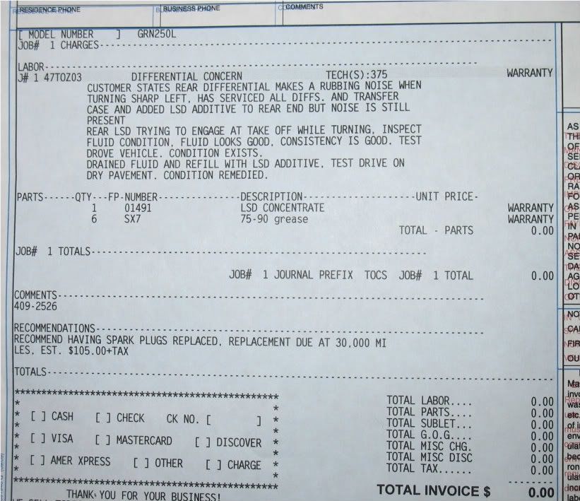

    Update: Tech said that it was the additive. Or, more specifically, the additive was either not getting where it needed to be or not doing what it needs to do. He explained that if the additive is not getting in the friction plates that you can get viscous coupling in the plates and they stick together and act like its locked, not letting it slip, causing binding. I can buy this. He said that the weight and brand of oil is not really that important, but that our rear diffs are really finicky with anything other than the toyota or chevy additive. Anyway, they replaced the oil and additive free of charge and wrote it as a warranty claim (I stressed to him that I had replaced the rear diff oil and additive TWICE). NO MORE NOISE COMING FROM THE DIFF!!!! FYI, the dealership used 75w-90. Proof:

    glad to hear the problem is gone and even better covered under warranty.

    X2!! I'm glad they even went with 75W-90!!! Thats all I have in my garage. I'm a little concerned still cause mine is all Redline products.:cool: Redline oil and redline LSD additive.:rolleyes:

    Can you get from them what brand oil and what brand of LSD additive they used ?
